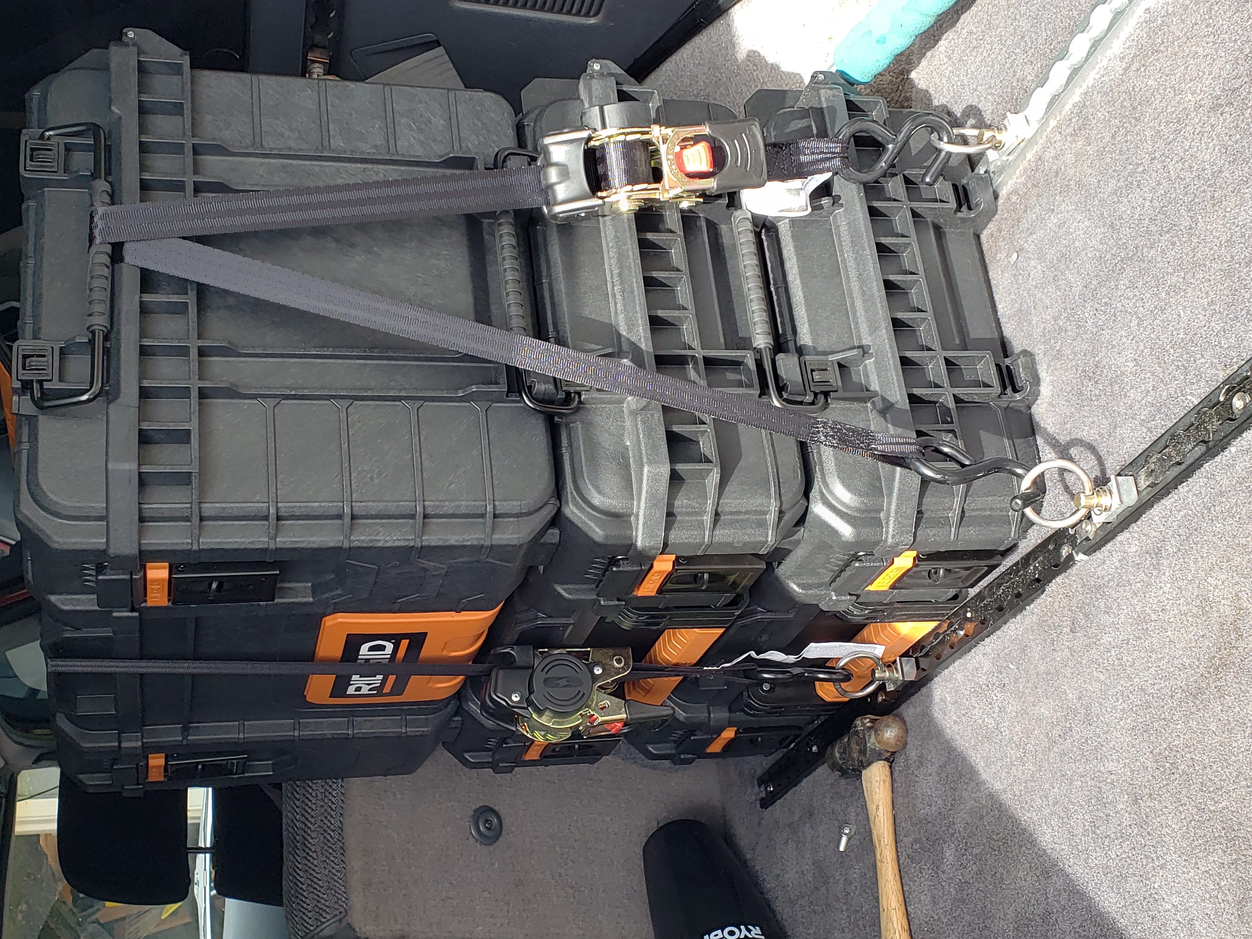

Added another tie down track for tying down the tool boxes. Also picked up a couple of self retracting ratchet straps. Push a button and they take up the slack and than ratchet to desired tightness like normal. So far I like them.
it's nice not having a strap go to the other side of the cargo area.

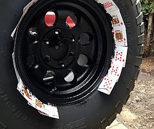

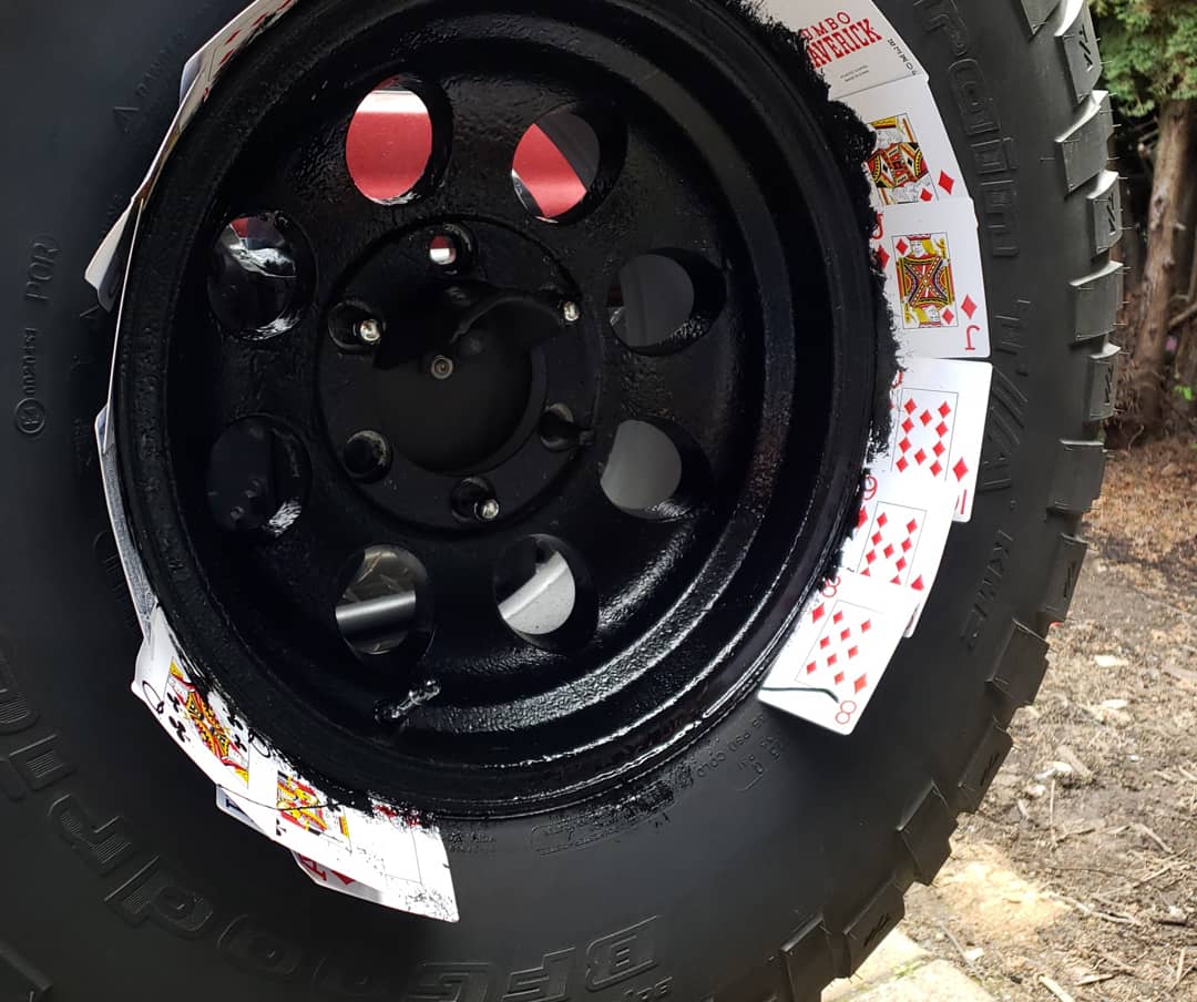

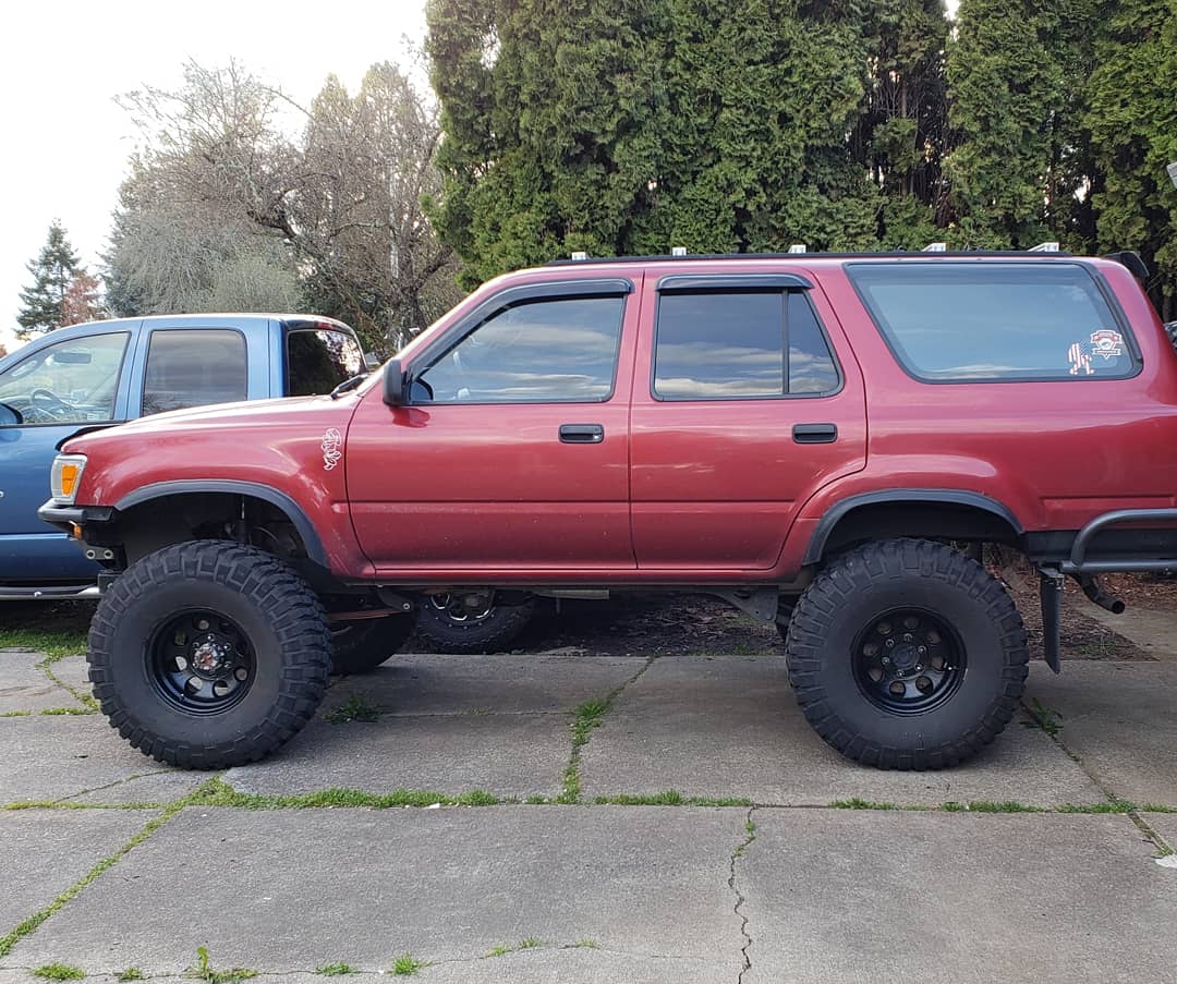

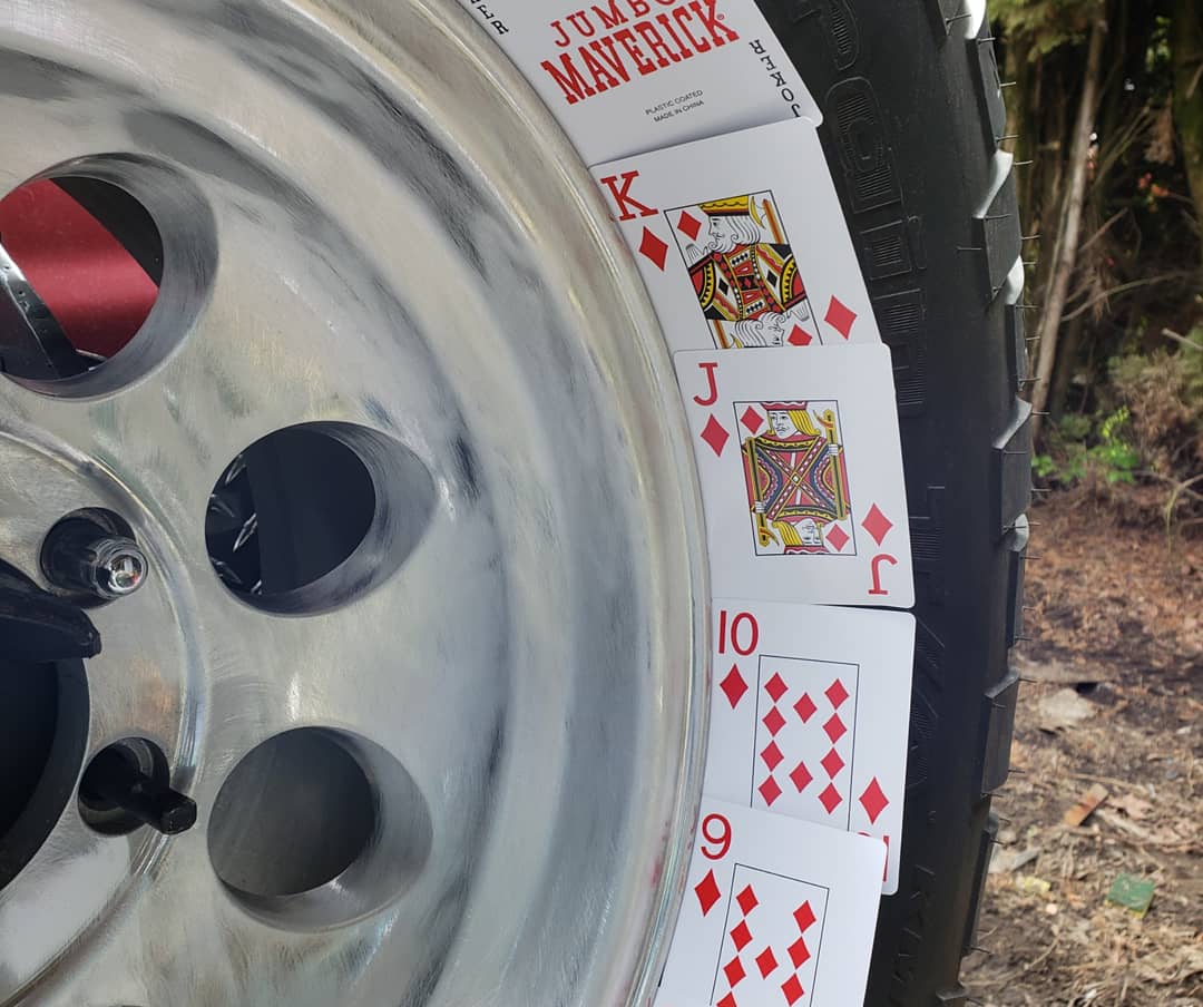

I have always liked black rims. Nobody had them in stock when I ordered the wheels and tires last year.
took a gamble and used some black monstaliner on the rims today. Saw a post a few years ago where someone used a desk of cards to mask the tires. Worked awesome.
it worked as a good experiment to let me know how monstaliner sets up. Not perfect but it will do

I read those paints, Line-x, U-pol Raptor and Monstaliner in the rims could affect the wheels balance, I don't know if that's possible but it's something to think about.
http://www.cumminsforum.com/forum/ti...ck-wheels.html
Old 04-19-2018, 07:49 AM
  #659
Fossilized
Staff
iTrader: (6)
dropzone's Avatar
Join Date: Oct 2005
Location: PNW
Posts: 19,771
Received 448 Likes on 293 Posts
it makes sense that it could impact the balance.
I didn't put on heavy coats, both were fairly light.
I'll find out when I drive it. Gonna let it sit today to let it cure. If it did impact the balance I will remove it.
