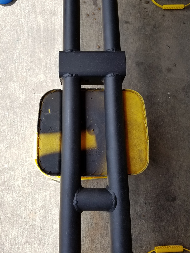

And since you were joking about the Tidy Cats buckets, I think Trail-gear used them for jigs on their bumpers. The two tubes fit perfectly in the indentations on the bottom of the bucket
