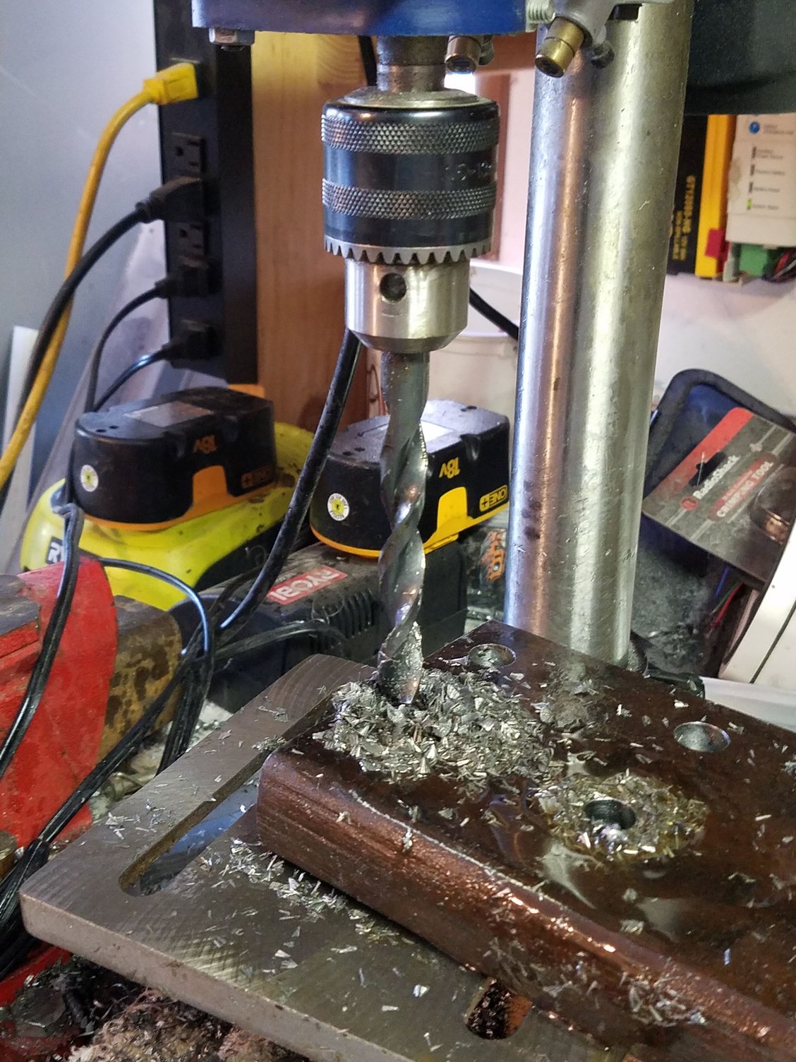

It is one heavy piece of crap, 20 lbs plus. Hopefully be able to get it drilled next weekend. Going to need some thread cutting oil and a few more drill bits, gonna destroy a few of them..

Played with the drill press today, got all 8 holes drilled in a couple of hours, started with 1/8" bit worked up to 1/2" and some thread cutting oil. Hopefully see tomorrow if this half assed spacer/riser idea of mine might work

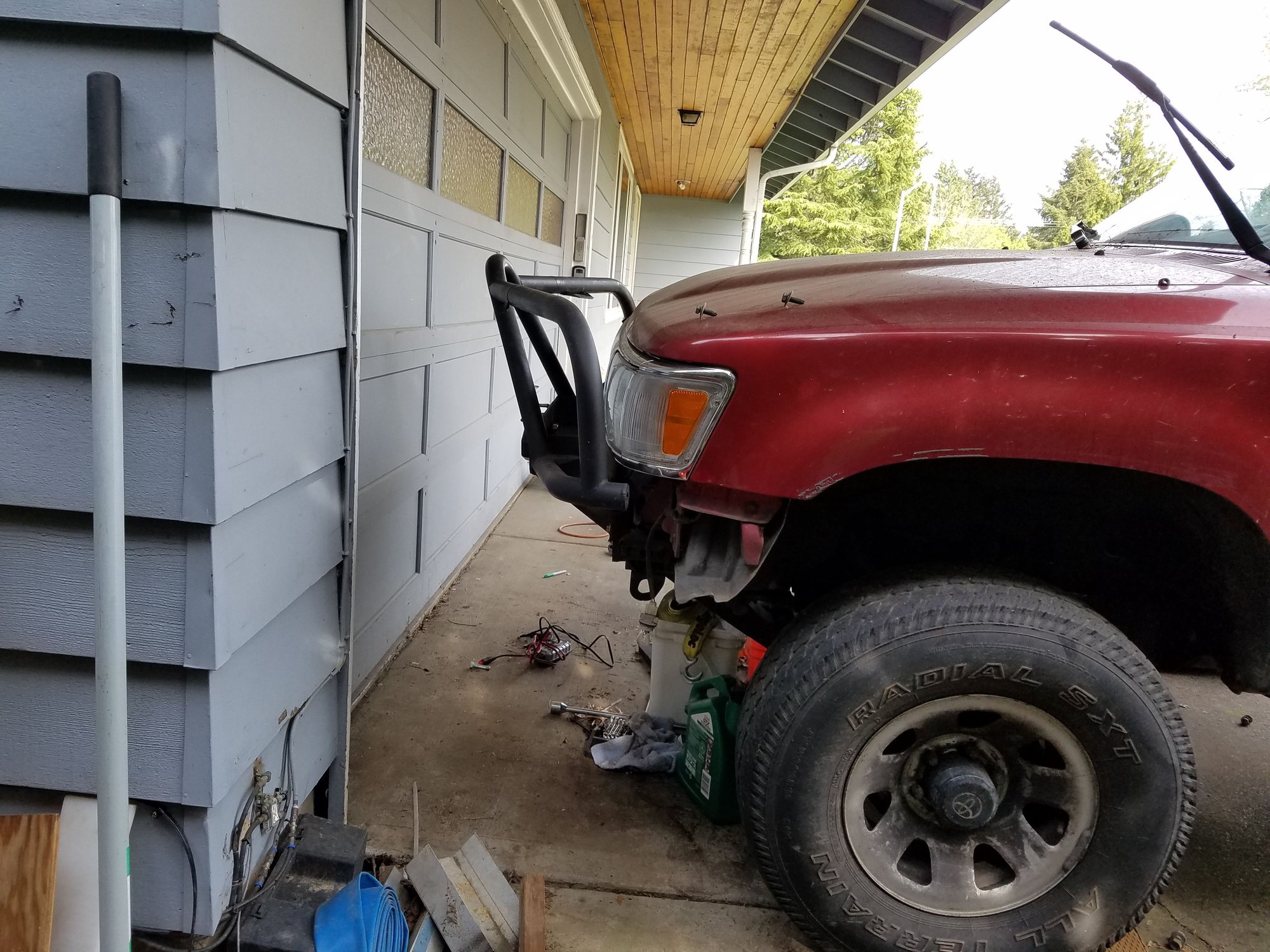

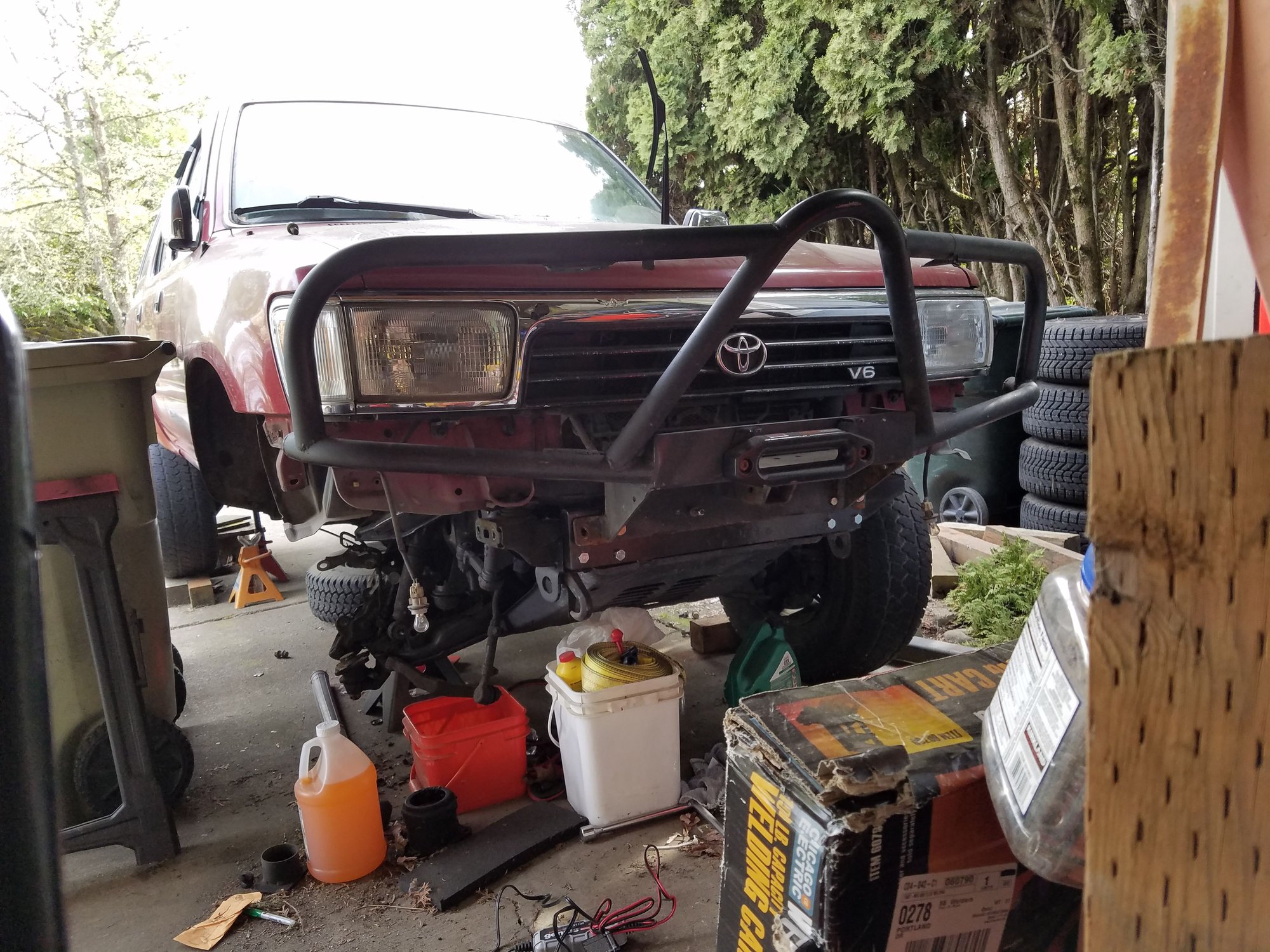

OK, still not sure if I am gonna keep the Trekker bumper but had some time to continue the recycle experiment
Here is it with the bumper mounted about 1 3/4" higher
I am thinking extending the bottom tube a few inches towards the fender well might help the looks department.

That does look good. If you extended it like you are saying it would be better. Nice work!

Good to be back! I like the bumper on there. Hot seems like the hoops for the lights aren't gonna provide much protection. Maybe cut those off and make new hoops that wrap the corner a bit?

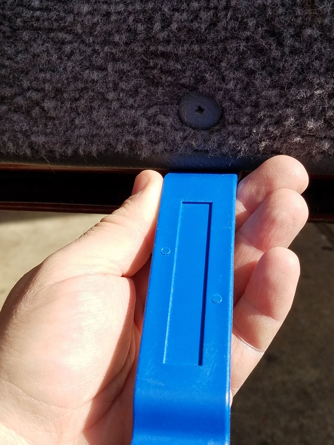

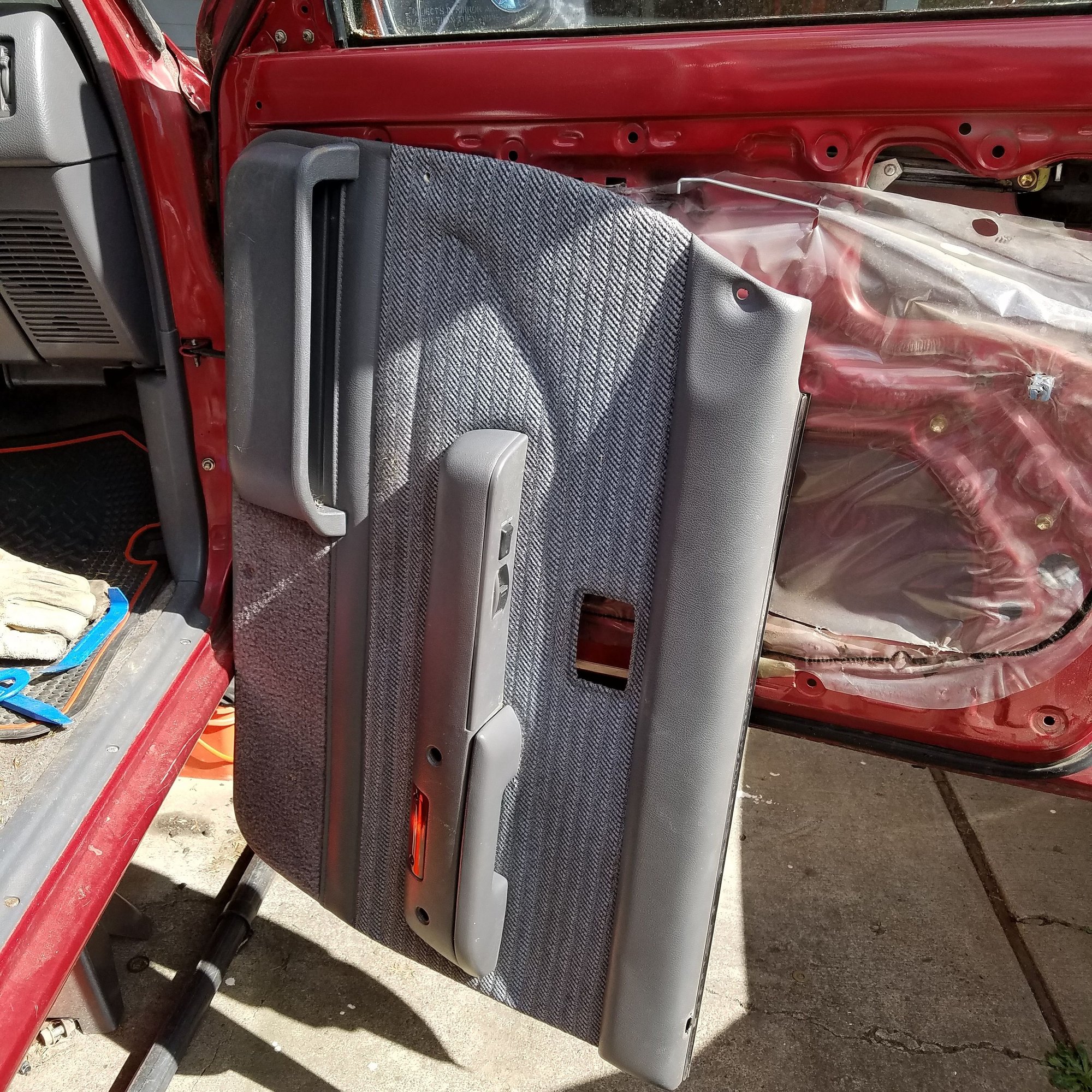

So one thing that bugged me since I picked this hunk up was that that passenger side door key cylinder didn't work. Had today off so decided to fix it.
Some simple cheap Harbor Freight pry bars sure make removing panels easier
Too lazy to pull the wiring harness
$35 at the local locksmith and I have a working passenger side lock
And nice thing I didn't know, passenger side lock will unlock all 4 doors like the driver's side
Oh if you ever take one of these apart have a magnet handy, the door handle housing acts as retainer for the little internal door and outer cover for the cylinder. I took the cylinder out from the inside and little parts dropped inside the door..PITA lesson

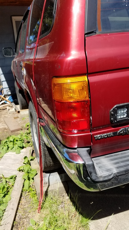

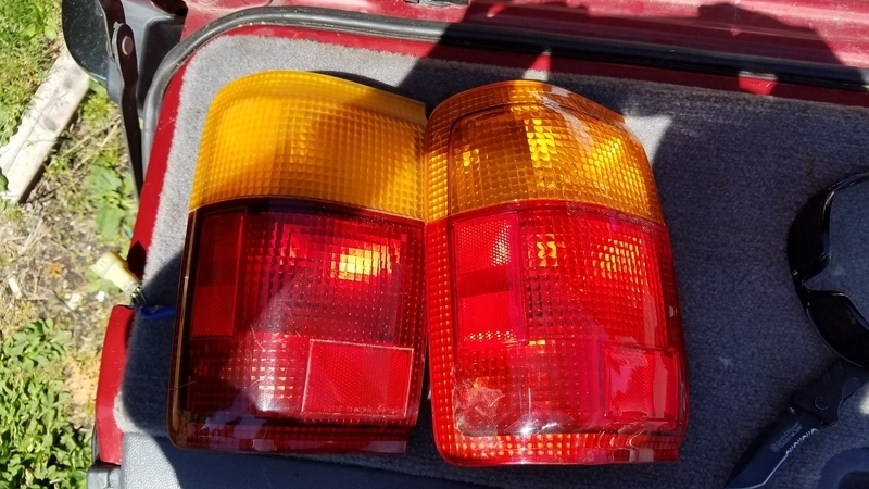

Been slowly selling old extra parts and used part of the proceeds to pick up a set of ebay cheapie replacement tailights. For what some guys were asking for faded used crap i now have nice bright lenses.
old on the left, new on right
pretty happy with them, and you have to like 5 minute installs

Old May 6, 2016 | 05:49 PM
  #177

I dunno, that looks awfully sparkly...

I think it looks good. I wish there was a replacement like that with a back up light in it like the trucks have. For those of us with spare tire carriers this would be an awesome swap.
when it comes to having something help the distracted person behind me stop better I will take sparkly
I haven't had a 3rd Gen truck tail light in my hands before but they do have a built in back up light. I don't see a reason why a set couldn't be adapted to a 2nd gen 4Runner
http://www.ebay.com/itm/89-95-Toyota...pXAcF8&vxp=mtr

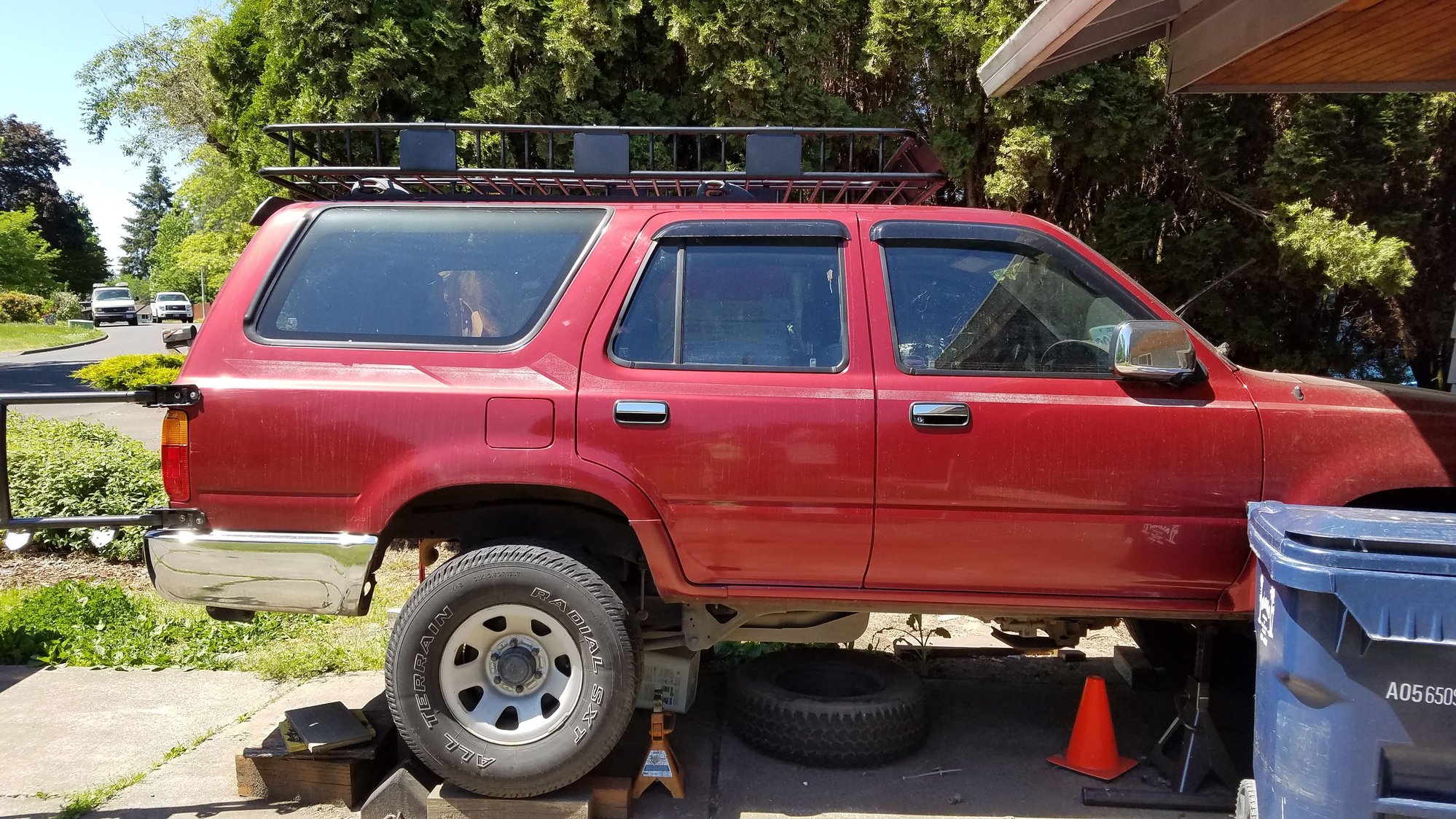

Wasn't sure if I was gonna do the whole roof rack deal but this was scored cheap at a garage sale this morning.
I will probably end up extending the factory luggage railso forward for a 3rd cross member
