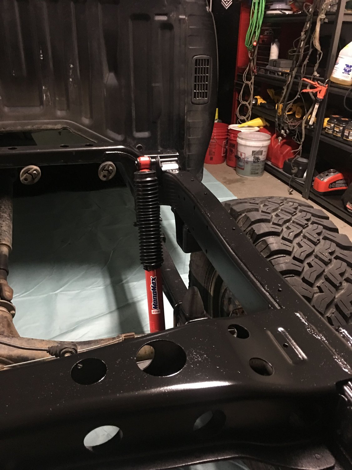

Swapping the bed and pulled it out to pressure wash, prep, and hit with a coat of POR15.
I don’t recall if these are stock... ?
I don't recall my 95 t100 single cab 4x4 having shocks that large. I had o buy a cheap set for now. But the ones took off didn't look that big at all.

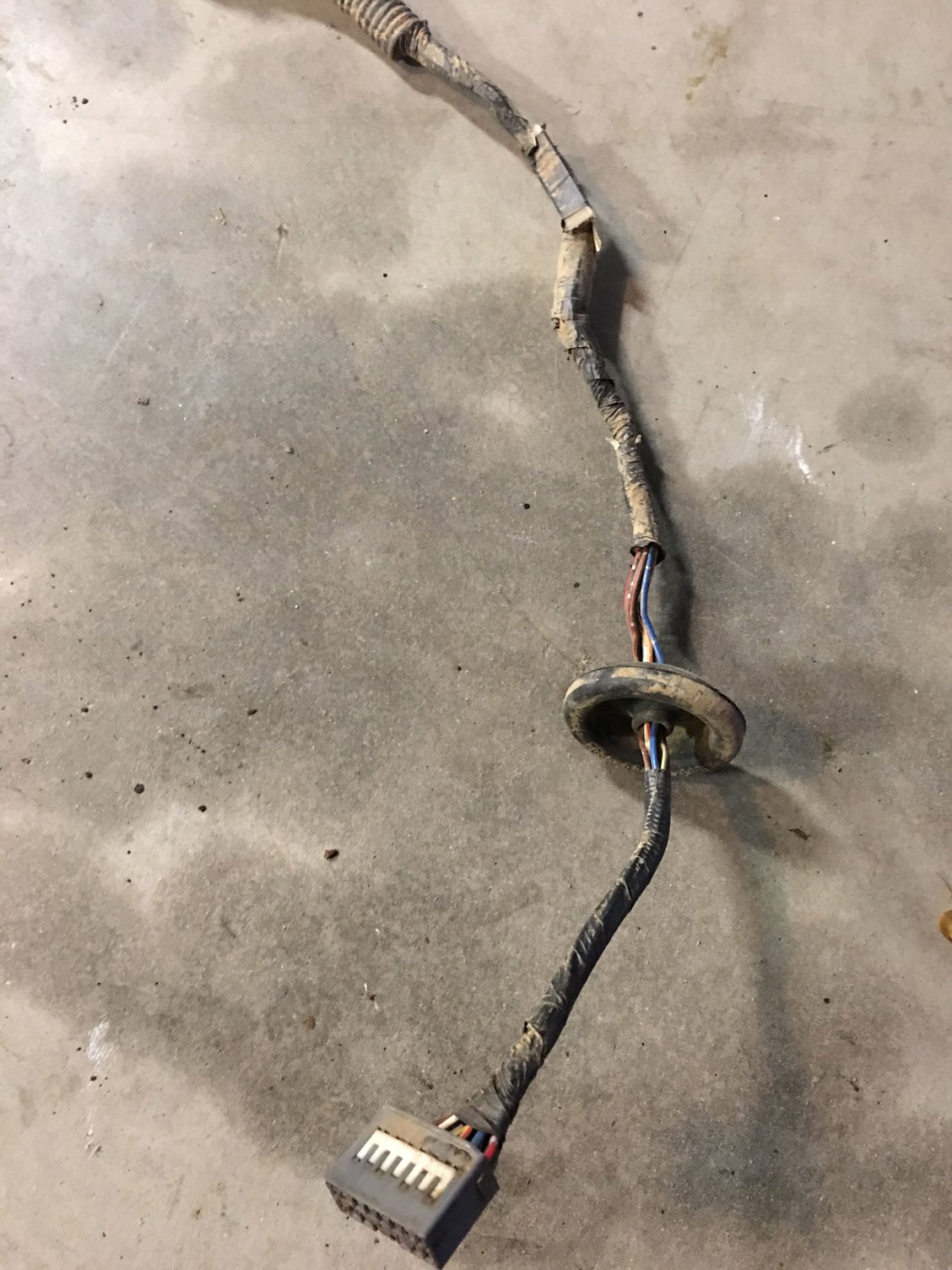

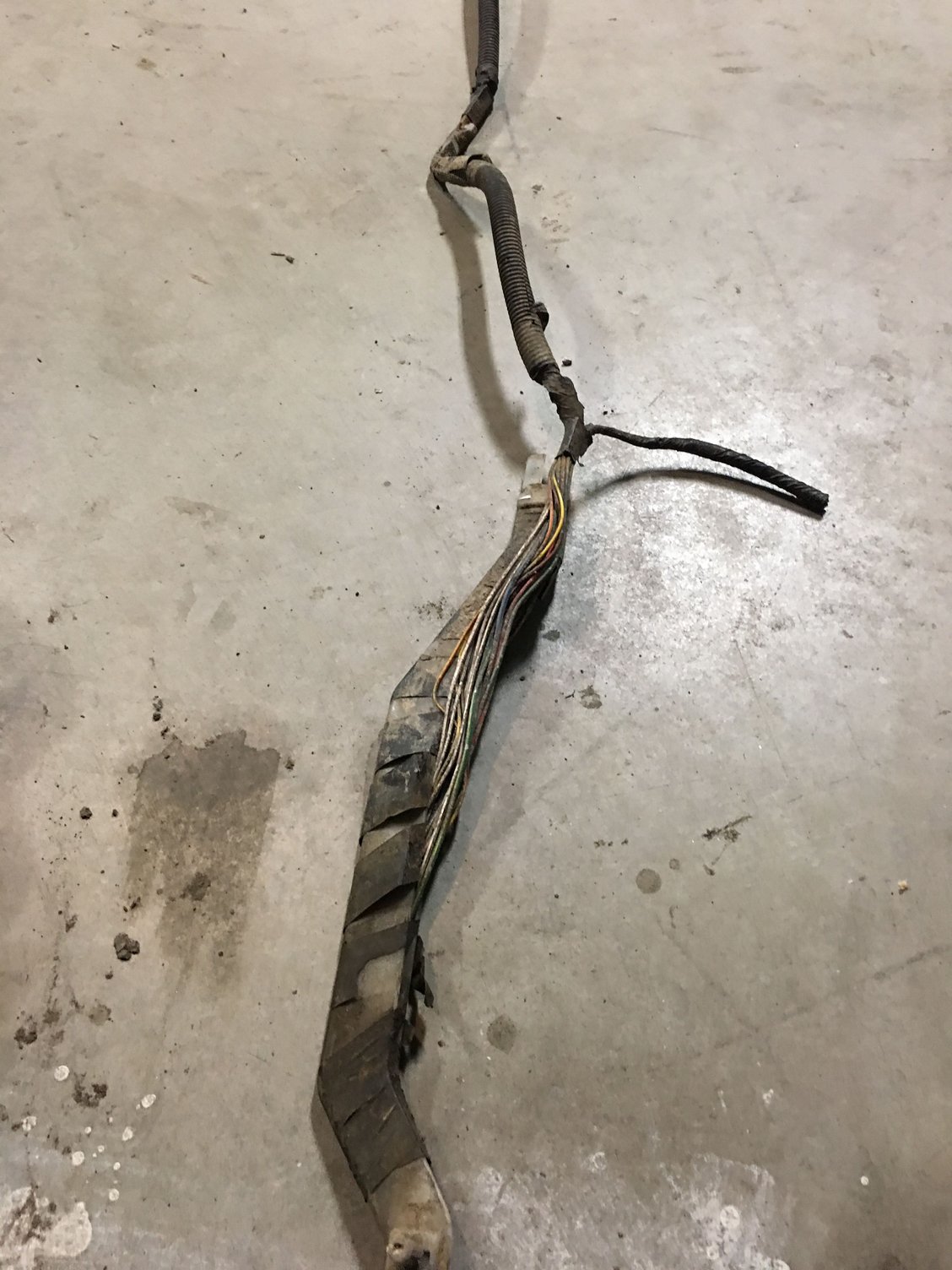

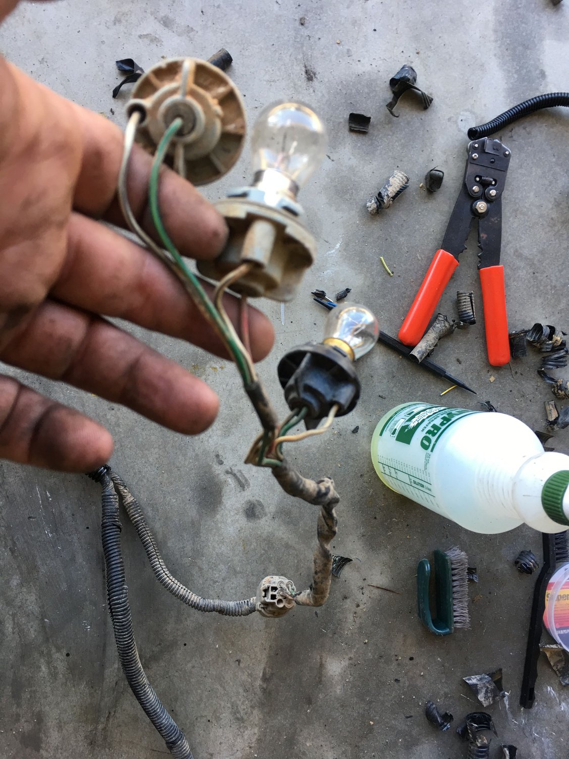

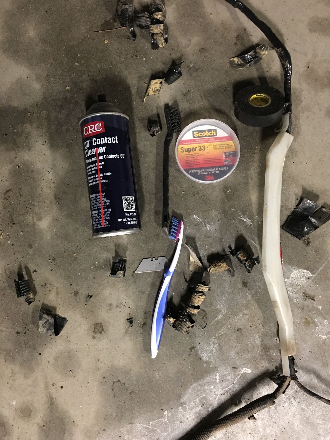

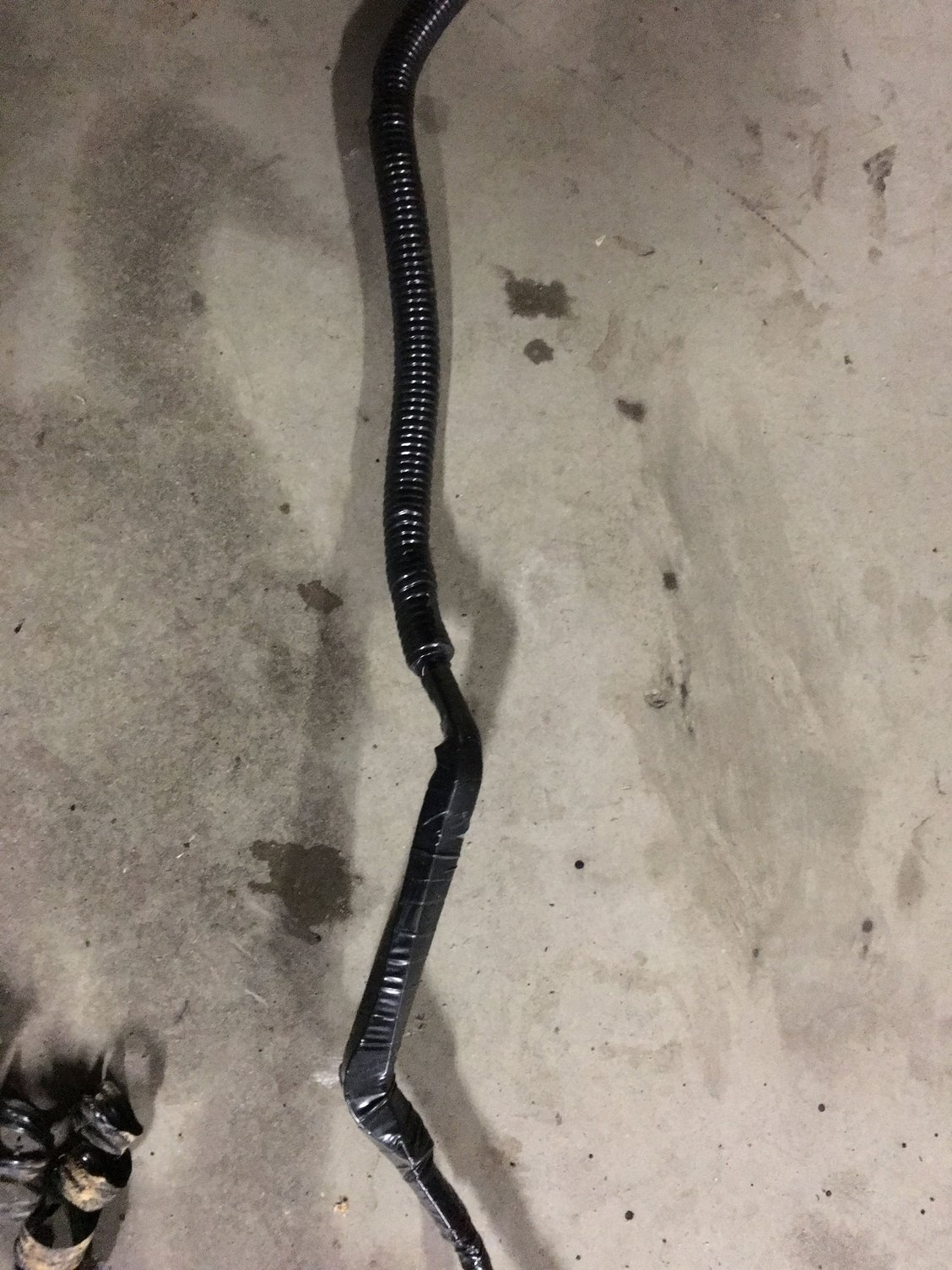

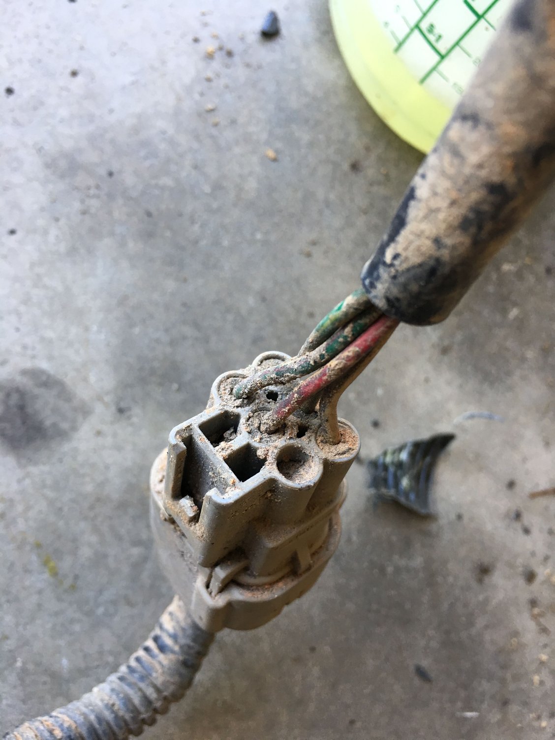

In the mean time, tonight I’m going to restore the rear harness
This is not my favorite thing to do on a Saturday night, but it’s the only way it’s going to happen. Lol.

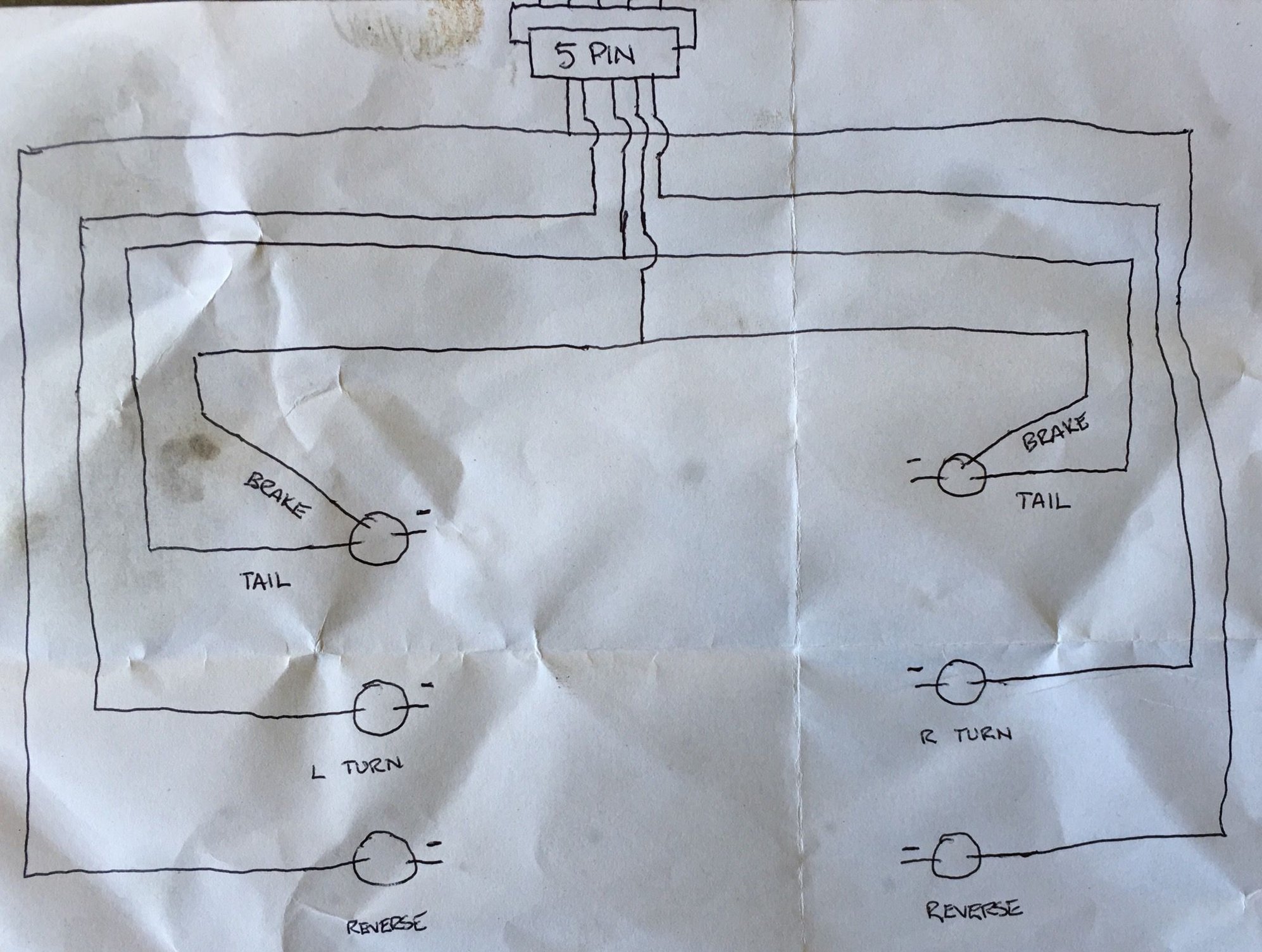

Matching trailer
At this point is just makes sense to make a matching trailer for the truck.
I sitting here looking at a spare rear harness that has the connectors I could use to have fully functional lights (including reverse) by just not throwing away my old harness and I have an extra bed now sitting in the back yard.
So, why the hell not, right?

Like this:
Did I overlook anything that anyone can see right off the bat?

From: SOCAL

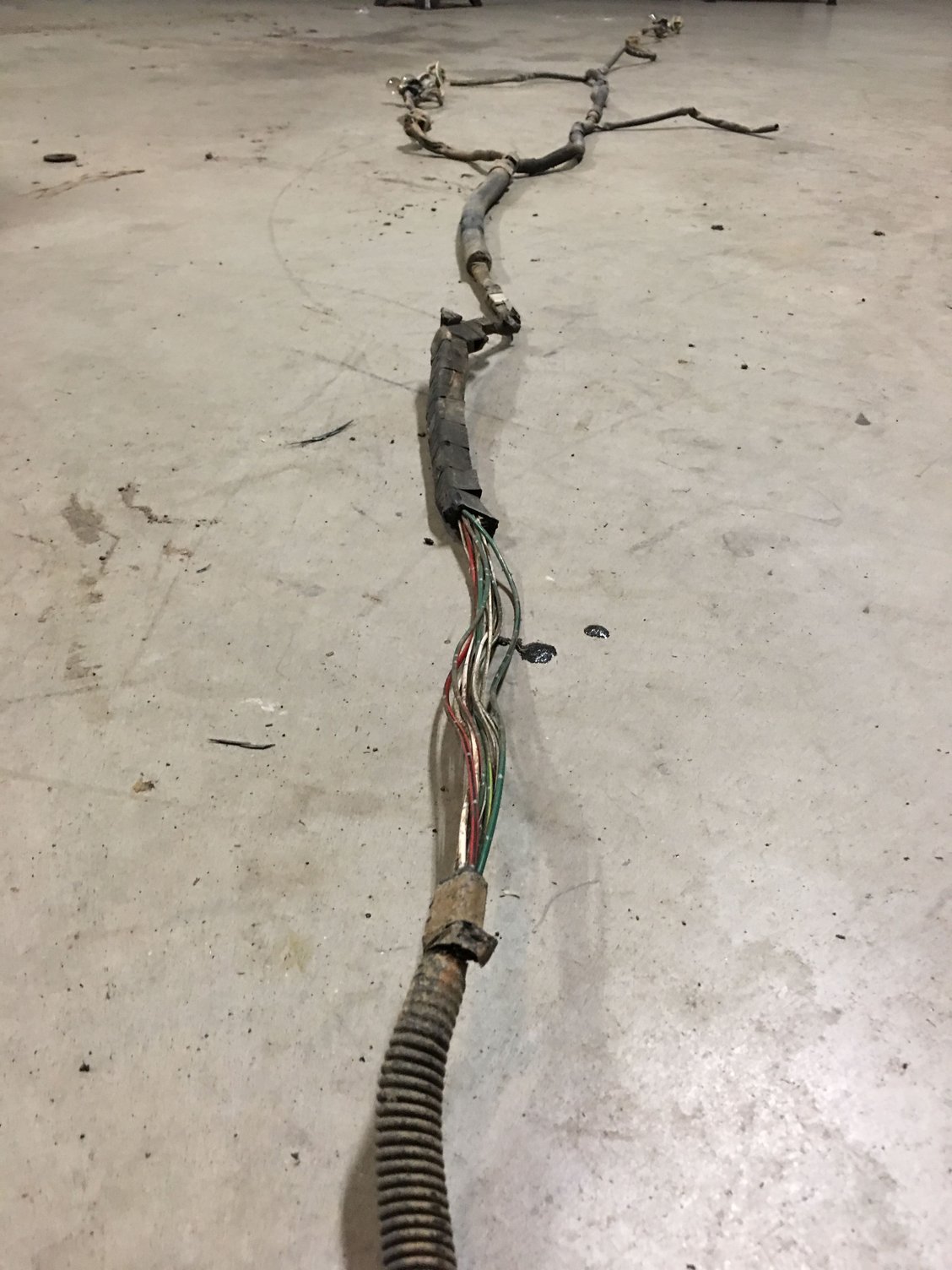

Talking
Great job on the wire bundle, ( you did check the continuity didn't you? )
Truck looks good in the last picture, Oh, an' I use the same brand of potty pads for my puppy.

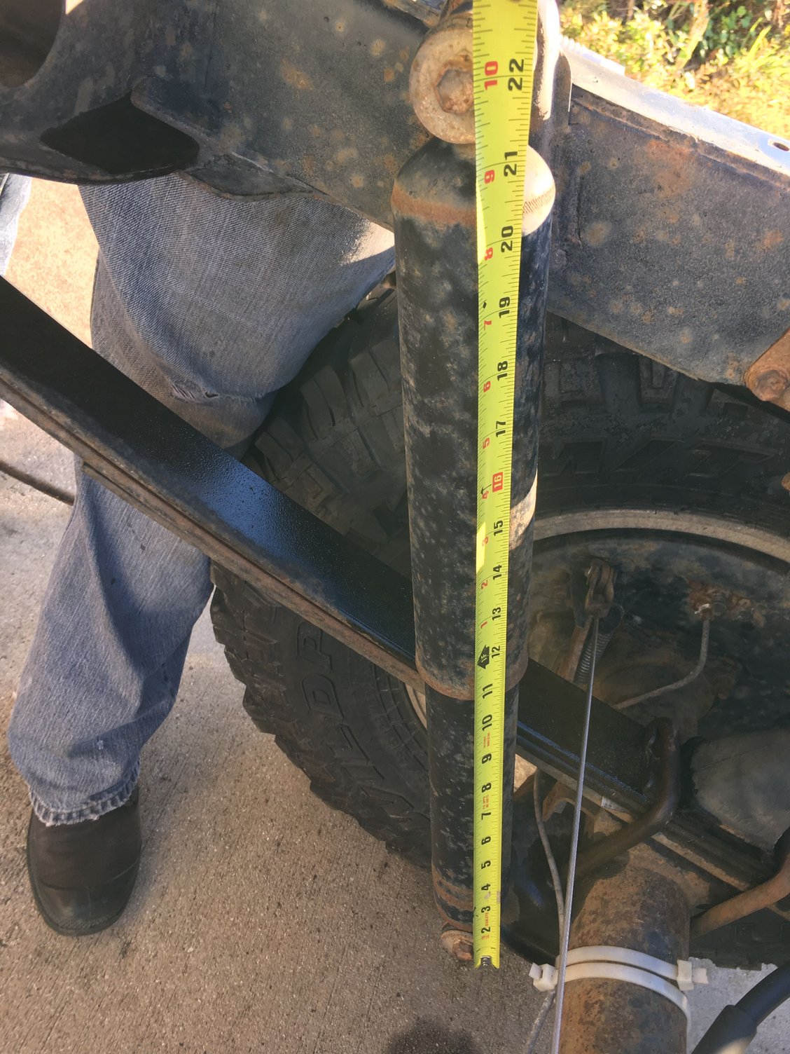

Rear shocks
Came out of the field today.
Got these shocks from RockAuto already set up for a 2” lift.
Bolted right up. No issues. Great deal.
I’m pretty good with wires. I don’t think I need to check them.
I’m willing to roll the dice.

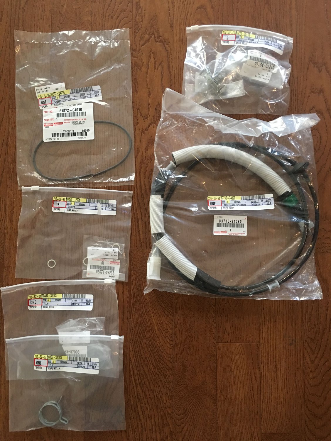

More parts came in..
3rd brake light gasket
Fuel injector rail gaskets
Lower radiator hose clamps
License plate light sockets
and....
Speedometer cable assembly

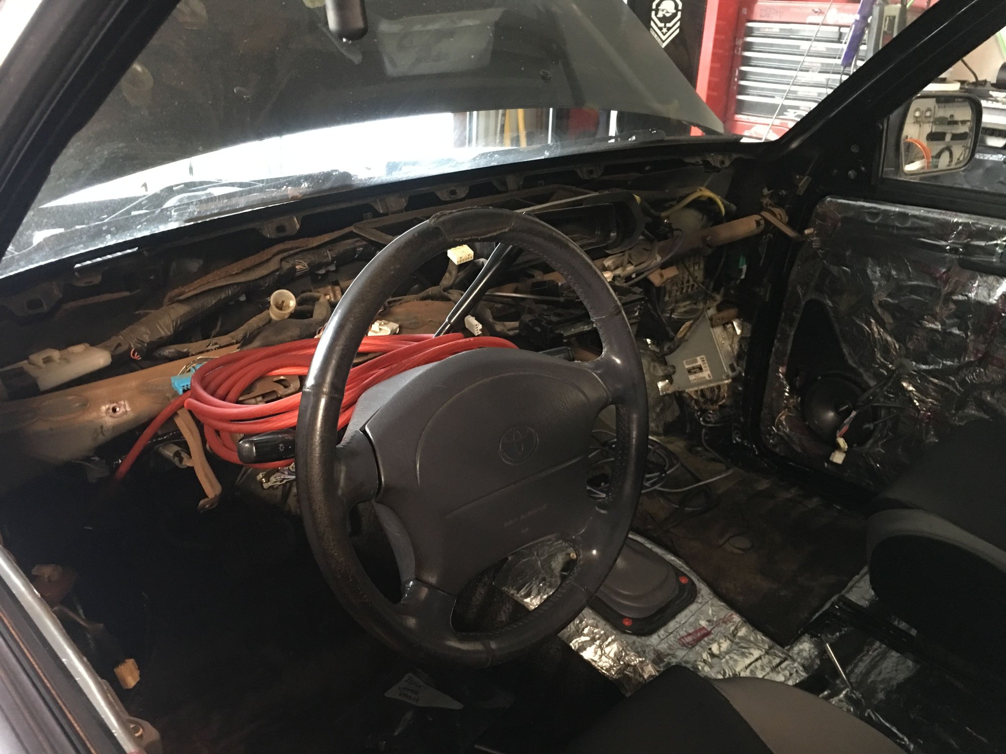

Tackling the dash
Since I was under the dash for the steering shaft and the speedometer cable needs replaced, I figure I might as well just pull the dash, clean it up back there, and route the stereo power cable, RCA cables, and hands free microphone, etc...
It’s ugly back here too....
No shortage of work here.

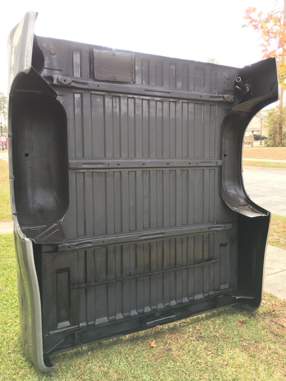

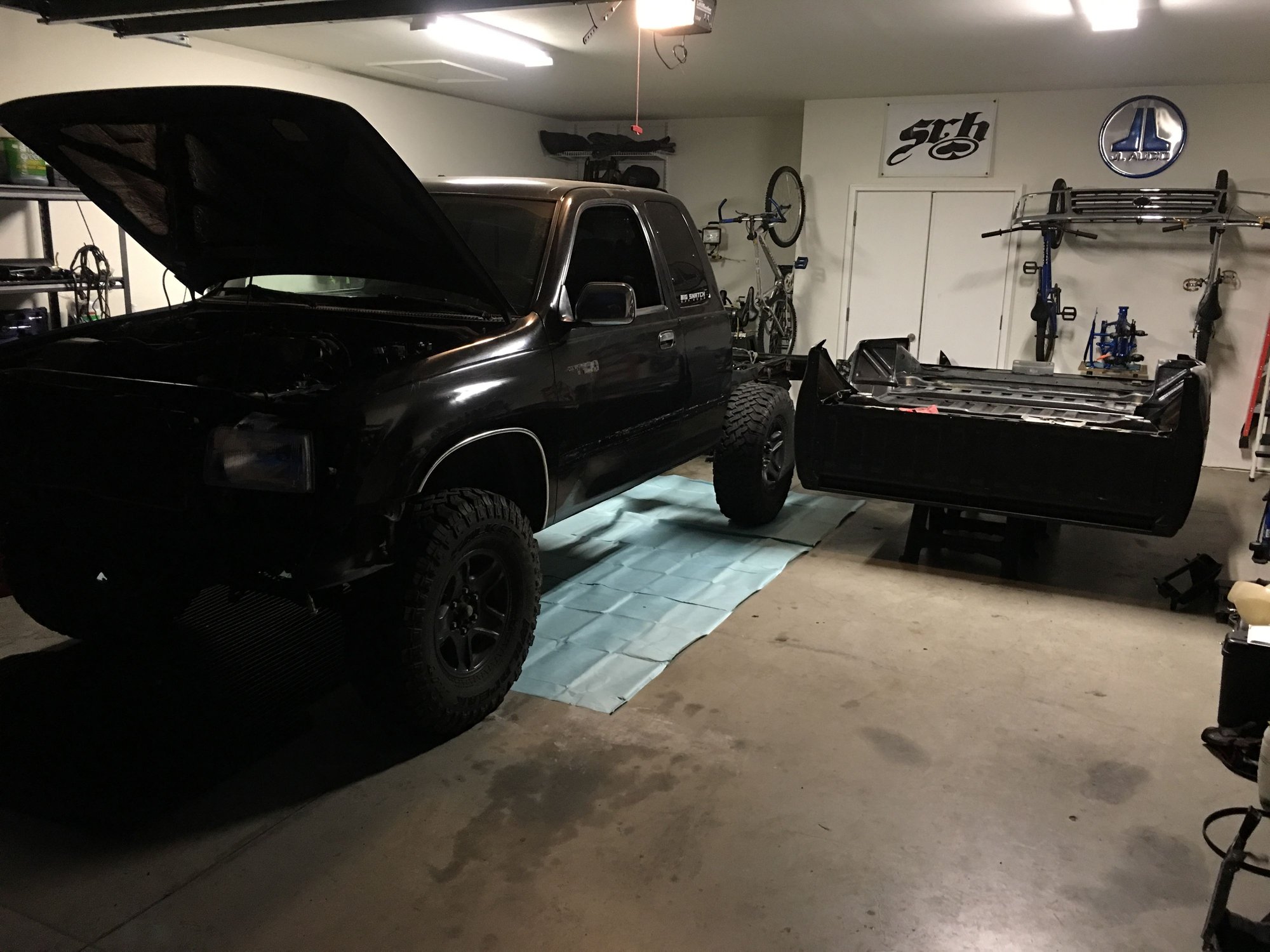

Underside of bed done.
While I’m skinning my knuckles in the dash, the bed is outside drying 3 coats of rubberized undercoating after 2 solid days of cleaning and degreasing.

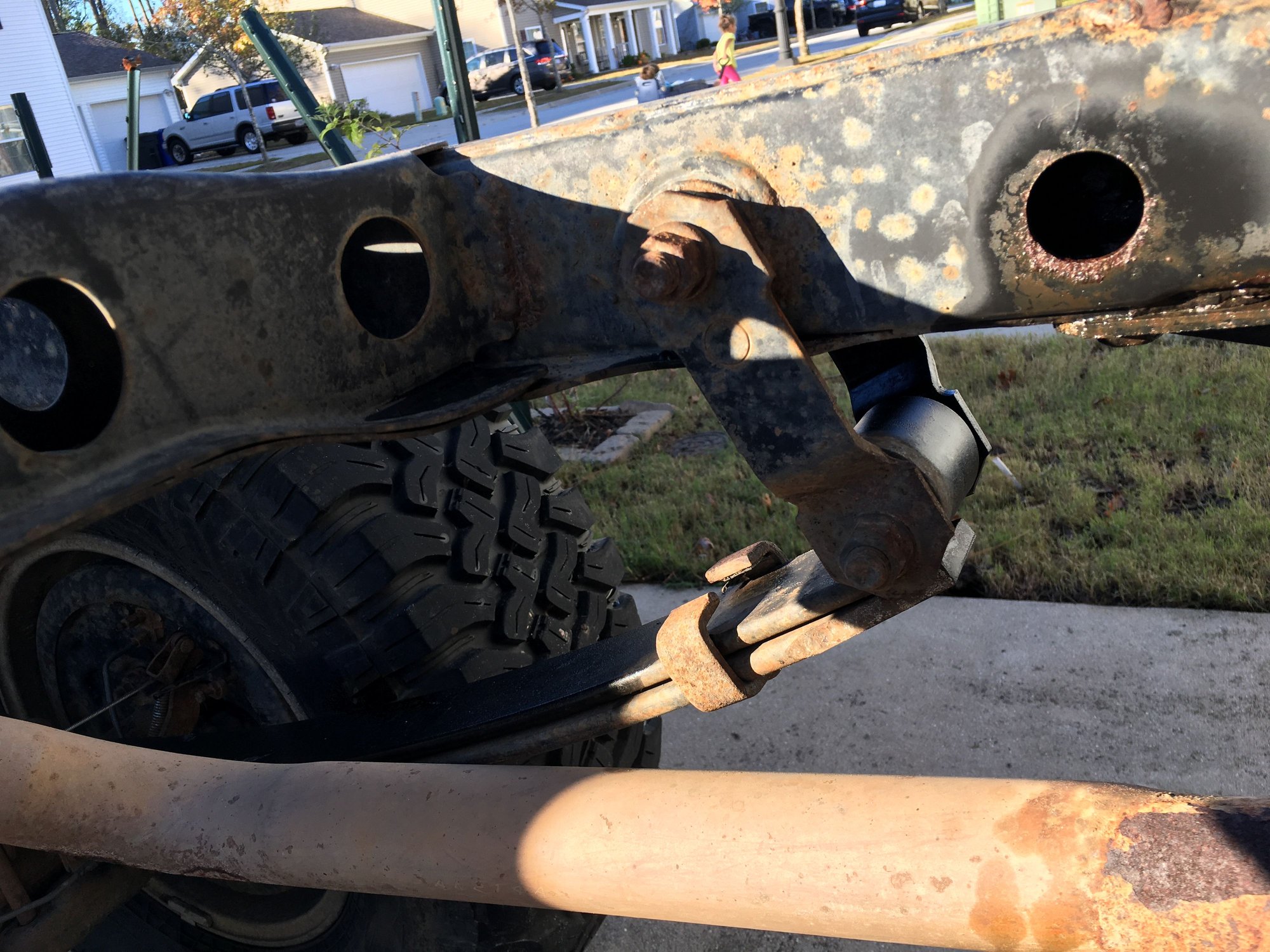

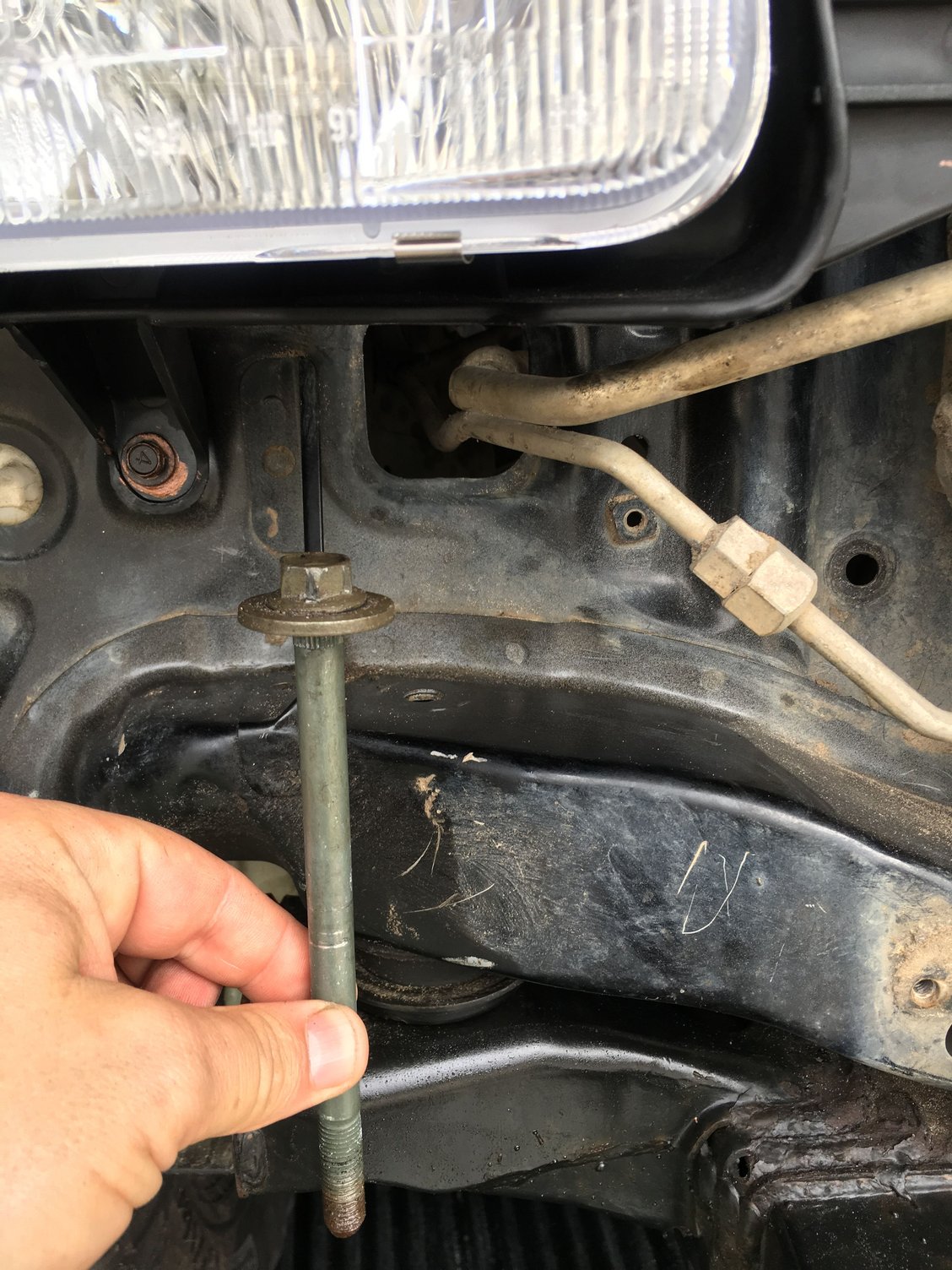

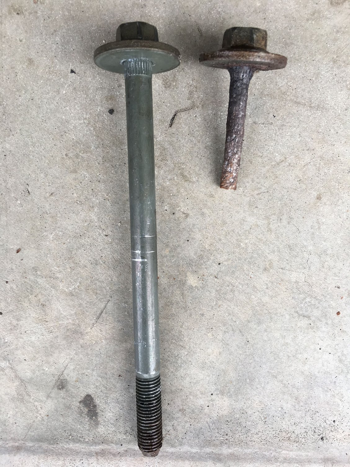

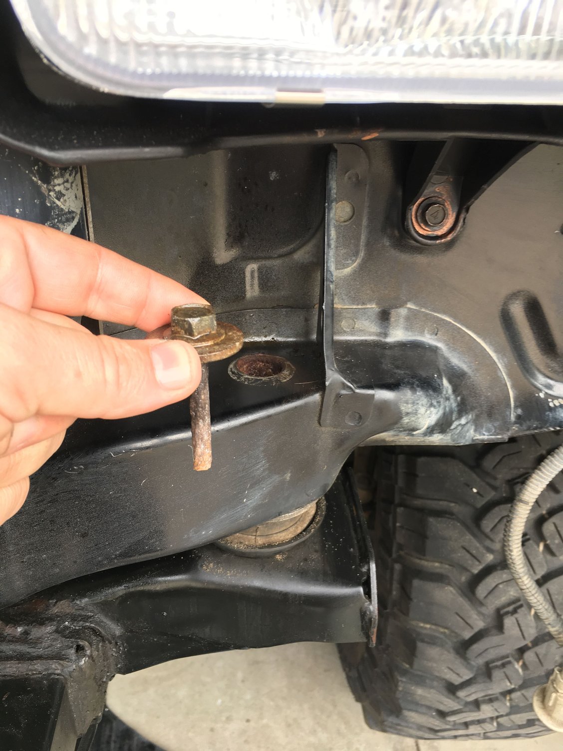

Houston we have a problem.
Taking the body mount bolts out to install the body lift.
Seeing as how the coolant overflow tank sits DIRECTLY above the drivers side bolt, I’m thinking this isn’t the only truck like this.
Look at the difference between the drivers side and passenger side.
Also, look at the hole it goes in.
The frame around the bolt is completely corroded as well. The rotten hole is only about 1/4” smaller than the large captive washer in top.looks like I’m going to have to weld a plate in to reinforce this.
DAMN IT.

Passenger and Driver side (respectively)
