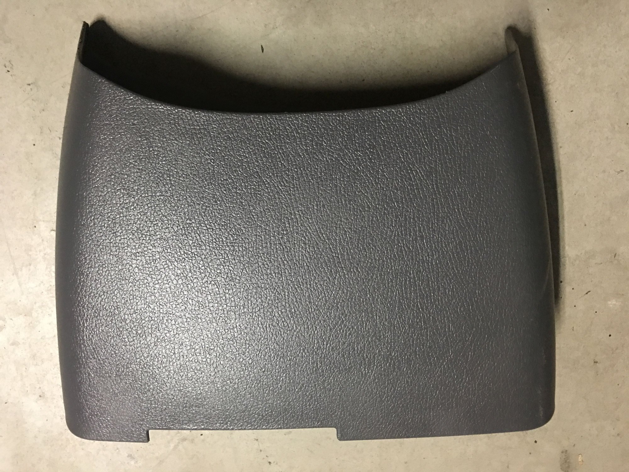

Look at how beautiful the new one is.
I think I’m shedding a tear of joy right now over this...

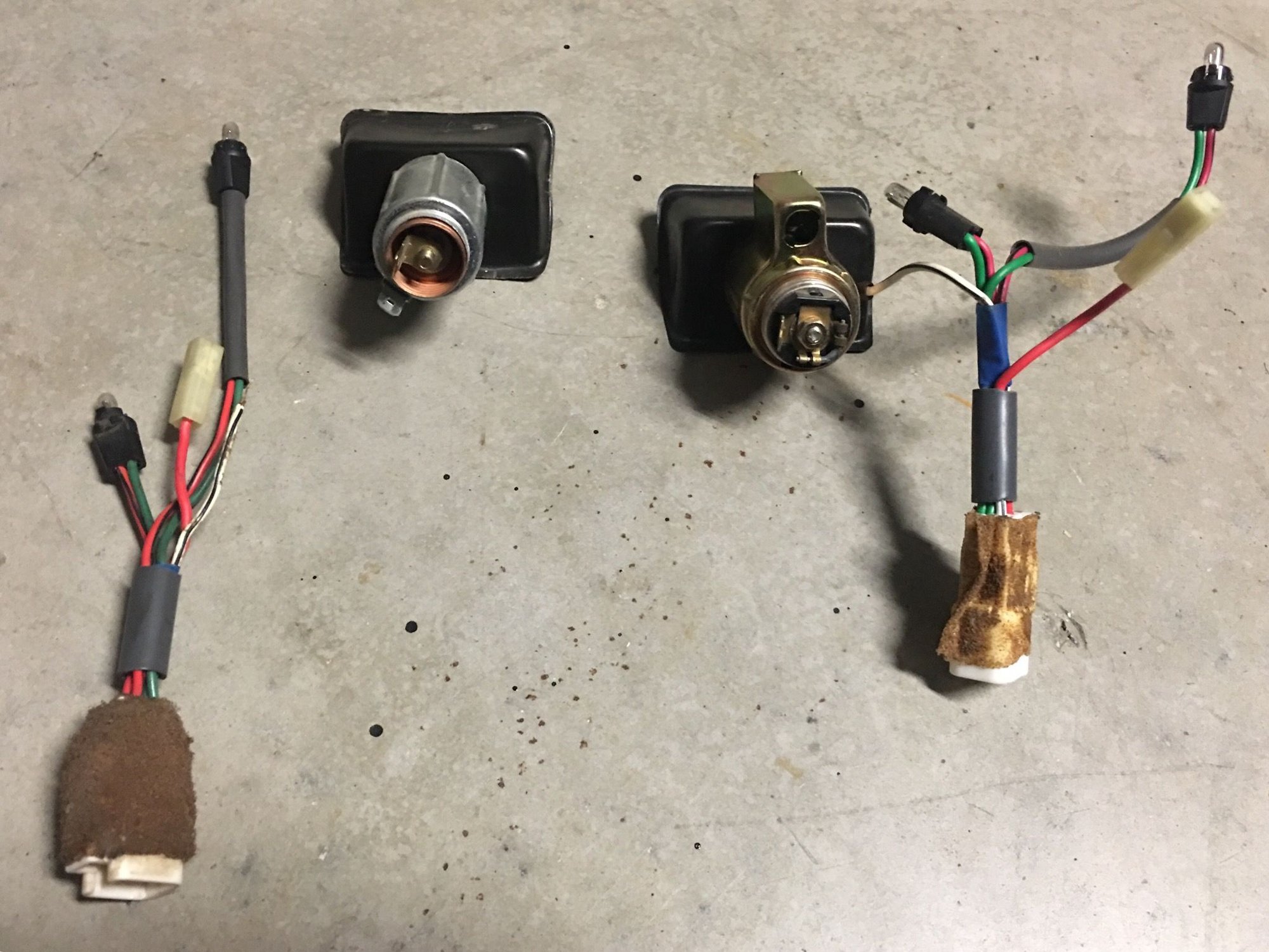

Lighted vs non-lighted lighter assembly
Here is is folks. Side by side.
The one on the left was in the truck and was making me pull my hair out with the extra bulb that had no home.
like mentioned above, the PO switched it out and ruined my summer because the online diagrams of these things are just SOOOOO bad.
The one on the right is gorgeous.

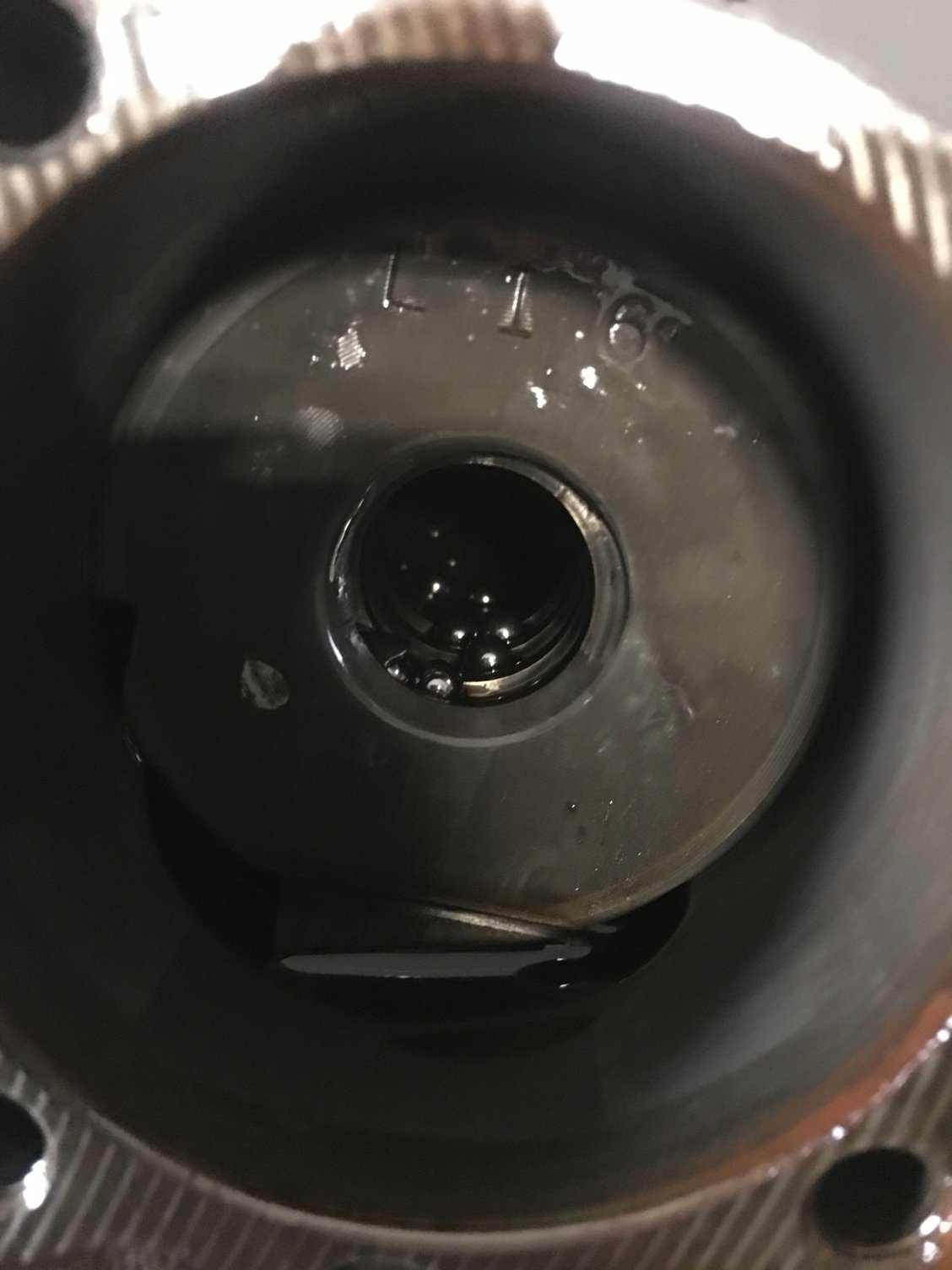

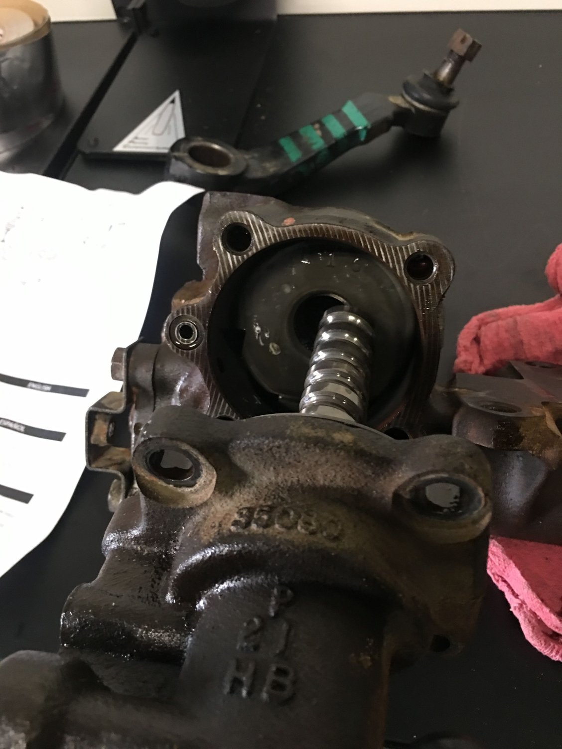

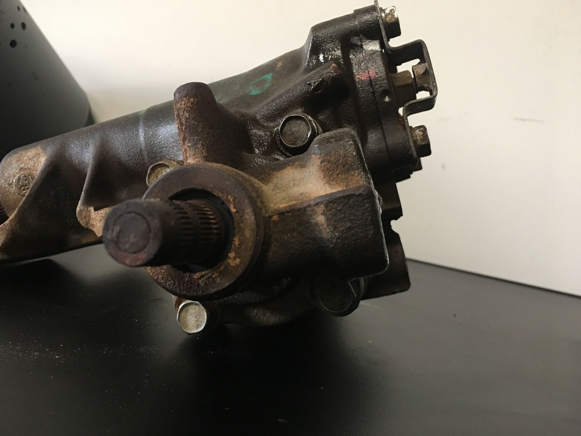

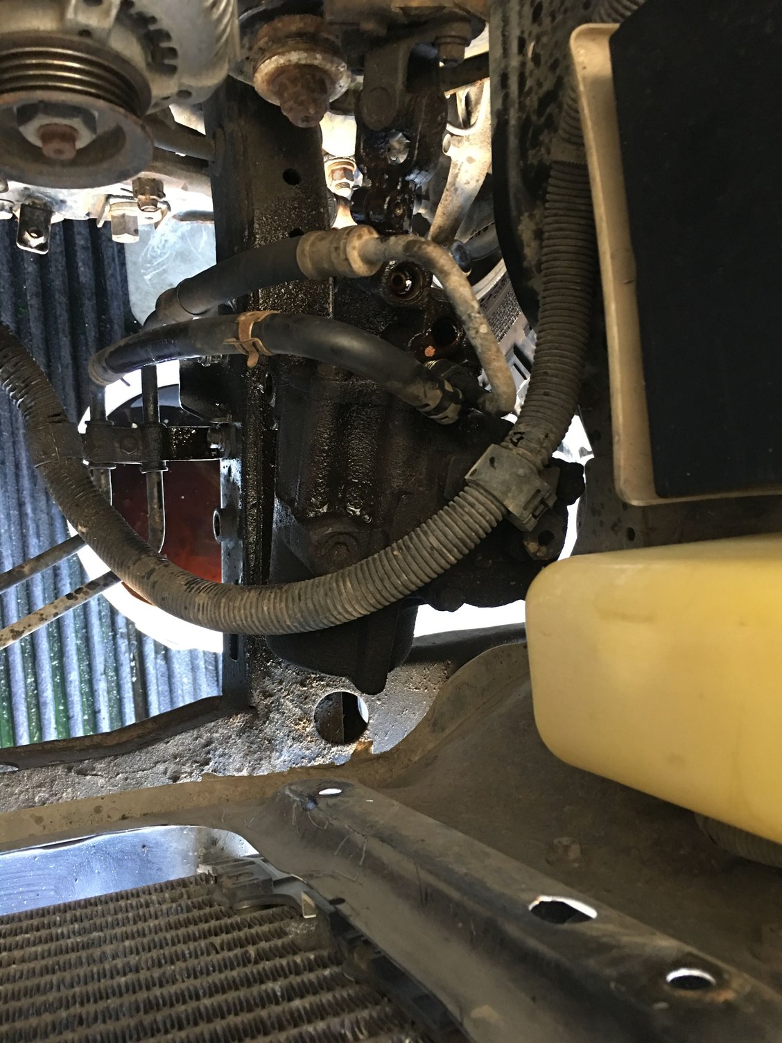

Steering gear rebuild
Before.
The majority of this fluid was on there before I disconnected the hoses. Probably just a bad o-ring or seal in the nose. Looks like it has been leaking from the shaft output seal.

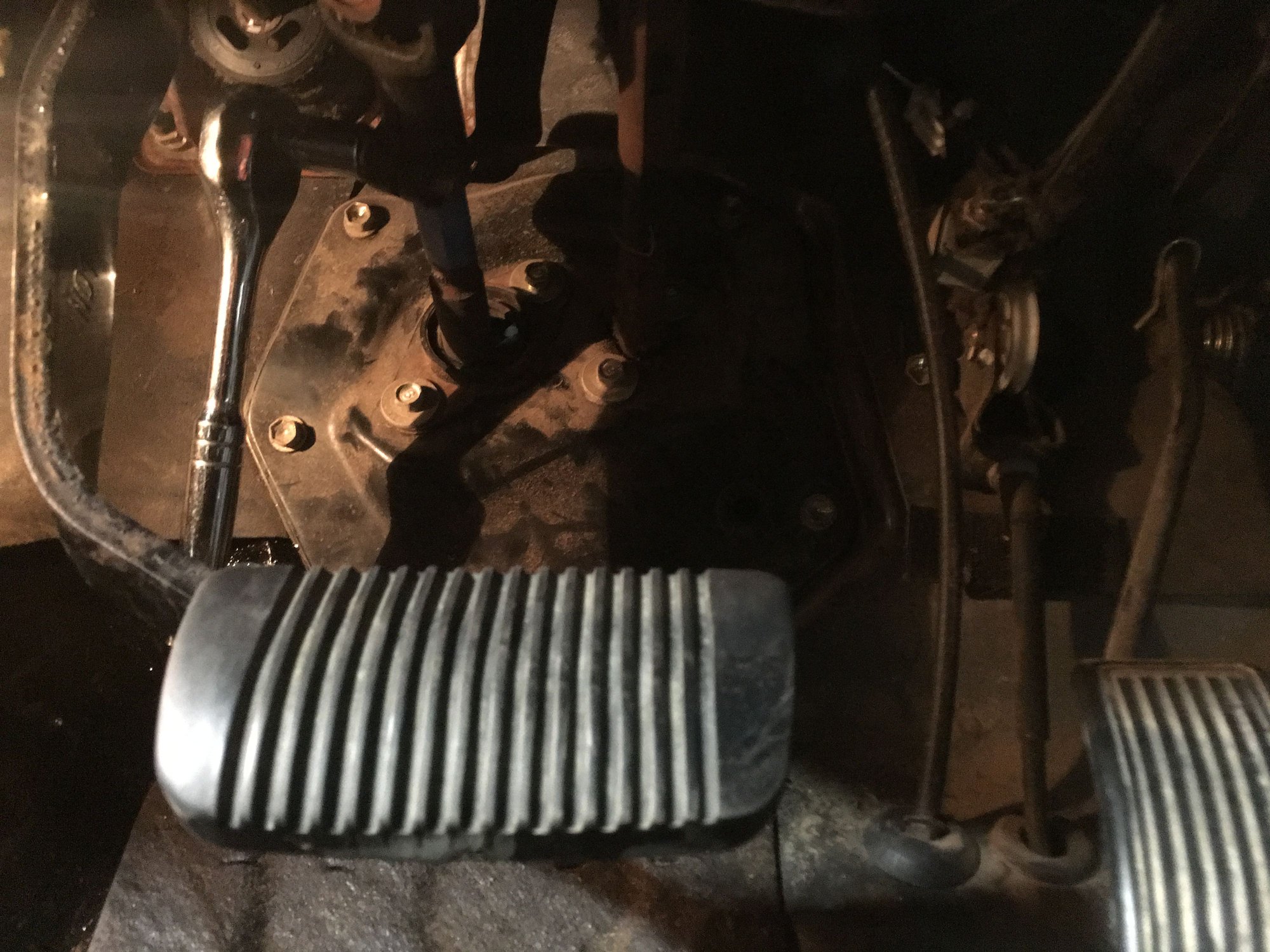

Body Lift Question
The bed is off.
The steering shaft is off.
I think I would be foolish not to put a body lift on while it’s already like this.
1” ?
1.5” ?
2” ?
At what point does it start requiring more than just a steering shaft adjustment and fan shroud bottom delete?

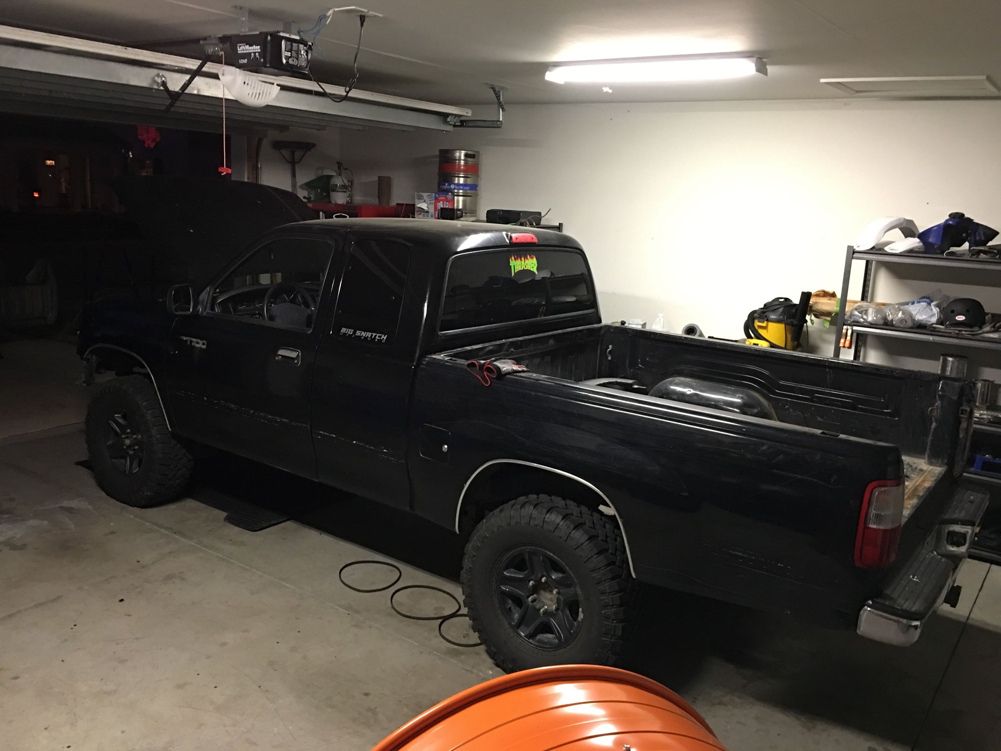

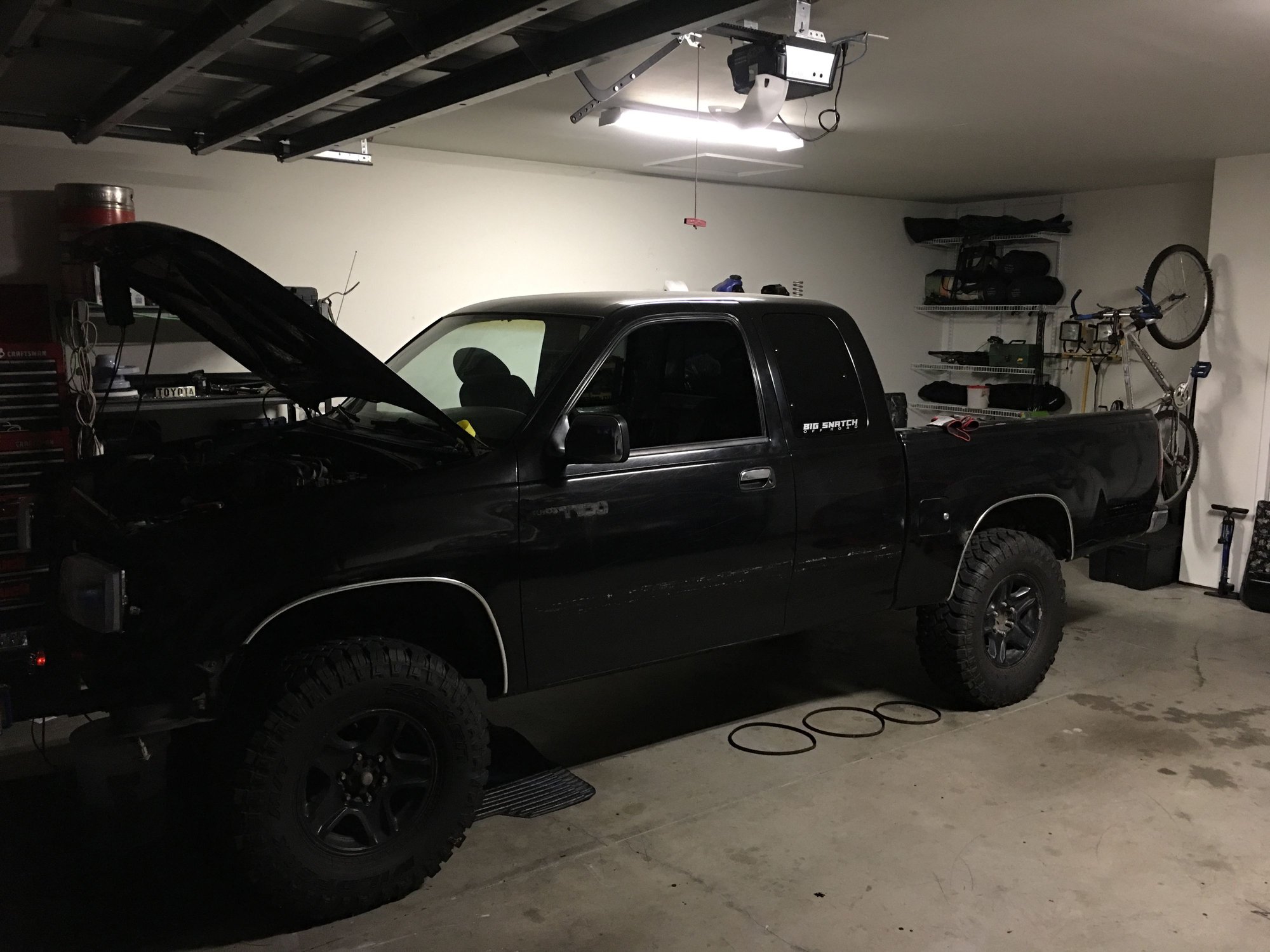

Current exterior pic
I don’t think I’ve put up an exterior shot since I put the new rear window in.
Also, had the pop-out windows tinted as well.
Waiting to replace the passenger side window switch (and having the running parts back in) to get the side windows and windshield done to match.

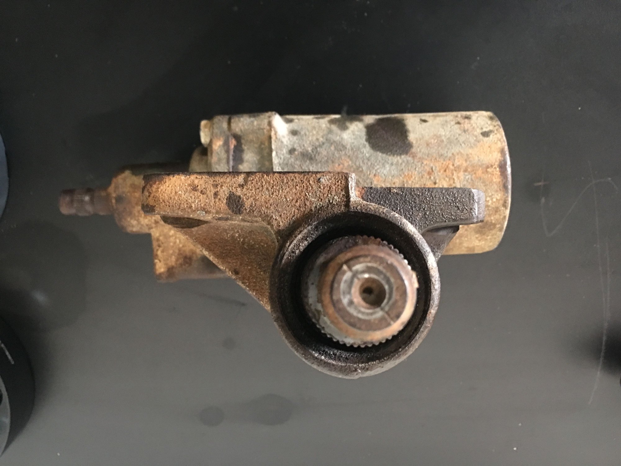

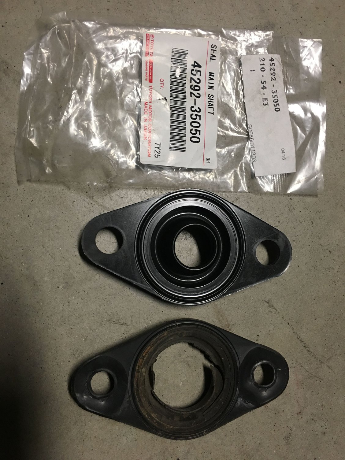

Steering shaft seal
While the steering gear is out, I had to replace this seal.
If you have hot air blowing on your balls when you’re driving you either have wife material or you need one of these.

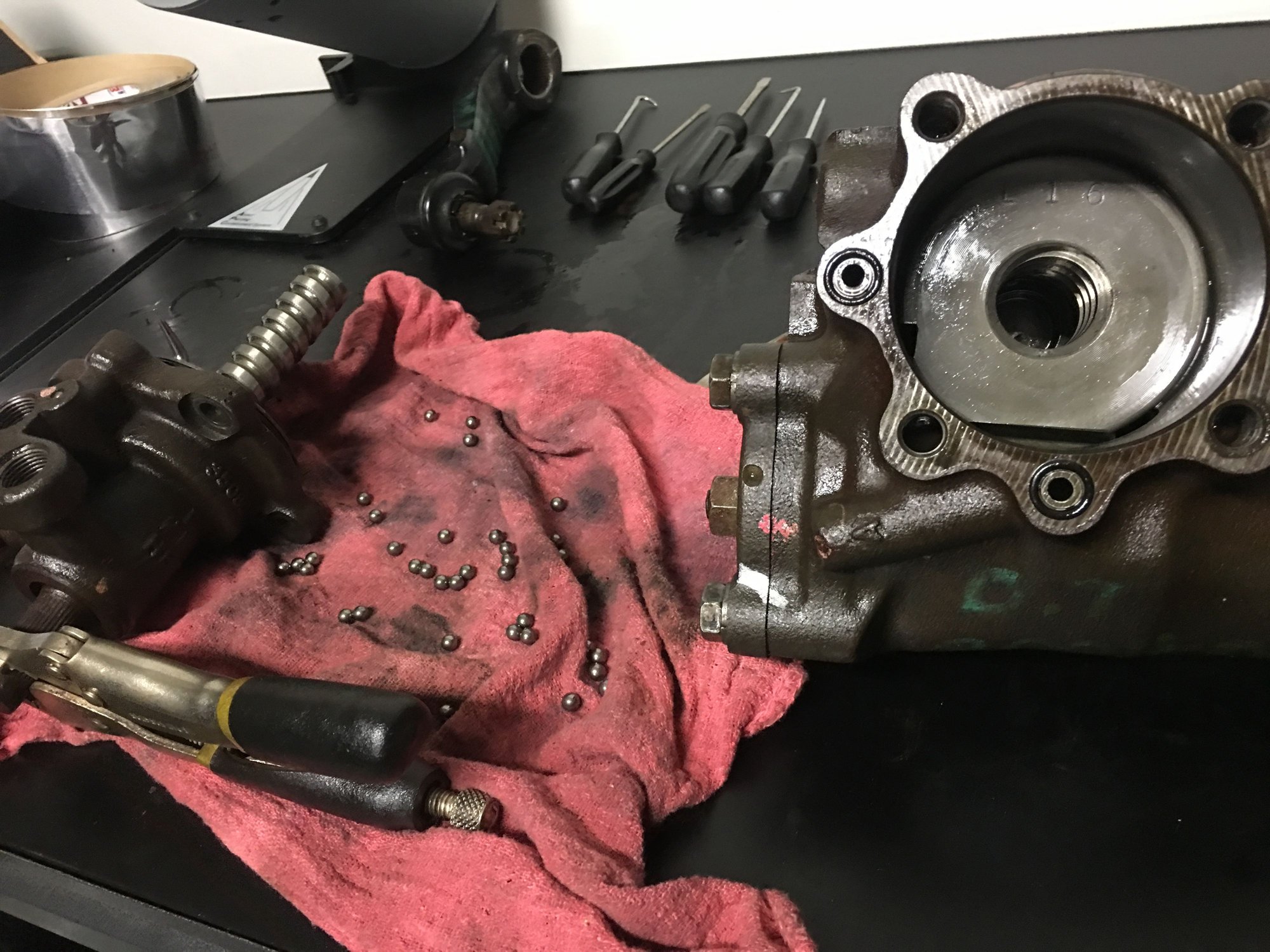

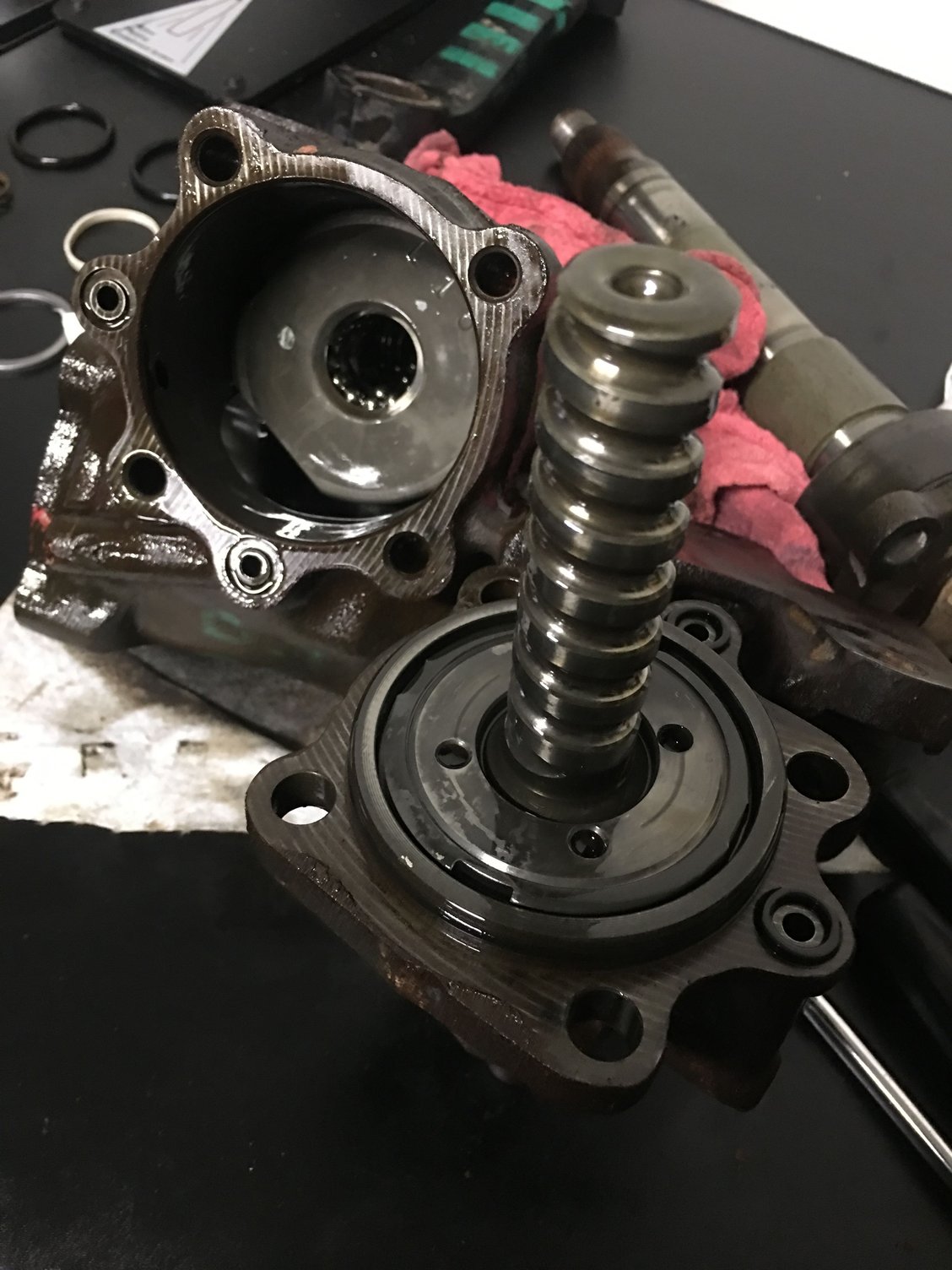

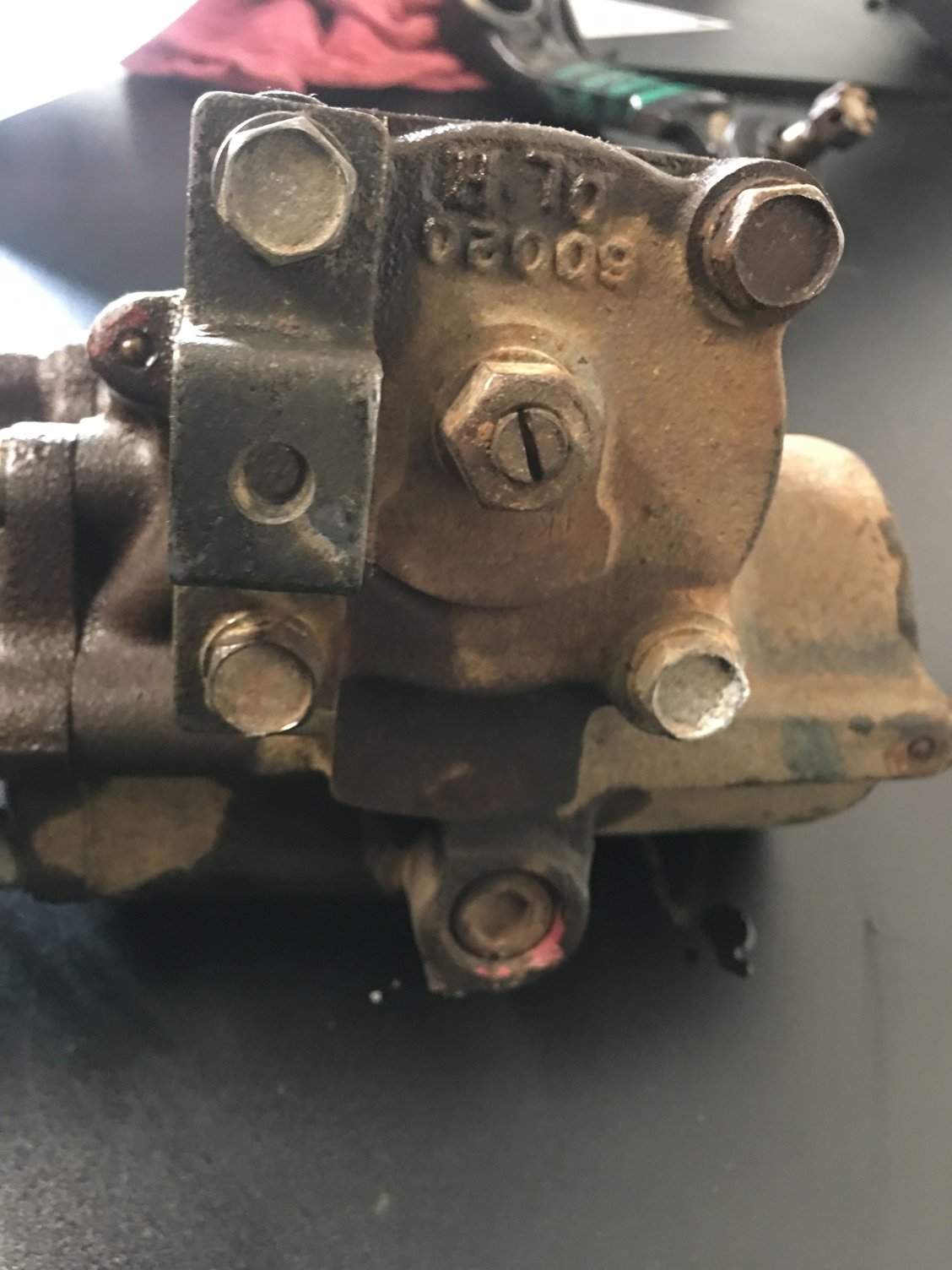

Complete disassemble of steering gear box.
Not recommended. lol.

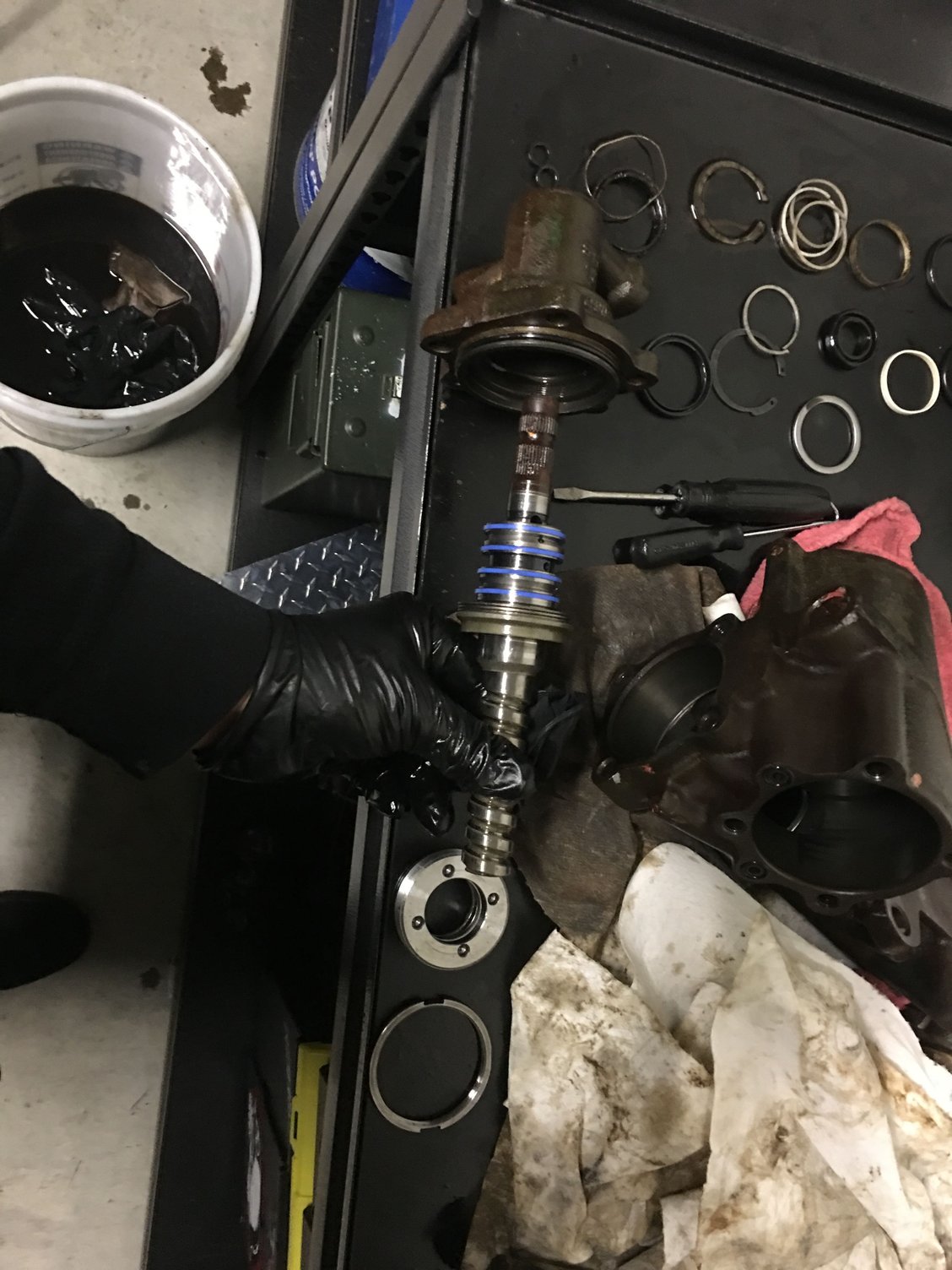

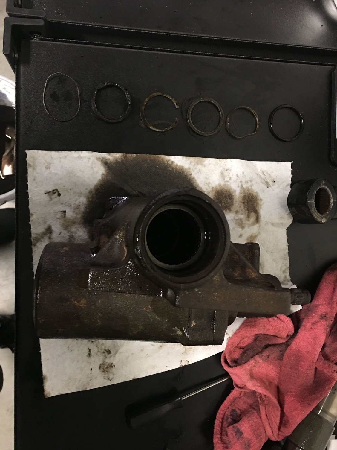

OH, my. look-it what he did. That looks like a fun time. In fact I could watch it again......Yep It's still cool

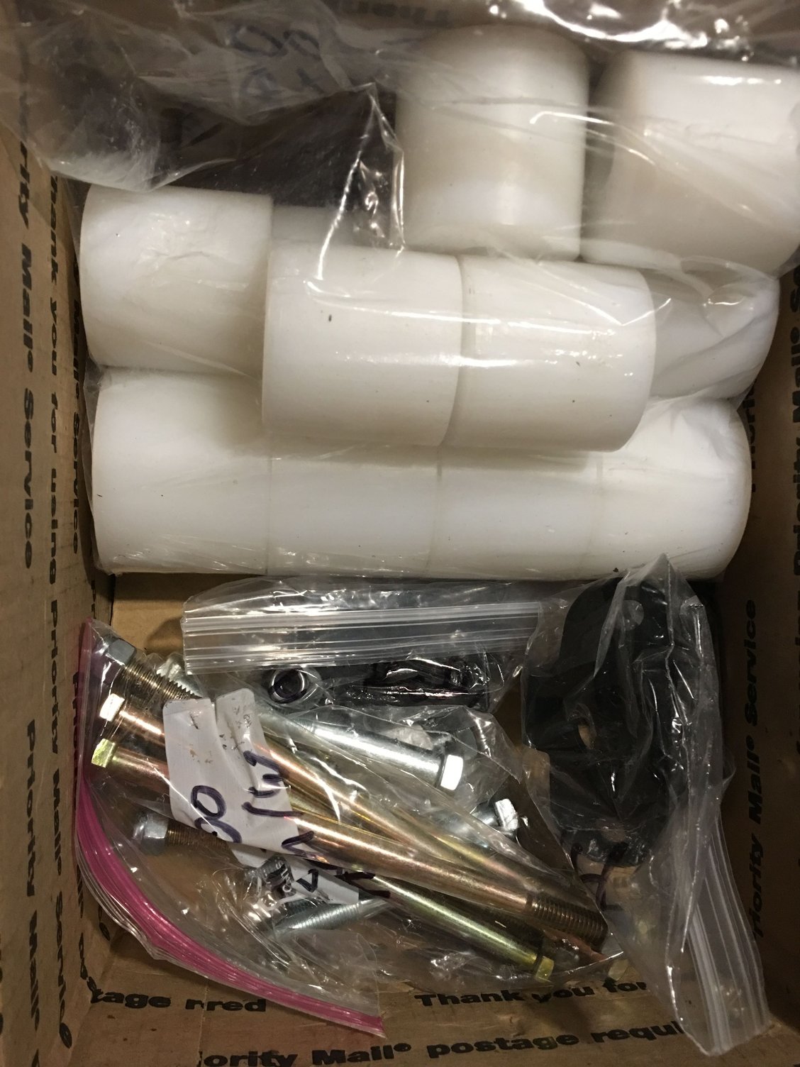

.......and the kit showed up with white spacers instead of black. If only there was a way to verify your order before they take your money.
I’m beyond irritated. Besides, why is white even the default color for body spacers?

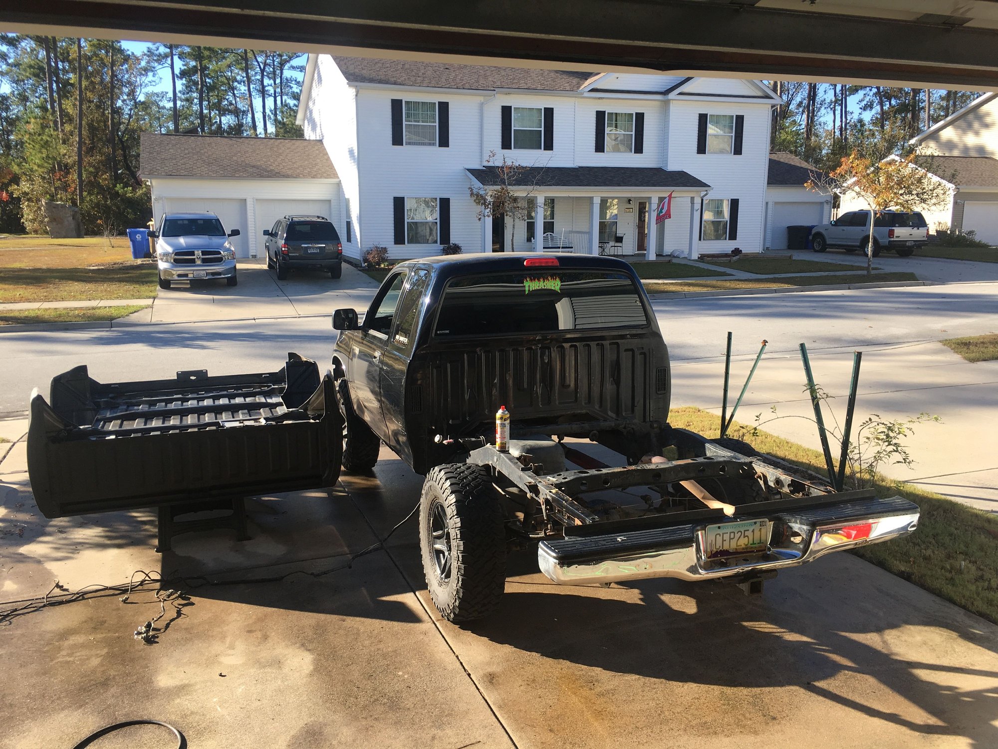

Are these shackles stock?
....and the shocks?
Swapping the bed and pulled it out to pressure wash, prep, and hit with a coat of POR15.
I don’t recall if these are stock... ?
