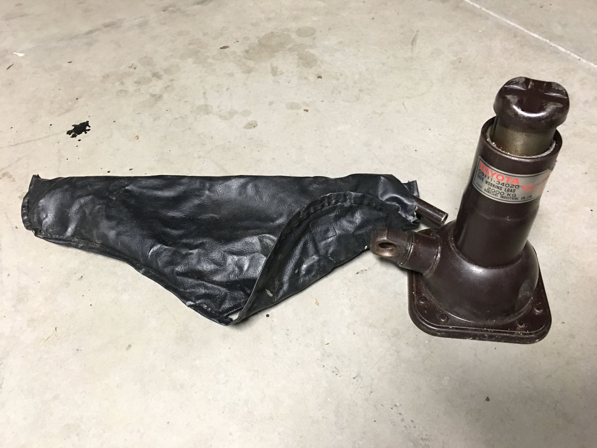

.....and I snatched the jack.

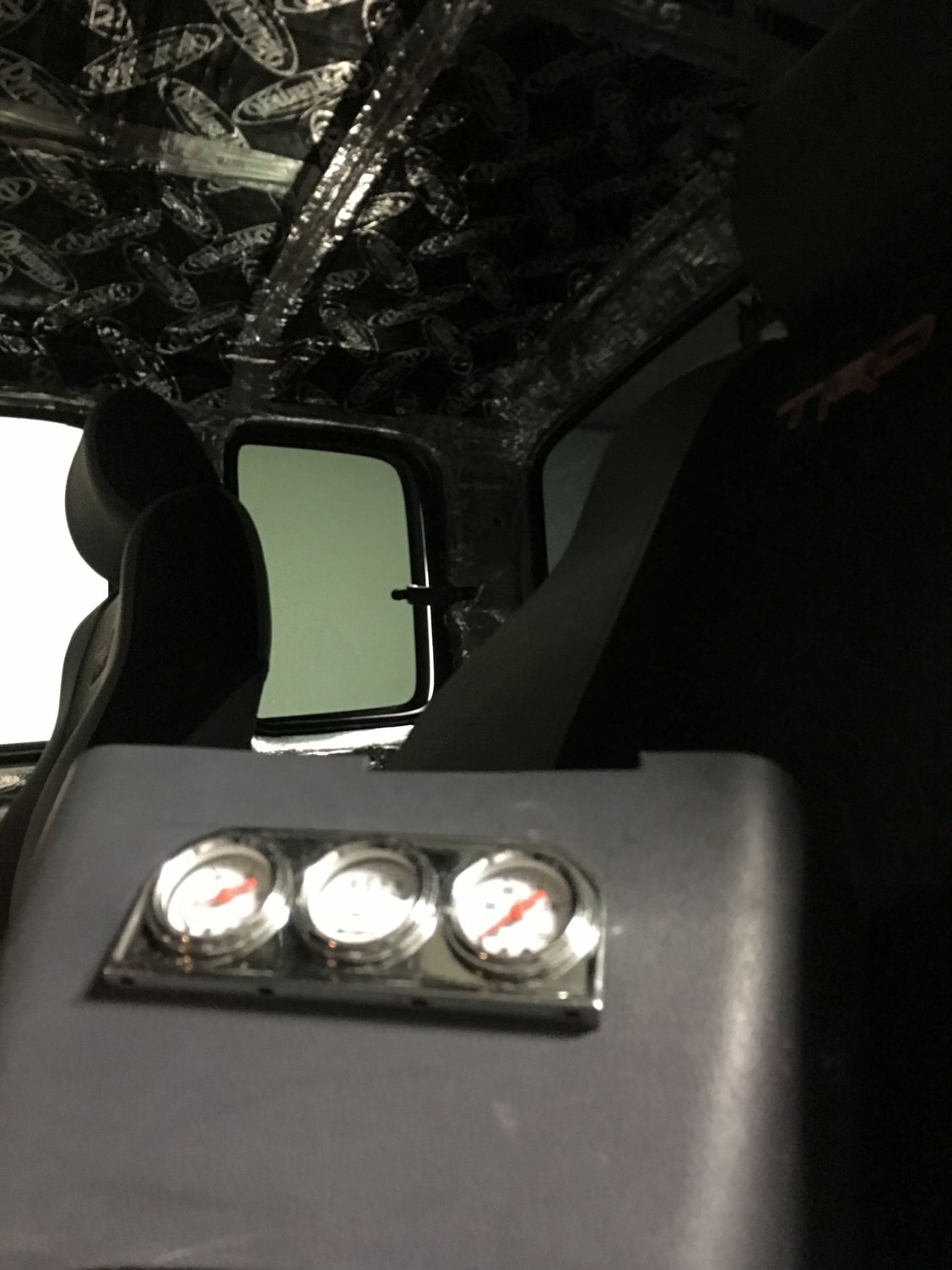

But most importantly...... THIS HAPPENED.
Words cannot explain the amount of ASS PAIN the guy who put this in caused me.
I had to replace the engine water outlet because of how he tapped in the sensor.
I had to replace the oil pressure sensor on the block and retap the block.
I had to pull the steering gear and steering shaft completely out and replace the steering shaft seal on the firewall because he ran the wires through that seal.
There’s more, but just know...
If I’m ever in Autozone and I see someone buying one of these “gauge clusters” I’m just going to punch them right in the mouth.
