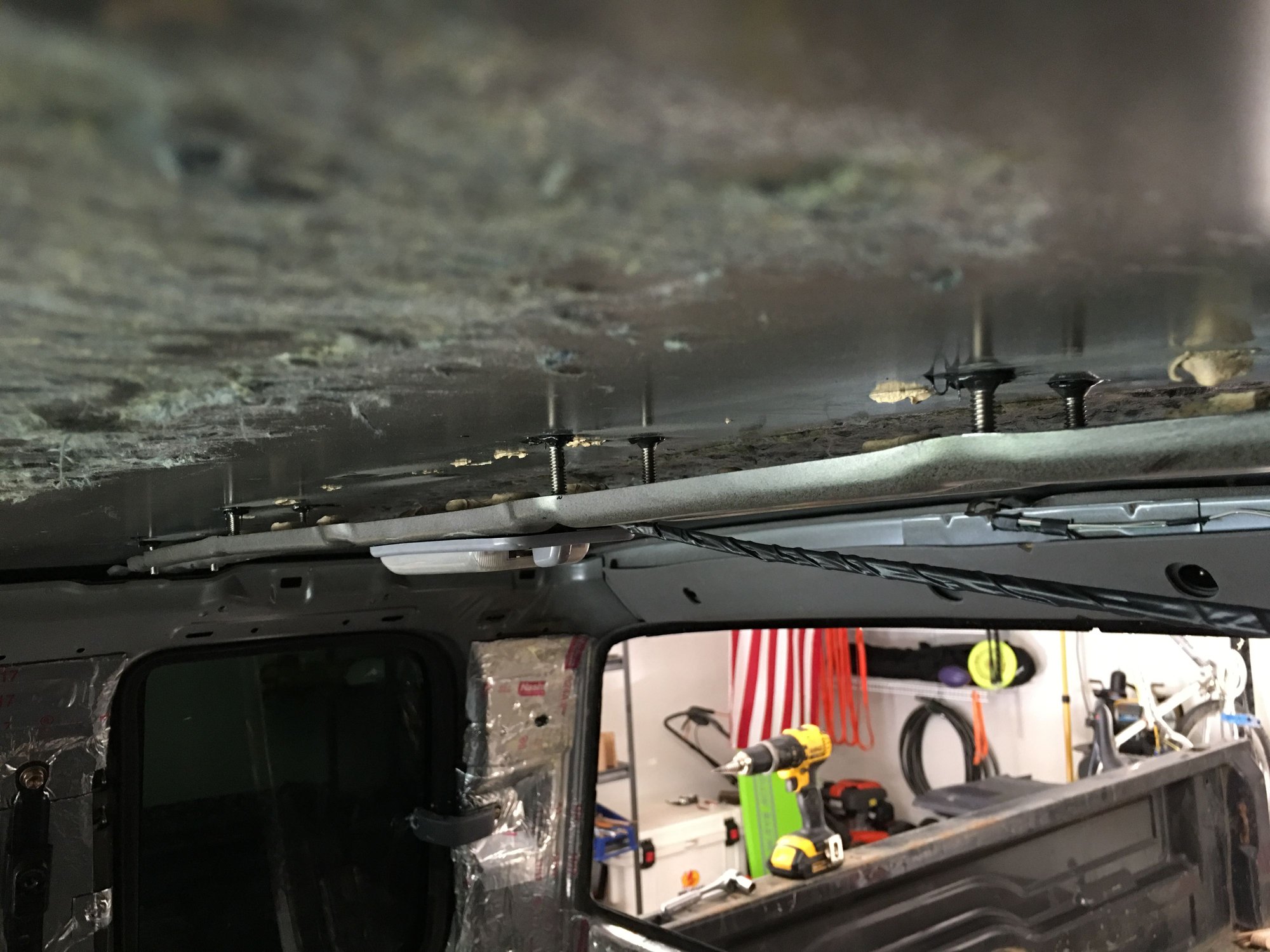

Scratched my head for a while, then decided I had a plan.
Jacked up the roof brace, drills more holes in the brace, marked spots on the roof skin, sanded the spots, JB Welded some bolts to the roof skin and then threaded nuts to pull the roof brace back up to shape.

TOTAL FAILURE............
My plan worked in application, but the roof brace just pulled the roof skin down instead of pulling the brace up.
I could not for the life of me figure out how to get the roof brace to come out, so I just ended up cutting the roof brace in half just to the left of the dome light mounting location.
my plan now is to weld it back together, bend it to the actual proper shape of the roof, then put it back in with either rivets or tack welds and a good amount of adhesives, etc.

Back to the roof brace issue:
Here’s the carnage of getting it out..

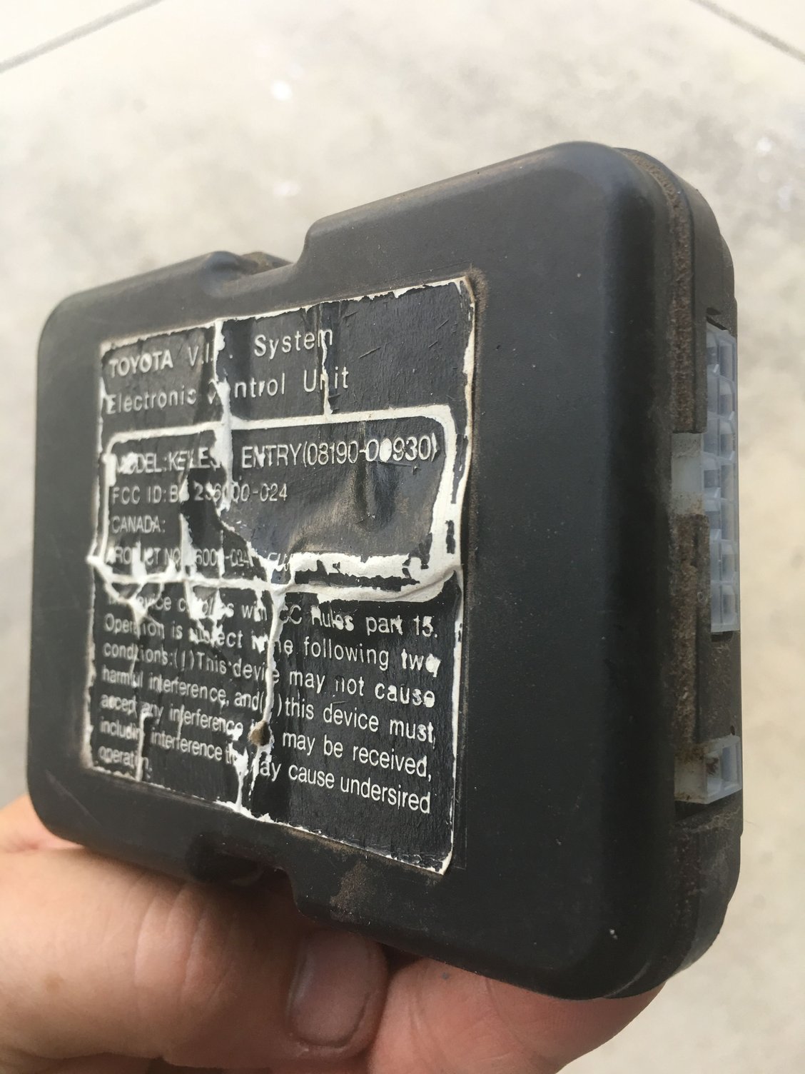

Couldn’t ignore the looming Toyota security system override / removal questions in my head, so I brought it home and started tracing wires.
Basically, my Toyota VIP RS3200 is a glorified keyless entry. The wire pigtail goes into the driver side kick panel and plugs in between the factory harness connectors.
Easy day. Ripped it out.
I’m pretty sure it works, it just needs a new remote.
Anyone interested, let me know and I’ll be willing to sell for cheap just to not feel bad about throwing it in the trash.
