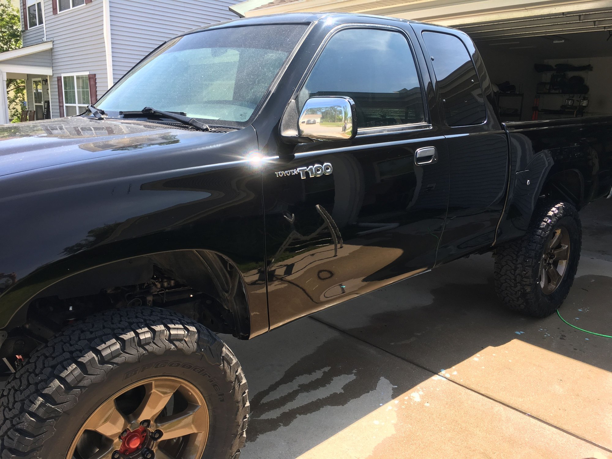

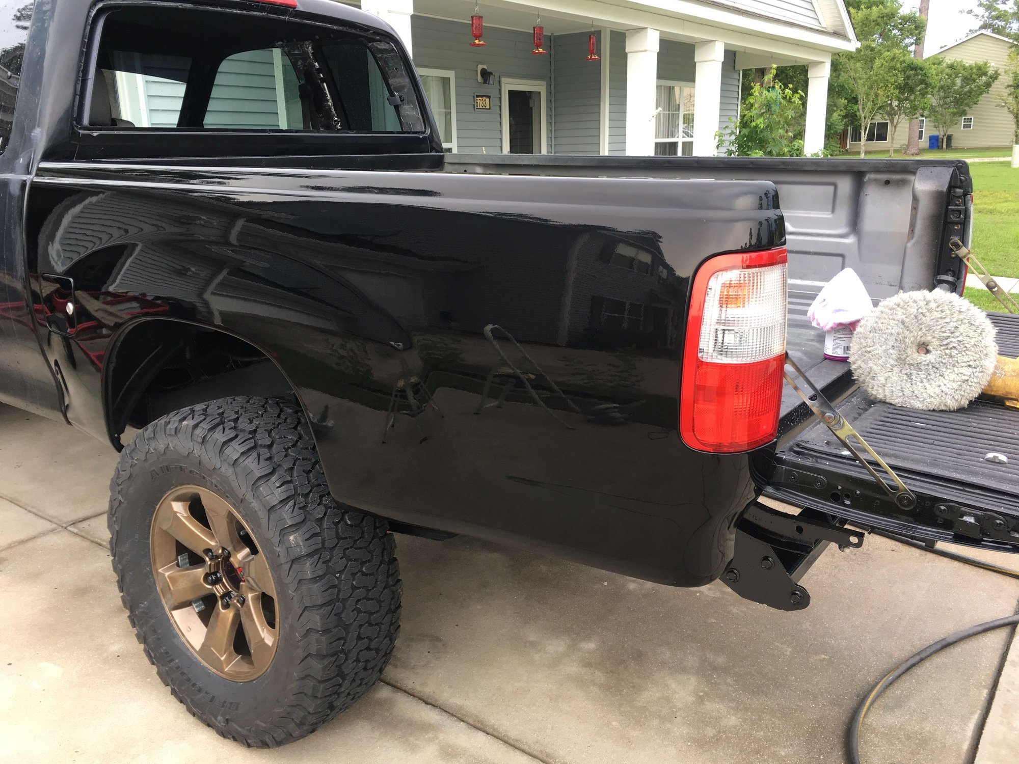

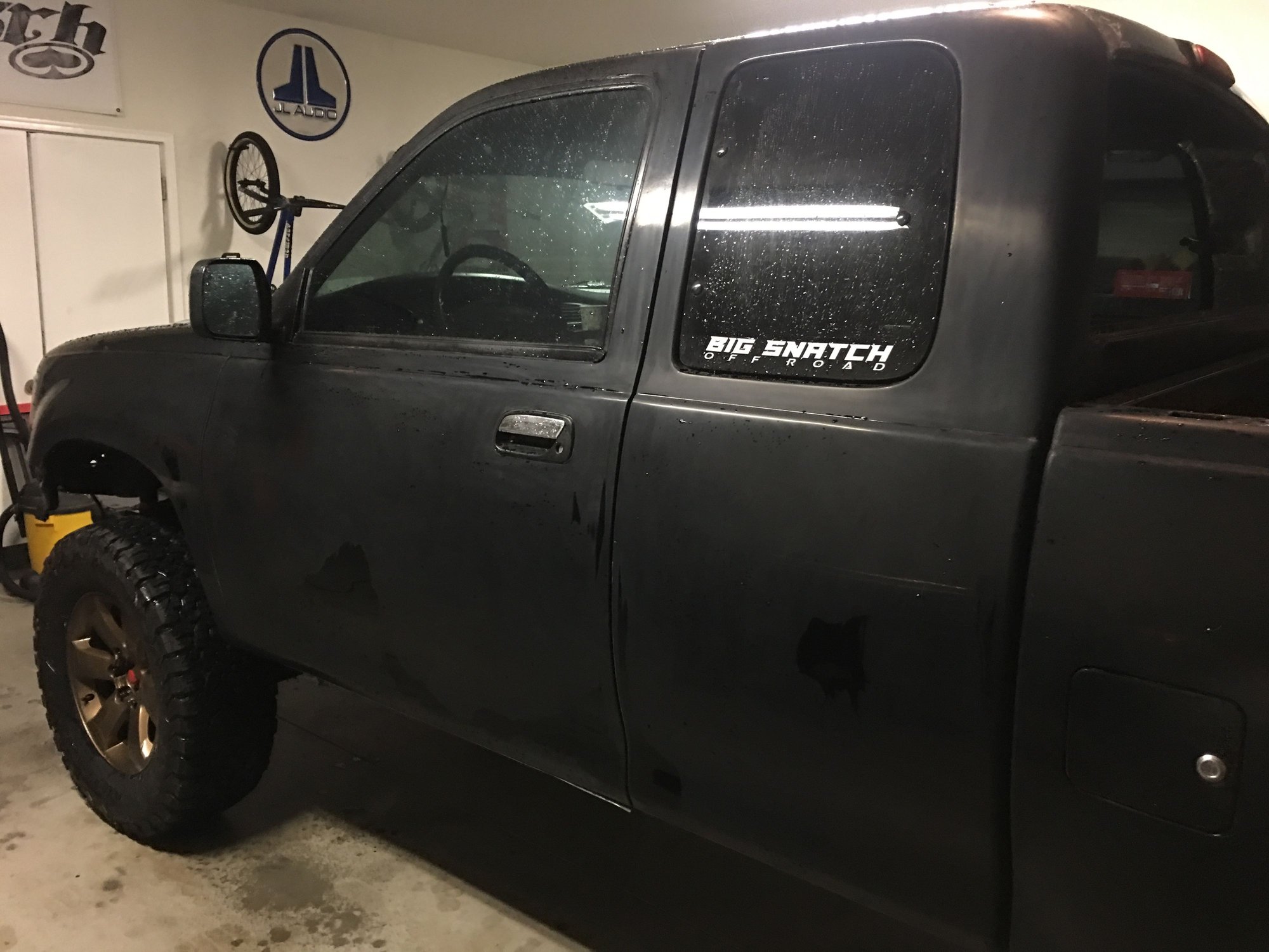

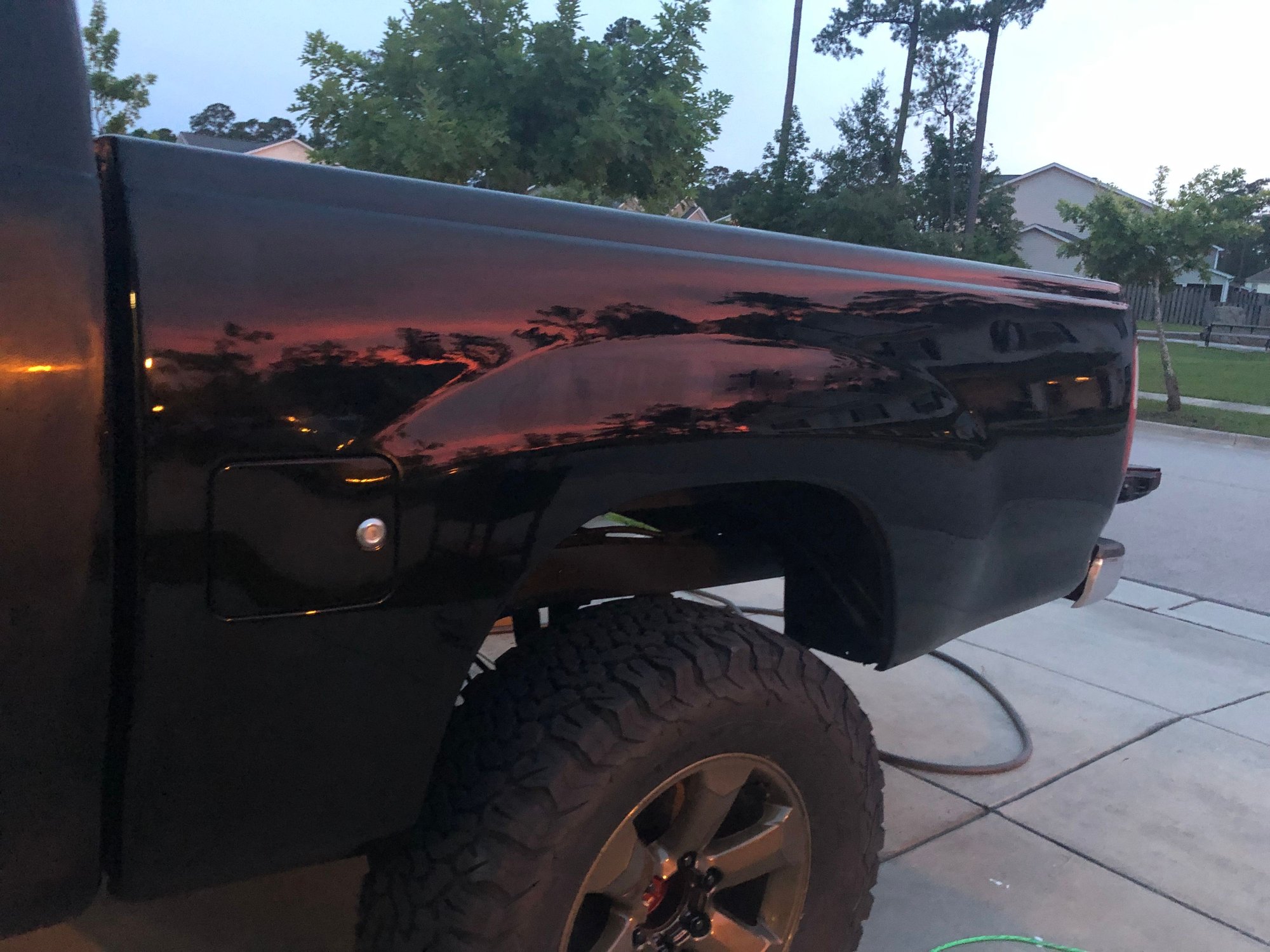

Wetsanding , buffing, etc....
Shoulder is getting sore.
Wetsanding by hand with a constant flow of water and 2500 grit 3M paper.
Follow with a wool pad and 3M buffing compound.
Got the rear window sealed in.
She’s coming together!

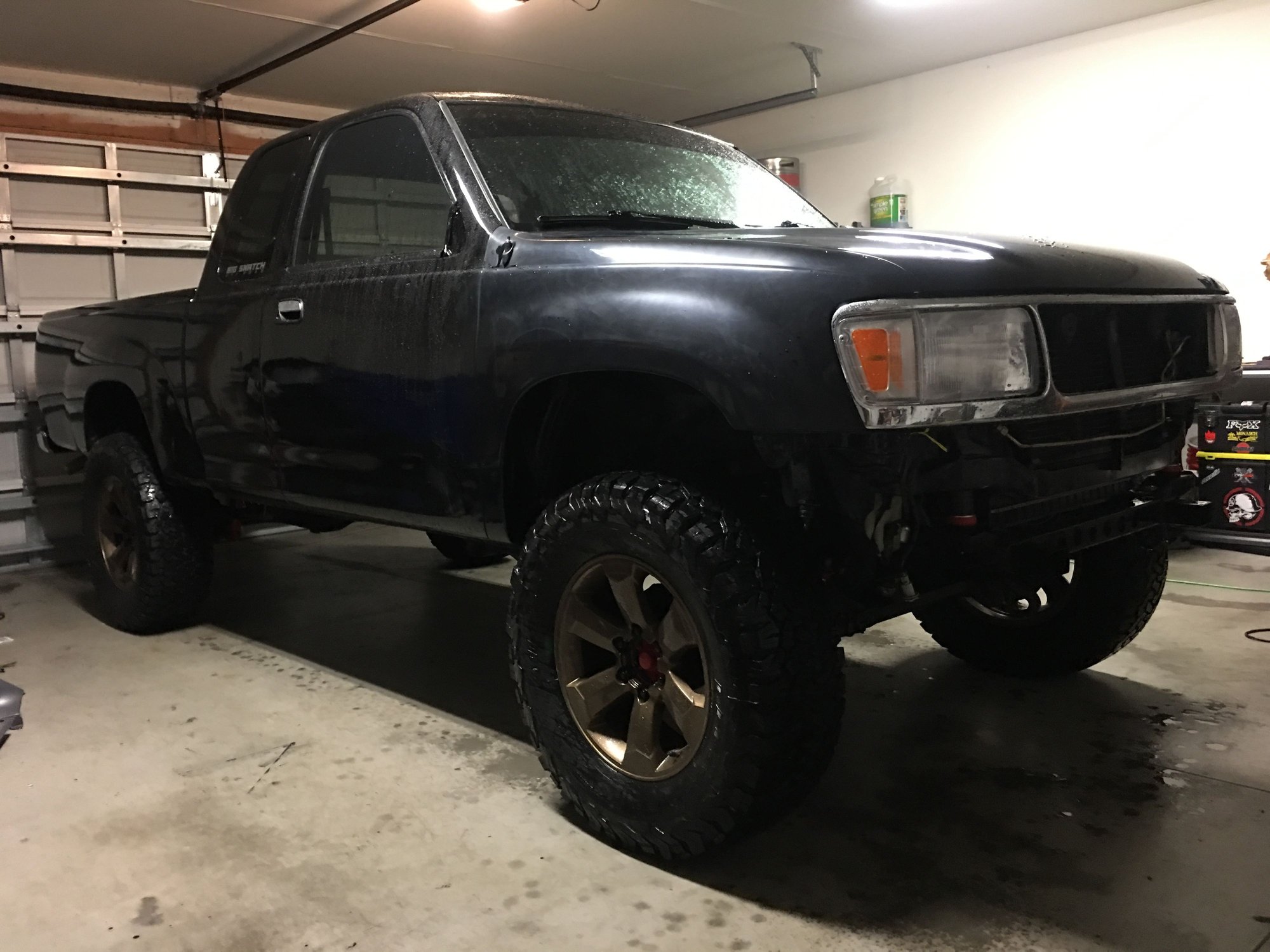

Driver Side sand, buff, badge placement

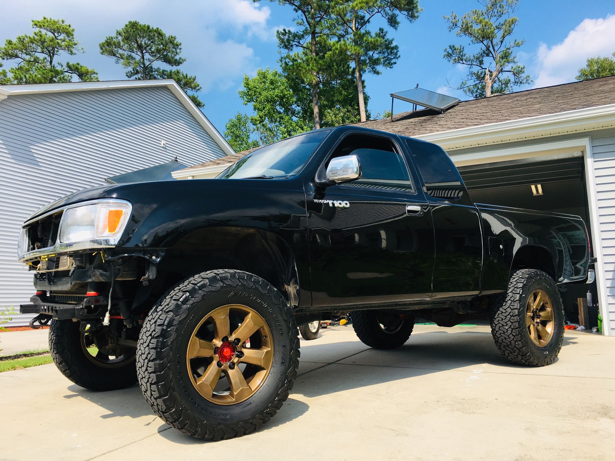

Forgot to make the 2” bumper lift brackets.
But........
She’s lookin FLY.

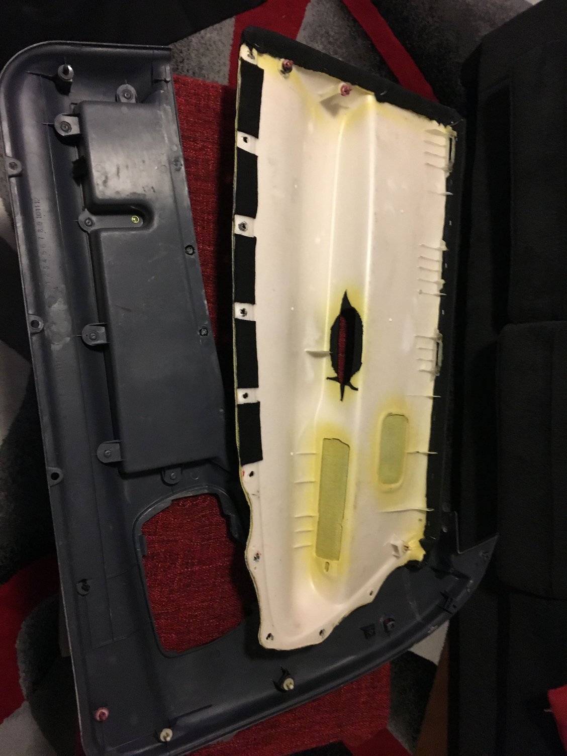

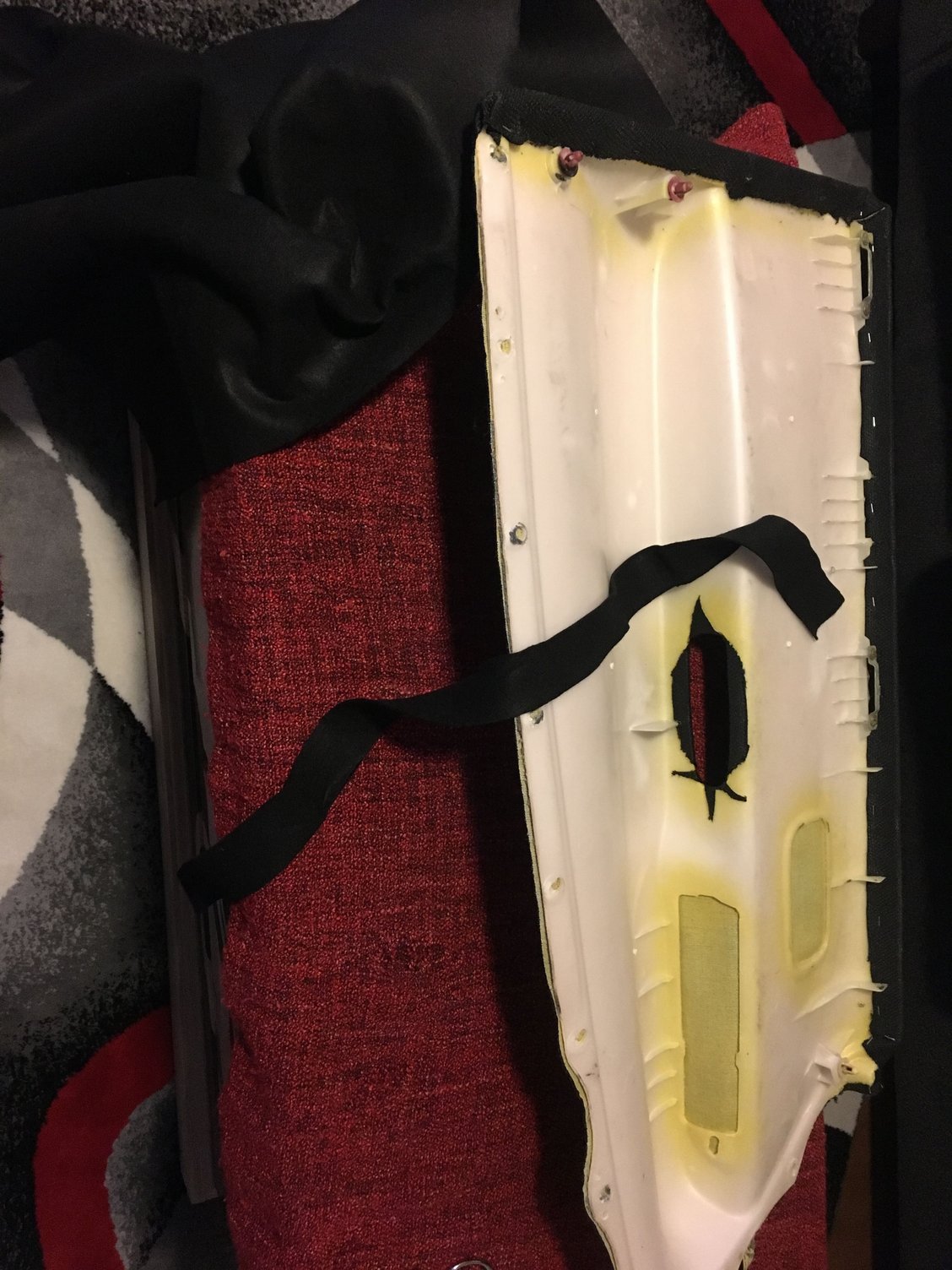

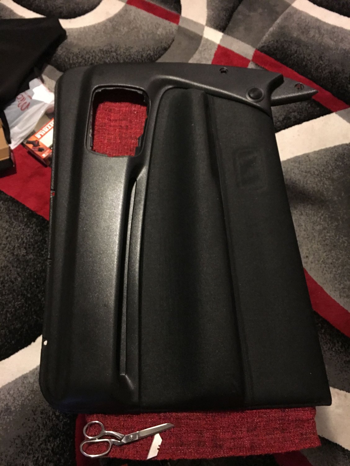

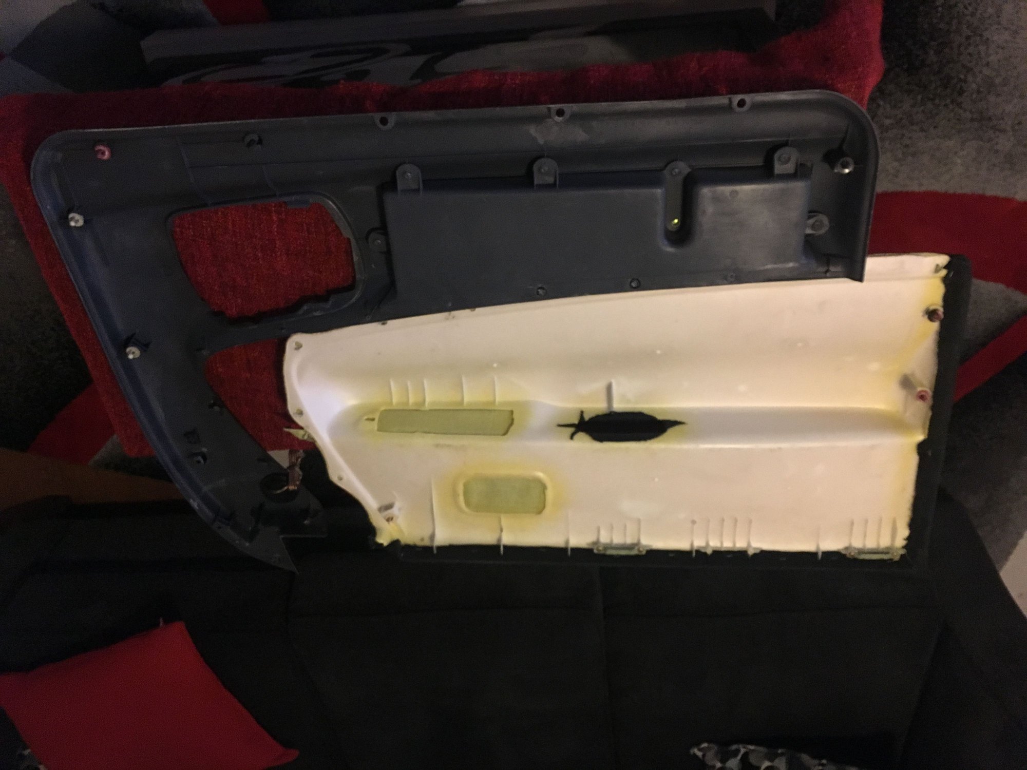

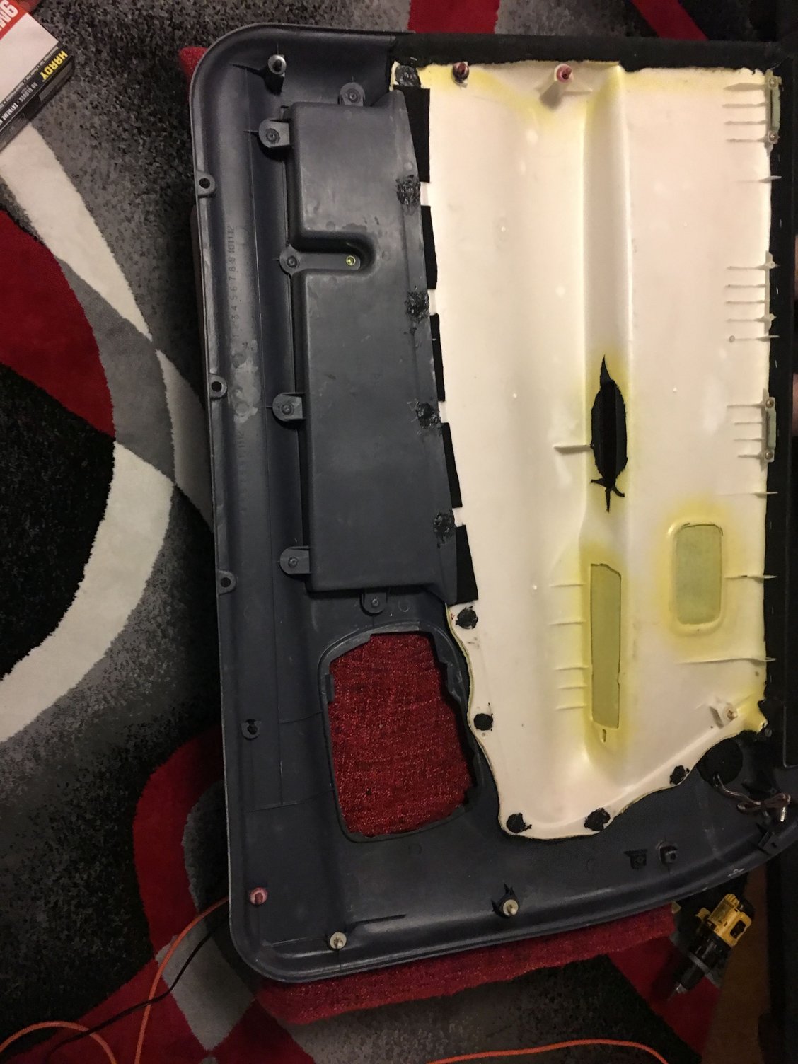

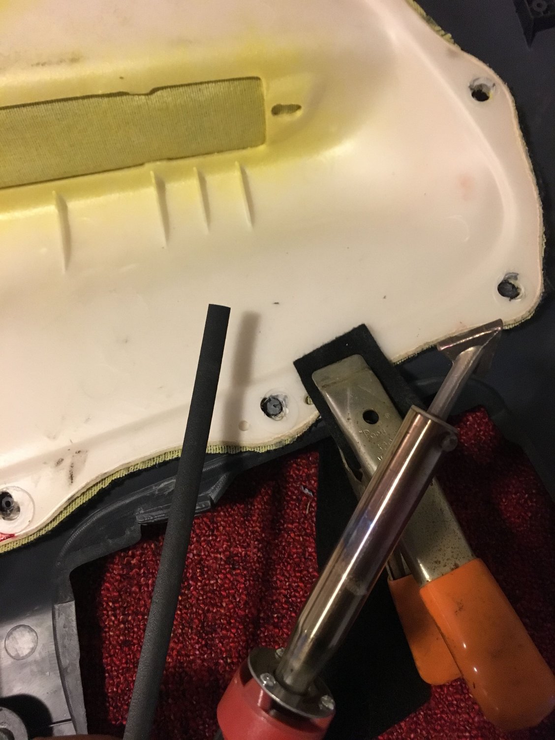

Door panel re-assembly
Plastic welded the door panels back together last night.
Also inserted felt between the panels to prevent any possibility of noise vibration to stay with the theme of the noise control inside the cab.

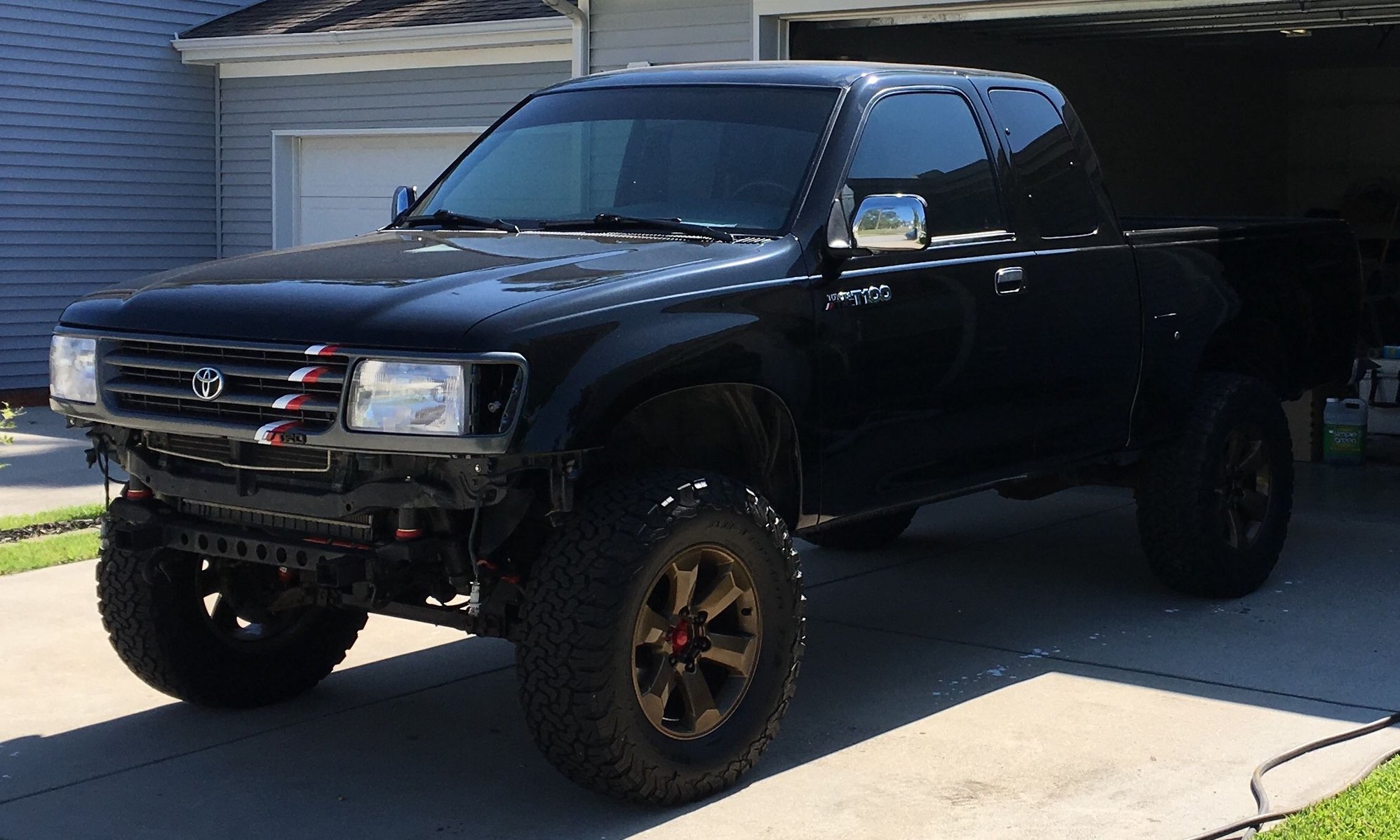

Grille
Meanwhile, throwing some TRD stripes on the grille.
Old Jul 28, 2019 | 06:26 AM
  #230
55reasons's Avatar
Joined: Aug 2014
Posts: 255
Likes: 38
Grille done.
Now just waiting on some bumper hardware from the dealership. Specifically the M10 x 1.25 bolts until I can order some stainless steel replacements.
Fastenal doesn’t even have any listed in their computers.
Anyway, old school TRD flavor on the grille.
