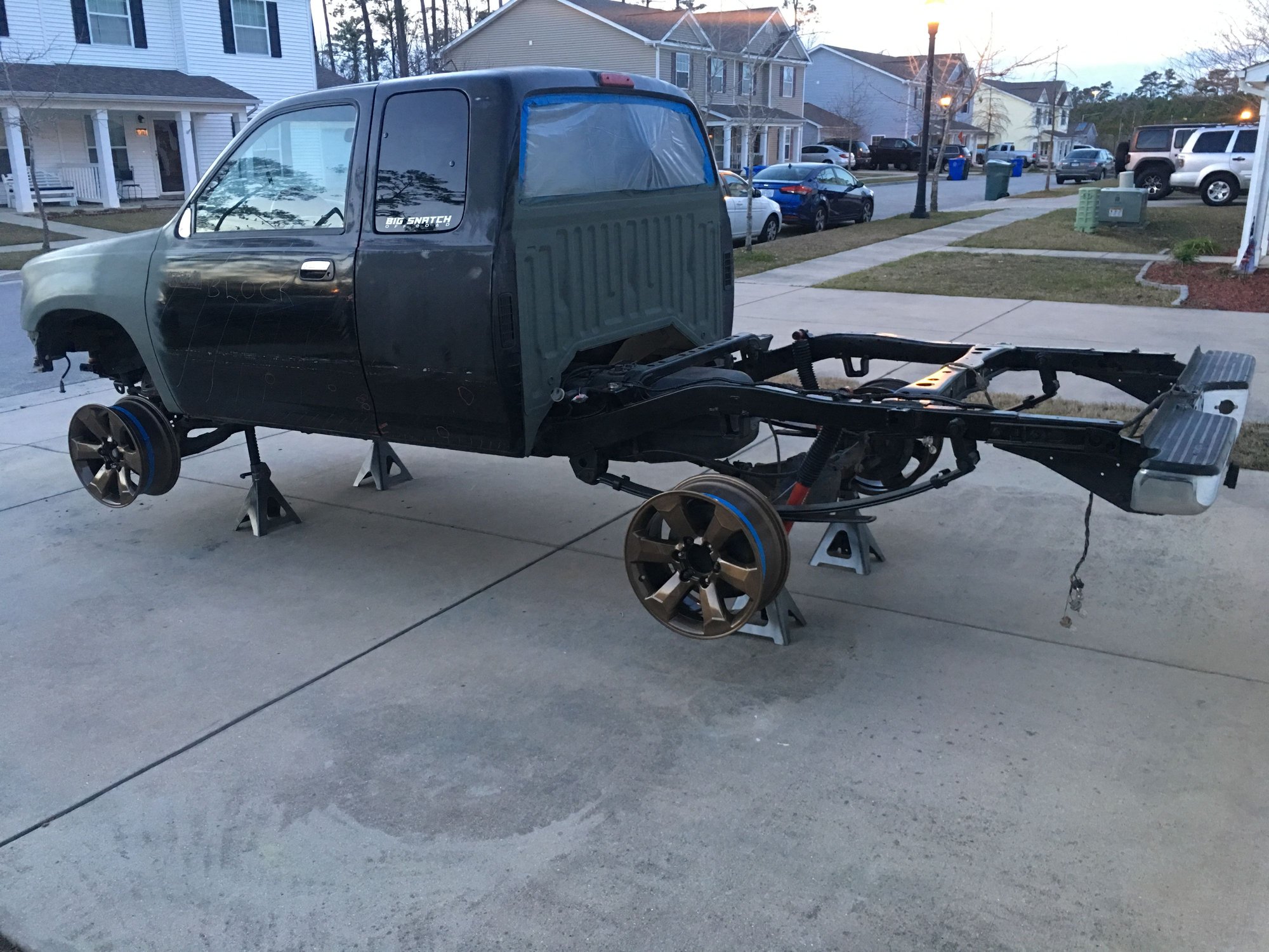

On to the body work on the cab.
Slow and steady.

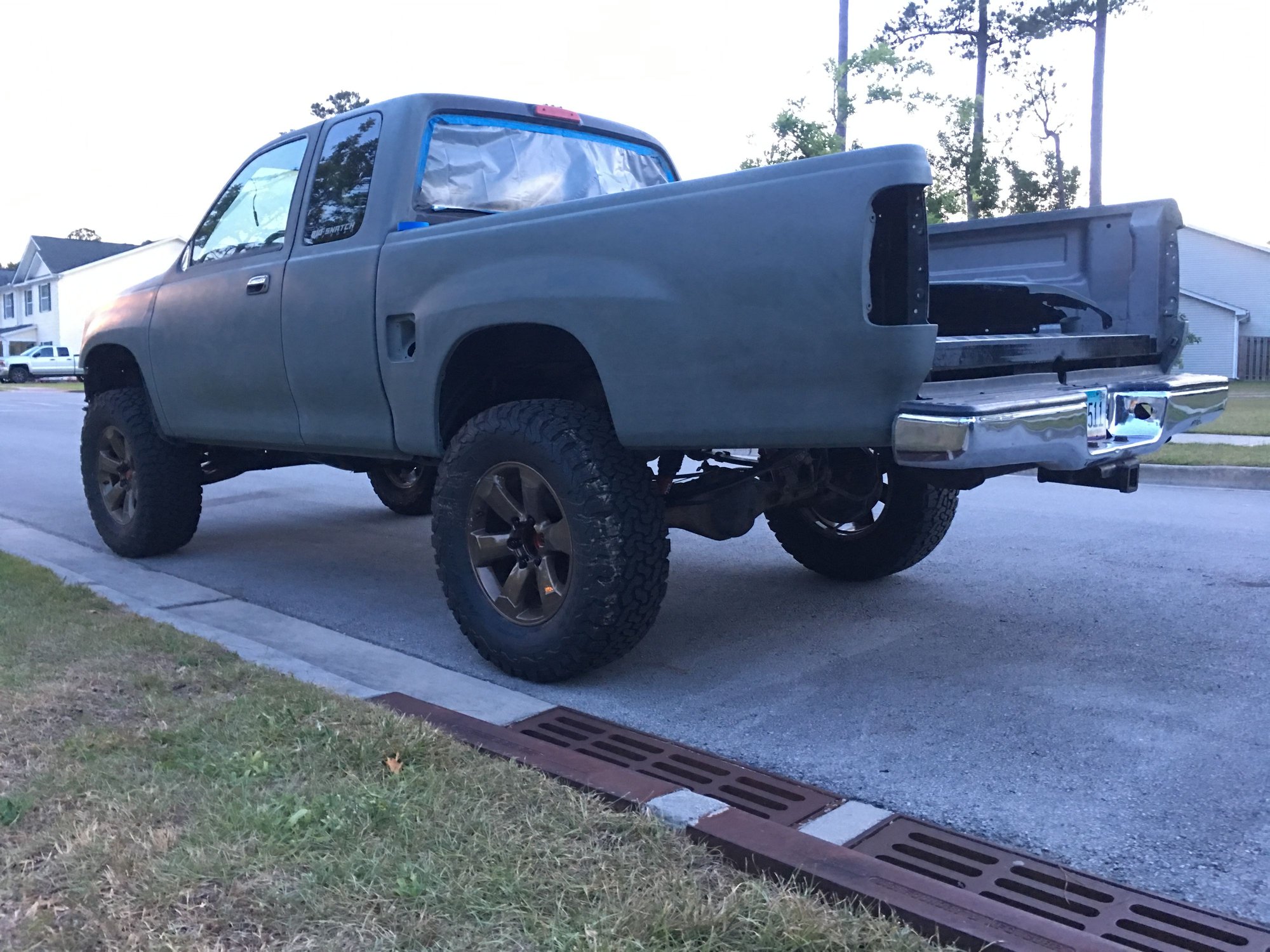

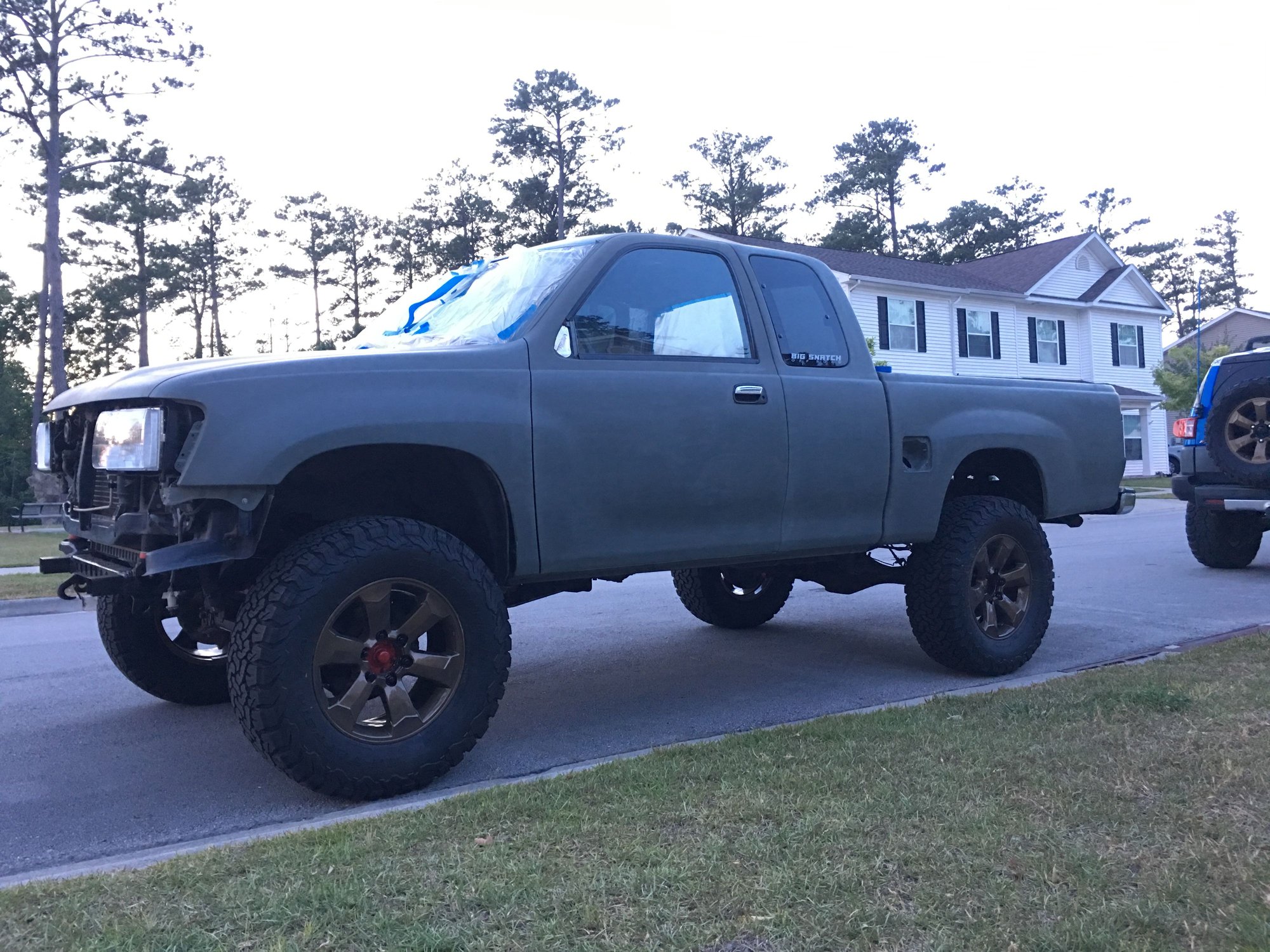

Progress. Wheels and tires, etc.
Finally decided on tires for the wheels.
Wrapped the exhaust.
....still pounding away at the body work.

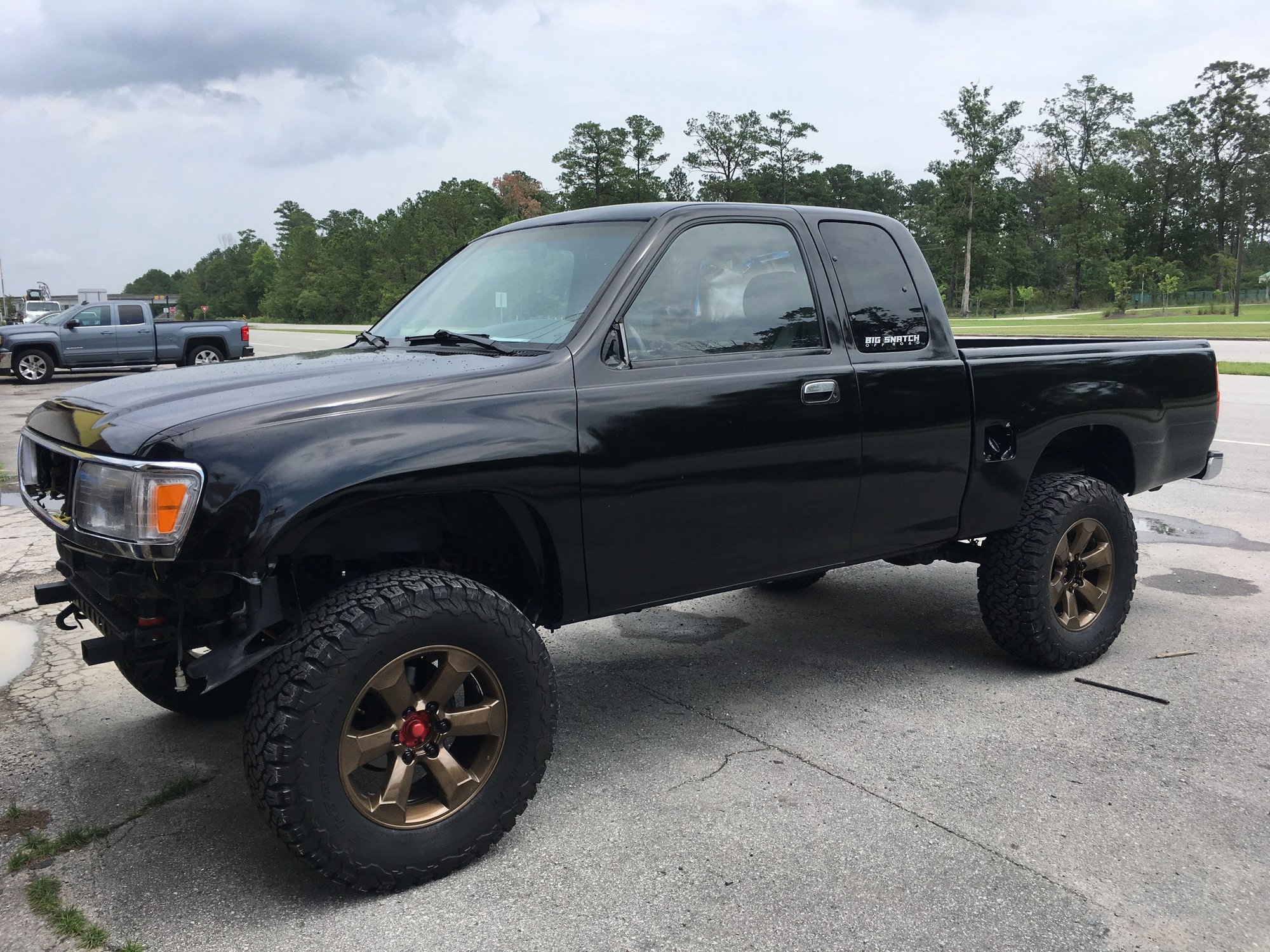

Out of the paint booth and to alignment
Surprisingly, my fishing line alignment was only off by .25 !
