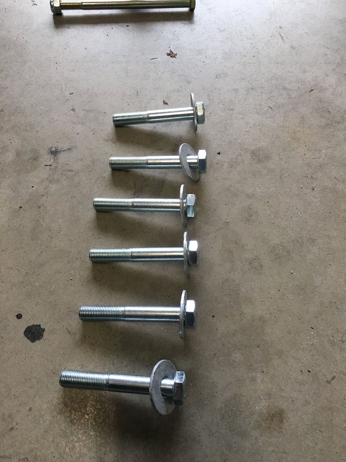

Body mount bolts.
This might be handy for anyone who unbolted their body from the frame.
If you mix up your bolts, here’s a pic.
(obviously the one that looks like a toothpick is the one from under the radiator overflow)
Bottom to top represents front to back:
(2) behind the front bumper
(2) in the front cab corners near your kick panels under the carpet.
(2) in the rear cab corners under the carpet (jumpseats etc.)
The washers to the right of them are the captive washers that I pounded off the bolt heads to re-use on the body lift bolts.

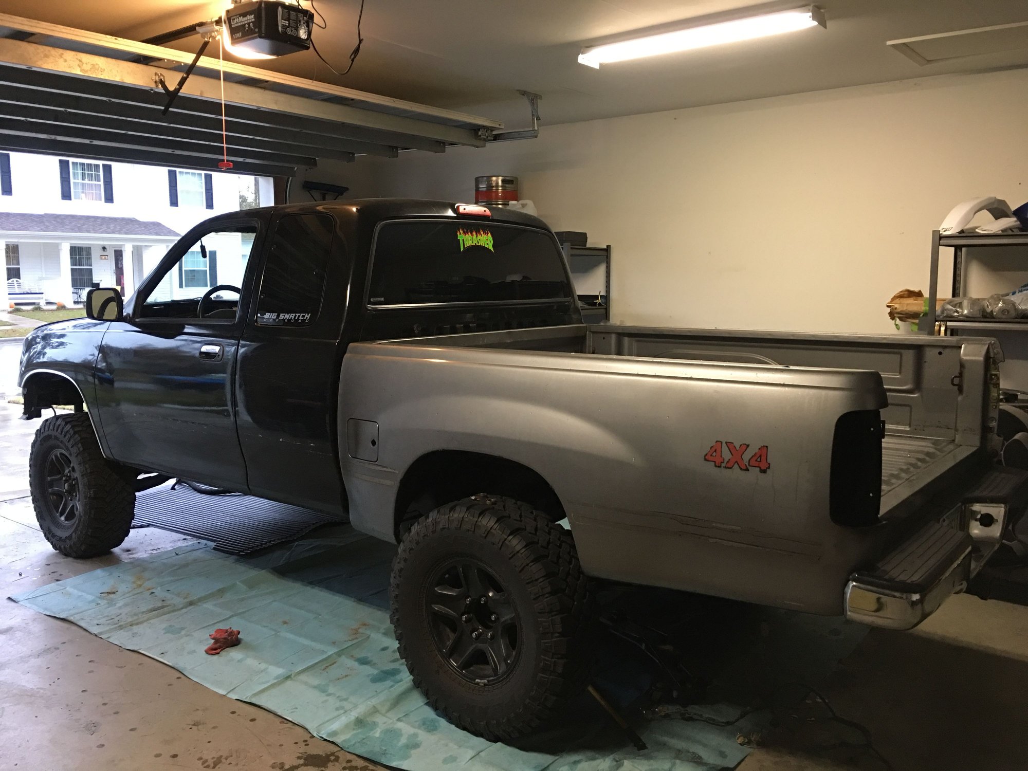

Cab Spacers on.
Messed around with this way longer than I should have, but I wanted to make sure it was right.
Gonna stop here for the night.
I’m already liking the clearance in the wheel wells and the overall door height.
