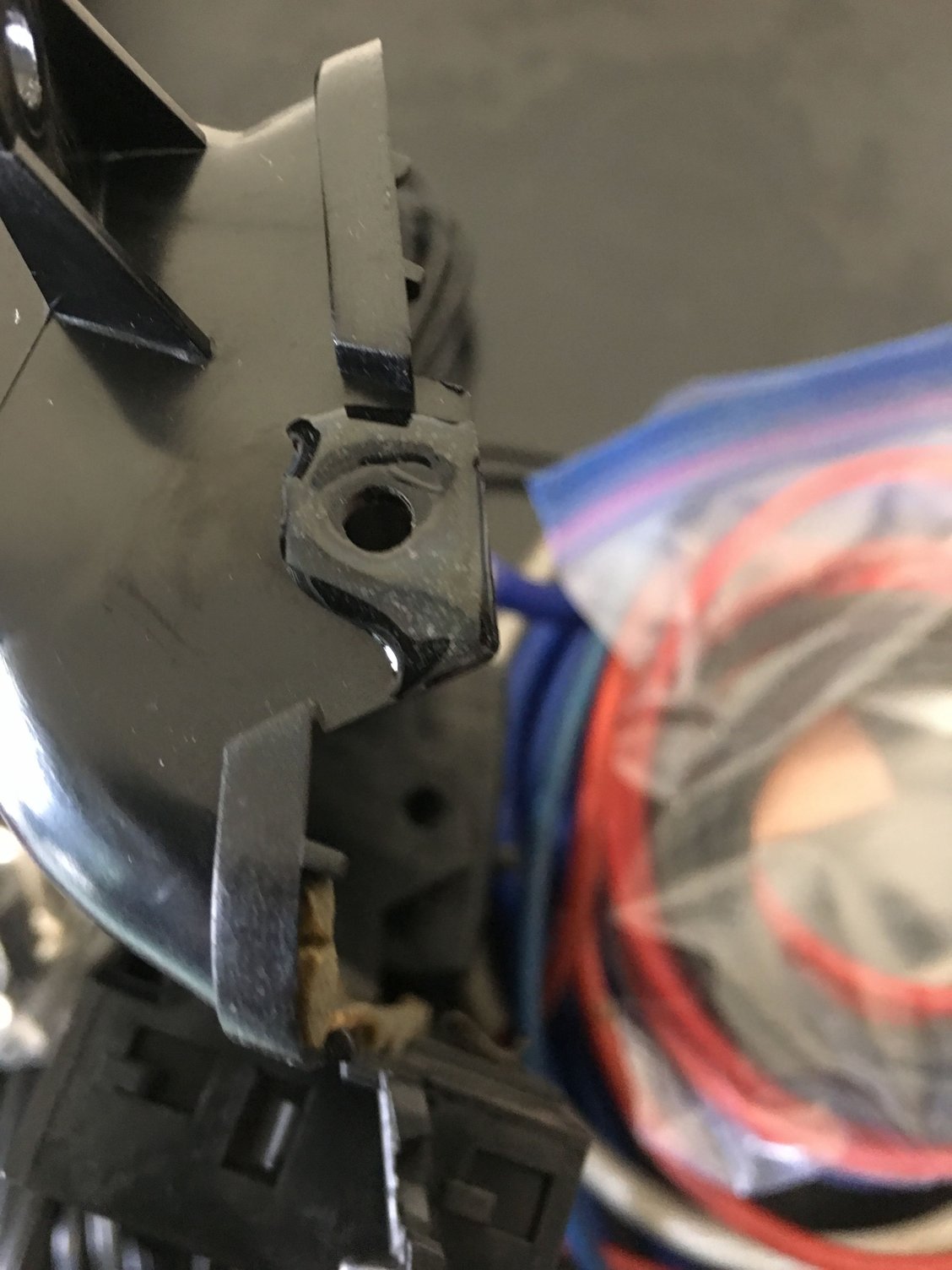

3D printer anyone?
It might be a really SMALL market, but I’m sure there are plenty of people going insane over their sloppy air vents.
These little pieces are inserts that are what provide tension on the vents up and down swivel.
they are almost ALL, on any truck I have taken apart, cracked, broken, missing, or completely worn out.
I managed to get a full set by scalping two full dashboards.
Inserting them, and then dropping epoxy resin in the gap. Hopefully this will do the trick for another couple decades.

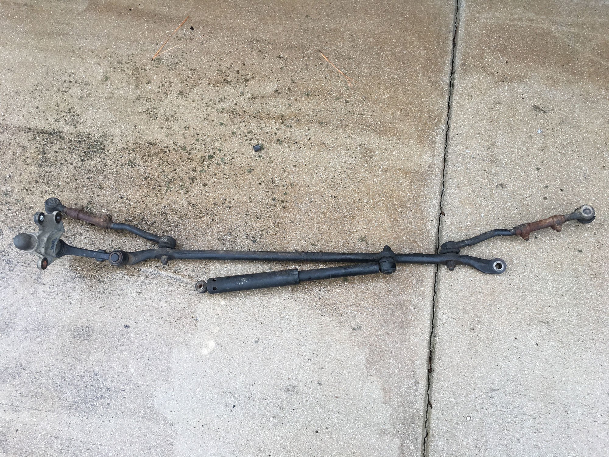

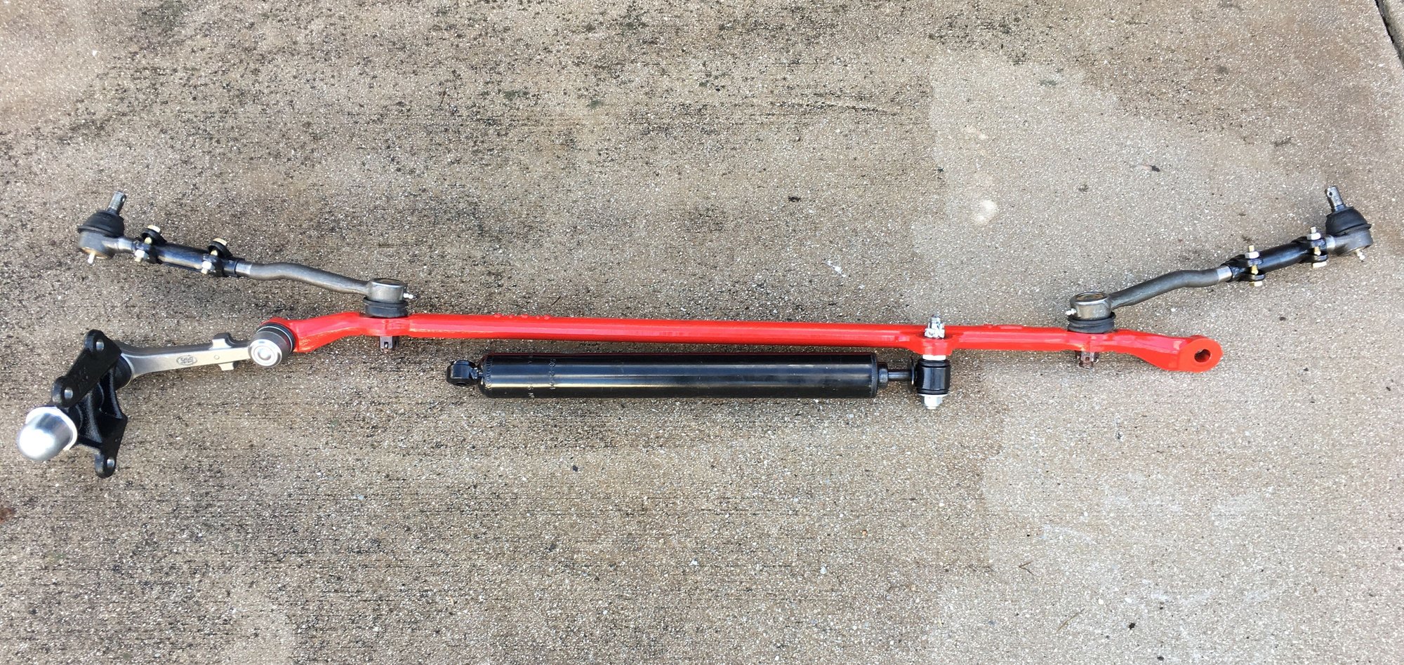

Front steering linkage rebuild.
Fastest way to get it done is to take the whole assembly out in one piece.
This also allows you to get some measurements from center to center on the ends so when you put it back together it’s not TOTALLY way out of alignment.
This should allow you to get down the road safely enough to get an alignment on it when it’s back together.

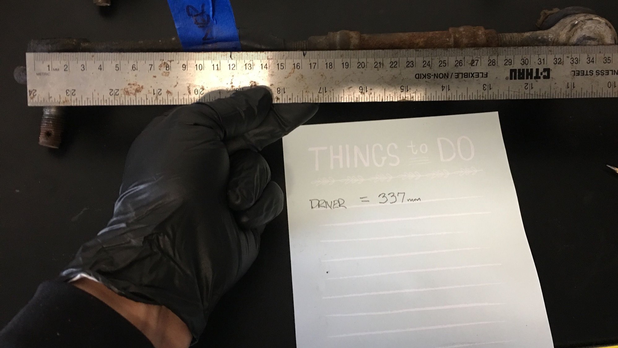

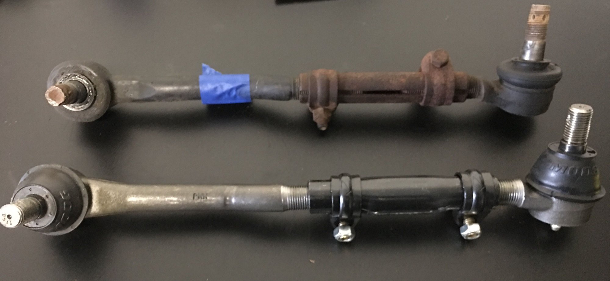

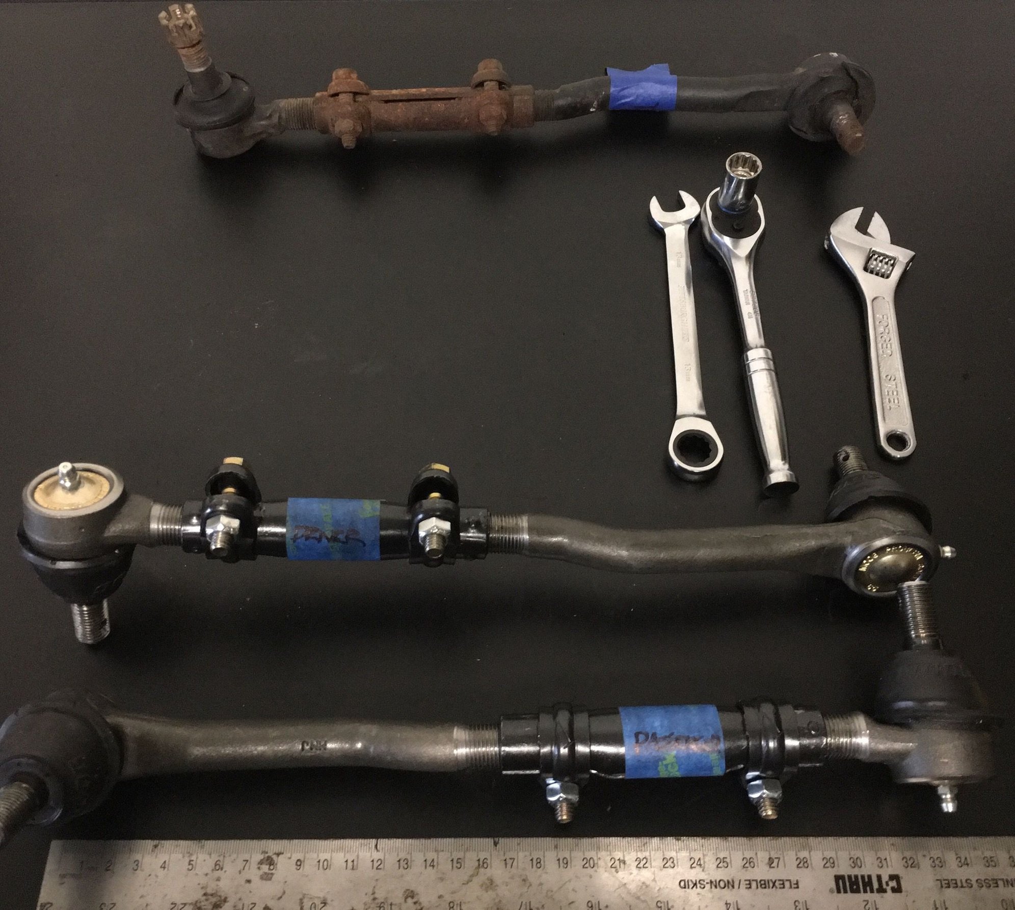

Tie rod end assembly
These MOOG tie rod ends are way better than stock, plus they’re greasable.
I measured out the stock ends.
Driver side = 337mm
Pass side = 320mm
The different between the two ends being 17mm.
My thought process is to split the difference. (Add 8mm to the pass side and take away 8mm from the driver side)
A 8mm shift of the tie bar won’t even matter in the damper or stabilizer travel.
If it throws off the “center” on the steering wheel, I’ll just move the pitman arm a couple teeth to recenter everything at zero.
Then I can make the fine adjustments to the tie rods when I actually do the alignment.
But overall, I’m thinking the tie rods should be in the neighborhood of 328mm on each side from center to center.

Steering linkage assembled
Took a break from sewing the headliner.
Got the linkage assembled this AM.
Ready to go back in.
