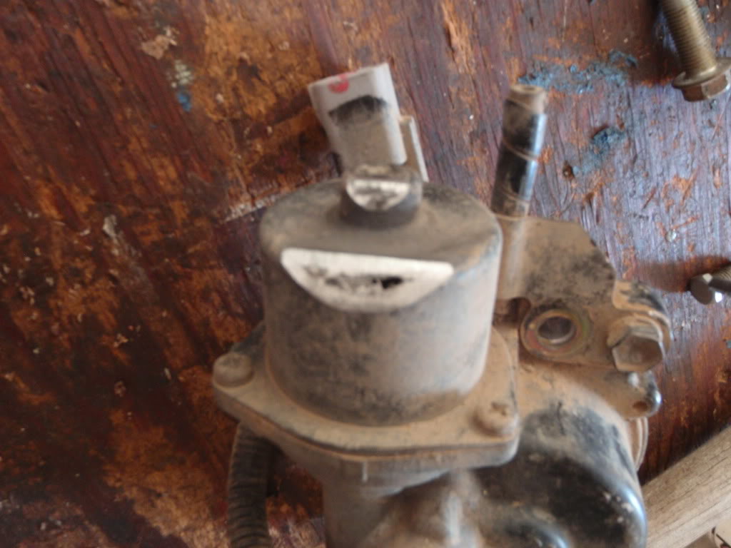

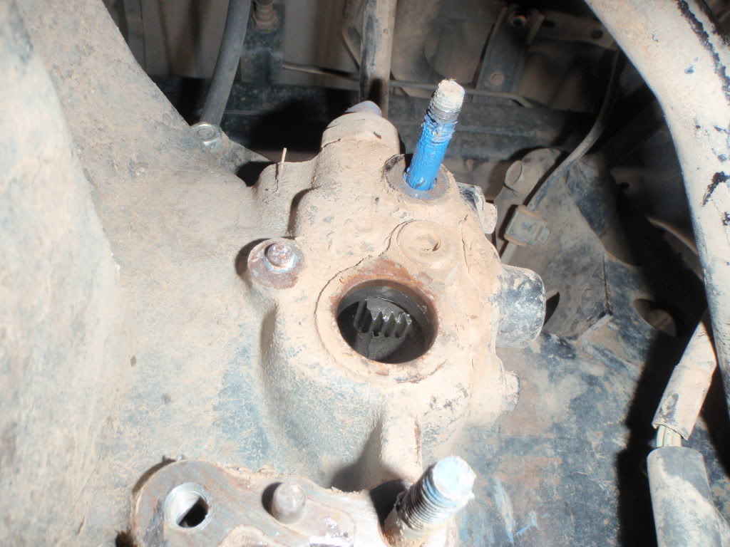

So I took one of my favorite local trails today, and afterwards I couldn't get my E-locker to disengage, it was frozen in the on position. I got it home and couldn't hear the motor running at all when I hit the button. I pulled the motor off the 3rd member to free it up manually, and found this.

The sway bar managed to rub against the actuator so much that it completely wore through, exposing the electronics. The sway bar sits about a half inch away on flat ground, but that obviously wasn't the case when I was on the trail. So the rear sway bar had to go, and I did my best to patch up the worn spot on the actuator with RTV.
Pretty simple to free up the E-locker, just pop the motor off the diff, and push this gear from left to right to the position it is now. Must have been gummed up or something because it works great now.

good call on dumping the sway lol more flex anyways. surprised you didnt just drop the motor and unlocked the locker before heading home
I would have, but I didn't have my tools with me, took them out just hours before. Stupid me!
