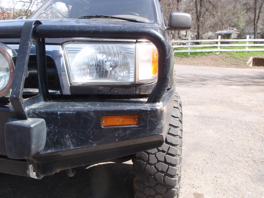

New headlights in from a 99. Looks so much better, light output is way better too

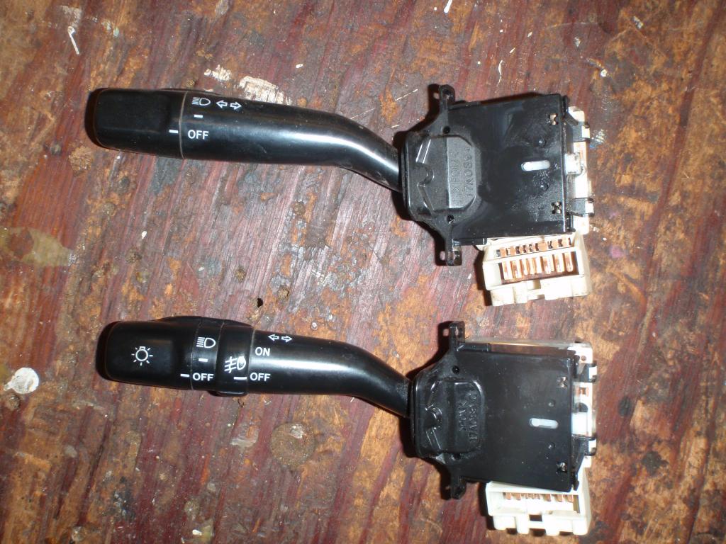

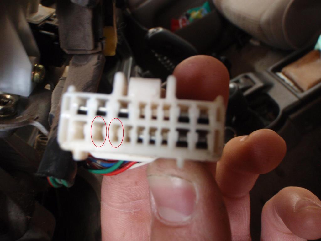

I also am trying to save up as much room as I can for switches on the dash to the left of the steering wheel. Eventually I'm going to have a front ARB switch there as well as a compressor switch, and maybe an LED lightbar switch down the road. So I got a new headlight/foglight combo switch from the same 99 that the headlights came from. Since my 4runner never had factory foglights, I just wired up my HID's on my bumper to this new factory switch on the stalk. It's got a nice factory look to it, and I just saved up some room for more switches later. It's a win win!
Heres the new switch and old switch next to eachother

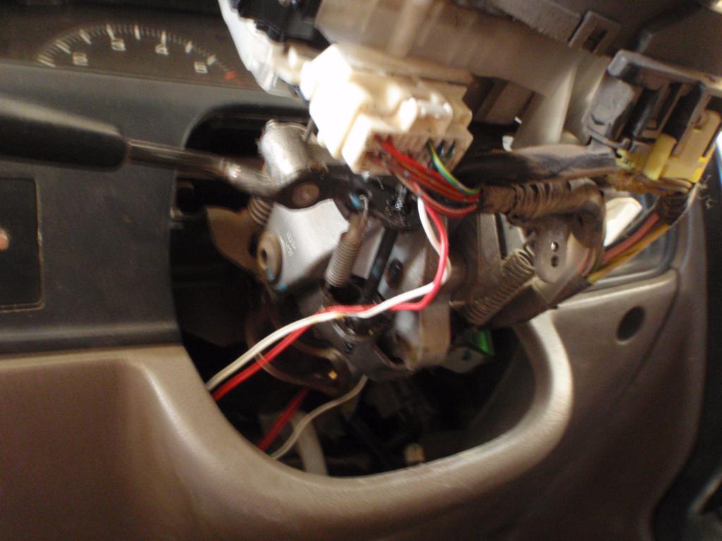

As for the stalk, already done! It's extremely easy, you could do it in your truck too. It mounts up exactly the same, and the plug for the harness is exactly the same too, it just has 2 more pins in the plug than the old one did for the foglight switch. I just unhooked my old switch wires, and stuck them into the back of the plug where the 2 switch wires are supposed to be, and done. Seriously only took 5 minutes.
Here are the empty pins on the plug, big pin is positive and small is negative.

And the old switch was already connected to a relay, so just using the new switch will still utilize the old relay.

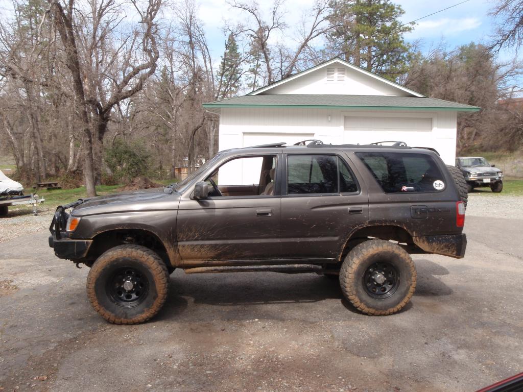

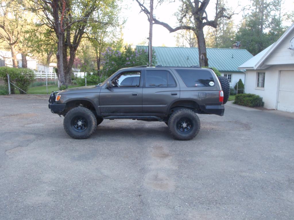

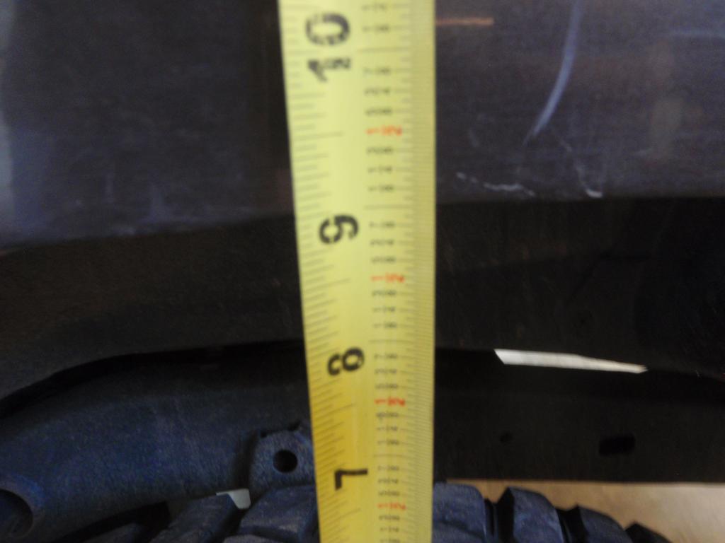

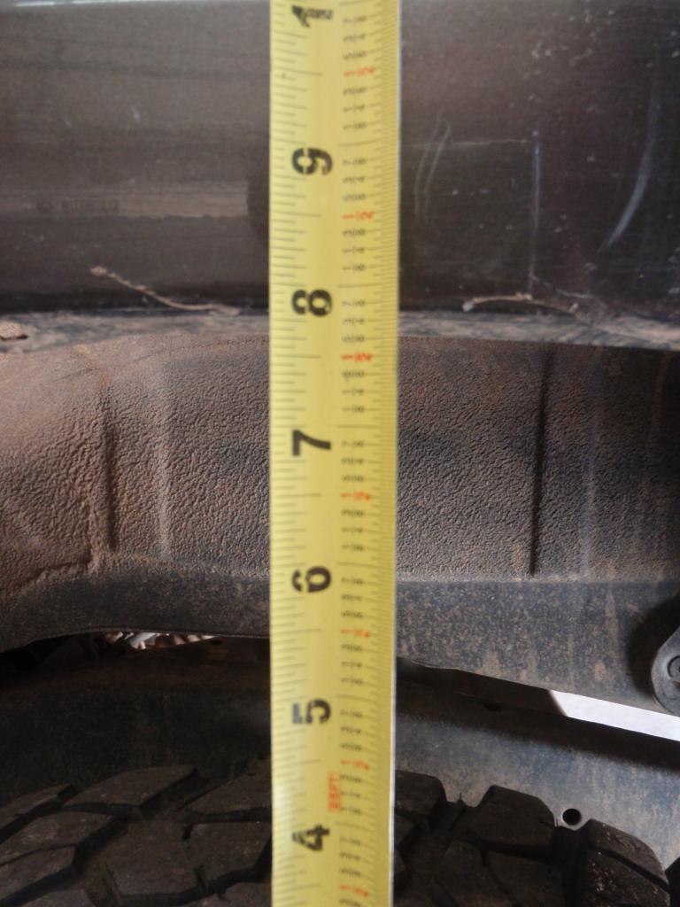

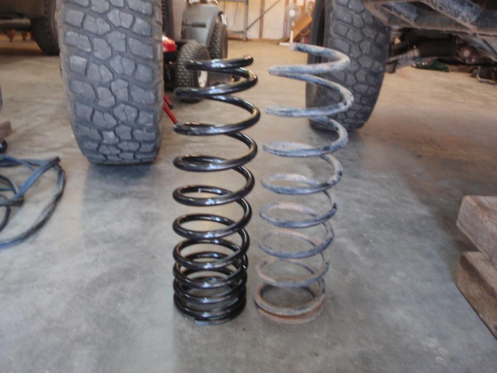

New OME 861 coils are in. Nothing wrong with my old LC 9 wraps, I just needed something that could withstand all the weight in the back. These should do great, and never sag when the tent and jerry cans are on the back.
861 and old LC 9 wrap side by side
Before
After
It's got a bit of rake, but the new shock bushings for the front should be here soon to replace the old blown out ones. That should give me another 1/2 inch or so in the front. I don't mind a bit of rake though, and it will be just about perfect with the tent on top and the full jerry cans on the back.
A few things to compare the 861's to the 9 wraps:
- First of all, I immediately noticed the rear end is much stiffer now. The 9 wraps made the rear end float around and bounce on bumps on the highway, that has been eliminated. The 861's absorb the bumps much better, and I don't get the floating feel anymore.
- I run no swaybars. I've always had quite a bit of body roll, but that has been reduced quite a bit. The whole rig seems to hug the road better now. With that being said, I've never been able to get a rear wheel off the ground on a sharp turn with the 9 wraps. Today I did it with the 861's, it was a bit scary and I wasn't expecting that lol. I guess since the new coils are much stiffer than the 9 wraps, the rig can't lean as much without pulling the axle with it. Now that I know what to expect, it wont be a problem.
-The 861's flex great, just like the 9 wraps. But I already knew that, thanks to the handful of you that run these coils and have talked about their wheeling ability. So thanks for that!
I'm really looking forward to loading these coils down with all my gear for the Overland Expo trip in less than a month, that will be the real test.
