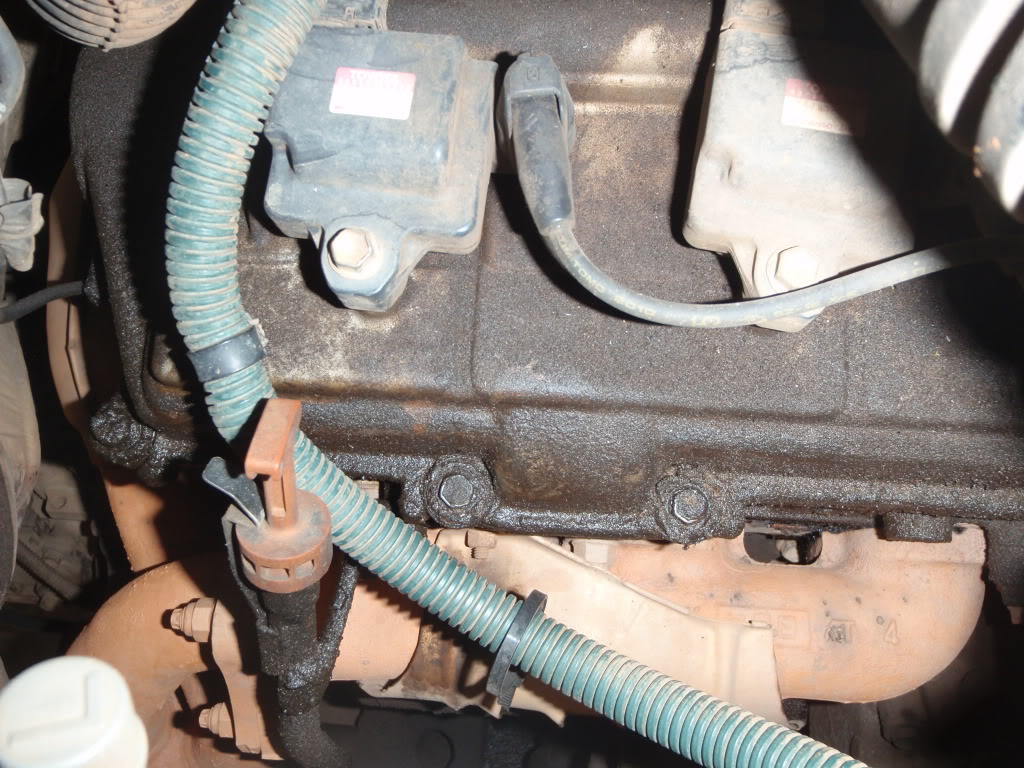

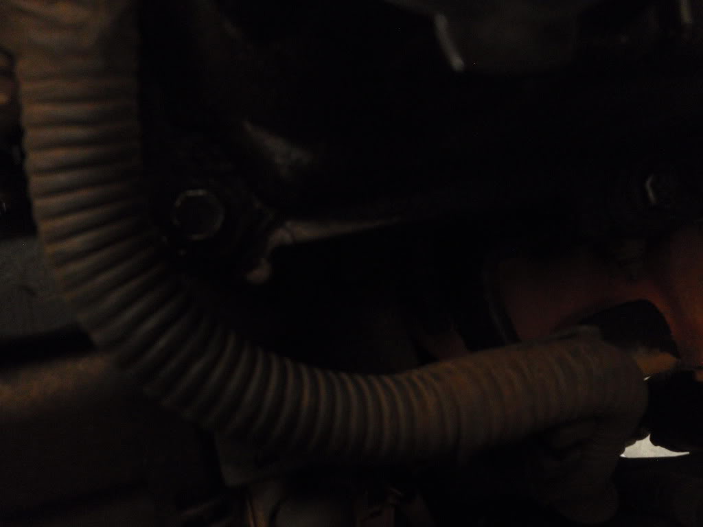

Since I am gonna be replacing my spark plugs anyway, I'm gonna try tackling the valve cover gaskets at the same time. Time permitting, I'm going to take my whole front end apart and replace my leaky oil pan at the same time, now that I know I need a 12 mm allen wrench to get the diff off.
I've heard on the 3.4's the valve cover bolts can loosen over time, causing oil to leak out. So today I went out and tightened them, and all of them were super loose. Some so loose it took almost 6 turns on the wrench before they even began to tighten down. The FSM specifies to torque the valve cover bolts to 52 ft. lbs, I just tightened them down pretty snug by hand. As I was tightening down the bolt just below the oil fill, the valve cover cracked, completely isolating the bolted portion from the rest of the valve cover. As of now it hasn't leaked through the crack as far as I can tell, but I'm really determined to order my gasket kit soon and fix the crack before it becomes a big problem.
Crack is just to the right of the bolt, you can see it in the clean portion of the valve cover.
Just a pic of how bad my valve covers leak.

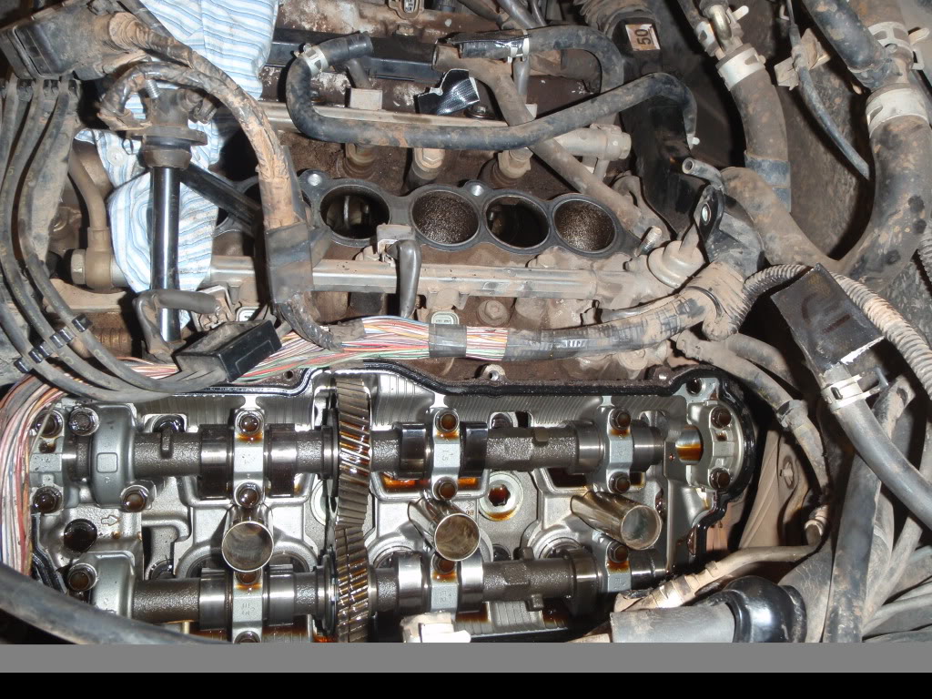

So over the last few days I've been tearing into the 4runner, I've replaced the leaky valve cover gaskets, old spark plugs as well as the leaky oil pan. I'm happy to say I am all caught up on my maintenance.
The valve cover gaskets wern't too hard to replace, just lots of steps and lots of hoses to keep track of.
I've never seen such clean valves during a valve cover change, usually there is at least a little carbon and sludge buildup, but there was absolutely zero on mine. Even after 240k miles, she looks like new.

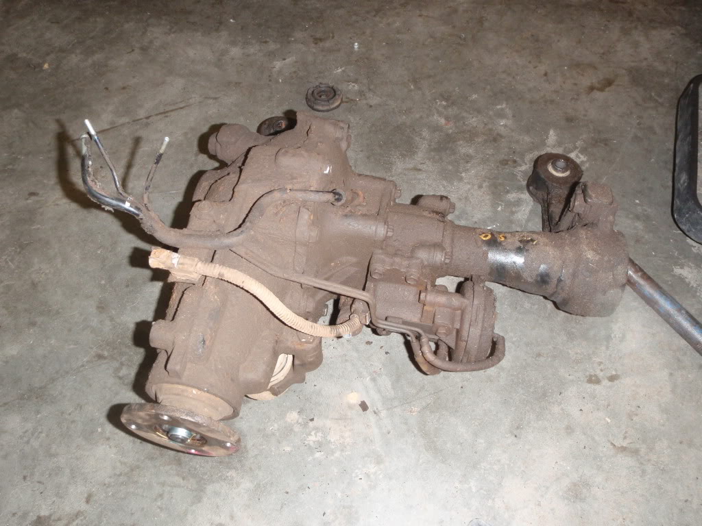

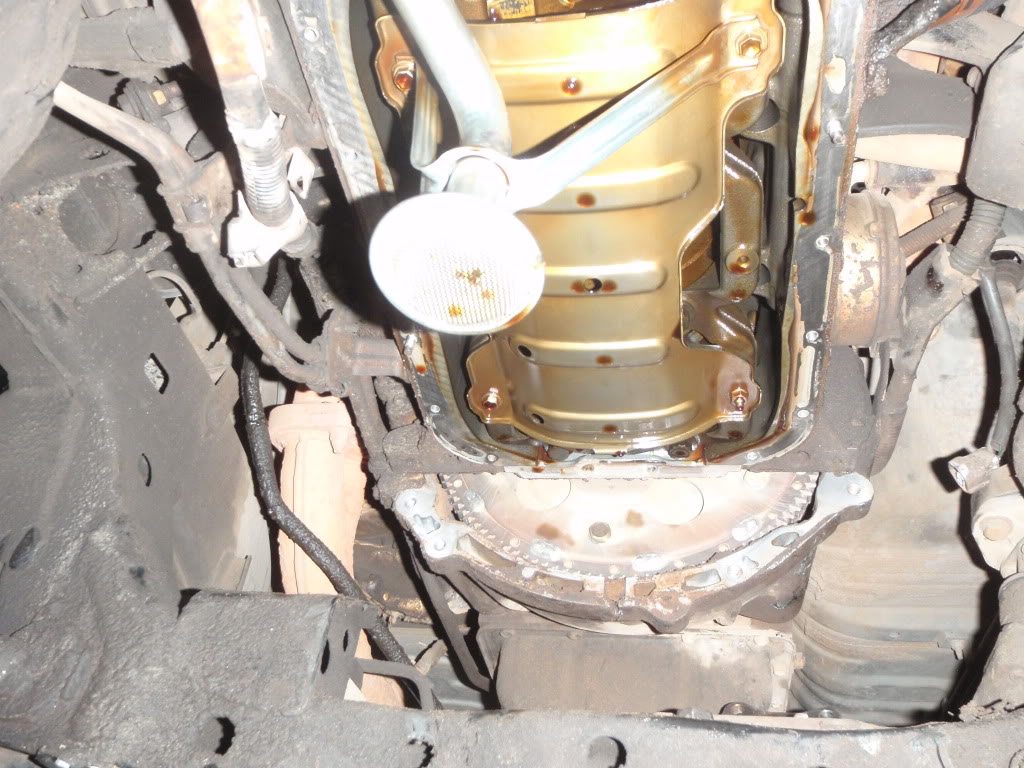

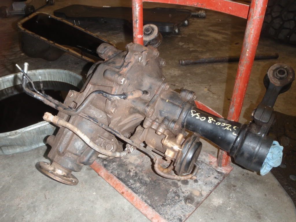

The oil pan replacement was not at all like the valve cover gaskets, it was a complete pain in the ass. Trying to wrestle that greasy front diff out was a nightmare, it took me over 3 hours.
Covered in a half inch of grease and grime
Cleaned up a little
No gunk above the oil pan either
I had the genius idea of replacing the gear oil in the diff before I mounted it back up, so I had to deal with over a quart of gear oil pouring all over my face while I mounted it back up, I'll have to fill it up all over again tomorrow. I'm just glad it's done!!

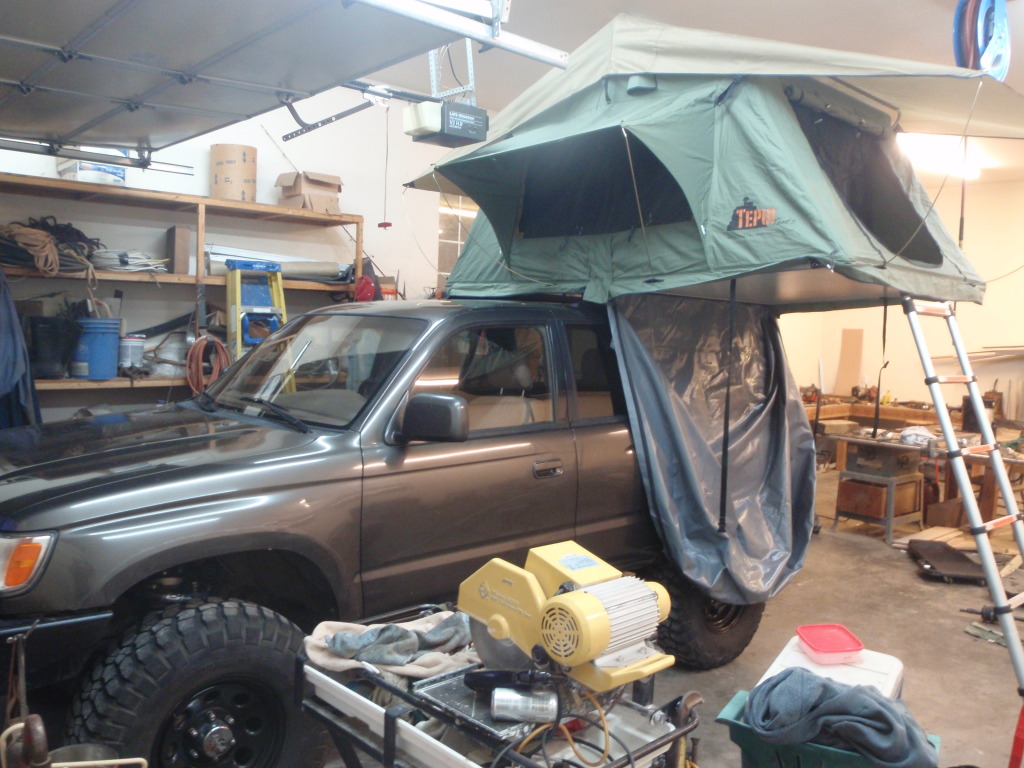

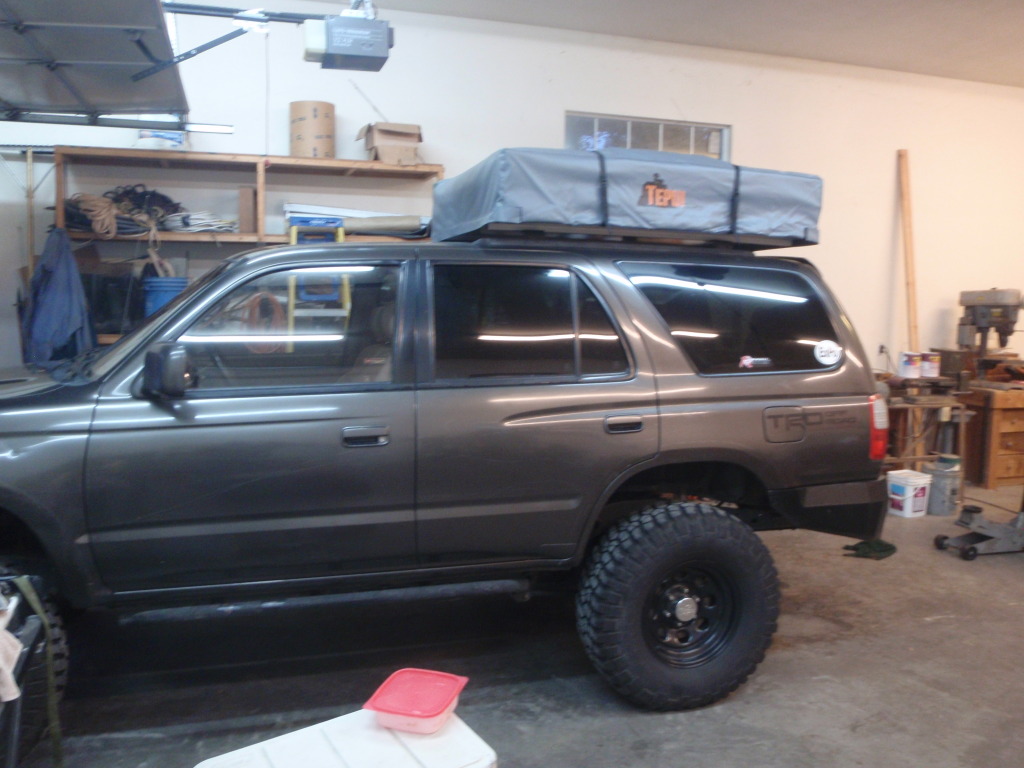

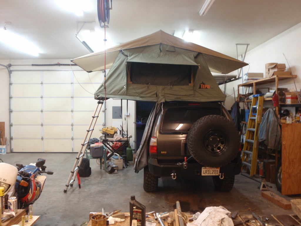

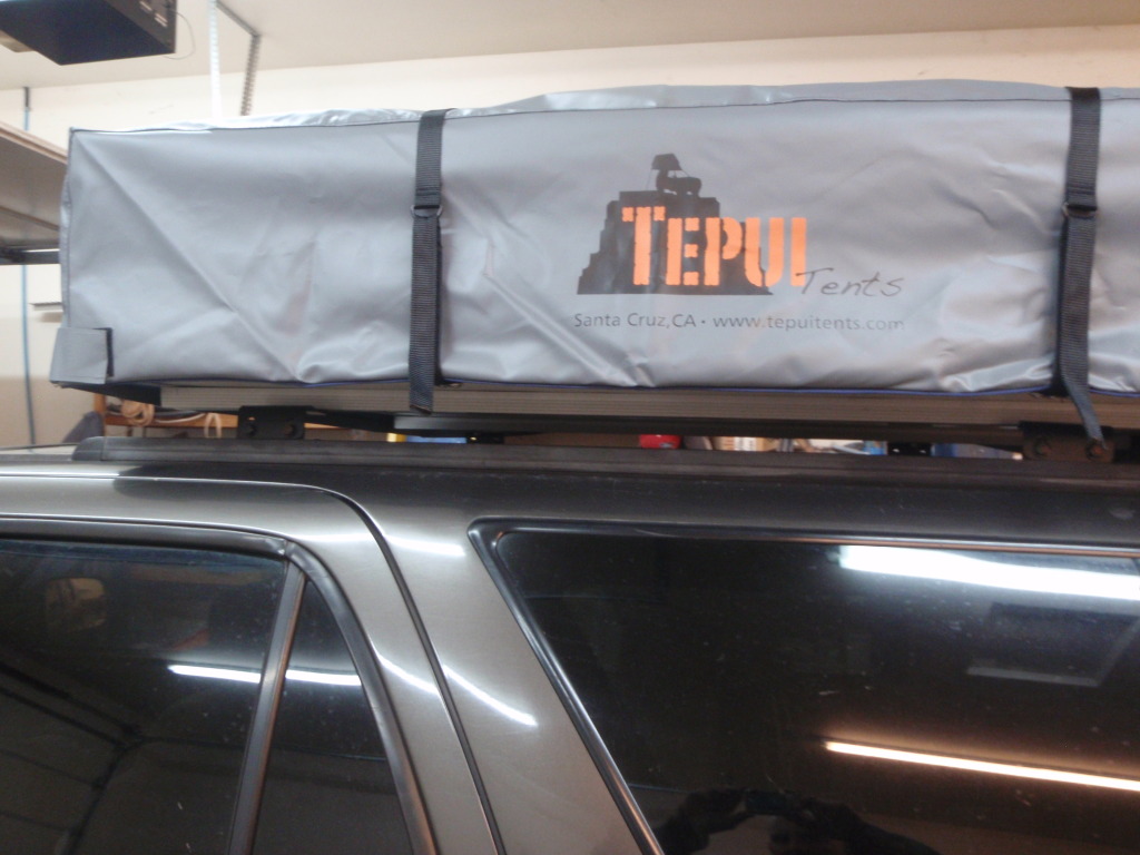

Yesterday I drove to Santa Cruz to pick up my new Tepui Kukenam rooftop tent. I'm pretty stoked on it, now I won't have to worry about where to sleep on my upcoming trip.
It's mounted to Defender rack mounts, which makes it sit really close to the roof as you can see, which is nice.

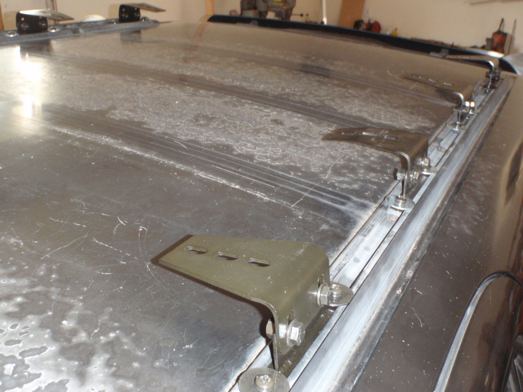

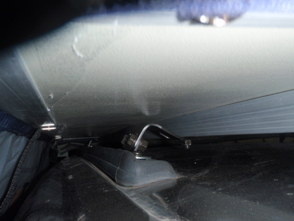

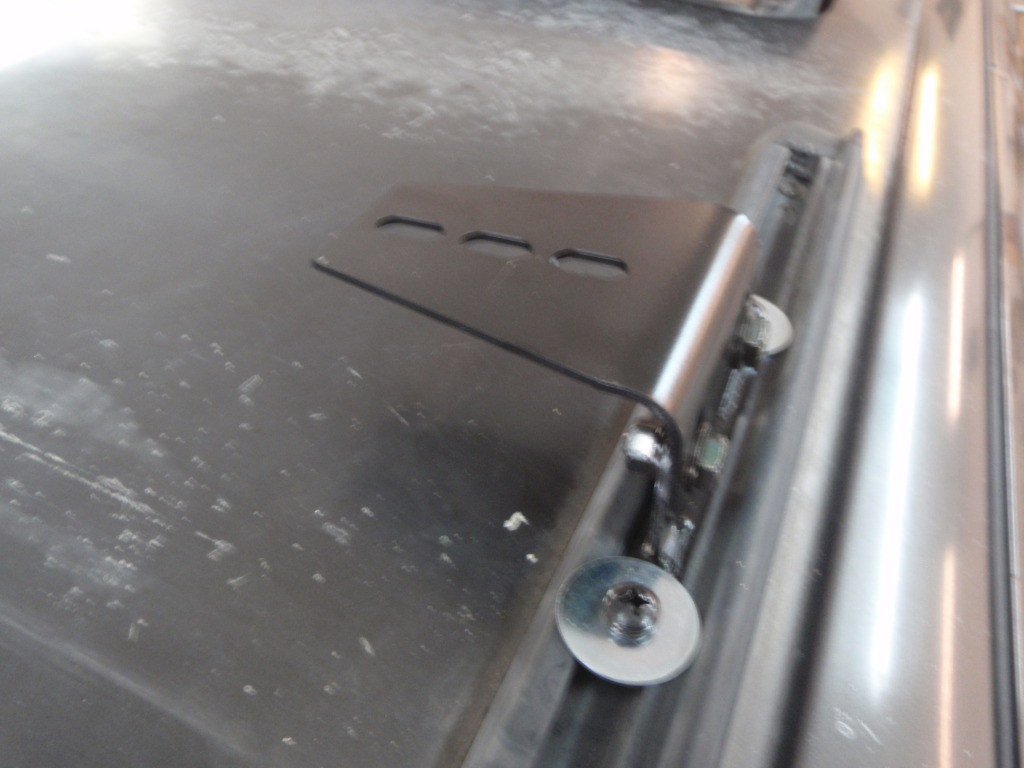

Here are the mounts. Others have said only 4 will do the job, But obviously they must weigh 100 pounds because the mounts don't like my 185 pound self. I'm ordering 6 more, so there will be 3 more on each side before I actually try to stay overnight in it.
So far I'm really happy with it, I don't even know it's up there on the highway except for my gas mileage going down a bit.

Originally Posted by racerflea
Looks good how many mounts does the mfg suggest
Well it's built to be mounted to crossbars, and usually it mounts only in 4 places. I have heard of people doing it this way instead with only 4 mounts, so I figured it would work fine. Definitely not though! A few more mounts should fix it no problem.

New mounts on! 4 on each side instead of 2, no sign of bending yet.
Slept in the tent last night for the first time, once the sheets and comforters are in there it's gonna beat the heck out of my double bed in the house!
