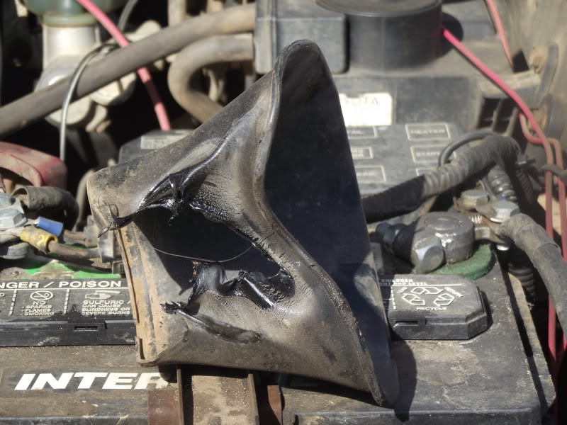

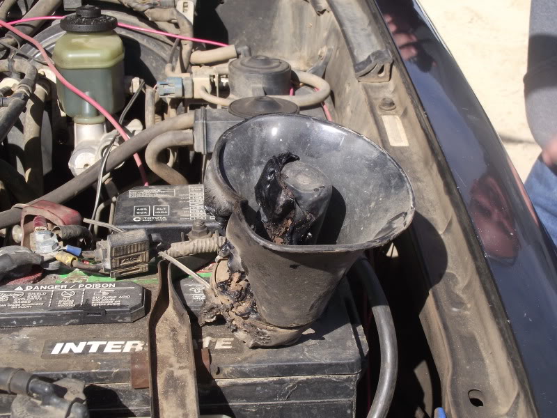

Had a great time at Surf and Turf, had a few mishaps though. First of all, my PA came off it's mounts on the inside of the fender and got lodged up against the headers. Started smelling burnt plastic and smoke coming from under the hood, I expected the worse. Had to laugh over this one. Funny thing is it still works!

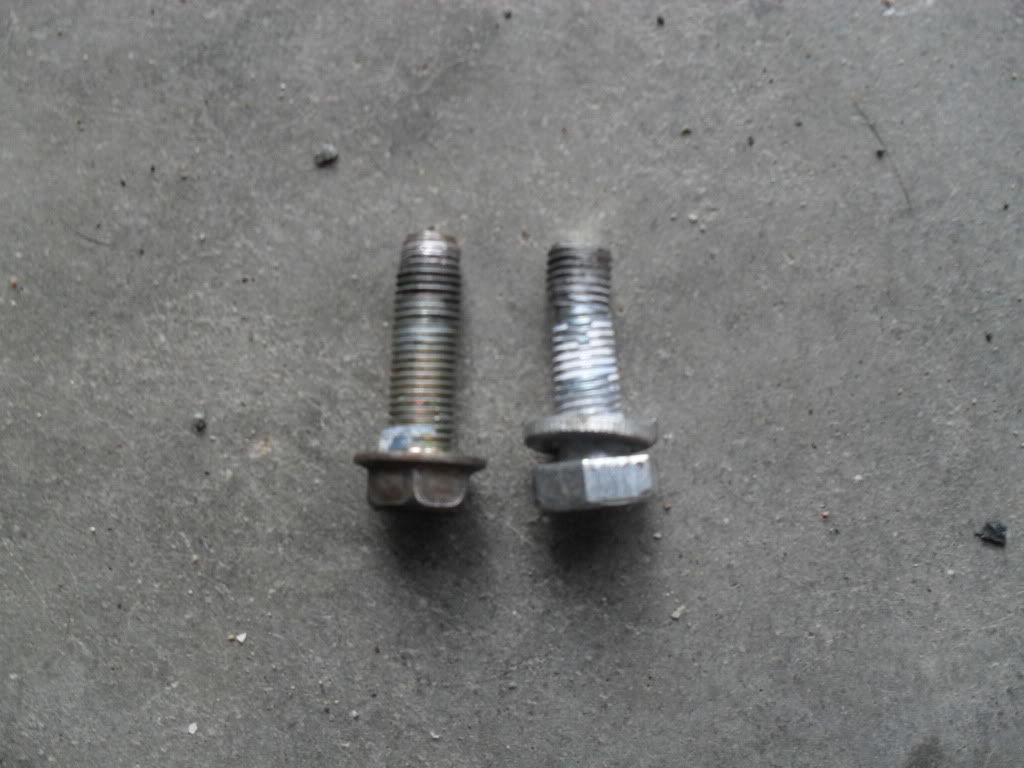

Then my lower ball joint bolts took a dump. I'm guessing the constant mobbing on the dunes at 65 loosened them, then a hard hit to a foot tall ledge on a midnight taco bell run tweaked them. This has happened before, I blame cheap bolts. The Duralast ball joint bolts came out on my last pismo trip, and I replaced them with Ace hardware bolts. They just wernt designed for these kind of forces.

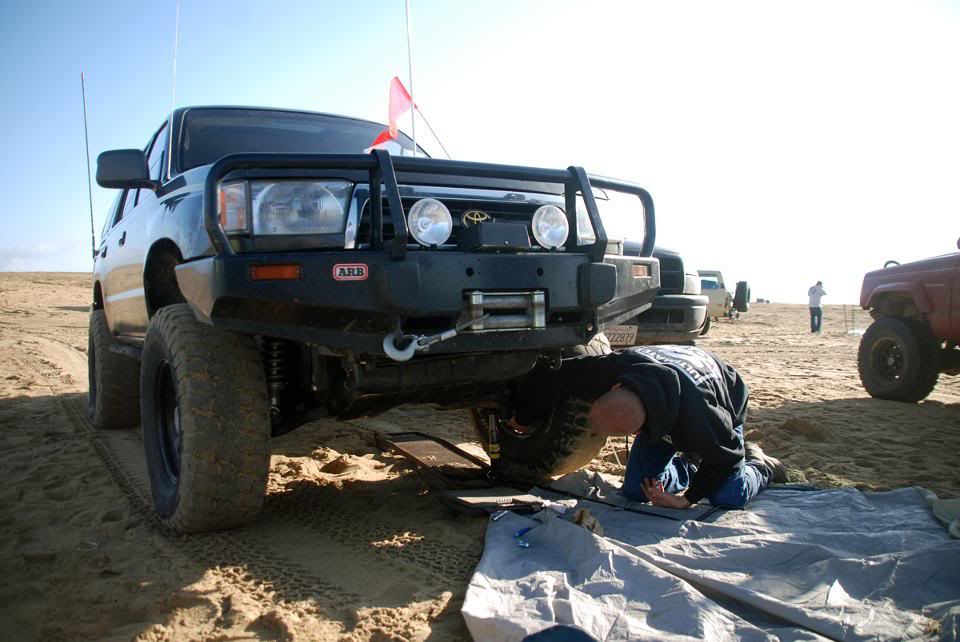

Inspecting them on the morning I discovered the problem

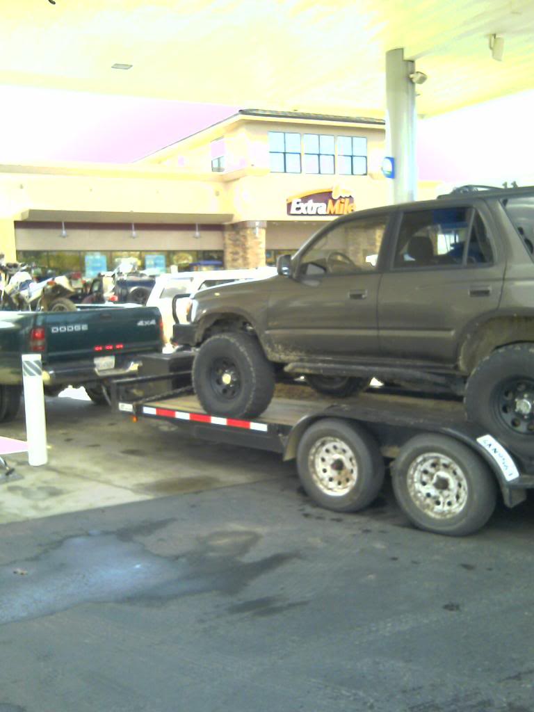

After I determined it wasnt safe to drive 250 miles home, I got a free ride

So heres what the bolts look like afterwards.
The one on the left is one of the bolts that came with the Duralast ball joints. I replaced it with the one on the right, which is from Ace Hardware. Both failed obviously. While in Utah the last week I swung by a Toyota dealership and picked up all new grade 8 OEM bolts, so this should solve my problem. just glad the threads up inside the spindle wern't damaged.

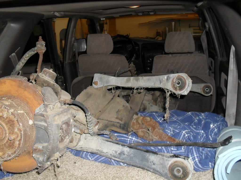

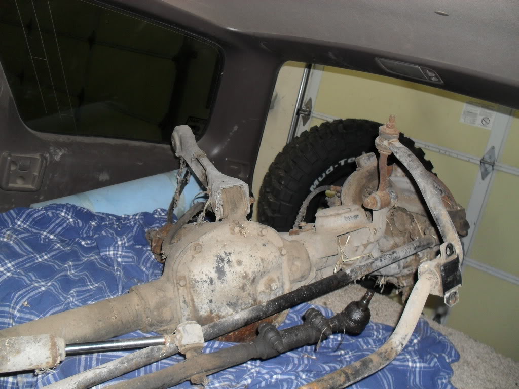

Picked this little guy up today
It's a Dana 44 out of a Jeep Wagoneer, exactly what I'm gonna need if I SAS this thing. Not saying thats the route I wanna go just yet, still got my head wrapped around LT. But at least I have it
Tossing it in the pile of other stuff I've accumulated for future projects for the 4runner.

wanna sell me those UCAs? lol nice find can still sell that for good money later if you decide LT its perfect width for anyone doing a sas on a toyota
If I SAS this thing, I'll GIVE you the UCA's for all the help youve given me and being a good friend over the years lol.
