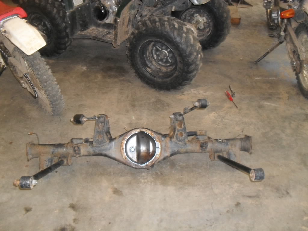

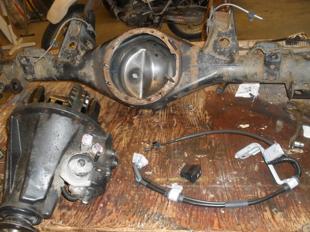

Locker is in...what a PITA that was. Mostly because all my rear suspension is old and wore out and I'm sure everything is a little tweaked from all the wheeling.
Here's what I started with

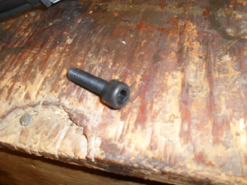

I swapped all the axle studs with button head allen bolts. I've heard of peoples diffs actually pulling out from the housing under high stress, so these will prevent that from happening.

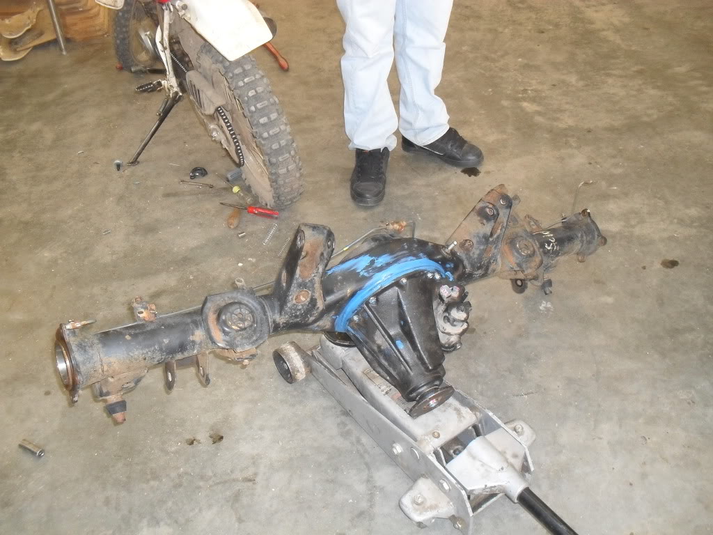

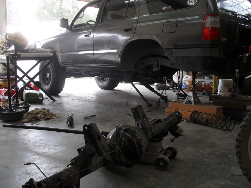

All torn down, pretty much wore out by this point lol
The new setup. Don't mind the crapload of RTV...shortly after sealing up the diff, I realized I forgot to put the oil deflectors back in the axle. So I had to open the whole thing up again and put even more RTV on. It was a blue nightmare.
Eventually my brother wandered out of the house to help me out. Then friends started showing up randomly. They stood around with beers in their hands for a while, then they eventually helped reassemble everything, which I am really thankful for.
