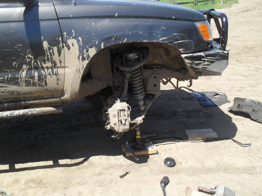

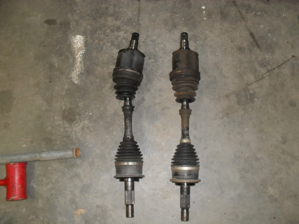

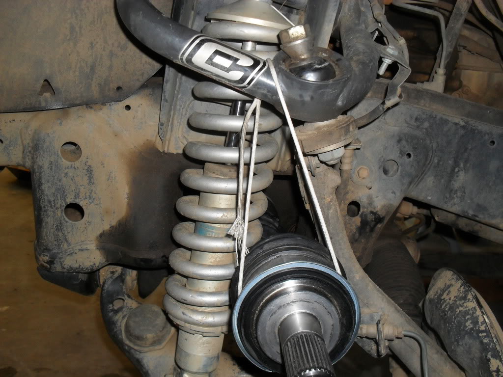

Been busy with the 4runner lately. Last month at Hollister Hills, I snapped both CV's in the obstacle course. We replaced one there at the trail with a spare, and I was able to get home on the other one being broken.
The goal was when replacing both CV's back home, to remove the front diff and replace my leaky oil pan. The 12mm allen bolt on the front diff had me stumped, as no stores around here had an allen wrench that big. So all I could do was replace the CV's and call it a day.
Trail fix
Original CV on the left with 230k miles...suprised they lasted this long!
New ones in...the paracord helped hold them up while I whacked them in

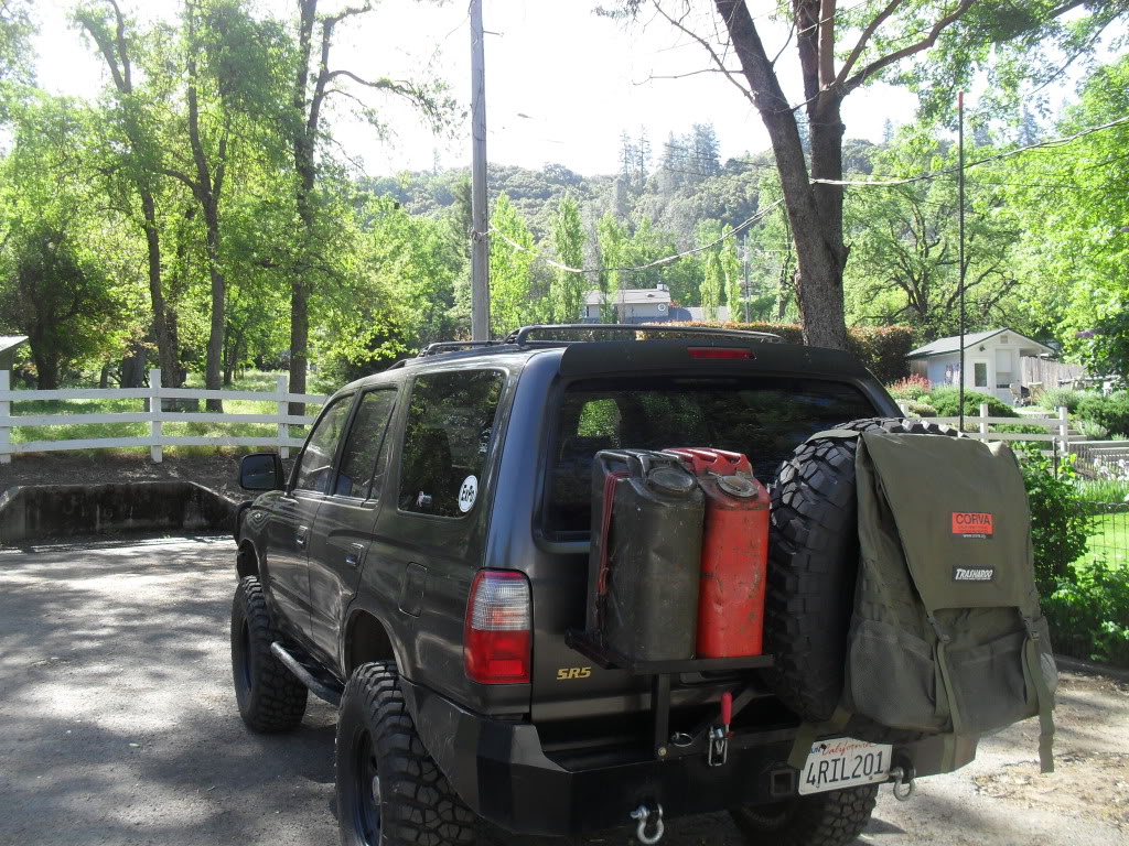

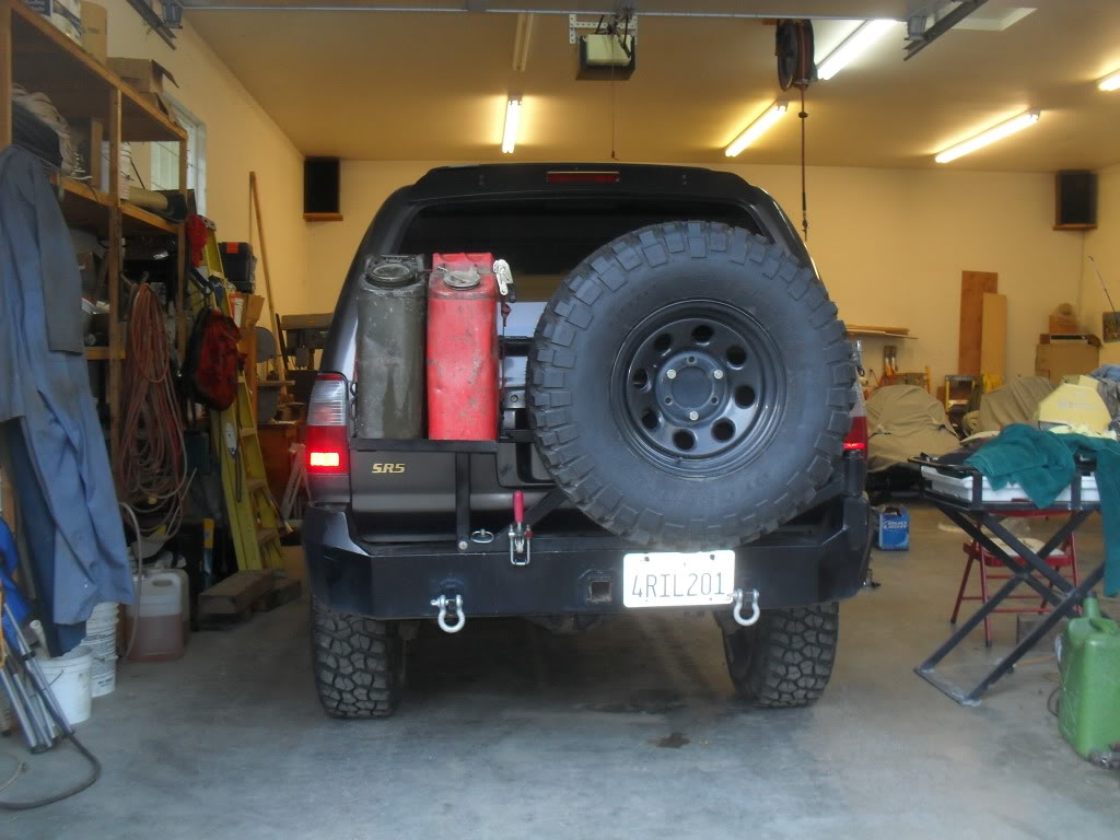

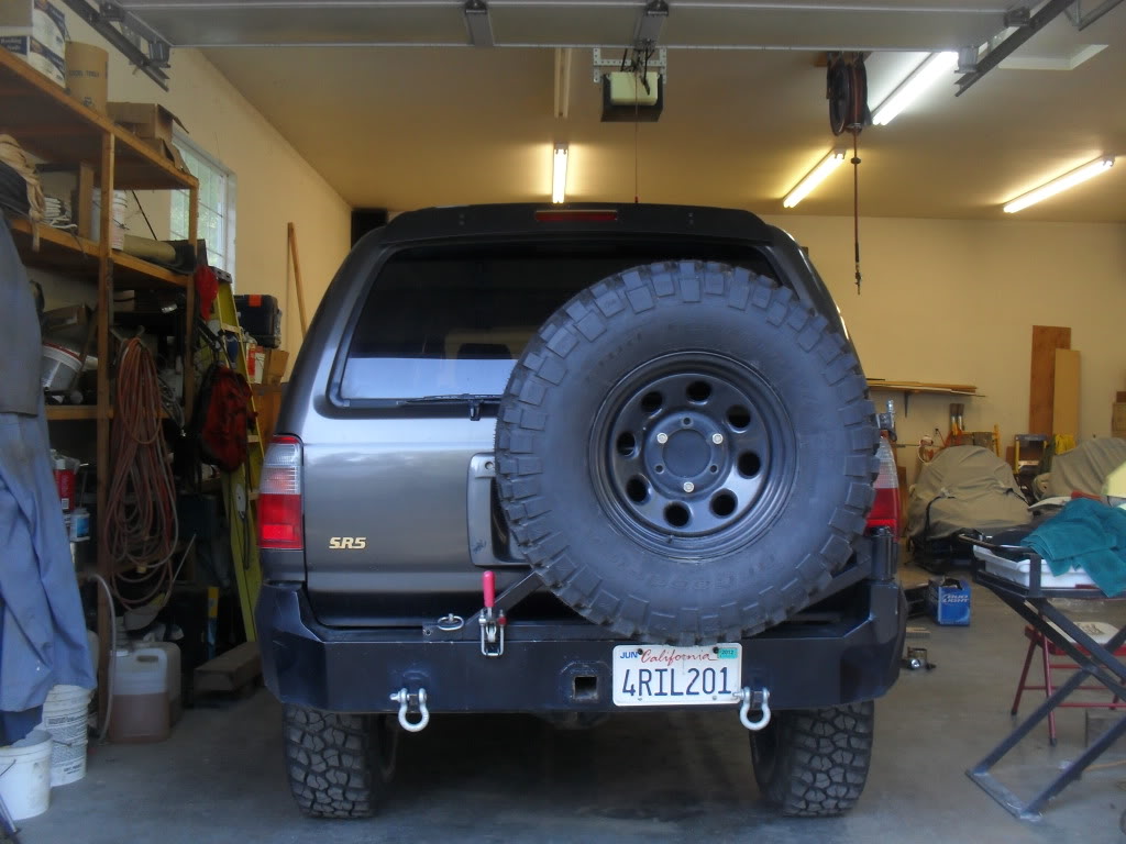

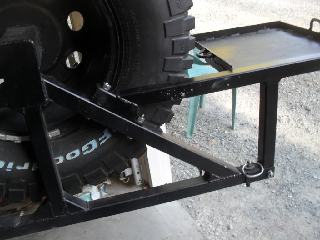

I also built myself a dual jerry can carrier. I wanted something I could take on and off, as I didn't want to drive with it on everyday. After a little fab work and tab making on the tire swing out, I created this...
Completely bolt on, it only takes 2 minutes to take on and off the tire swing out.
Tire only
Jerry can mode

What about a plate between the two and maybe a bar on the back going from the top of the plate to one of the corners. Help give it some more support when they are getting slammed side to side. They might roll over still in some heavy thrashing. I guess Utah and Arizona trip is a good test though. Is that still my old ratchet strap?
Old May 12, 2012 | 10:07 AM
  #254
stockwell45's Avatar
Joined: Dec 2007
Posts: 1,144
From: Sonora, CA
I have thought about that, and I figured if I had any problems on this trip with it, it will really get beefed up. I made a super strong 4 pass fillet weld on the base where it connects to the square tubing, I don't think that will ever break. I was hoping to make a slide out counter under the carrier, so hopefully it stays strong and I can keep that space free.
And yep, that is your old ratchet strap. It has come in so handy for me, thanks again for it!

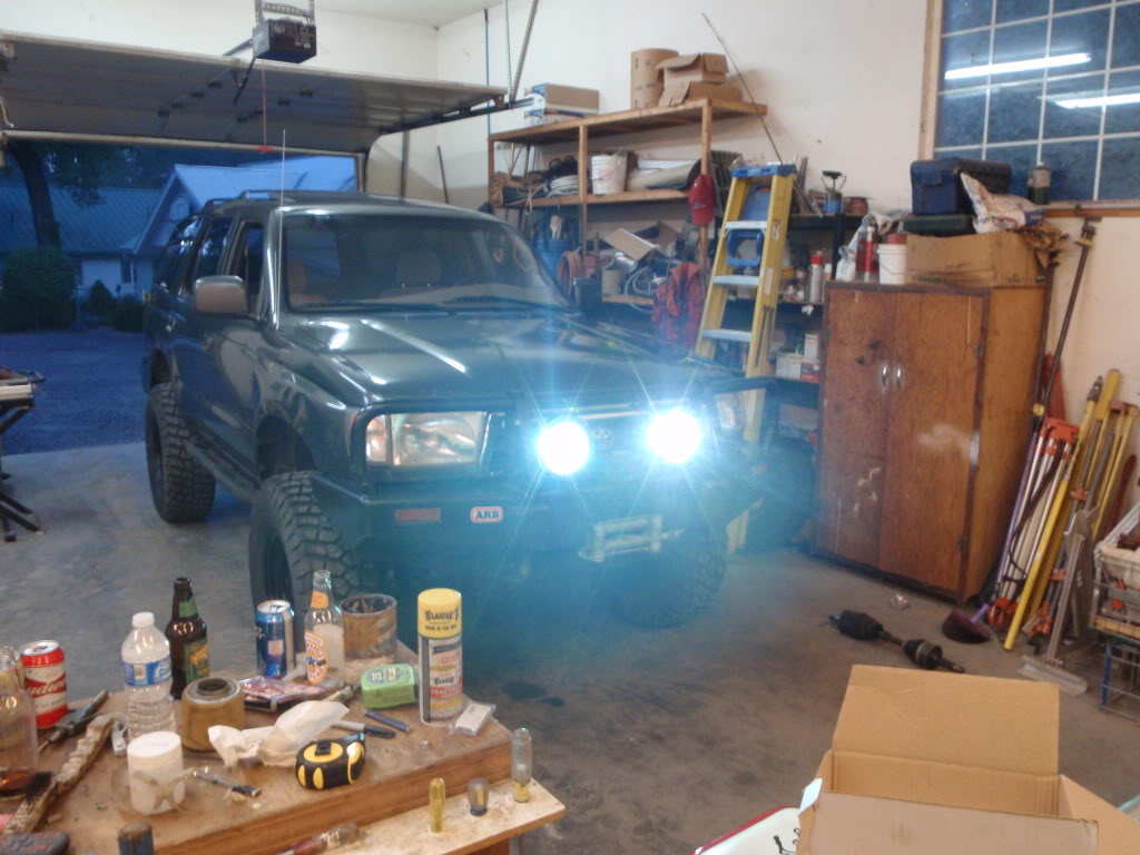

I got some 7" HID flood lights at the expo. HID's really arn't my style, but I couldn't pass them up for the price. They really do light up the night too.
