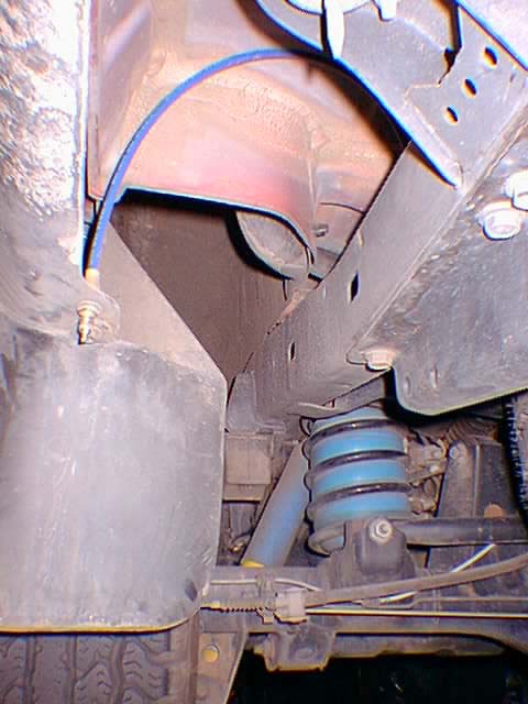

Air bags actually go inside the coils. Basically, you disconnect the rear antisway, jack up the truck with two jacks, one under each spring seat, then lower one jack. The lowered side spring just pops out and you install the airbag. Depending on model year, the axle bump stop has to be cut per the instructions which came with the airbags. It's not a difficult job, took about 1.5 hours (I work slow) to get the airbags in, and another hour to route the hoses. Just behind the rear mudflaps are holes in the bumper, a most convenient place for the air valves.
Mine are TRD (Firestone) air helper springs from RomaniaToyotaParts.com

I debated going to different springs as well. What I really wanted was a stiffer spring with unchanged ride height. Couldn't find any, so I took the airbag and HD Bilstein shock route. Been working for 2 years, and I like them.
