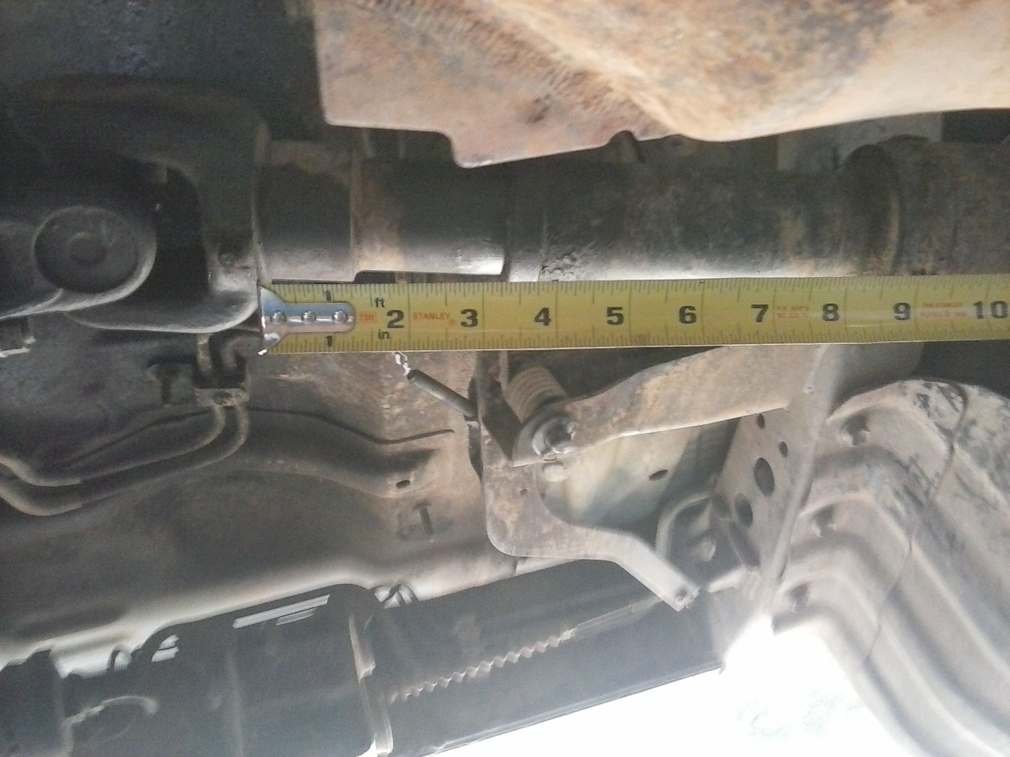

Rear driveline

A few questions about these pics:
The tire is clearly hitting the frame on flex in the rear. And the shock is only out about 8in. Could this be what is limiting my rear flex and causing to hang the tire so much?
So my original post that the shocks were limiting the flex I don't think was right because the shock is only out about 8in.
Or maybe a 2in. block would help give me a higher lift and more flex?
There are a few other things about the 2in block lift that I'd need longer u bolts and hopefully no extension on the rear driveline (which the slip is out a little more than normal now too).
Some facts: No bumpstops, wheels 4in back spacing, front 1in wheel spacer, no wheel spacer in rear, this lift was copied from another 4runner that was running 38.5x14.50 tires with the same back spacing I believe while my tires are 37x12.50.
My front shock isn't out as much as it can go either so,
If the up travel is as high as it can go does that limit the down travel on the other side?
(Front and rear shocks show about 4in-4 1/2in when its sitting level)
EDIT: I just noticed the rear chevy 63 spring is negatively arching a bit lol. No bumpstops. I'm not too too worried about it but it does look like it has bent the second leaf down from the top one. If I were to put on bumpstops the tire wouldn't even go up into the wheel well as much and would it also give me less flex? Lmao this thing was not set up that well and I know it but it was the first thing I've ever built and I love wheelin it. I guess another option is grab another set of springs when these start to negatively arch sitting level. And I'm thinking this set up will be about the best I can get it. I just know the front end can do a lot more than the rear and wanted to try to get more flex out of it.
