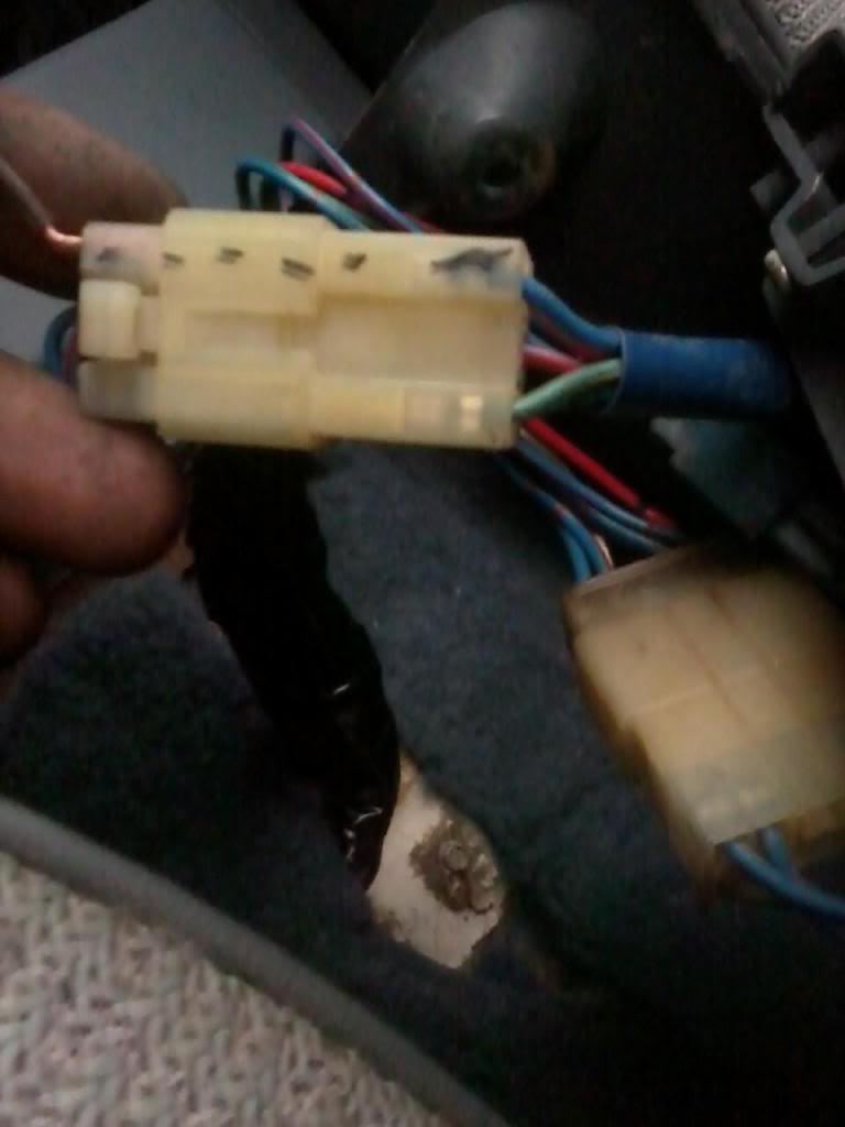

The safety switches cause alot of issues on these trucks for the back glass. I run a ground wire from the plug to the front mount. The rear console mount has plastic and is not grounded. I have never gotten the rear key to work. I just use the inside switch.
Running a ground wire from this wire on the plug, the blue wire to the place on the pic below elminates a lot of problems.

Ground to center consloe mounting tab.
