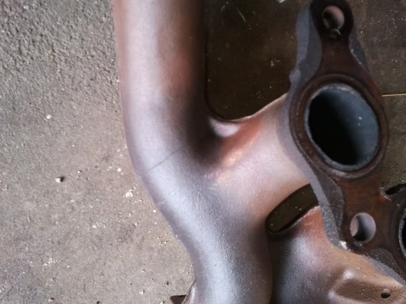

So, much thanks to all of the posters in this thread. It's been a great help! So, my 1995 Tacoma 3RZ (2.7l) cast iron header is badly cracked. I researched on this thread, and thought the consensus was that a 2001-2004 2RZ (2.4l) mini header would bolt right on my engine. I found one in a junkyard, and had it mailed to me. Upon inspection, it has a different (triangular) flange, and only one opening. Mine, and all the other ones I saw online, had two openings, and used two donut gaskets.
How did I screw up? Did I get a CALI header, which is somehow different than a federal header? Are they not actually interchangeable? Any advice would be greatly appreciated. Thanks!
My newly purchased header:
You were sent a California emissions header.
You need one from a federal emissions vehicle.
I sell them here: https://www.yotatech.com/forums/f37/...ilable-179930/

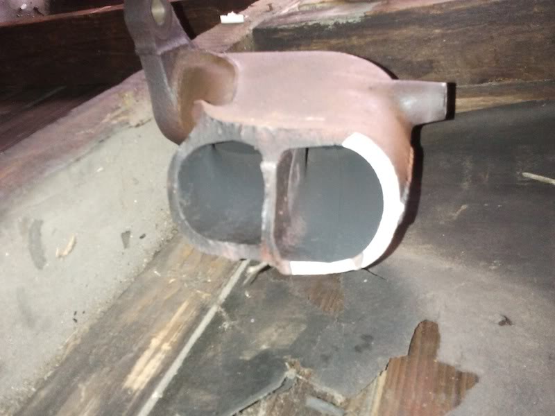

Hey all, my first post here at Yotatech. I'm glad I found this site - I was able to find DeathCougars ad for the "mini header" kit and ordered one up for my '99 3RZ Prerunner. I was considering a long tube header, but I really didn't think the extra cost was worth it. I mean, they are cool and all, but considering I don't pull anything with my truck, and in an attempt to save gas, I rarely go over 2000 rpms anyway, so I don't know that I'd take advantage of any possible gain a full long tube would provide.
Anyway, the install wasn't too bad; it was pretty straight forward, common sense stuff, if you've ever played around with cars and trucks before. I had no problem loosening the rusty nuts and bolts, but I did shoot them with PB Blaster the night before. You can do this with typical handyman type tools, although I wish someone would have told me to pick up some of these "reverse torx" sockets first.
Very handy, especially considering that the old manifold has torx-head bolts pointing in 3 directions - made it a little tricky to take apart. I also didn't disconnect the downpipe bracket from the trans, something else that would have made the job easier. I'm convinced I could have done this in 1/3 the time with those two simple tips.
After the install, my truck immediately ran smoother and idled a lot lower. I've only filled up the tank once since then, and the mpg is slightly better than average, but we'll see how that plays out over time. I can't say it sounds cool now, but at least it doesn't sound as bad.
A few pics and a telling video from my install. I didn't know how bad the crack was until my "kick test." This was not done with steel toed boots either...

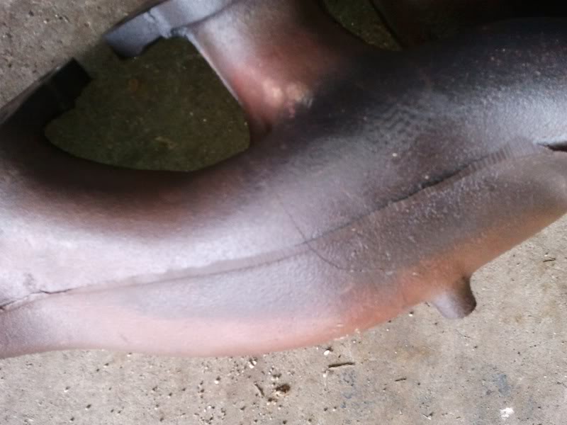

The stock mani, with the telltale crack
The crack went all the way around the casting

My "how cracked was it" demo
[YOUTUBE]http://www.youtube.com/watch?v=SDxx2vC5Uq8[/YOUTUBE]
Look how much of it was cracked and leaking. The bright "clean" part is what I just broke. The dark / dirty rest of it had been leaking for who knows how long.
