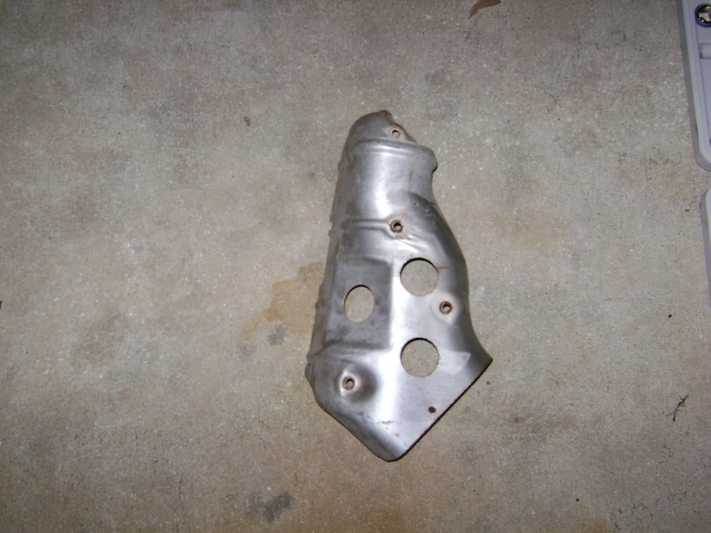

So this all started the other day when I was driving down the road with the windows down and the music off.
I was driving past some of those concrete highway dividers and heard the tell tail sign of a exhaust leak - tick tick tick
after further lissening (standing next to truck as some one drove) it was true
Since I have the 2.7L I knew it was the manifold.
After a brief time and a few choice words I found this-
heat sheild

I will be getting the exhaust mainfold from a 01+ 2.7L
they are like a mini header that bolt right up to the factory down pipe
part# 17141-75080 this is a direct bolt on they run around $150 from the dealer
