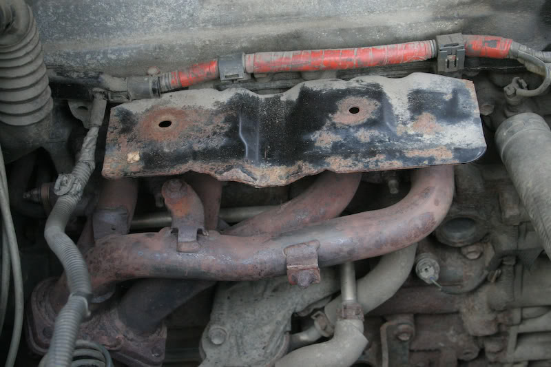

yeah. i was planning on doing this so i took my heat shield off today hoping to find a crack in the cast manifold. but to my surprise, i found that i already have the mini header, weird....but i'm not complaining
heres a picture

Do you have CA emissions? All 2000 vehicles with LEV cert (AKA CA emisions) have that header.
