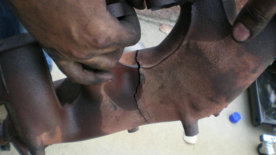

I replaced mine with LCE headers when I bought it. It had a giant crack. I ripped it in two just for giggles with my bare hands (have the video, if anyones interested ill put it on youtube).
