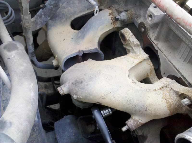

thought id post this pic... gonna look for a used mini header. this is on my 99 tacoma at 173,000 miles. the head is cracked and i think this might have been why the head cracked
so will the 2rz manifold work?

2RZ and 3RZ use the same manifolds. But the manifolds are JUNK.
Shoot me a PM or call me when you want to upgrade to the header conversion. No more cracked headers, no more burned valves, no more cracked heads
If you ever talk to someone fixing a head issue on a 2RZ/3RZ, they are always repairing Cyls 2 or 3.
