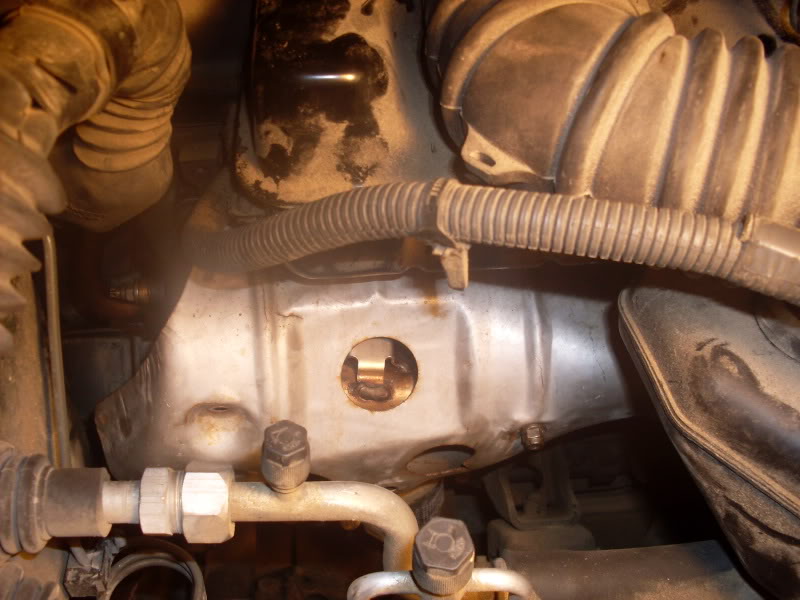

Here's some pics of my swap, nothing out of the ordinary..
Yes, I took the down pipe off because I thought I saw a hole in it and I was going to weld it up..

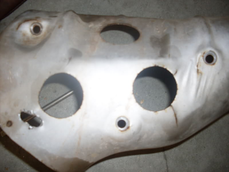

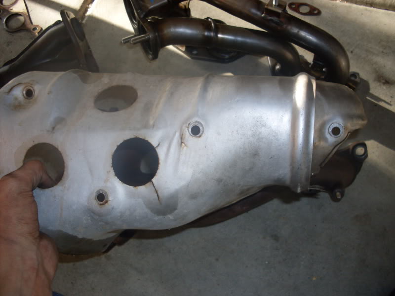

POS

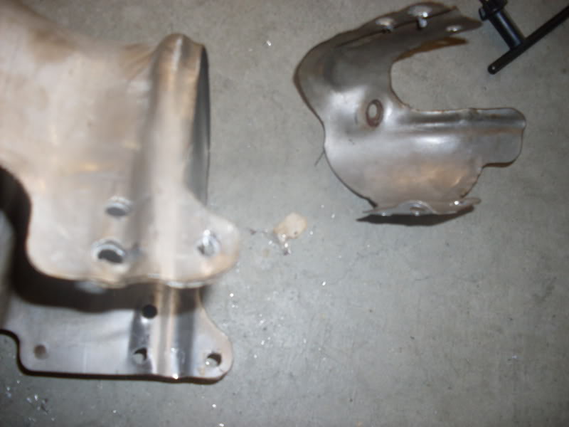

Here's what I did about the heat shield holes not lineing up:
The part on the very right of the shield in this picture needs to go.
After you drill out 3 pop rivets on each side:
The hole on the right is reused, And you can see my crapily fitted and drilled hole on the left..whoops..

Took me like 4-5 hours, just kept having little things go weird, I did soak all the bolts I planned on touching in PB blaster for a couple days prior to today..
Nothing really went wrong, Im dehydrated like hell cause I dont like to stop working and pickup a waterbottle, oh well.
