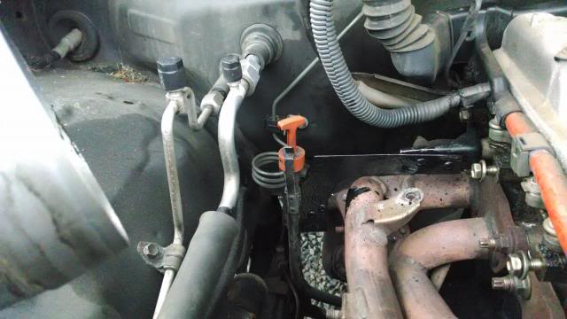

Ok I got it fixed, took a few tries
Heres the original problem

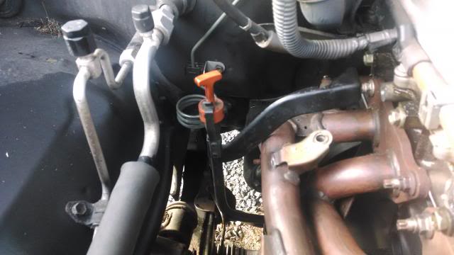

I decided to try to grind/cut out the bracket down

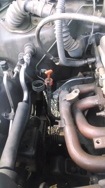

Still not happy because it was still touching the header so I had to take a more extreme measure and remake part of the bracket
It was probably overkill and I probably could have just removed the bracket and been fine but I feel better with this solution. And yes I know my valve cover is leaking, that's the next of many projects

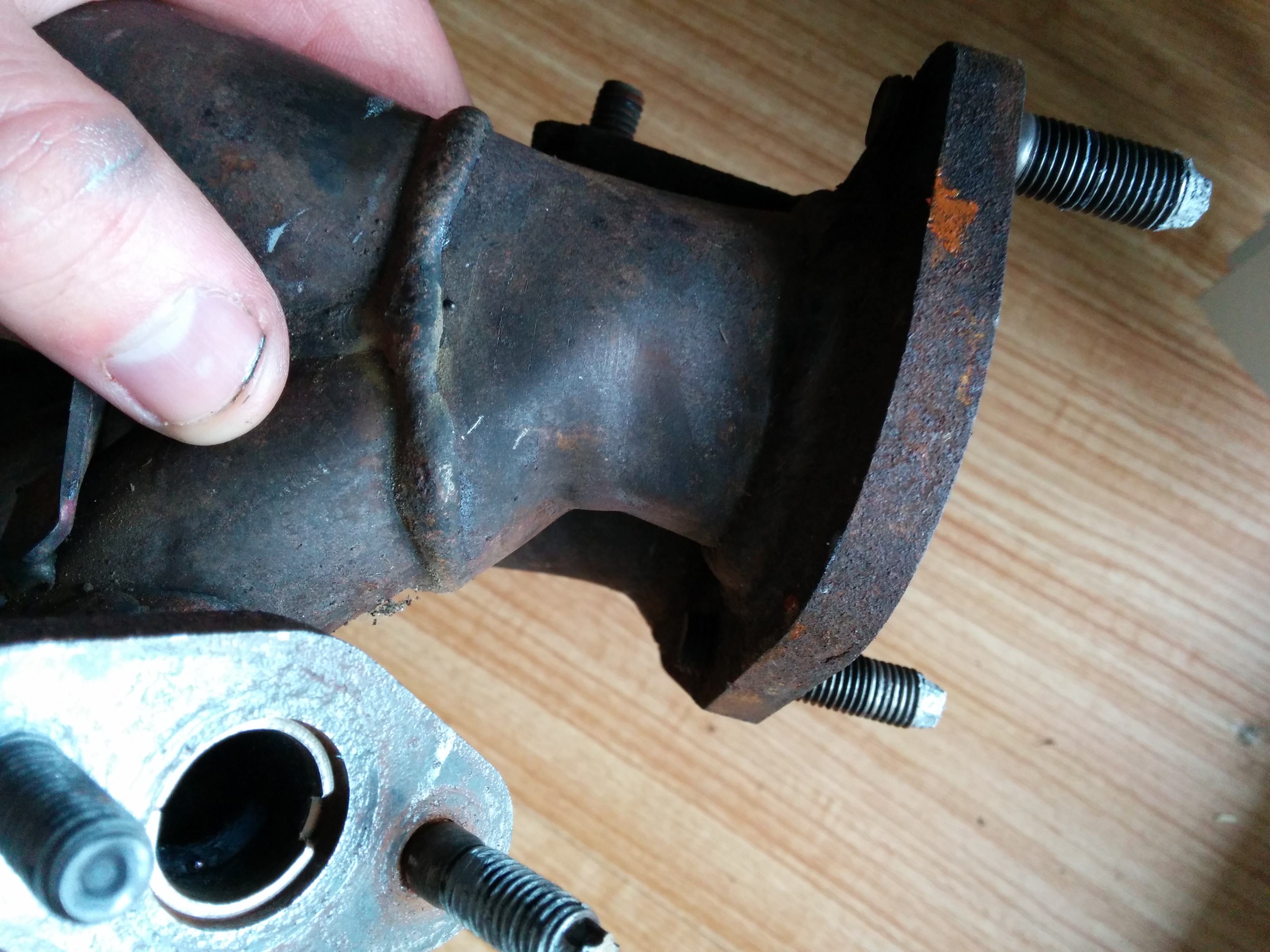

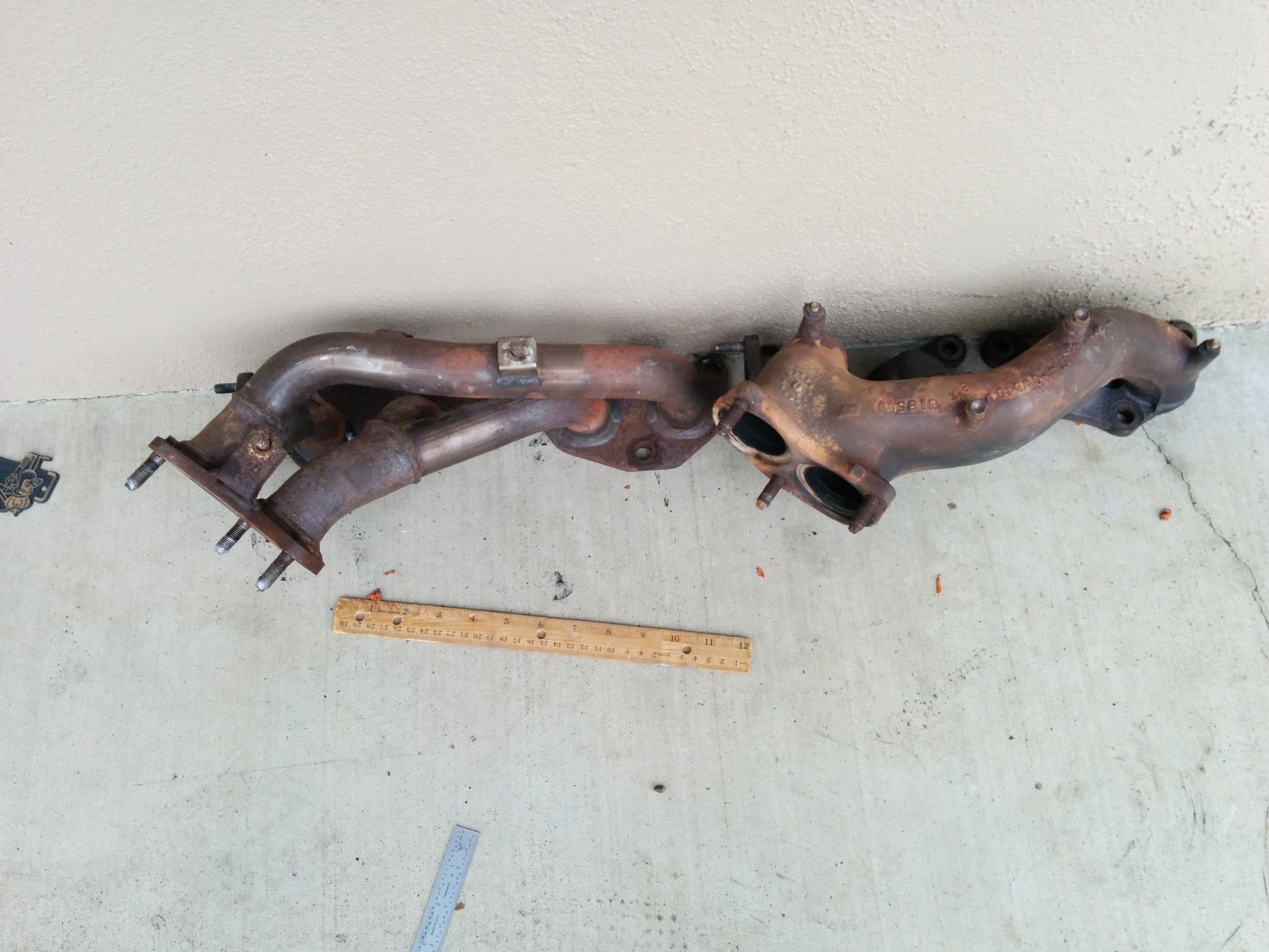

The yard told me the mini header came off of a 3rz prerunner, even gave me the vin number.
so I took off the mini header manifold and lined it up with the old manifold. although very similar there were a few key differences causing problems for me. First, the horizontal distance between the outlet flange and the head flange is about half an inch smaller on the mini-header and second, the angle of the outlet flange is angled toward the engine more (by a few degrees). It almost seems that this mini header was bent inward.
Actually, upon further inspection, it appears that there is a bend with some buckling to on of the inlet pipes entering the lower flange... crap... seems like there was some damage when the truck was in its accident. amazing how a few degrees of damage, although almost un-noticeable, can cause such fitment issues.
Attached Thumbnails OEM mini header install for 2.7L*(Pics)*-2014-02-28-11.52.57.jpg   OEM mini header install for 2.7L*(Pics)*-2014-02-28-12.42.38.jpg
