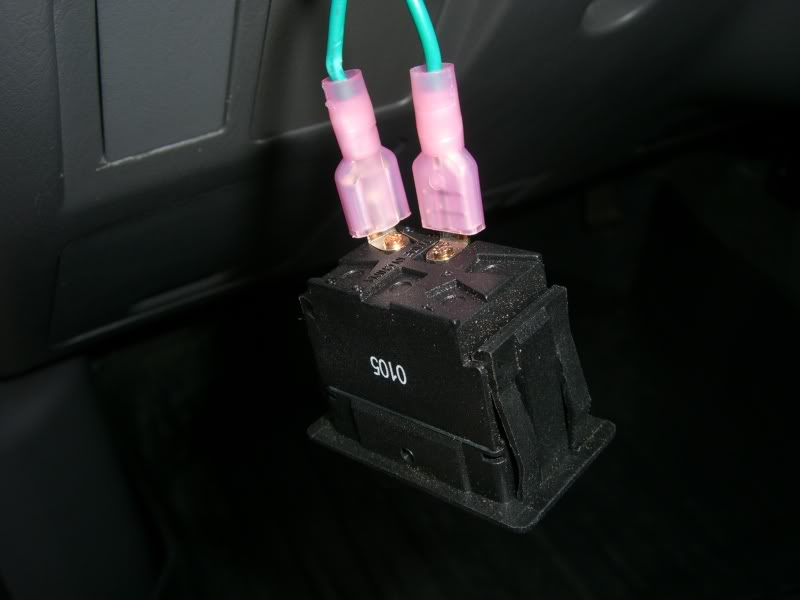

I cut this red wire with black tracer and crimped a pair of new wiring to the cut ends. (Feel free to solder these connections if you'd rather):
Attachment 185608

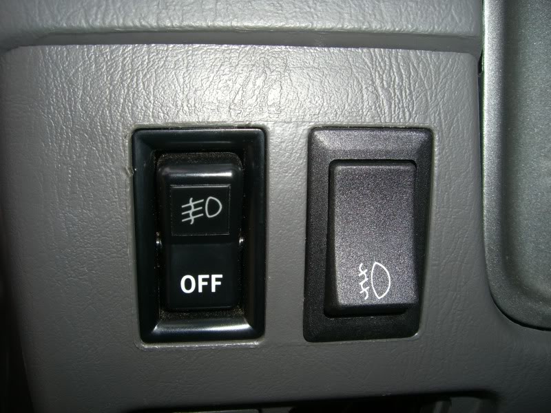

Ran the pair of wires up to my dash mounted fog light switch:
Attachment 185609
Fog Light Switch Installed (on the right). Toyota switch Part#: PT297-89013-SW:

Once the switch is installed, you’re done. Simply activate the switch in either 2WD or 4WD with the vehicle on or off. Wait a few seconds and you’ll notice both the VSC and TRAC OFF lights appear to let you know they have been disabled. Flip the toggle switch back and restart your vehicle to regain VSC and TRAC.
