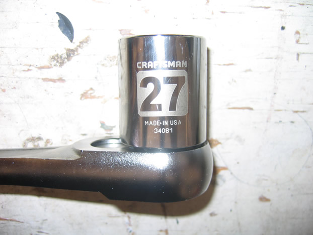

the switch is 27mm:

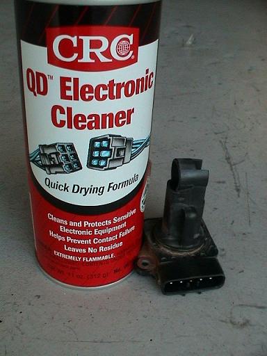

so i removed the backup light switch, cleaned it off and sprayed the prongs with the same electronics cleaner that i used for the MAF:

wow, 27mm is huge for that little switch, I don't even think I won a 27mm socket.

yeah i had to buy a 1/2" ratchet and 27mm socket just to do this...but i had been needing a 1/2" drive ratchet for way too long anyway.
