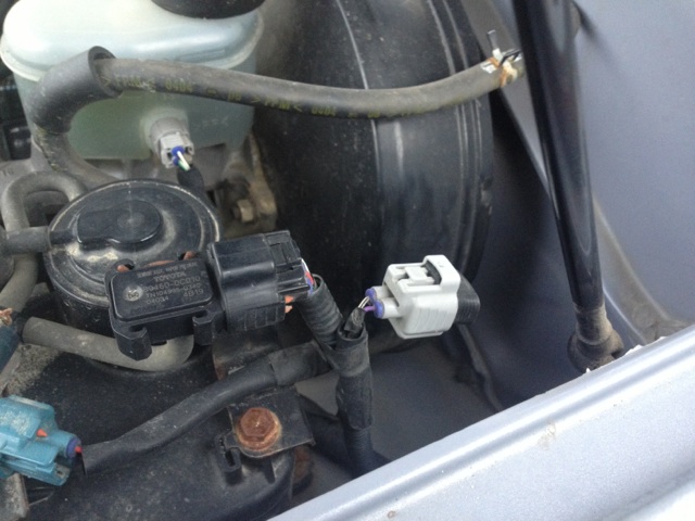

What is the white connector for?

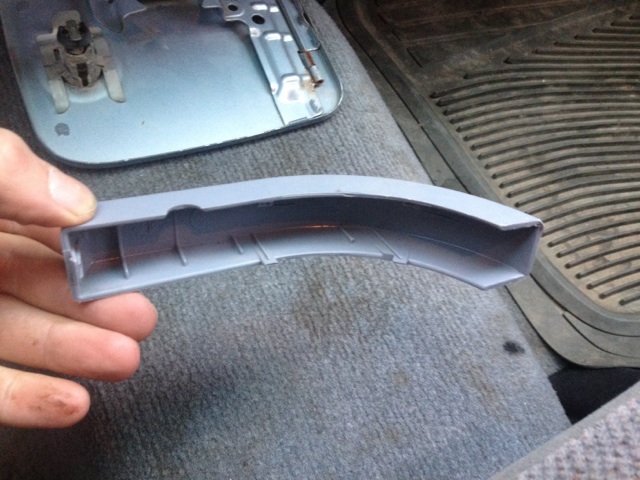

This was under the rear seat. Any idea where it goes?

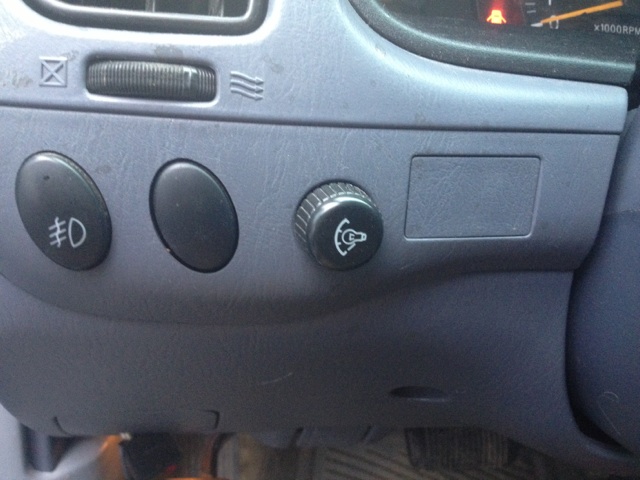

Fog lights, blank, dimmer, blank. What were the options that went in the blanks?

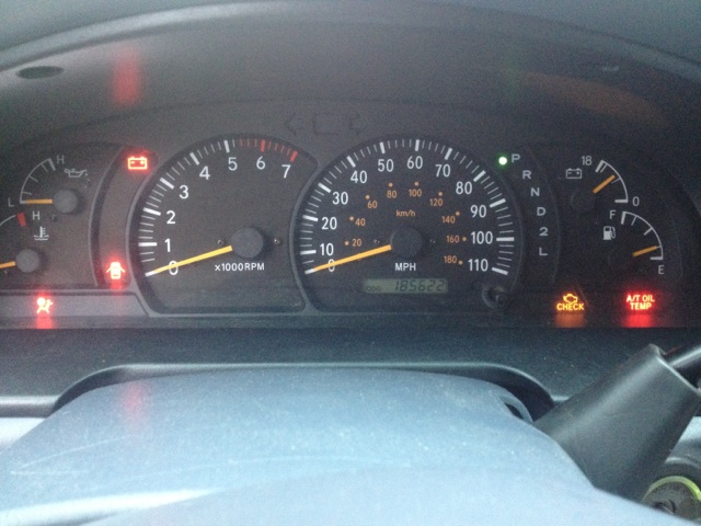

The PO said he bought this truck because it had no ABS. Was this a factory option? The ABS fuses are gone and as you can see with the key in ON position the ABS light doesnt light. Are any other lights supposed to be lit besides these? Can someone explain the not having ABS thing?

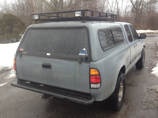

Leer cap with custom safari rack w/ back up lights on rack

I was not aware that non-ABS was an option on 4wd Tundras. I thought it was only 2wds. Did he possibly take the fuses and the bulb out?
I believe that connector, if not capped off, goes to the ABS actuator on the opposite side of the engine bay. Its a large black box with like 6 or 8 hard brake lines connecting onto it.

Thanks for the info. The connector had what looked like a factory rubber cover on it and I dont recall seeing the actuator on pass side. I suppose this would help

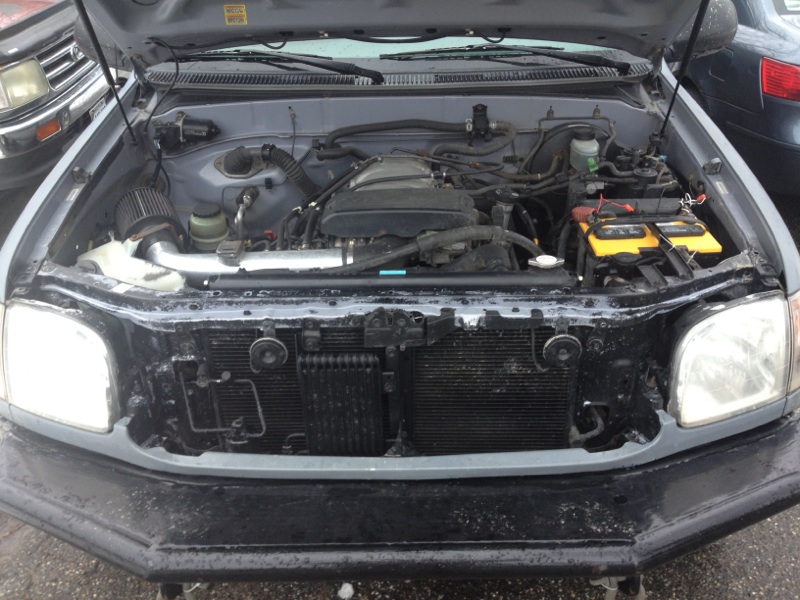

Another question. On the left is that for the AC? And on the right is a trans cooler?

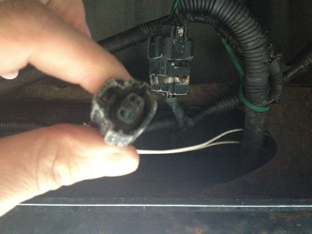

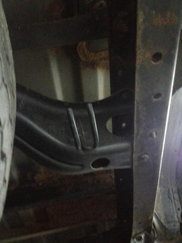

This is under the rear bumper by the hitch. Its coming off a wiring harness going from what I think would be one tail light to the other. Any idea what its for? -Note- The plug is factory and covered in wiring loom. Dont pay attention to the white wires those are for cargo rack lights.

No ABS Actuator. Its hard to miss.
That hook is a hanger point for the factory exhaust. By the looks of your first few pictures you have some kind of side-exit right in front of the tire?
Im pretty sure that plug is for the factory license plate lighting.

Oh great call with the hanger and license plate lighting. Makes plenty of sense. Yea the exhaust has a flowmaster that sounds super mean and then takes a turn and exits just behind the rear door. The pipes sit below the frame so theyre the lowest point on the whole truck. I might chop em off and just put a down turned tip on it.

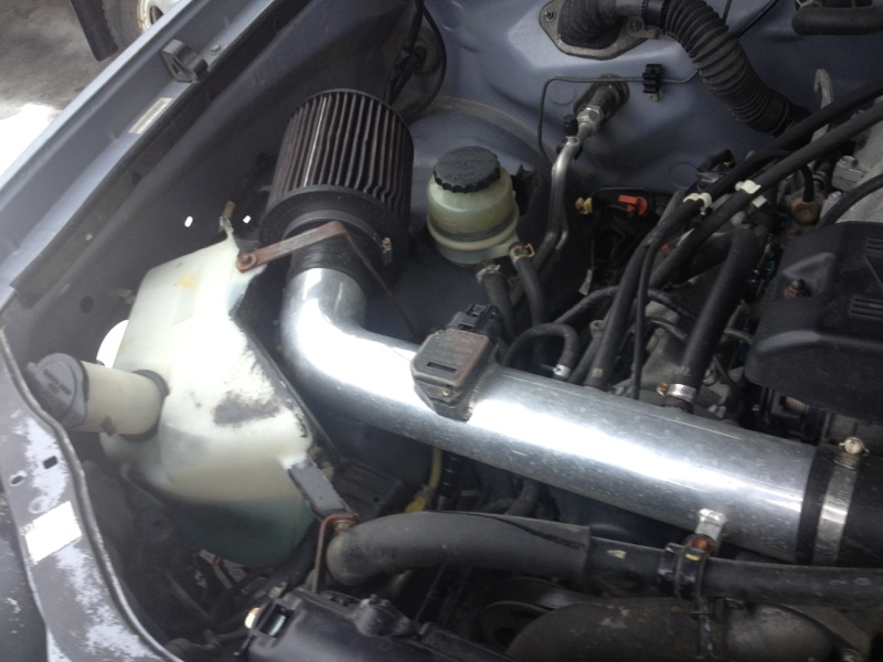

I have heard mixed reviews on seafoaming Tundras. Is it ok to use thru the PCV hose? Which is here?
IMG_9861 | Flickr - Photo Sharing! IMG_9861 | Flickr - Photo Sharing! by BC4Lyphe, on Flickr

first picture: No idea
