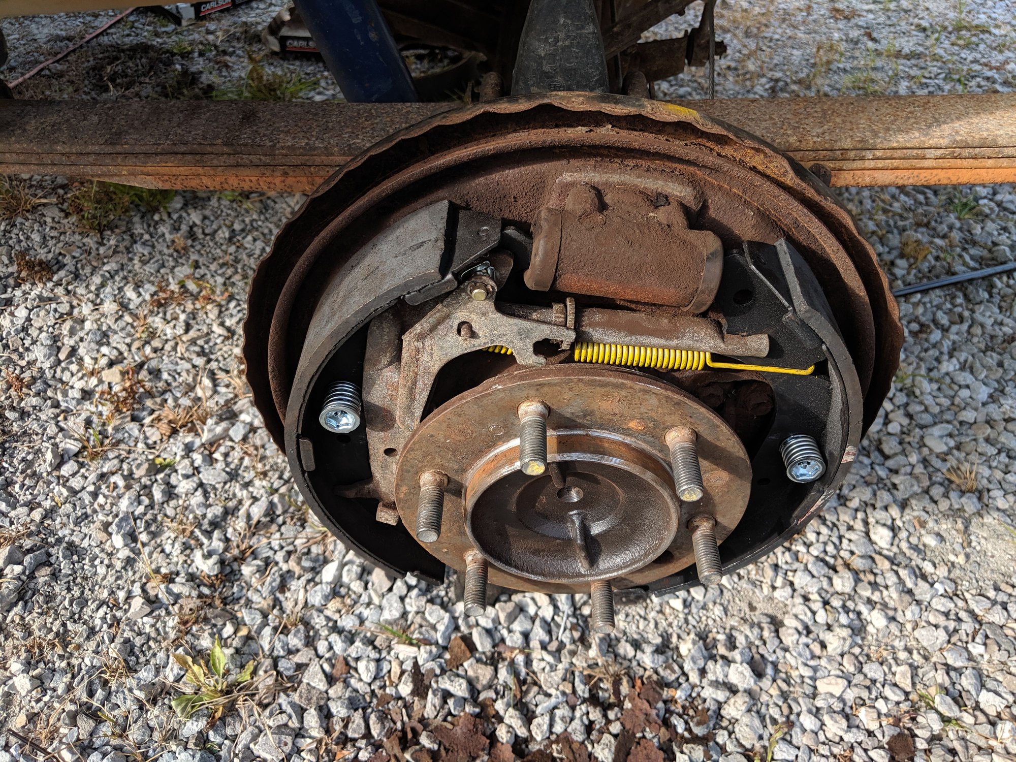

Finally did new brake shoes and springs this weekend, cheap quick and easy! I ended up with an extra spring.hardware kit if anyone wants it, ordered 2 when I only needed 1

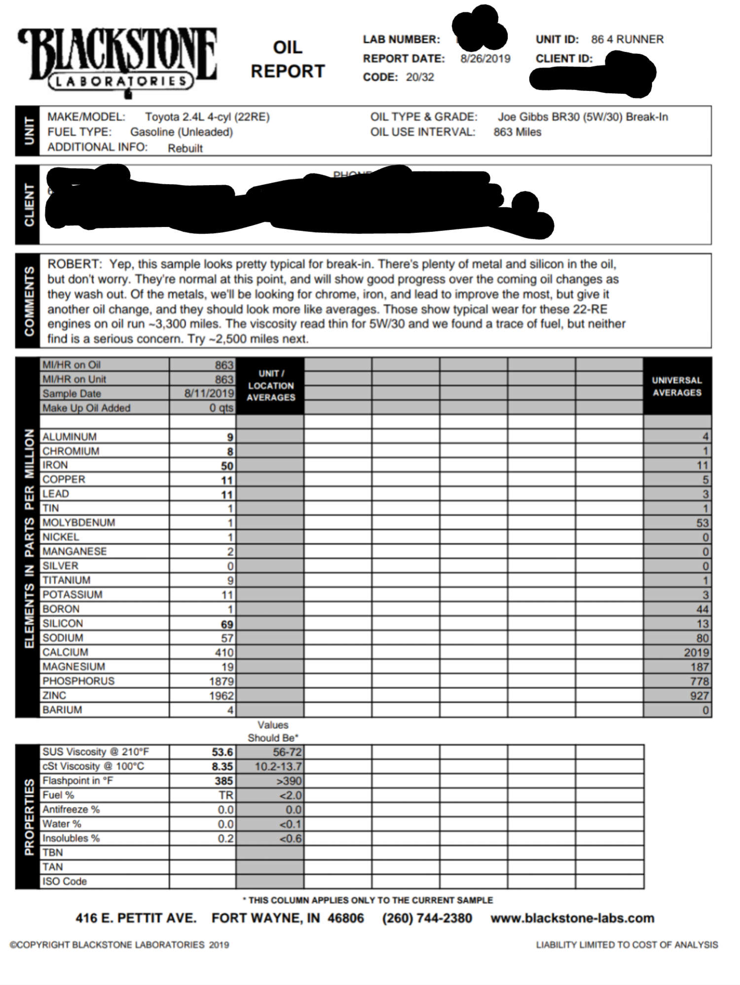

Did the first oil change and got the break in oil out, took a sample to send to blackstone

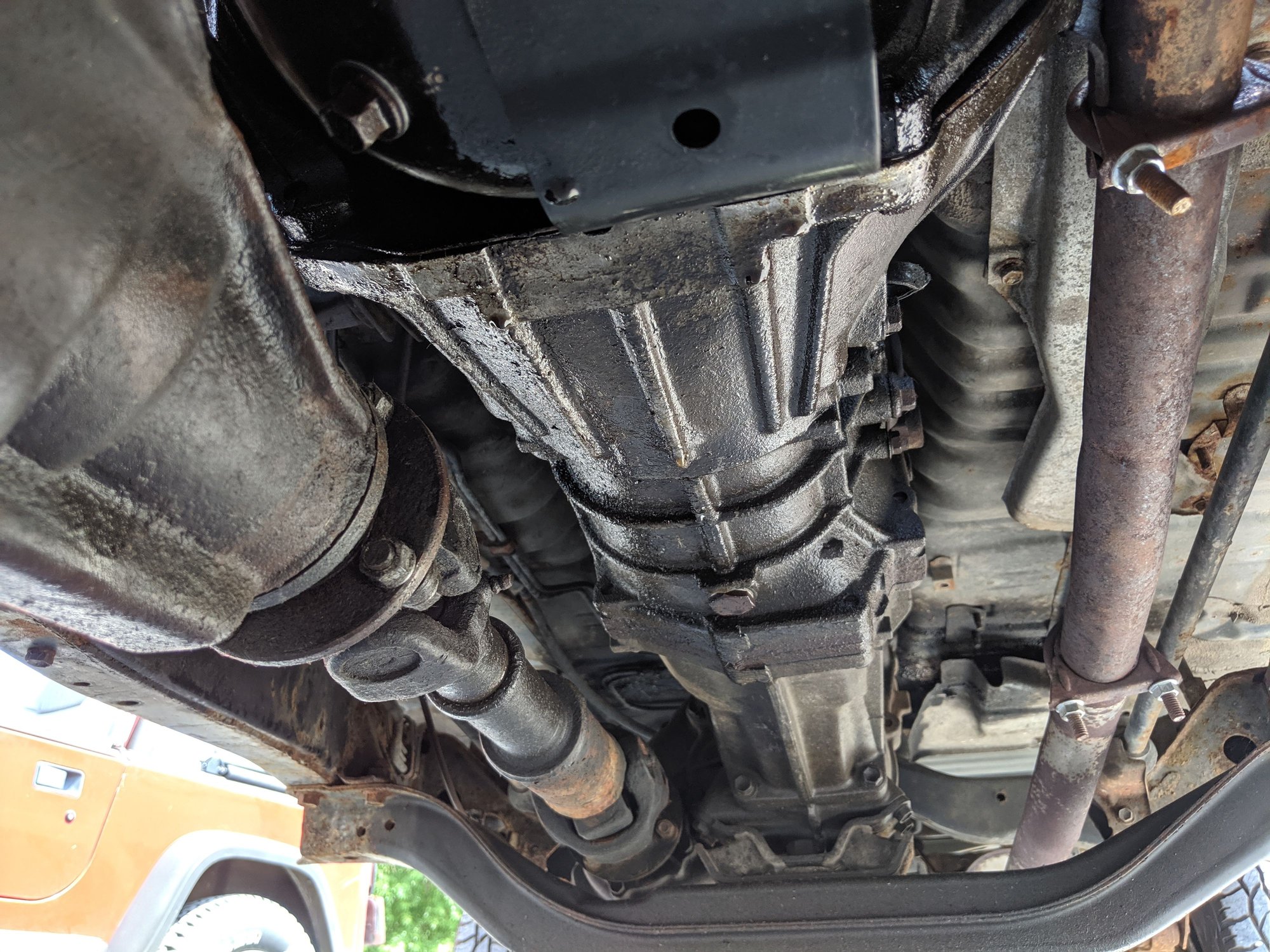

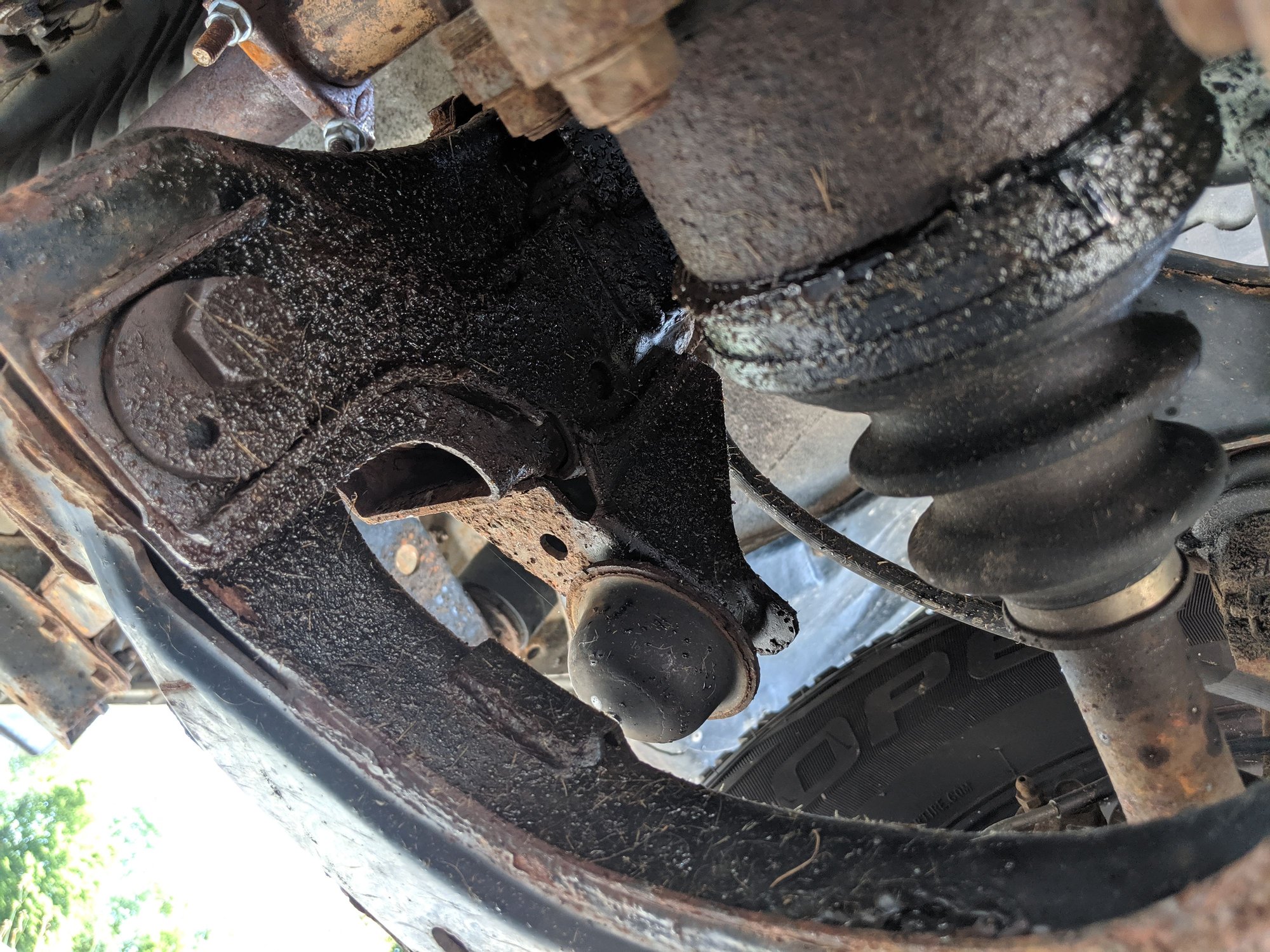

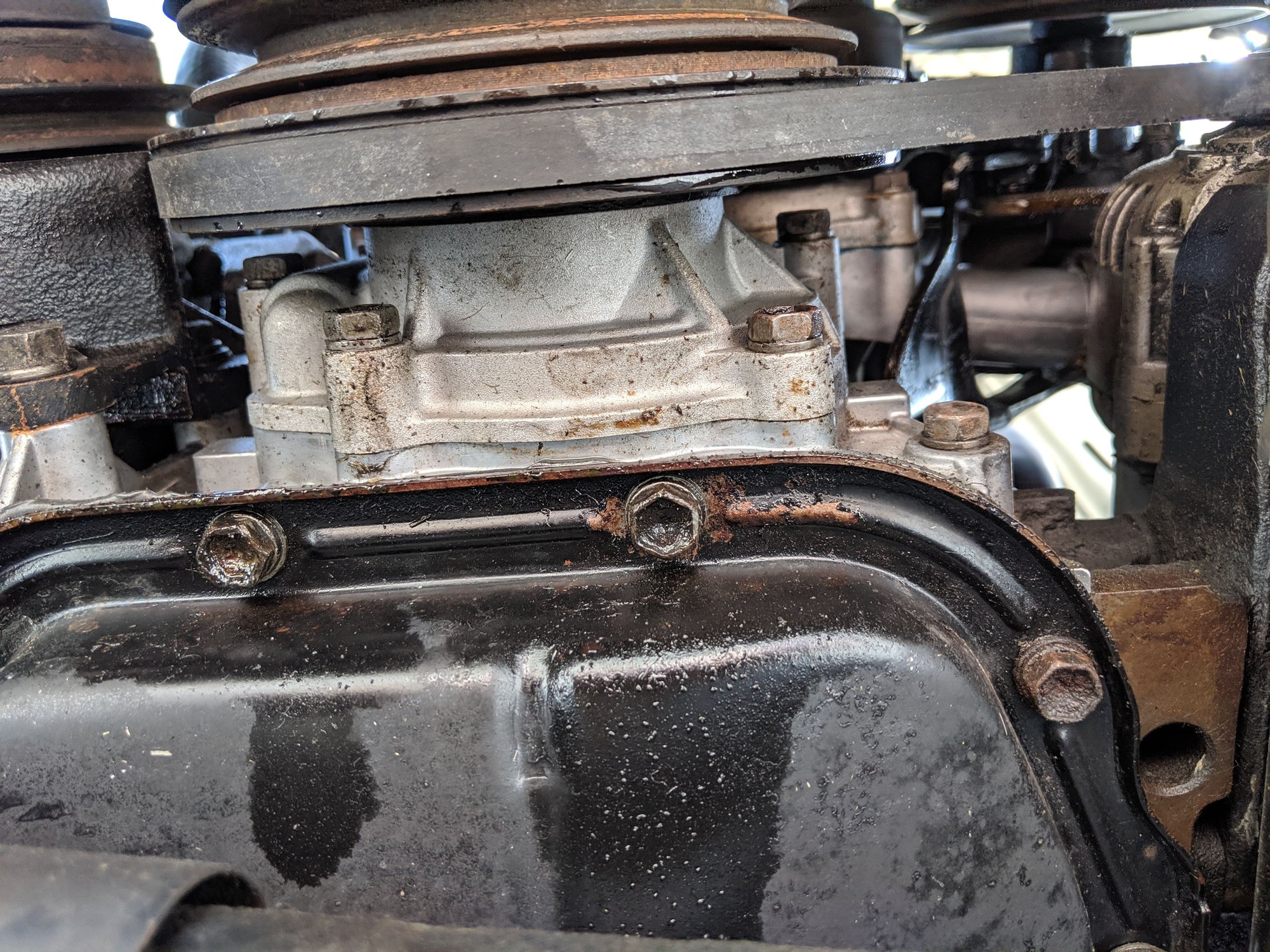

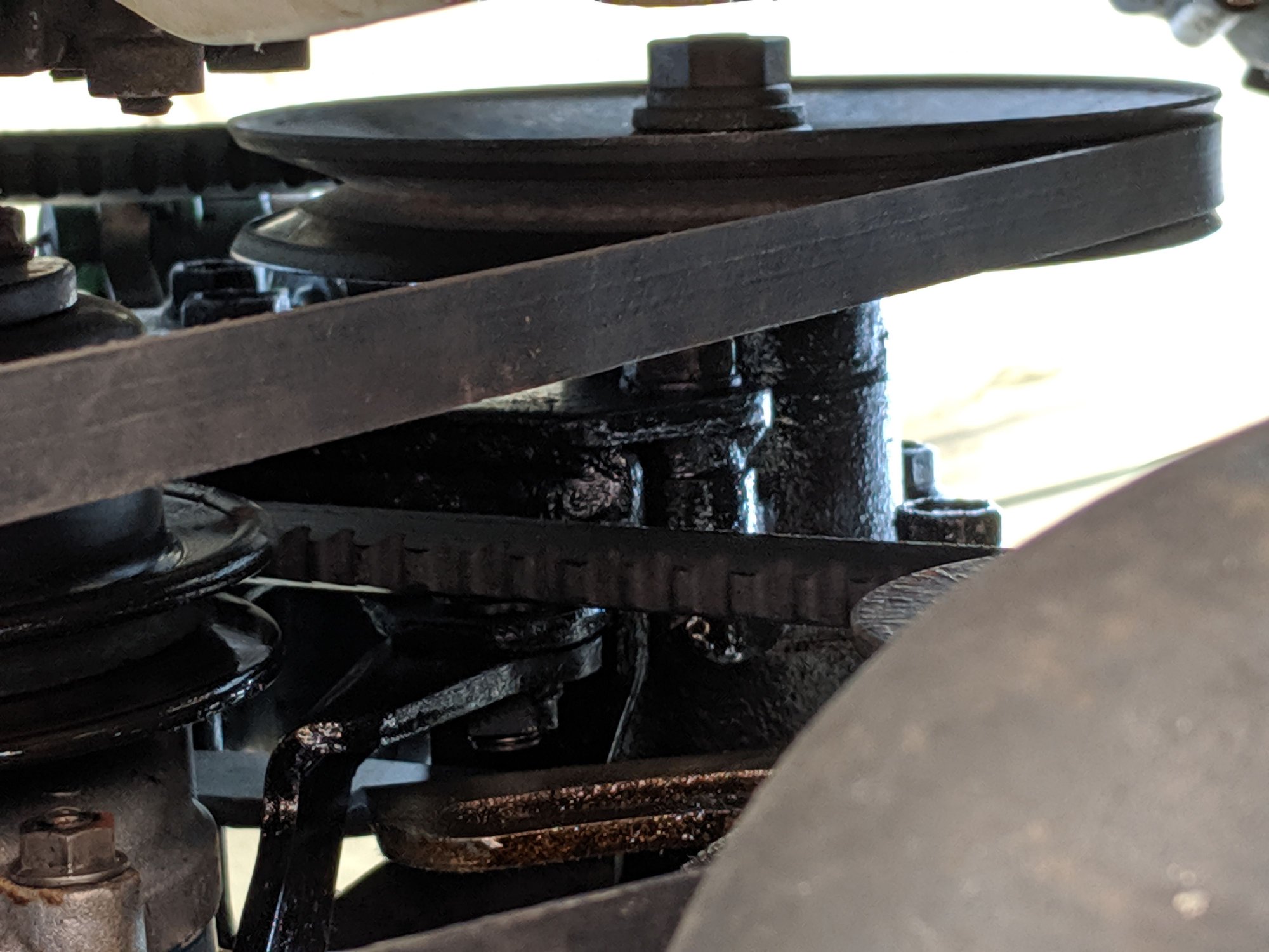

Leaks:
1. Lost a band on the half axle, looks like that's allowing stuff to leak out. Not sure if I can just replace the band or if I should replace the whole half axle
2. Tranny was wet :/ will have to keep an eye on it. Could be one of the seals I replaced.
3. Might have a bit of leaking from the front oil pan bolts, or could be weeping from a different bolt or seal. (note the oil on the pulley is just from me spilling during the oil change)
4. PS pump looks to be leaking, added to the to-do list

Got the oil report from Blackstone labs for the first oil change, so far so good!

Very cool to see that report.

Pleased to say the engine has been running great, didn't drive during the winter, started driving this spring and (now that I have a shop I'm parking in!) I'm seeing I've got a rear main issue of some sort to address
So I got a transmission jack! Guess I'll have to pull it and figure out what's up. Sleeved and replaced the seal, guess I'll find out what I botched

Are you sure it is not gear oil? Either way you gotta drop that tranny. I had a significant leak there that turned out to be tranny input seal.
Old Mar 15, 2020 | 05:40 AM
  #329
magnet18's Avatar
Joined: Aug 2016
Posts: 596
Likes: 70
Yea, tranny fluid was still pretty new and red in color, this is definitely oil
I replaced both engine output and tranny input seals, so either way I botched something

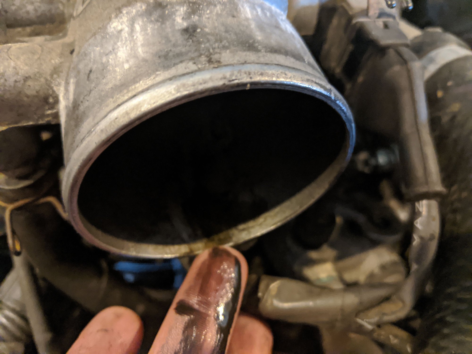

Weather got nice so I finally started working on the truck again. First up is the revving at stoplights, need to adjust the TPS position as I learned during my rebuild.
Well I popped the hood and low and behold I'm missing two valve cover acorn nuts! Also some oil in the throttle body. Thoughts on if those are related? Or if it's just from excessive blowby during break-in?
Anyway, proceeded to clean up and adjust the throttle body. Put her back together and she runs good as ever. I'll take her for a test drive tomorrow and verify that fixed the issue

Put the Throttle body back together, ran around in the truck for a couple days, have confirmed that the engine revving at stoplights is finally fixed!!

And, cautiously optimistic that my 'rear main' issue is fixed. Looks like it might've just been leaking from the valve cover!

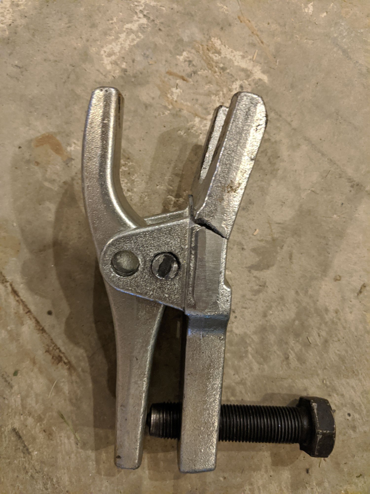

Got the tie rods swapped... Not without breaking 3 different tools
(Harbor freight wasn't exactly up to the task)
