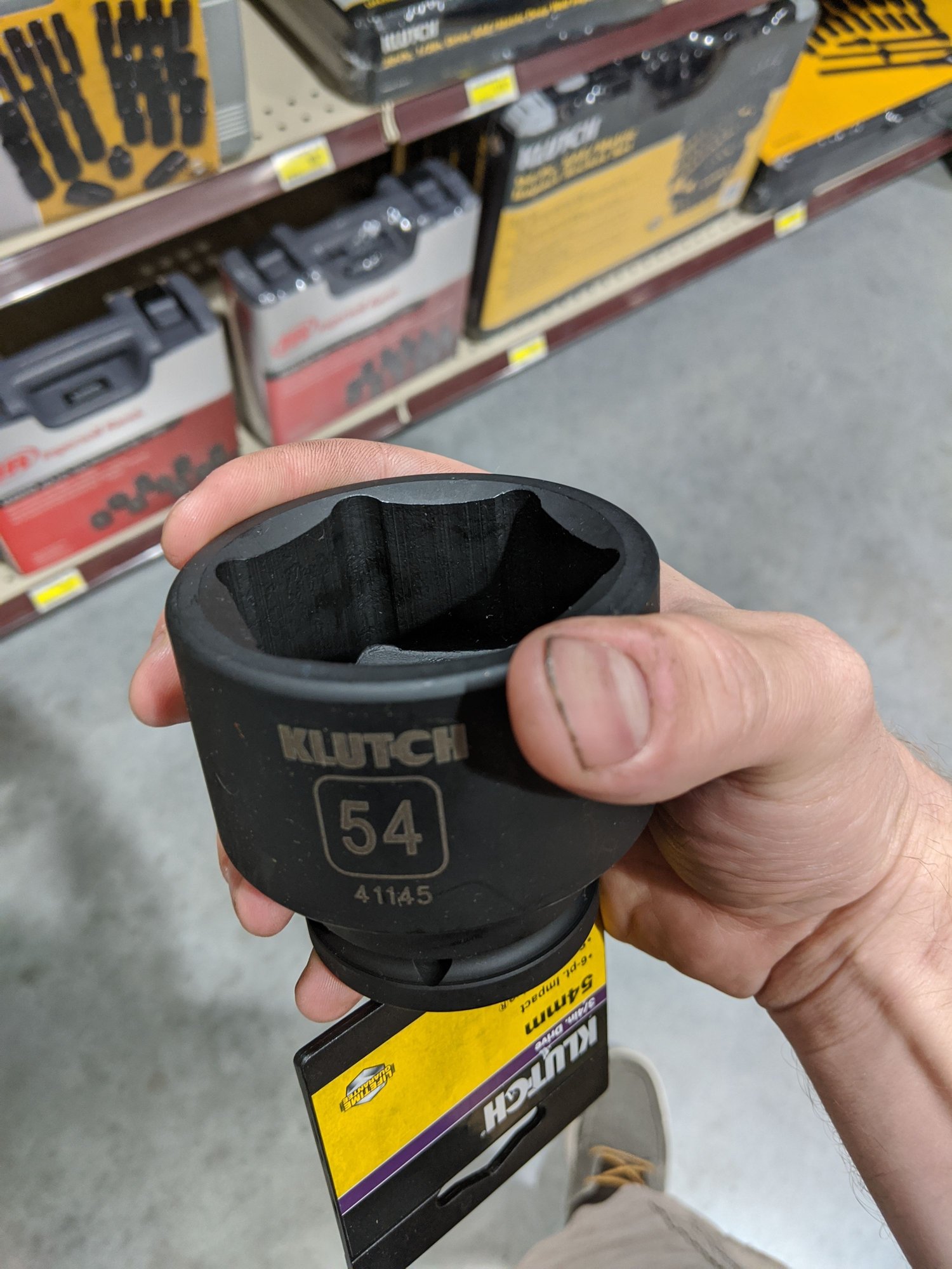

Apparently replacing brake rotors requires a 2-1/8" or 54mm socket...
Thank goodness my city just got a northern tool. If not for them I'd be waiting a week for an online order!

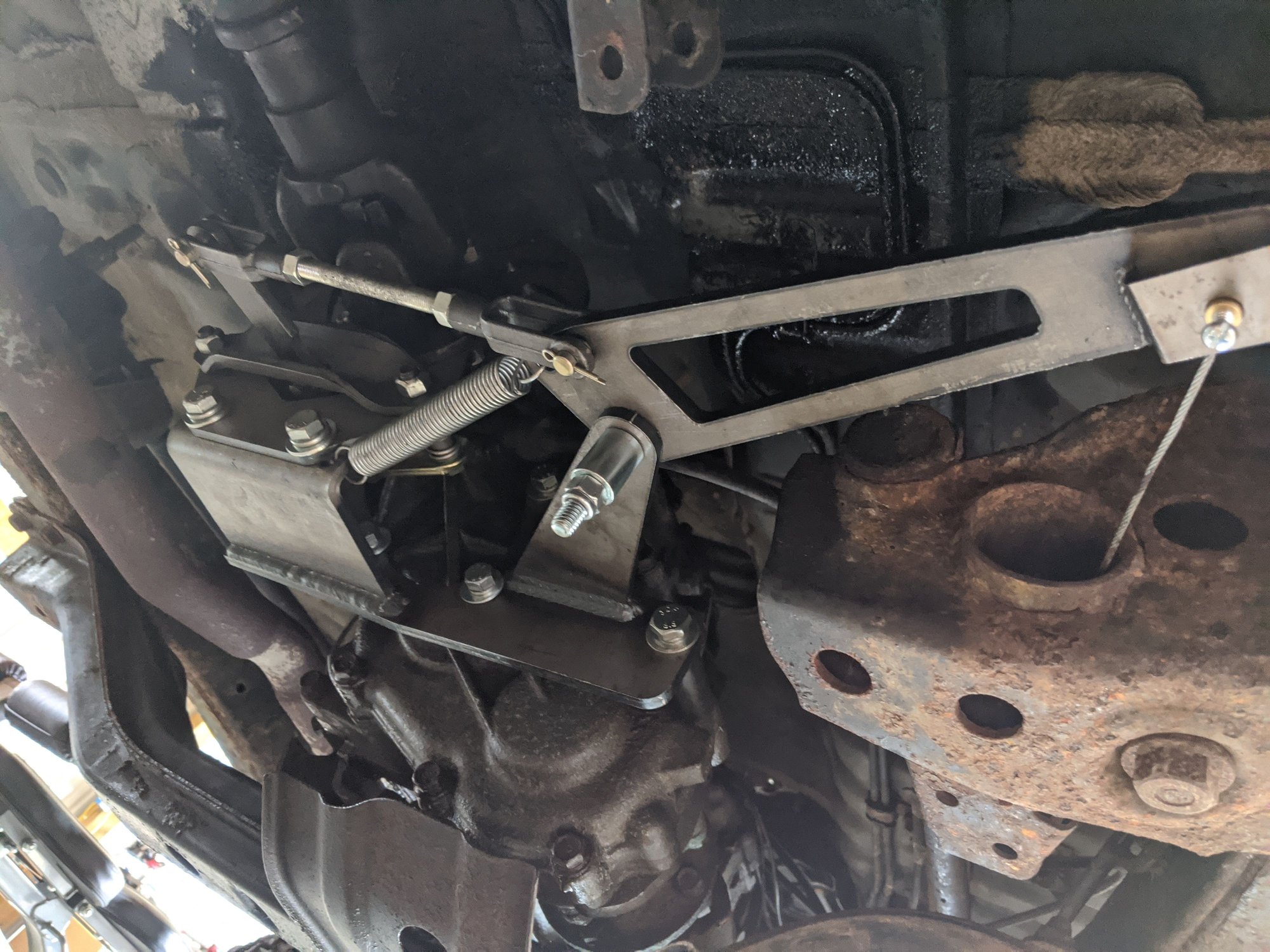

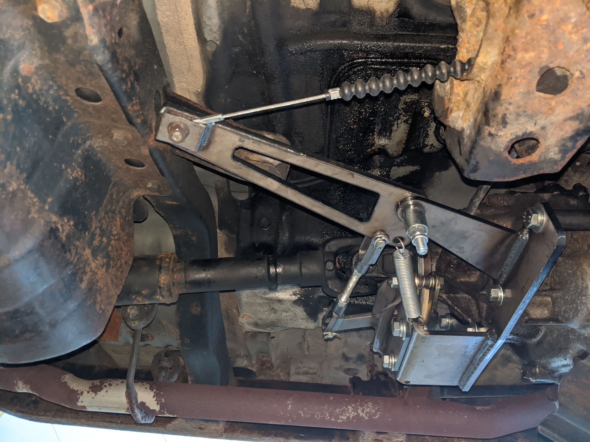

so that parking brake cable wasn't the correct part number, I think the correct number is 46410-35340. I made do with the old one for now, since that one is $100 and won't be here in time anyway. I'm not happy with the cable routing, but it doesn't rub when just driving, so I think it will be ok for this trip. Definitely not a good long term solution, I think a longer cable would come out straight enough to work better.

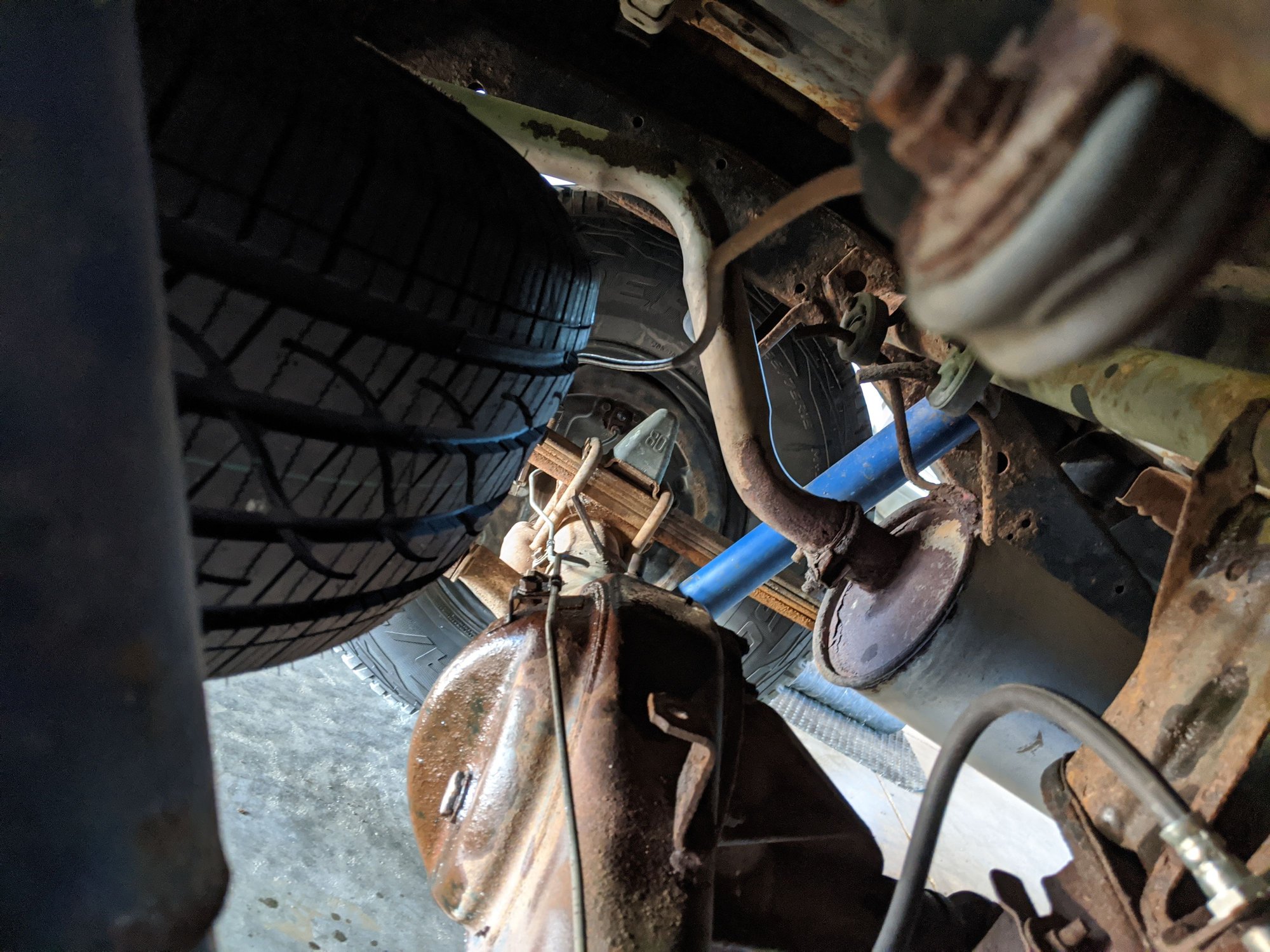

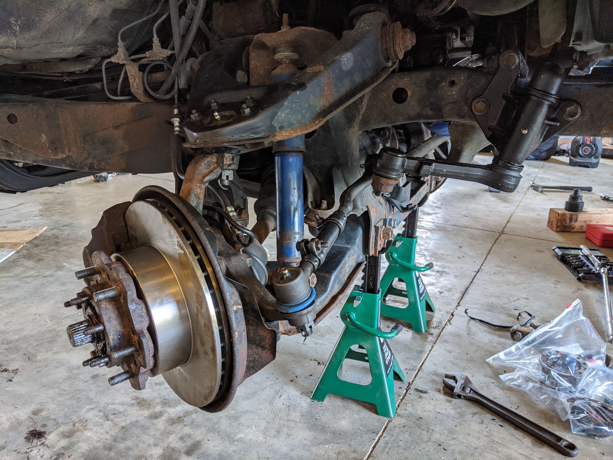

New brake hoses and rotors installed. I got pads but I couldn't get the slide pins out of the old calipers, and the old pads were still 1/4" thick, so I left them on.
New ball joints installed
New tie rods, pitman arm, and upgraded pro-forged greasable idler arm installed. The old joints seemed okish, except for the old idler arm ball joint, which was totally totally shot and I'm pretty sure was the cause of my front end shake

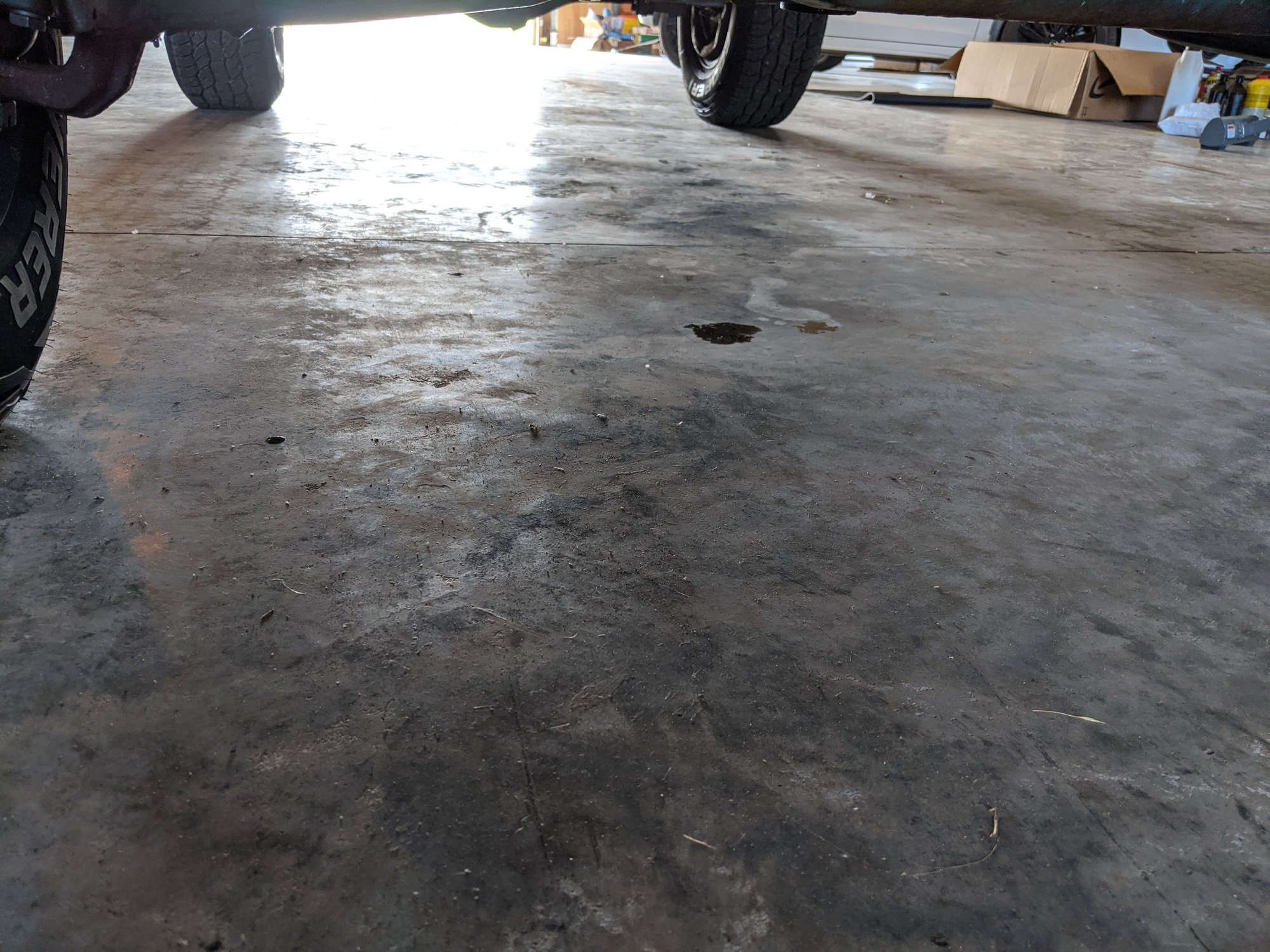

​​​​​​parked overnight to check for leaks, the results below, doesn't look like much to worry about

Oh, final piece of good news, I've parked it hot the last two nights and it hasn't leaked a drop of any fluid

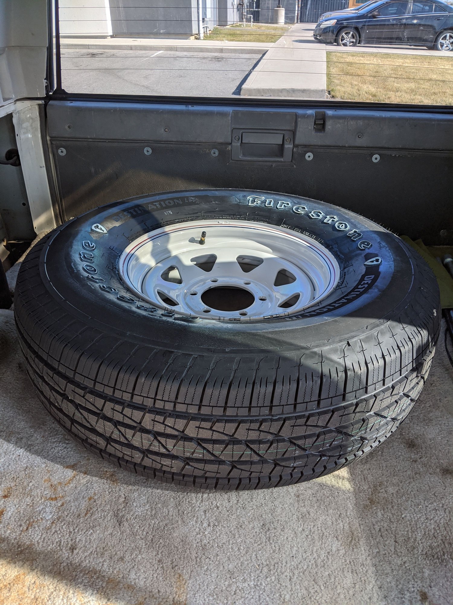

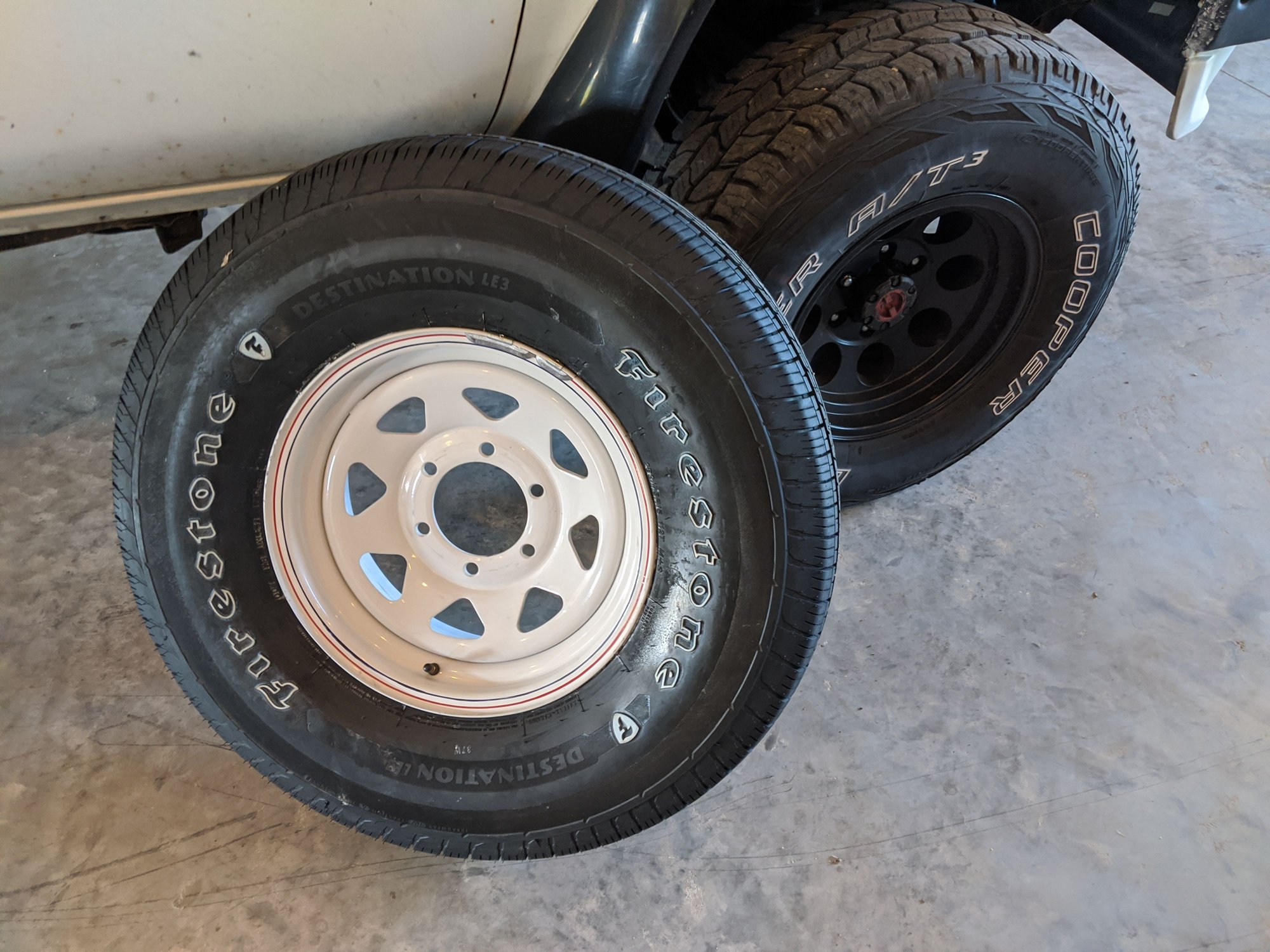

new full size spare. Didn't want to risk having to bounce along a dirt road on a donut for 80 miles

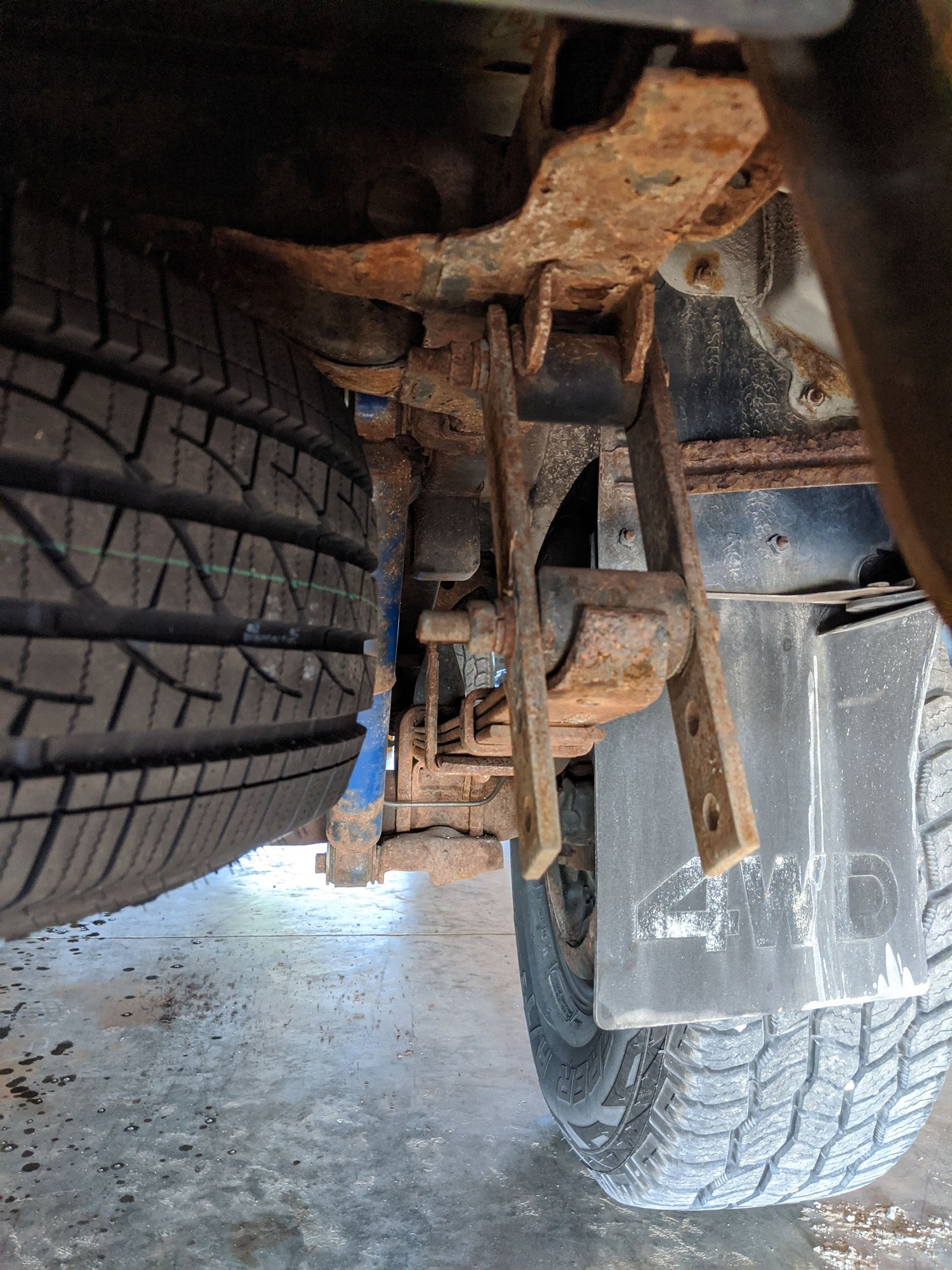

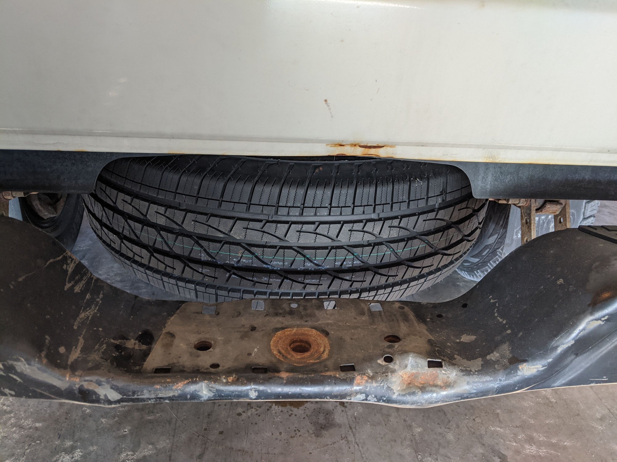

Breaking the tire hoist loose was a chore, I think the key is to pull it down (3 bolts on top) and remove the c clip from the shaft, and get the shaft out of the way so you can work all the internals better. A lot of the friction was just between the shaft and the rear face.
267/75/r15 fits in the spare area nicely

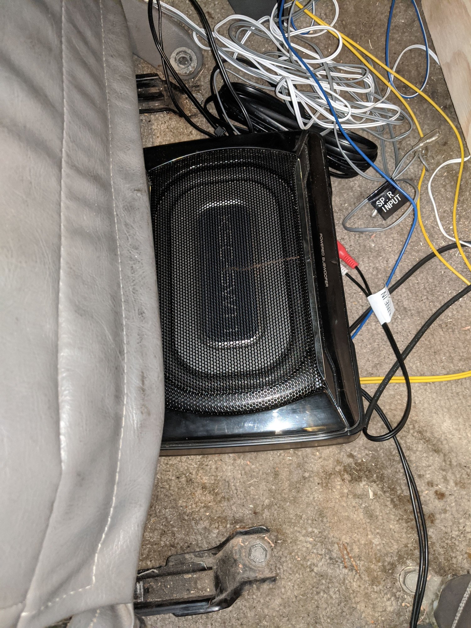

I also got a subwoofer installed under the drivers seat. Now more mids to come so I can actually hear with the windows down!

The new sub

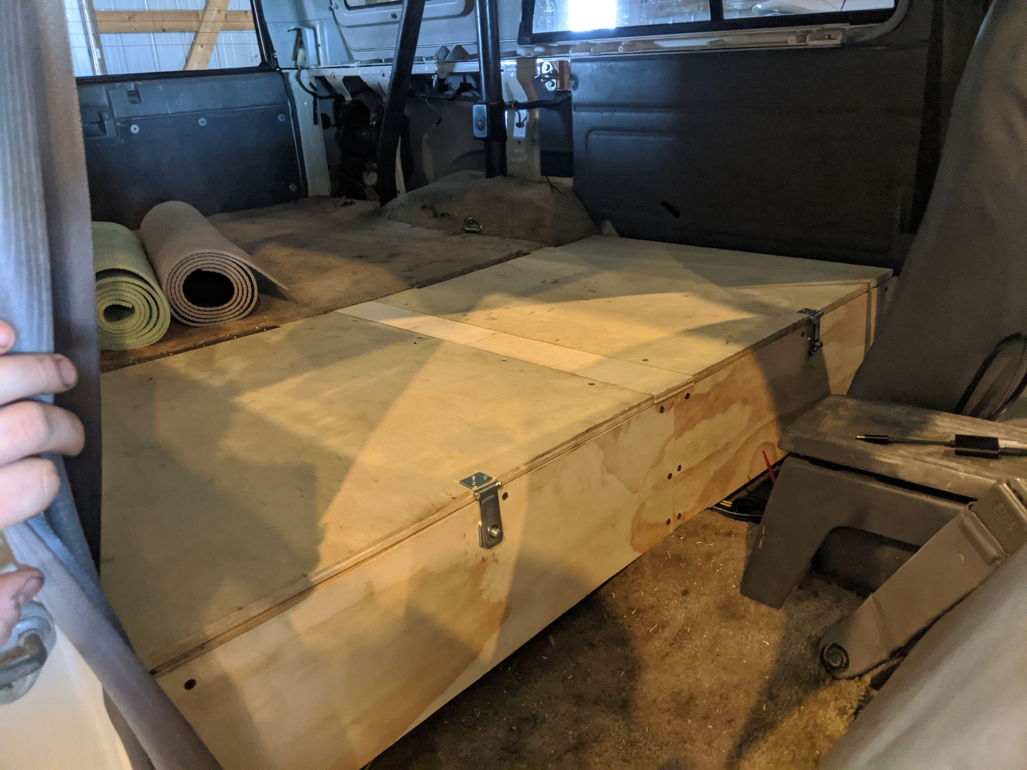

Threw together this platform in the back yesterday as well for storage/to make a flat spot for sleeping. Padlocks to lock up the valuables too.

The correct brake cable showed up yesterday afternoon, installed it this morning before hitting the road. Much better.

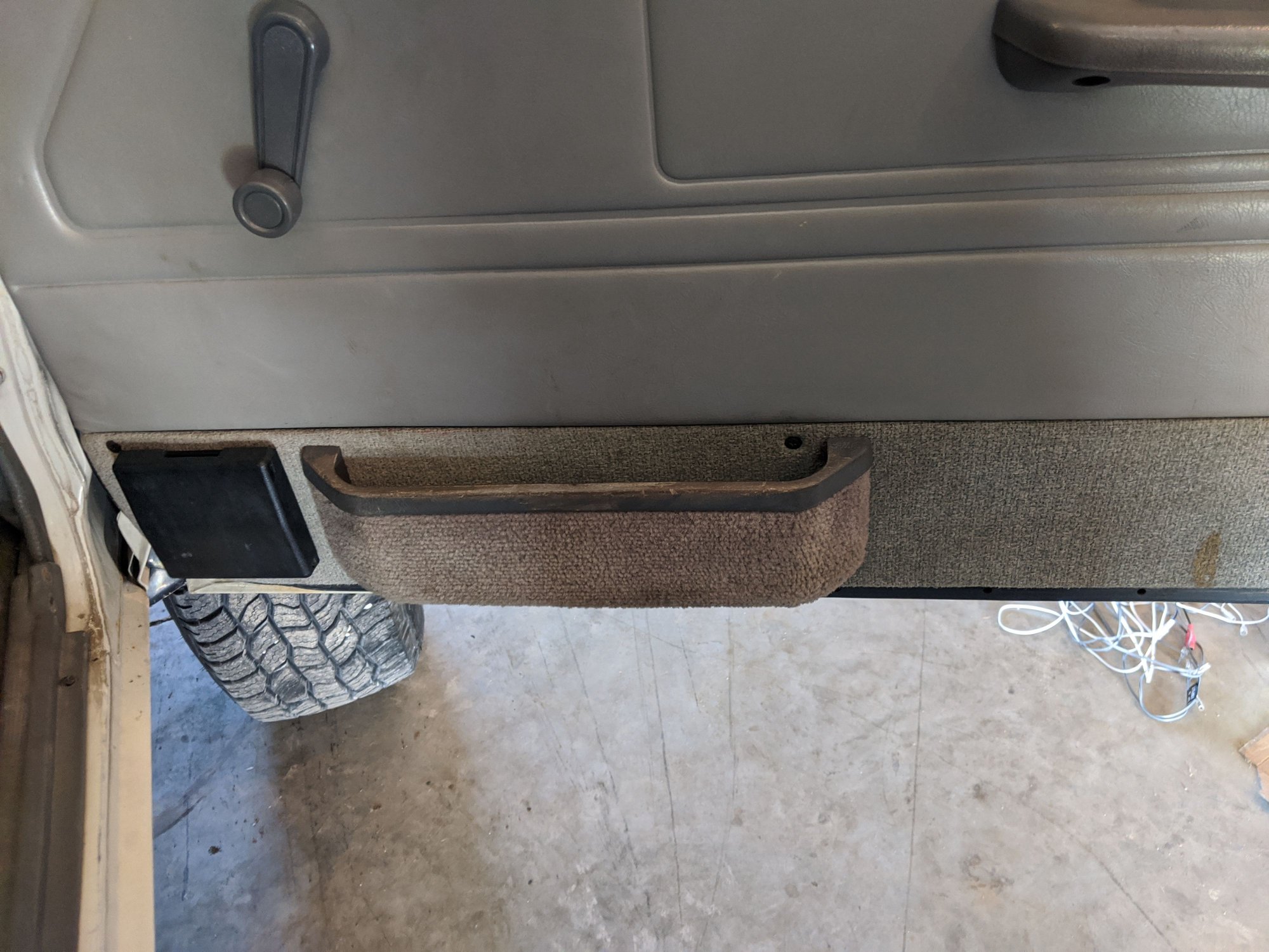

Installed map pockets and flip out cupholders. All the comforts of home. I think it's time to hit the road!

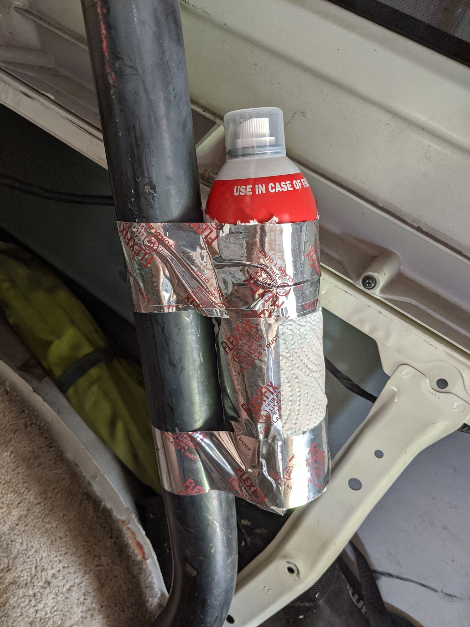

Oh, and a duct tape fire extinguisher mount. All the nice elastic ones were gonna take forever to ship. It'll do.

i see a lot of extinguishers mounted on the roll bar. i wonder about accessing it in a hurry with the hardtop installed and the window up. how quickly can you get that out and ready for use?
mine is located directly behind the driver seat, on the floor. as soon as i get out of the rig, i can grab it in seconds.

My primary concern was being able to grab it while sleeping in the back, for which it is perfectly situated. Didn't think about jumping out of the truck though, i should probably put another one behind the drivers seat, good idea
and i didn't think of sleeping in the back as a reason to locate it on the passenger side of the bar. you can still access the driver side floor while sleeping in the back, though.
