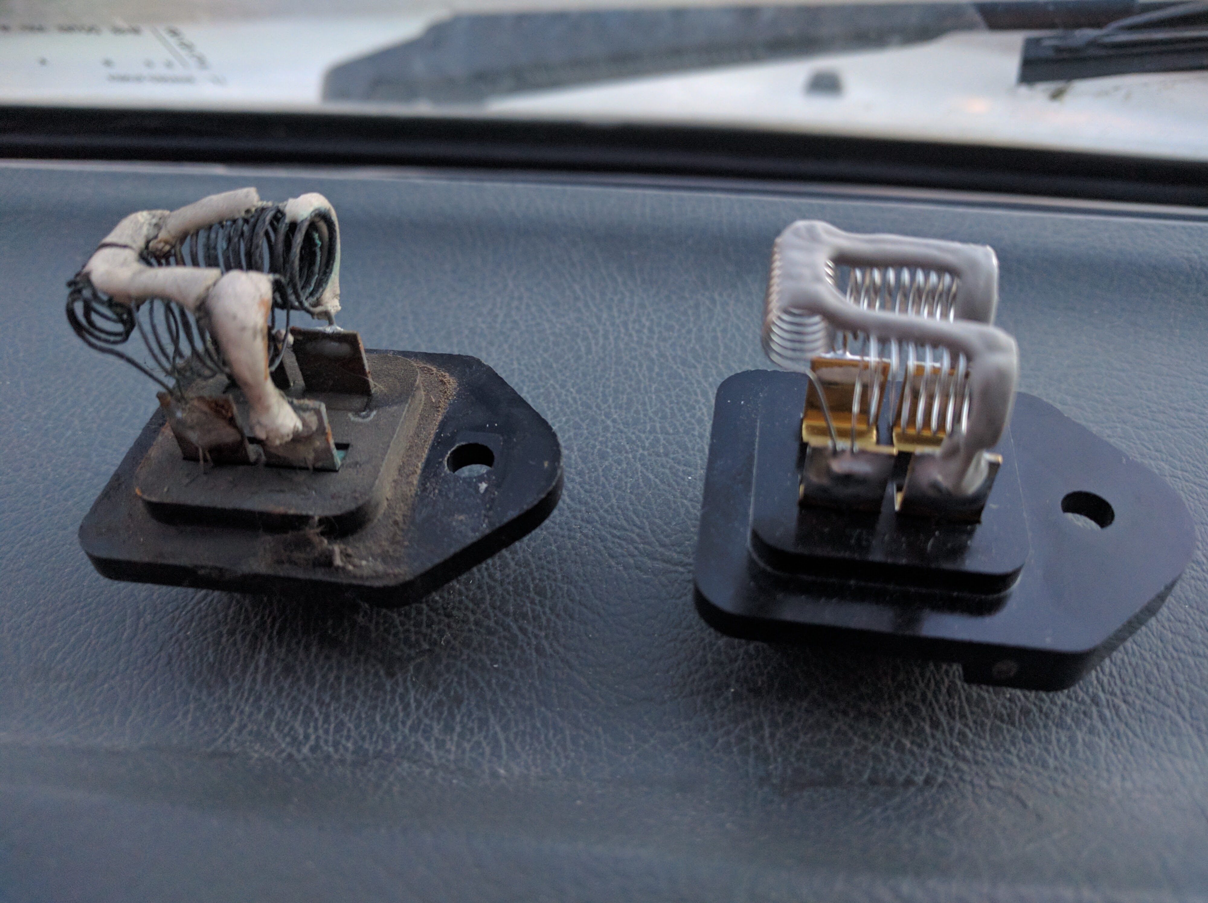

Replaced the blower motor resistor!
Definitely found the problem, look at that old thing! Will be good to have heat this winter!
Thanks for the windshield tips, I saw rad4runners posts on it, will probably do the same thing as it's the only for sure posts I've seen that work/look good.

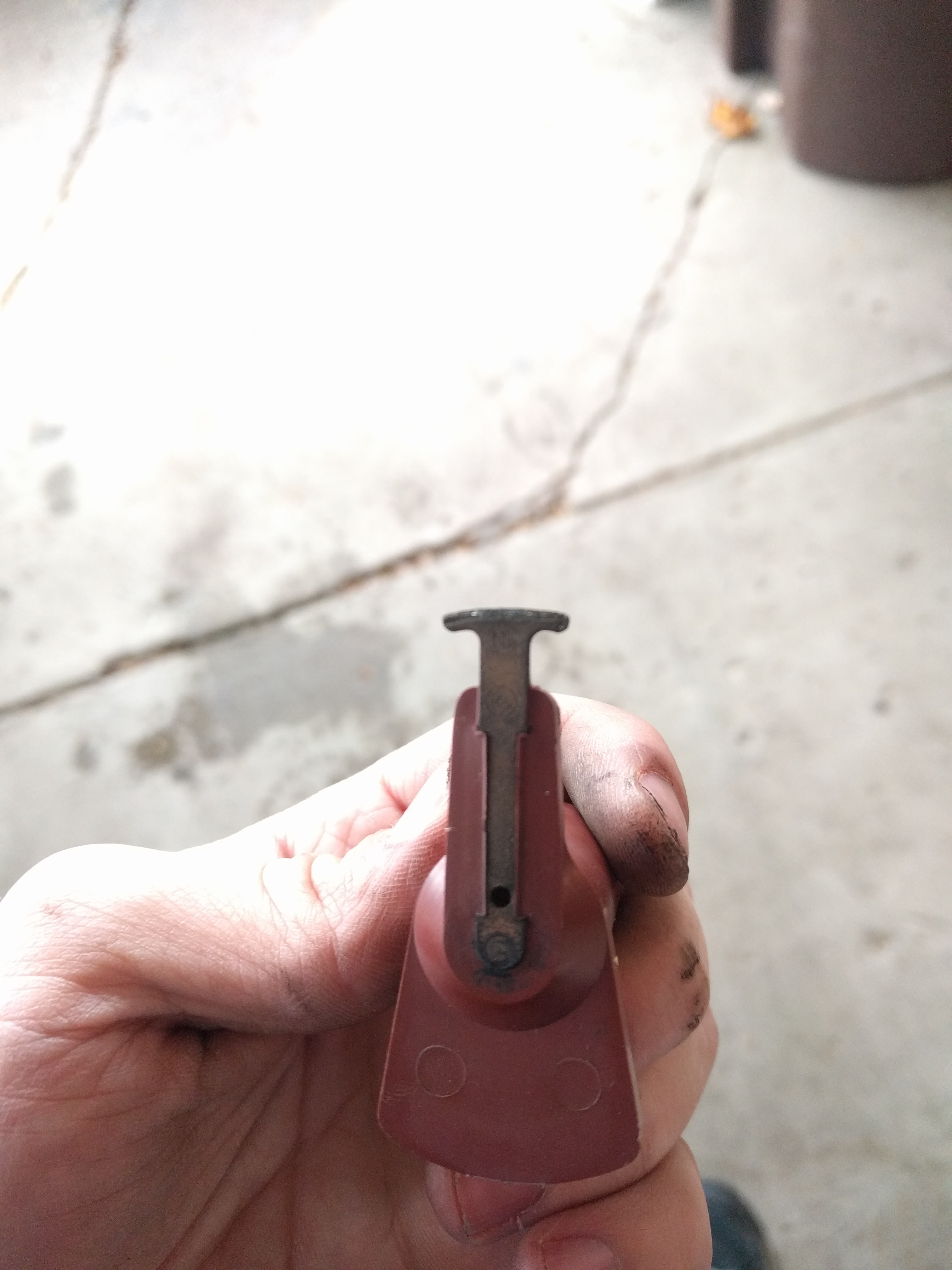

Replaced the distributor cap and rotor. Looks like it was original, nice and black and worn.
Realized I didn't have an O-Ring, ordered one from LCE, along with a new idle adjust screw, the old one had loosened it's way up above 1250 RPM.
When those get in I'll finish up the job of swapping the plugs and wires
