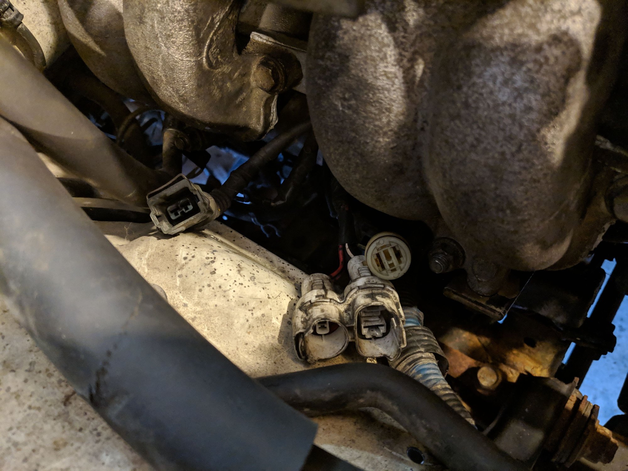

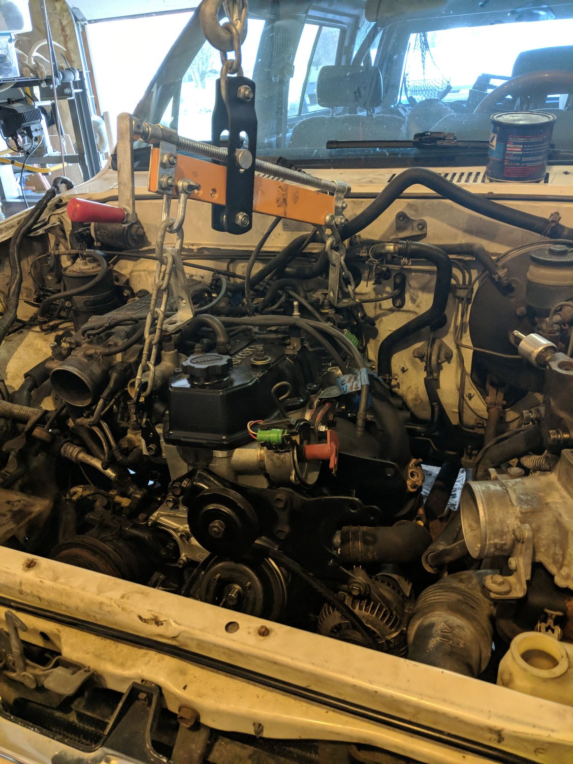

It's in!... Almost anyway, the only thing I can't figure out is where the squarer part on the double connector goes... Is it an EGR connection?

Could the square one be your cold start injector connection?

Nope, CSI is already hooked up. I was up down and around everything from every angle I could with a flashlight, couldn't find it's mate
The square on it's own, and the circle on it's own both found their home, the circle in the double connector went to the transmission, just can't figure out the square part of the double.

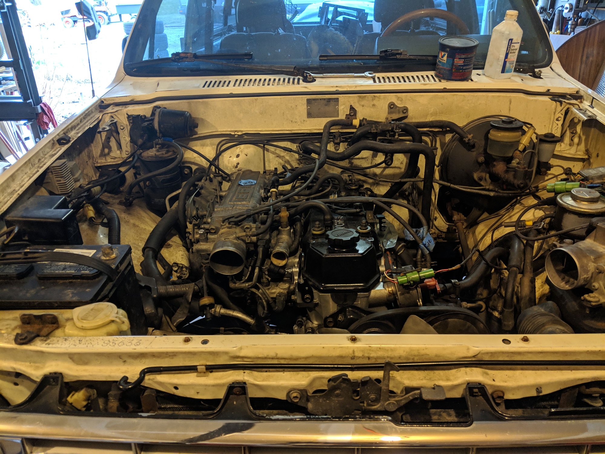

Picture time!

Rest of the pics I meant to post last night

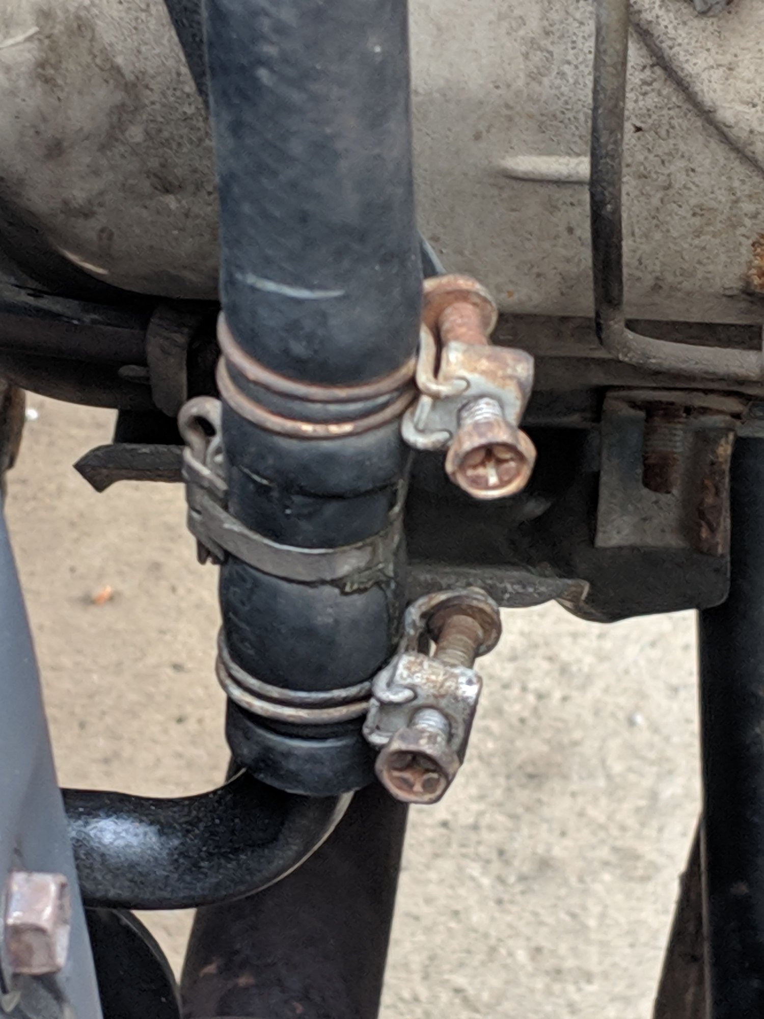

Ive got that same wacky heater hose clamp setup. Must be factory.
Is the screwdriver only temporary?

Lol, yes, I replaced it with bolt and nut that are the same size as the screwdriver... those may or may not be temporary

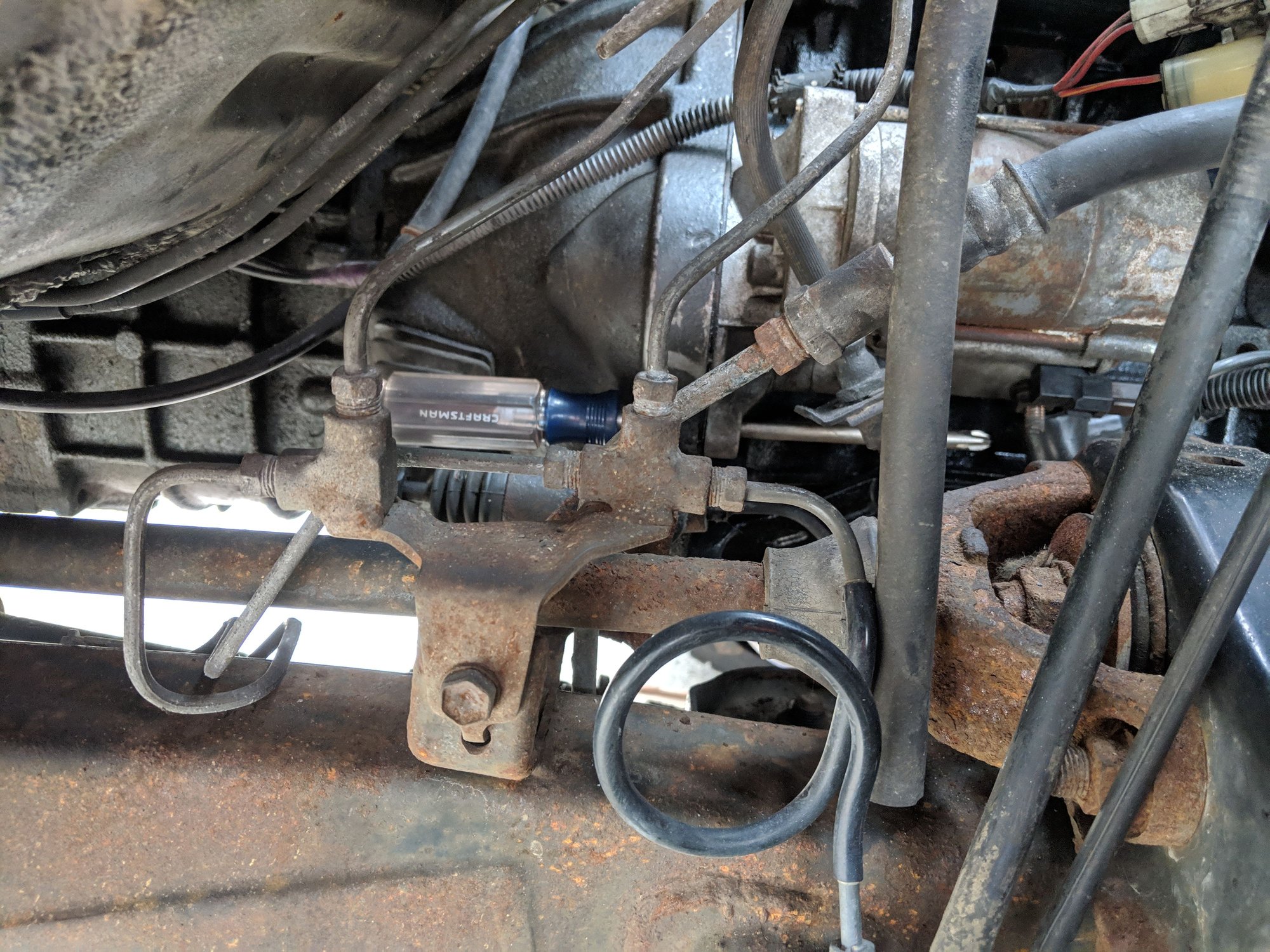

I need to order a few different bolts, I must've lost a plastic baggie somewhere
Pic 1, the wacky hose clamp is my only leak (it's very slow). Tightening it isn't helping I'll figure it out sometime.
Pic 2, (ignoring the screwdriver)
1. it kinda smells like gas down there, but I don't see any leaks
2. Where does the fuel line bracket thing go? I can't see it going anywhere reasonable, unless I bent it badly during removal/install

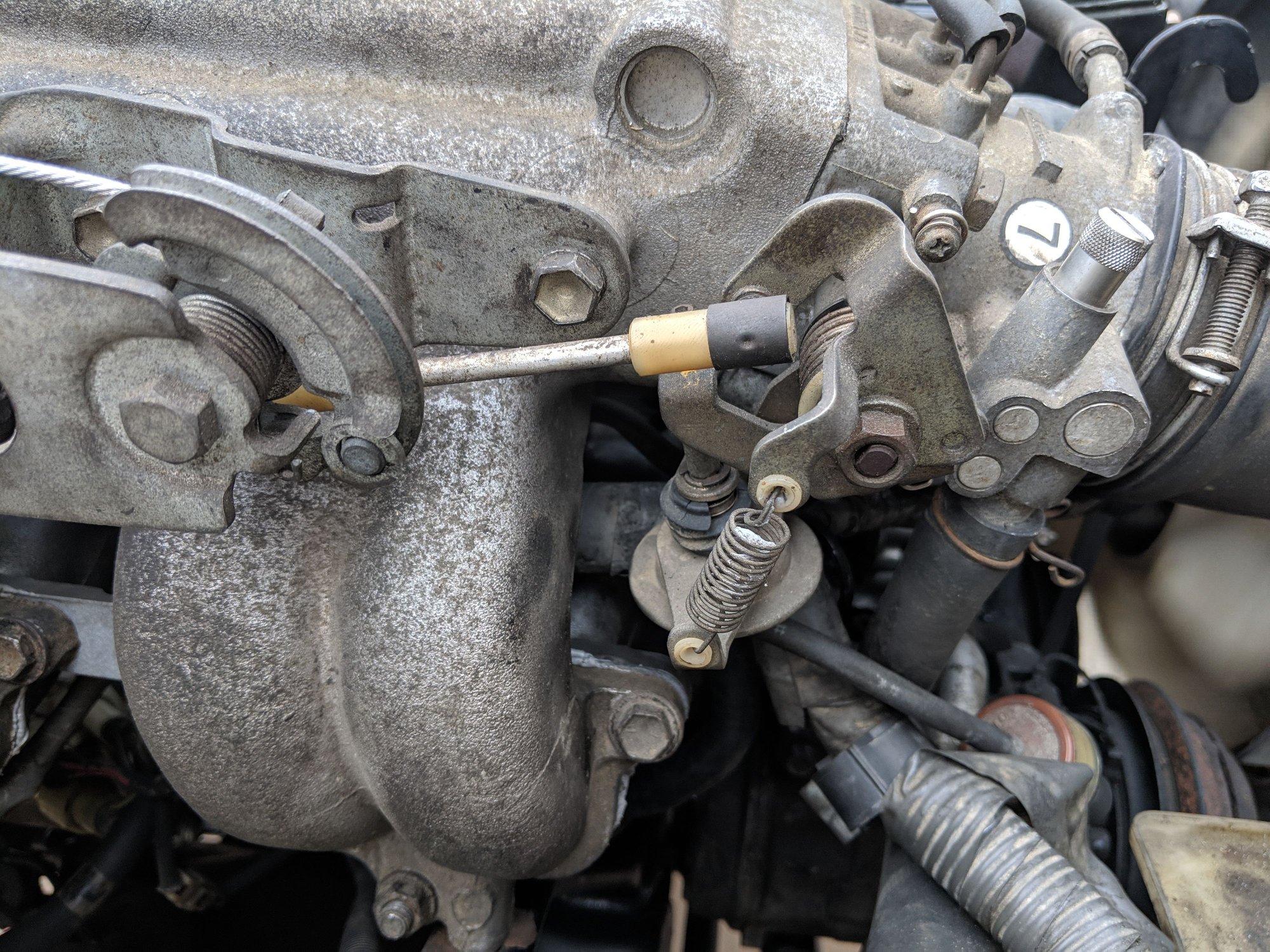

Pic 3, I replaced that spring with a stronger one which helped a lot, drive-able now. LCE has a bushing (shaft seal) kit here
https://www.lceperformance.com/22RE-...-p/1061048.htm
but I don't need the set screw, I'll shop around to see if I can get just the bushings cheaper somewhere but I didn't see them in a quick search
