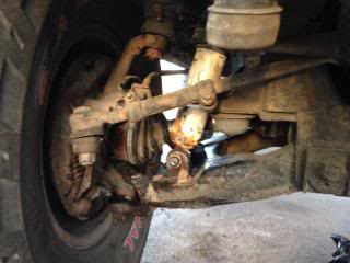

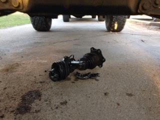

So i replaced my destroyed cv tonight.Took 2hrs with simple hand tools and a jack. Wish i had more pics but i was in a hurry. Took the tire n wheel off, lockout,bolt n washer,snap ring, lower ball joint,shock, and swaybar link to get it out. Put the used one out of the 87 in (which looks like it was replaced,fairly decent shape...) and bent 2 of the lockout studs with the brass drift while getting the cone washers out.

Nice work buddy. She's all ready to go
