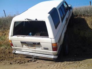

Old Sep 23, 2014 | 05:53 PM
  #938
kornhuskerwizard's Avatar
Joined: Dec 2008
Posts: 2,391
From: tecumseh nebraska
Would a made it up all the way if it wasn't for the fence.damn farmers.I'm also doing a seismatic activity test with my ball hitch.
Old Sep 23, 2014 | 11:18 PM
  #939
Terrys87's Avatar
Posts: 11,787
Likes: 28
From: Anderson Missouri
See you got the fender on. I got stuck due to the ball hitch hitting the ground. If you leave it on you never use it. The minute you take it off you will need it 5 times in one day. Farmers and their fences, lol..
