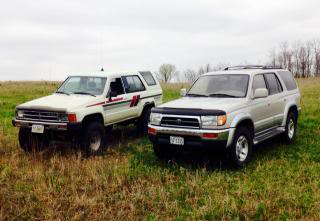

Took a pic of bries runner next to mine
Then i climbed up this rock and realized i have no sag to my rears.These tires rock for climbing and theyd even be better if id lose some air pressure.

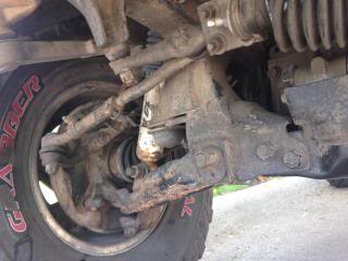

So i was mowing my lawn the other day and could smell 80 90 weight.found a puddle under the passenger side which ive recently replaced the cv. So i forgot to tighten the cv bolts and nuts they were just finger tight and when i wheeled it last weekend i ever so often heard a loud pop which actually was the heads of the cv bolts shearing off the ifs case!!! I got lucky and two of them stayed together. The leak was caused from the axle popping out of the housing about a 1/4 inch. I lightly popped it back in and replaced the bolts and TIGHTENED them up.Good to go.

15,000 nuts and bolts, bound to miss a few of them. One of the things I plan on doing this weekend is going back over every nut and bolt to make sure I haven't missed any. glad to hear it was an easy fix for you.
