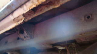

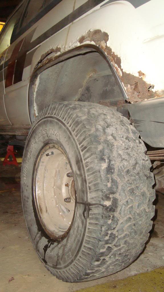

The more research i do i on wolf steel rear qaurters the less i want them. My 2 other options is flares or toyotafiberglass. Im leaning toward toyota fiberglass. Im afraid if i do flares it will just provide a pocket to keep rusting.

another pic of the rocker

I would do fiberglass without a doubt especially where you live!!!!!!

Decided to go with some aerosol white rust encapsulator for $19.99 a can from eastwood co to stop the rust.

Akk. I just typed a long winded post about how to use fiberglass mat to rebuild those rear quarters but it got deleted as I struggled to post pictures. You need gloves, fiberglass mat about a quart of two part epoxy, wax paper duct tape, and rust proofer to treat cut ends. I removed the rear interior panels of my 4Runner. Cut out bad metal, treat edges and smooched wetted layers of fiberglass mat from the inside. Put wax paper on the outside and used duct tape and paint sticks to hold it in place til it dries. With the wax paper you can smoosh it into the shape you need and it dries pretty quickly. Then I put on a second layer. You then wipe it down with Dawn or Purple Power and then a thin layer o Bondo. I wish I'd taken better pics. I'll put a couple in the next post.
