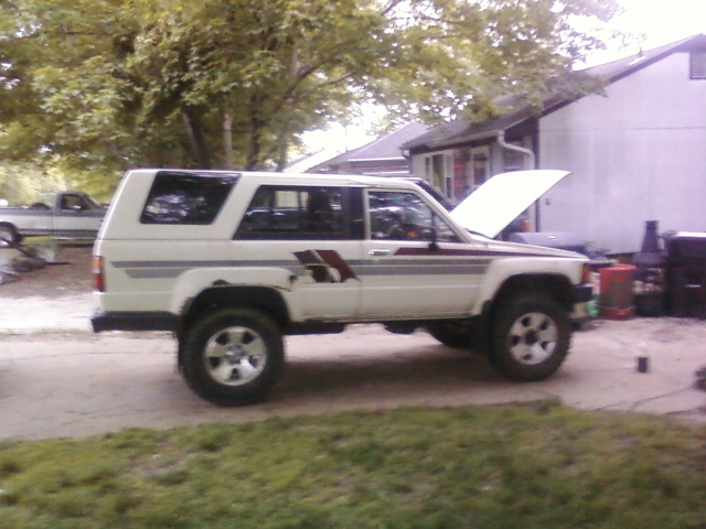

Yes i am slacking on pics!! But the fuel line leak was the steel line along the frame. So as of March 30th i officially started the runner!! Still have to mess with the tps and etc... ok ill get some pics!!!

I'm posting some pics for you since your slacking. Haha
It's looking great buddy. Really coming together.
