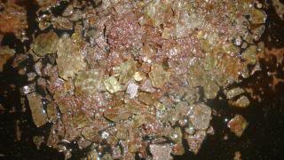

broken glass schards and white vinegar with a pinch of pb blast

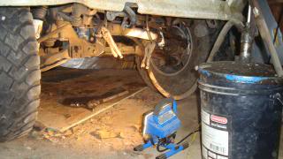

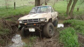

so heres some more pics. The gas tank is getting cleaner by the revolution. Also put in fresh diff fluid in the fronts and rears. Hopefully my injectors will show up tomorrow. KyleB also called me and he was stuck again so i had to take trusty buoy to the rescue.
tank rotisserie
white vinegar $3...
front diff

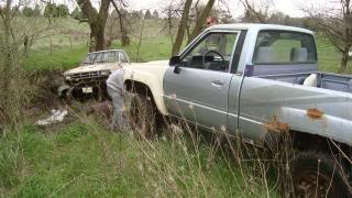

stuck, no lockers
buoy to the rescue!
unstuck but popped off a valve stem, i brought a spare...urwelcome

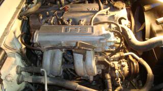

installed the injectors,rail, and ran the harness to sensors.

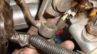

Lost this banjo bolt and washers for the evening
All these auto trans pigtails suck compared to a manual...

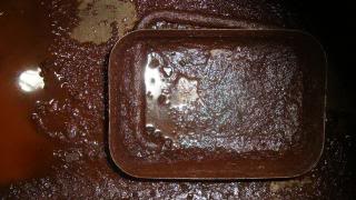

rusty tank...
glass shards and rust out of tank after spinning on rotisserie
a good steam cleaning with the hotsy did wonders after the vinegar breaking it down.Thanks Terry!
