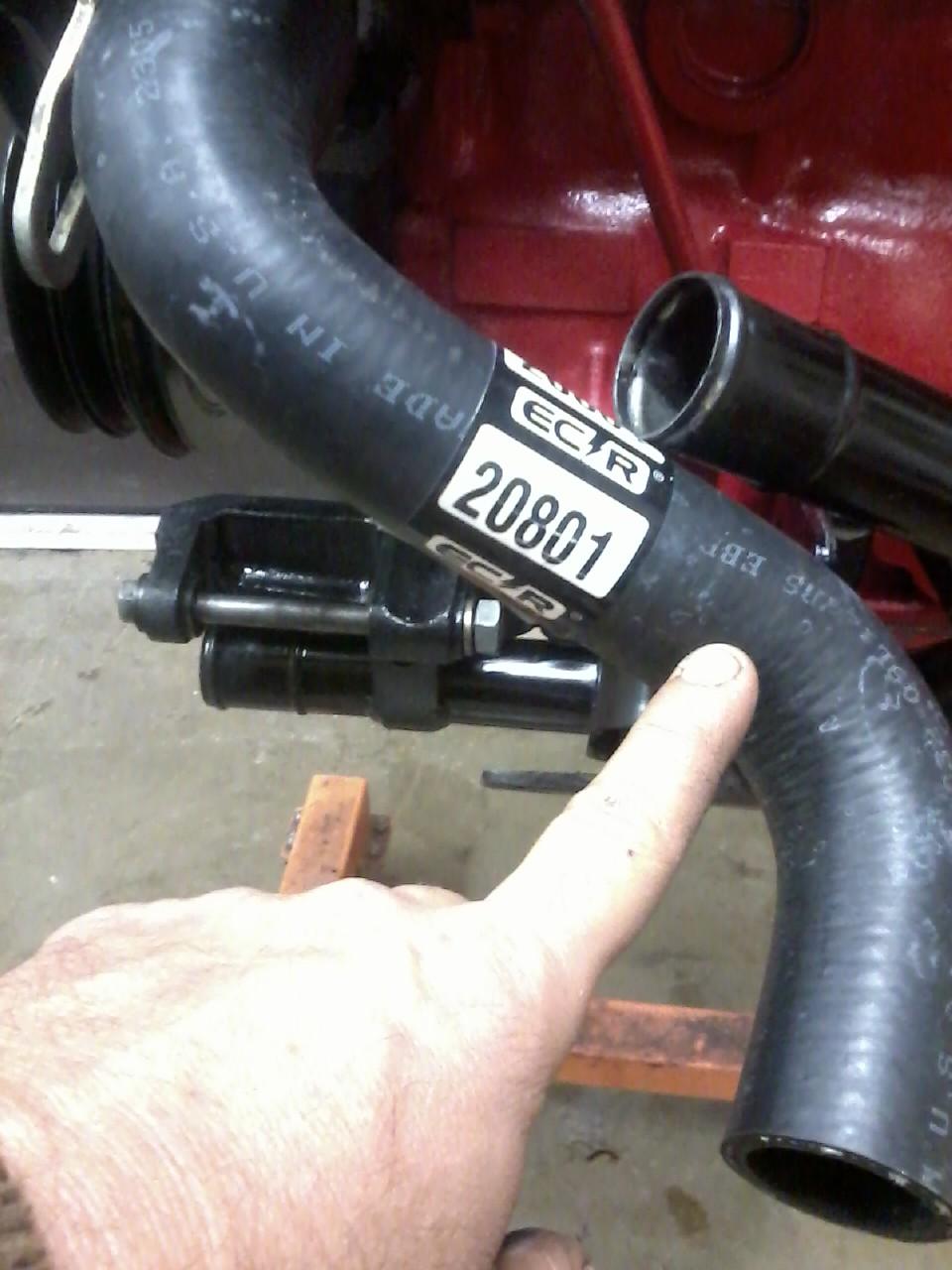

The past few days have been nice here as well, but tomorrow we get snow flurries I am itching to take the top off as well. Fresh injectors should make a nice difference. I get my fuel pumps off of ebay. A lot cheaper and never had any problems with them.
The radiator hose that goes from the water pump to the horse shoe pipe can be made from one that the parts stores sell. It needs to be cut but is an exact fit.
Copied from 88s build.
Parts store will tell you this is a dealer item or they dont stock it. This hose likes to leak coming off of the water pump when it pops a hole. Gates PN#20801, just cut off where my finger is at. Alot cheaper then the dealer.

Good info on the Coolant hose Terry!! I love being able to make something work without going to the dealer.

Thanks for the info on the radiator hose Terry!

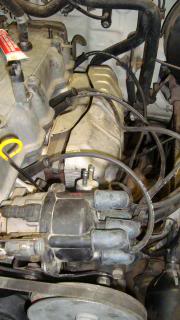

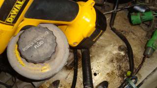

Yes the snow has come and gone again. The boy accidentally knocked the downspout off the gutter when putting away his soccer net and the rain found its way in the basement so ive been dealing with that most of the day but did get a little work done on the runner last evening. I installed new plug wires, need to make some looms to keep them outta the way of things. Also wired up the alternator and realized id robbed the coil off this thing when i sunk my truck in the river last summer. That wasnt the problem on the truck, and i eventually found the original coil with the cool plastic cover included! I broke one of the coil mount bolts that goes through the fender and had to drill it out. Im also gonna have to freshen up on the egr delete, like what sensors you dont need etc... i know theres details on this in threads ive read in the past just cant recall off the top of my head. Ill be expecting my injectors back maybe Monday????? dunno, but then ill finish the upper intake and wiring. Also on the power steering pump...do you plug the ports on the vacuum sensor or do you still utilize it after egr delete???
pwr str sensor
what i seen when i realized i robbed the coil!! haha

Lol...My boys cause me some home repair time as well. Just hit my funny bone when you said that. You will want to run your vacuum for the power steering to the plenum.
On the EGR, I will need to look but the one that goes to the bottom of the brown egr valve, I think you plug. I plugged mine with a screw if I recall that being the correct one.
Spaghetti has a better design then my plug wires. One day I too would like to get mine looking descent.

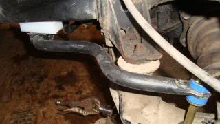

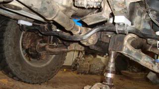

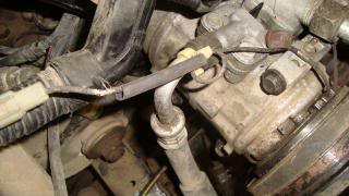

Finished installing the swaybar drop kit and new links, i had to drill out the drop blocks a little to get the bolts to line up on the frame.I also soldered another broken wire to the ac compressor.

i need the long neck style lugs for the wheel spacers on the front
very close clearance

On the ps lines in your photo, I've seen where people just leave them unhooke like they are right now in your photo.
When I deleted my egr, I took the whole thing out and plated the head, then used the downtube from te intake to make a plate for the intake. Then I have a header so I had the plates for the header/manifold egr outlets on te exhaust side of the head.

Im gonna atleast get some rubber plugs when deleting the egr so i dont have to do the ol' vac line with a wood screw!Thanks on the motor Mark! Ill be heading your way later, so i finally get to see your runner in person i hope!!
