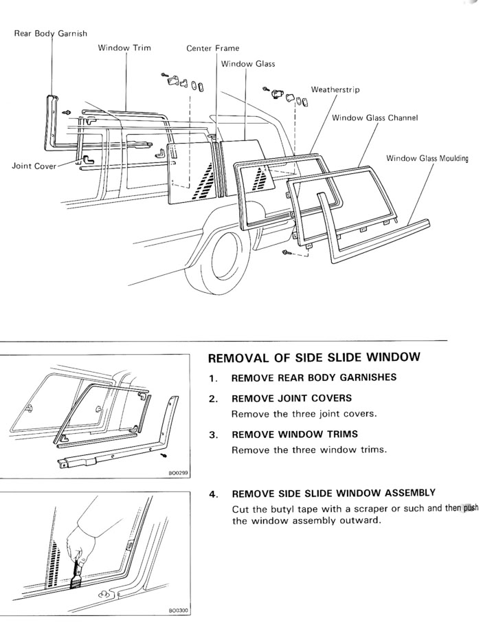

In the old days a mechanic could work on just about anything, but now you almost have to specialize in a certain model and that gets outdated quick after a few years.
To get the Ltrims off, you have to remove the whole window from the inside. I will see if I can find the info to remove them.
