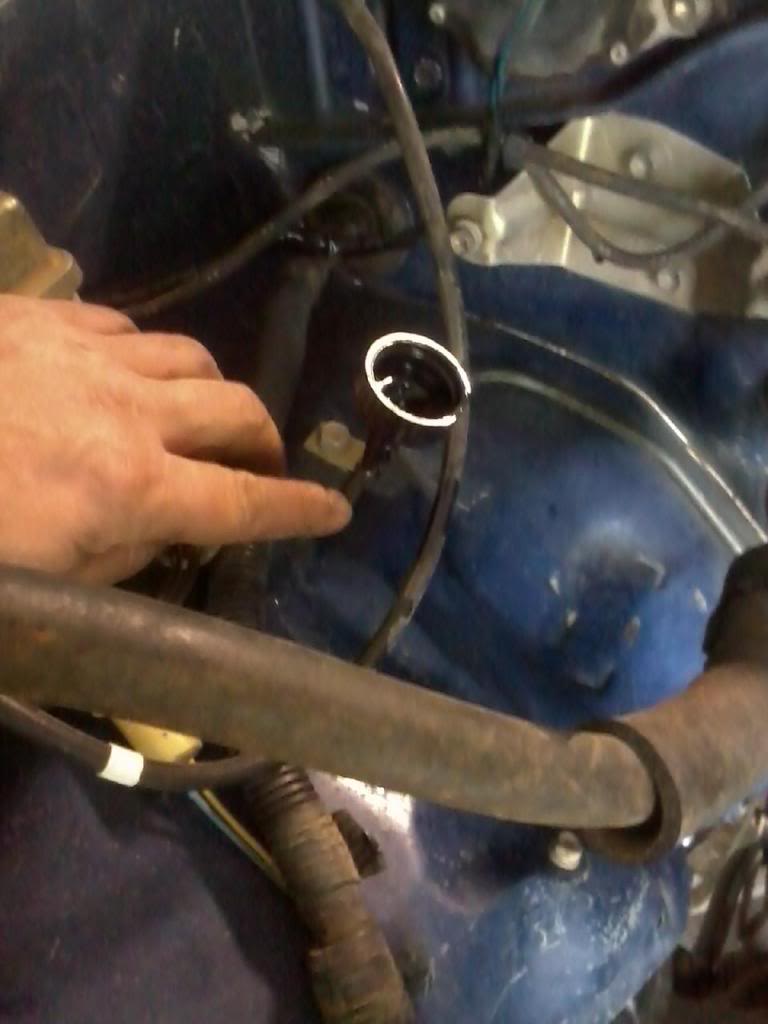

I found a fuel rail bolt/regulator somethin or other off my celica engine but it didnt fit. Yesterday we took the boys out to ride.were kinda getting a track started and cleaning up stuff.

I think I have an extra fuel damper if you need it. ( the threaded fuel line part you have pictured )
