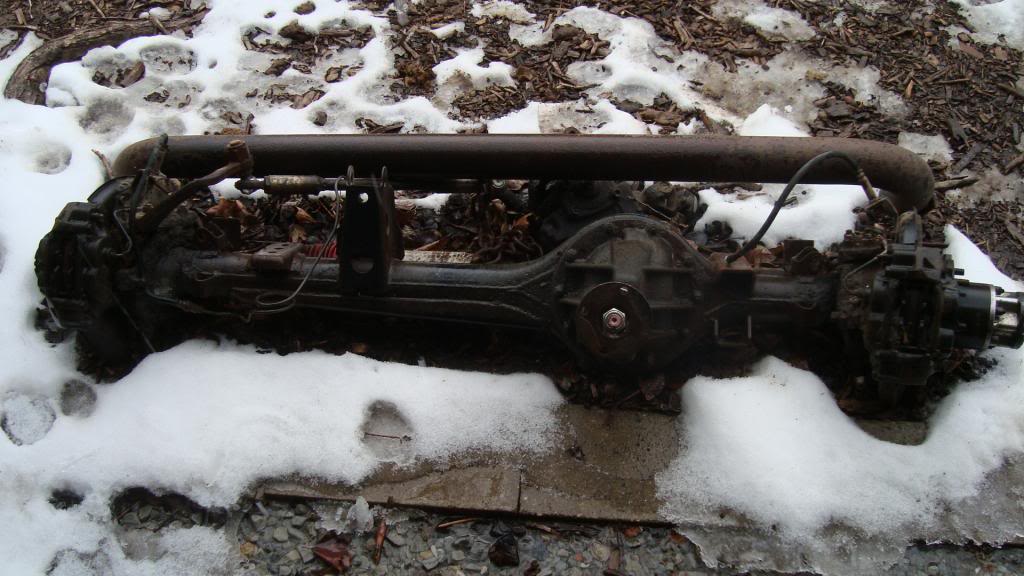

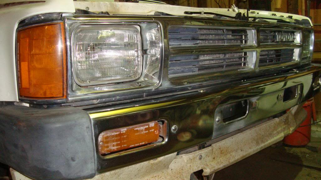

used ball joint spacers are usually sold by the time i findem.. plus id feel more comfortable knowing there a reputable dealer. I see the ebay crap out there and am not very sure if i trust a china suspension component especially something connected to a balljoint. By the way i polished up my frontend and was suprised how well the 20+ yr old chrome shined up.
85 axle for the future...

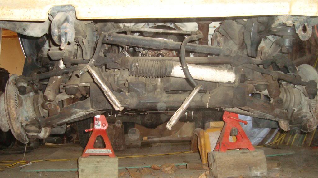

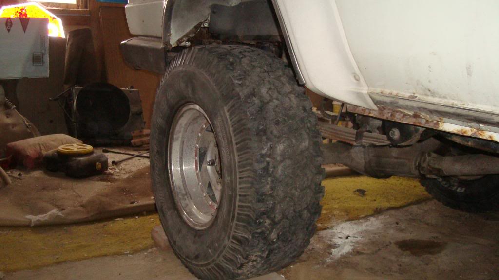

Ooooo another future SAS thread/ nice I gotta and it to ya man i thought my engine was fugged up when i got it but yours tops mine by a long shot. You definitely got more courage then i do taking on a job like like this. Hey do you have any pix of the way your rig sits at right now?
Old Mar 13, 2013 | 04:59 PM
  #158
kornhuskerwizard's Avatar
Joined: Dec 2008
Posts: 2,391
From: tecumseh nebraska
the rear...
the front...

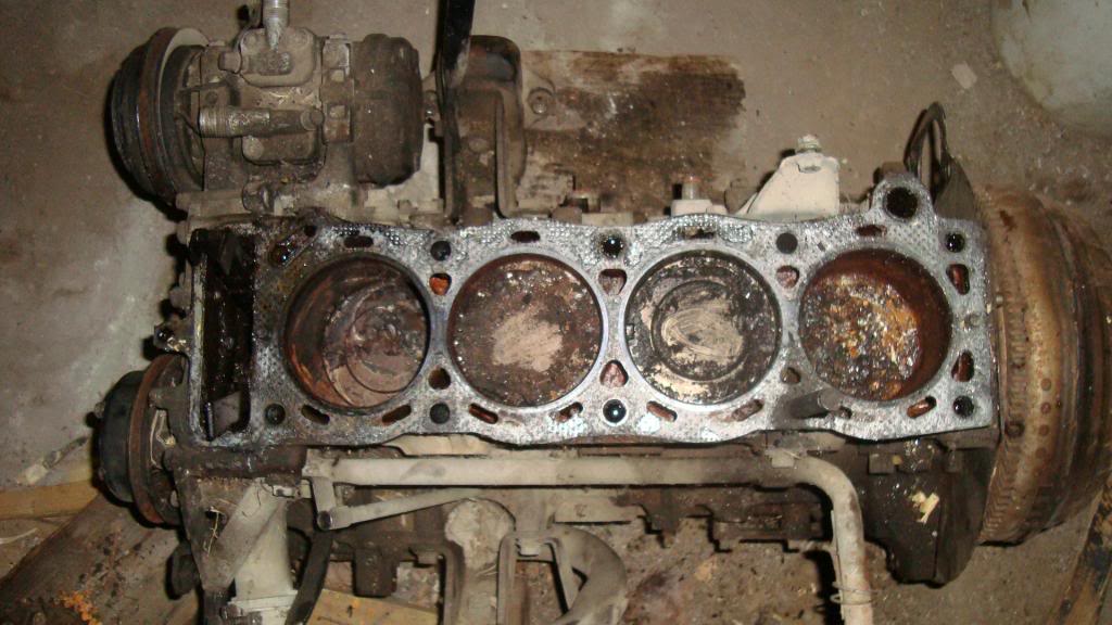

the sweet engine it came with

Just throw some seafoam in cyl number 4 and it will clean right up. Haha. Looking good man. Great find on the bj spacers!

That engine is still locked up and might be forever.
