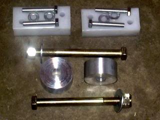

Kit from 4crawler says it will be here tomorrow says the usps tracking info!!

So the brown truck showed up with my diff drop and swaybar drop. I removed the old bolts on the backside of the diff so it pivots on the front downward and installed the drop. Took about 45min by myself, didnt install the swaybar drop yet cause im gonna try and replace the bushings, get the rust off it, and paint it. Just a comment... do i really need my swaybar?? Im gonna be doing highway driving and mild offroading so im thinking it wouldnt hurt to have it. Ive seen disconnects made out of s.s. turnbuckles (simple to make) which i may do in the future. The diff drop and swaybar drop was $35 and was impressed with 4day shipping from cali to nebraksa. I will continue to do business with 4crawler.
So this was the last step i wanted to due before installing the engine (cause its way easier to get to diff with engine out!!) so now the engine is ready to install and the weather is getting warmer!! I plan on getting it in this weekend and i still havent found my sony cable for my camera so everyone can rant about no pics still.
