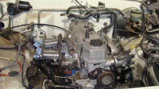

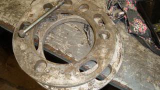

Heres some pics of the engine goin in. Also i found some spacers but there 3/8" actually a little more, somethin millimeter haha!! Great day, ive waited along time to get this engine in so im pretty happy with the weekend so far...

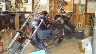

Gettin the hog road worthy, changin oil and kickn tires n lightn fires!!

Great pics. If the spacers are too much you you can check out auto zone. They were the only place that had the ones we needed that had a large enough hub opening. I think they were less than 20$.
It's getting to be the perfect riding weather!

Ran into a snag today... When i went to install tourqe conveter bolts i had to turn the engine over a little (by hand, which turned over BEFORE i bolted trans to engine)and i grabbed crank pulley to turn over and was rock solid...˟˟˟˟˟!! what the heck??!! So i am assuming the torque converter is up against my flywheel in a bind. Ill have to search through my thread but when i installed the flywheel i did some research on how it went together...from crank back...big spacer,flywheel,little skinny spacer,bolts. There is a bevel on the flywheel kicking it back towards the torque converter which is making me think i have it on backwards. This is the part where i wanna kick myslf in the face!! Gonna do some research and see if i truely get the jackA$$ award today.
tightened bellhousing...also can see my diff drop spacers in pick as well.
