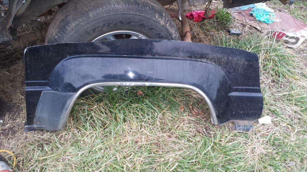

i think i finally have the steel arches for my girl a black 88 is being parted out weather is delaying the cutting but im in no huge rush
then it'll be fixing the sides get some of this stuff a thick vinyl rock guard material for trailers super sticky i think it will be far better replacement for the rock guards by the rear wheels (and along the rockers) which is where a LOT of my rust started so once the steel is in painted get the thick vinyl & heat gun to help mold it to the body no water an dirt behind it anymore

im getting the arch steel which mines all rusted away i can finally repair the rear quarters an seal up the body shell adding the insulation after gotten the inside all primered painted undercoated weather is keeping the person from doing more cutting (papawheellie) ol girl got rolled but the rear arch metal is un touched an is solid

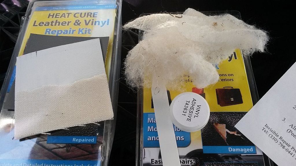

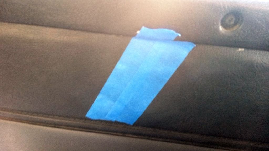

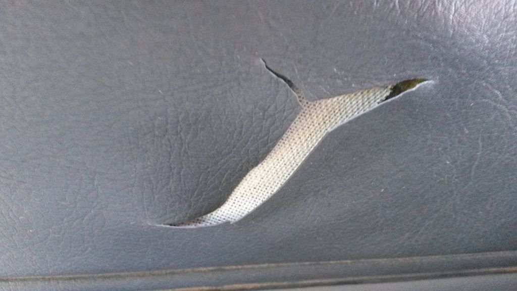

so today i started working on the tear in the vinyl side panel i got a couple of them repair kits one with an iron to heat cure the material i will report on more tomorrow the adhesive has to cure for 24 hrs in the tear
my tear with the repair kits backing material in there i needed to add some cotton fluff to pad the back so it would be level with the rest of the panel (cotton fluff acquired from old mattress going to the dump)
repair kits
cotton fluff remains an vinyl repair glue that bonds the repair cloth to the rips
repair begun has to sit 24 hrs for the adhesive to set an hold the torn parts i put the tape on to make sure it stays stuck to the cloth an is flat tomorrow i work with color vinyl an grain paper

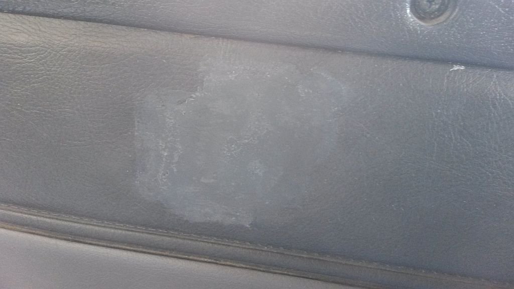

ok the adhesive worked excellently! my color matching an goopy plastering of it not so good but its NOT a tear anymore an thats what is important to me im tempted to use it on the tear on the seam in my roof vinyl
also put some in the cracks in my dash needs a second treatment BUT it did fill the cracks an should help keep them from getting worse just had to be in a corner where the flat heating iron cant get easy
after adhesive setting for 24 hrs soild! would not pull up off underlayment
heating iron
mixing colors
first try at color matching i wiped this off an added a bit more black
after heat setting not ...ehh it sucks for a repair but its not a tear anymore

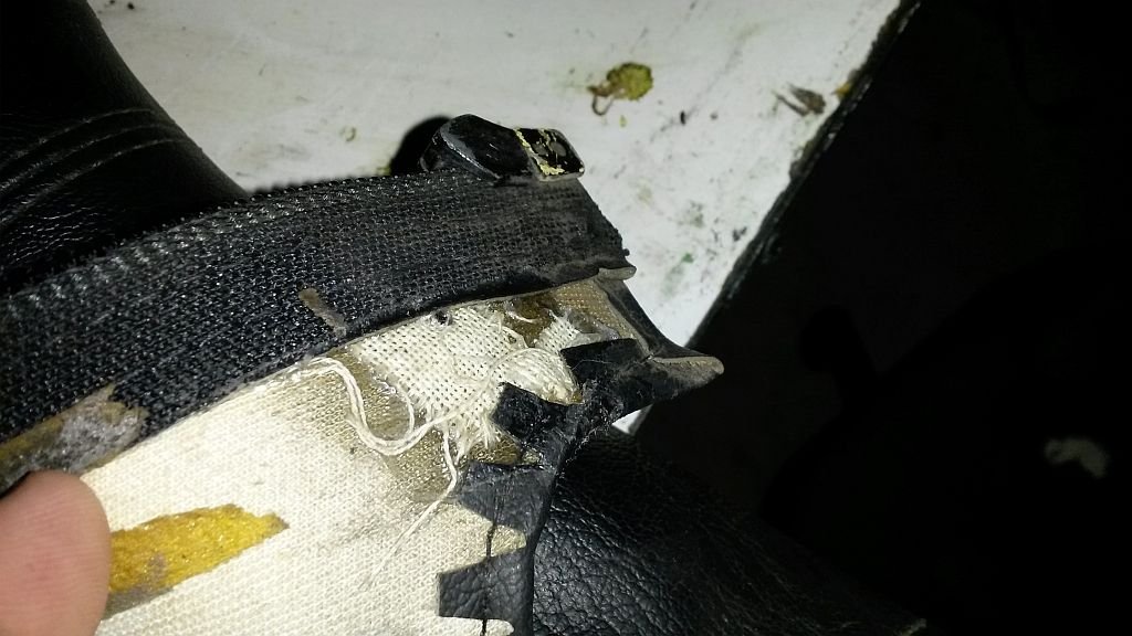

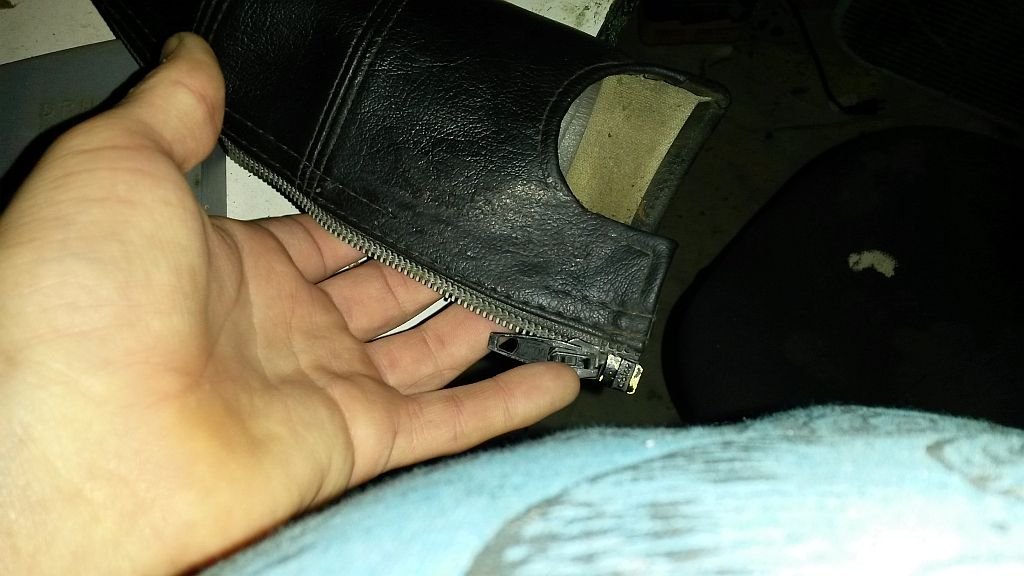

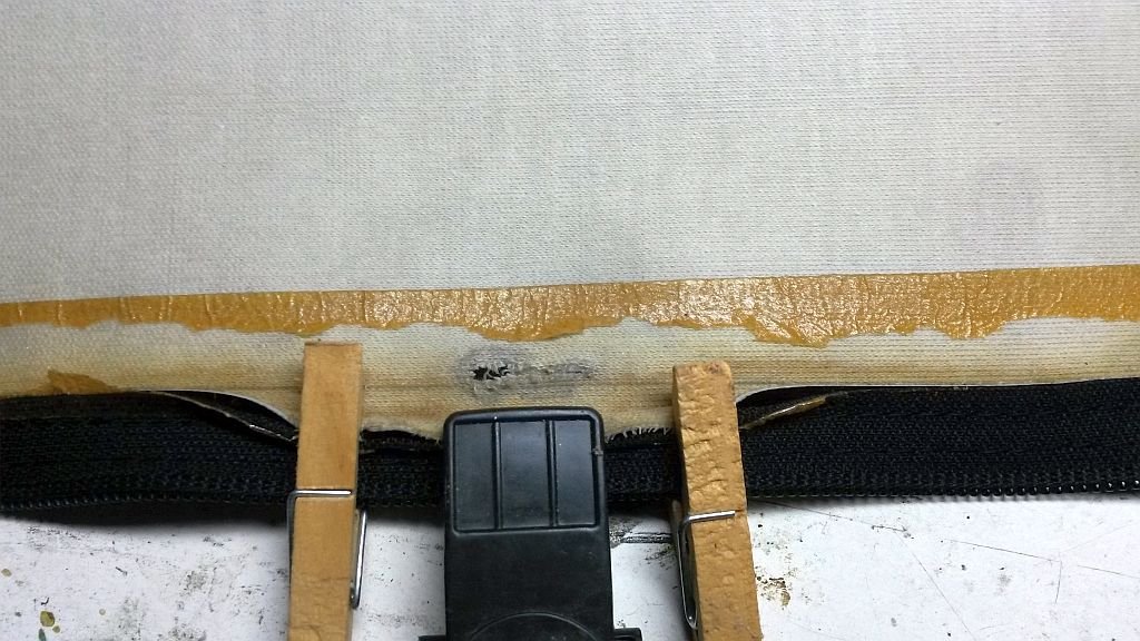

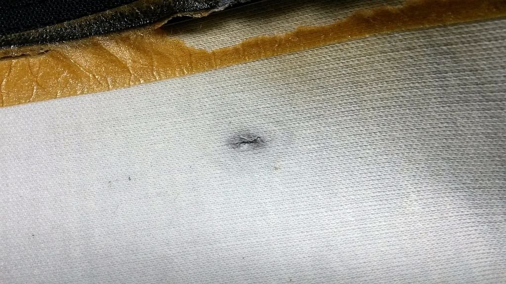

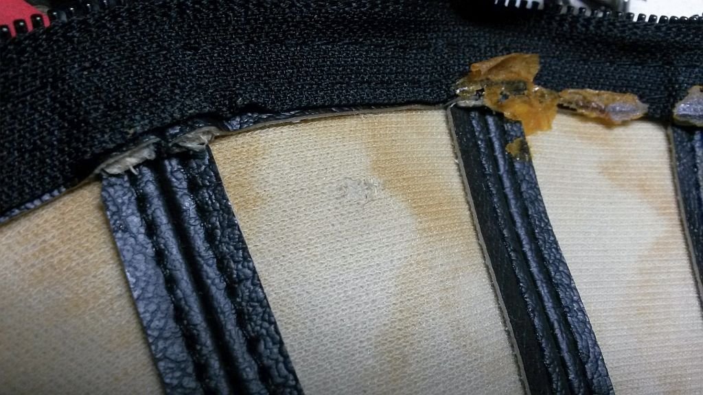

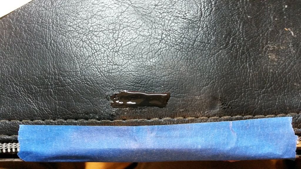

so i bought a roll bar pad an cover from chef (mark) it needed a few fixes an some tlc worst was a tear near where the zipper starts the vinyl bonding liquid an repair cloth fixed it better than if id sewn it
wow she was dirty though (in the grain an stitching) i gave it a good scrub to get the dirt out did the repairs an last night rubbed in leather an vinyl conditioner had a bottle of it from when i wore bull hide boots as a guard made the cover very supple the repairs i think i did a much better job with than the side panel in the truck lol learning process the iron with the kit broke (gotta take it an go braise the thing made of brass) so had to use a normal clothes iron set to near wool did a very good job setting the repair liquid
few pictures of repairs an such
back side at the tear the repair cloth about 3/8in past each side of the tear

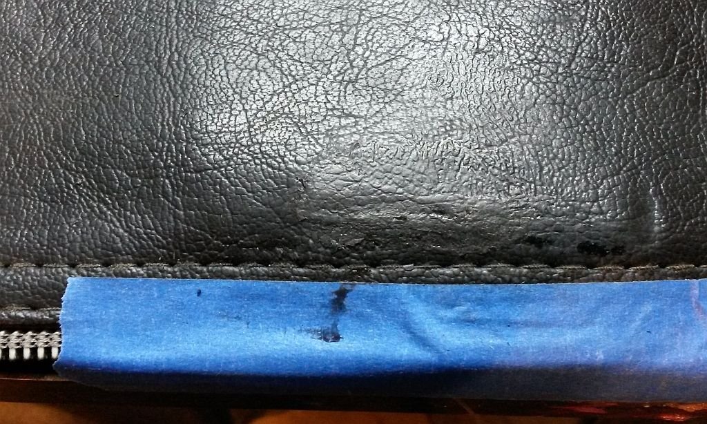

after vinyl repair liquid not too bad really no sign of the tear which would have run along the line of my mid finger from the inside heading towards the zipper
about the middle of the cover 1in wear through spot reinforced with repair cloth
applied repair liquid over spot
after heat set not too shabby an the repair is strong
little wear through holes i patched them with cloth an adhesive no repair liquid as once glued they disappeared
same with this one once glued it wasn't visible from the other side

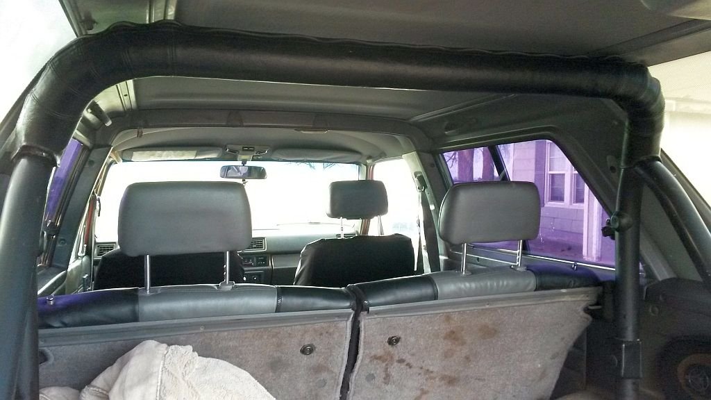

rubbed down with armorall (generic equivalent) and installed looks good now wont have to worry quite as much when the two kids go leaping over the backseat to get in or out...
wiped down before installing lubed the zipper with some silicone
installed on the bar looks good! i can see where some of the wear spots happen the nuts that hold the rear windows in the top are really close to the pad cover

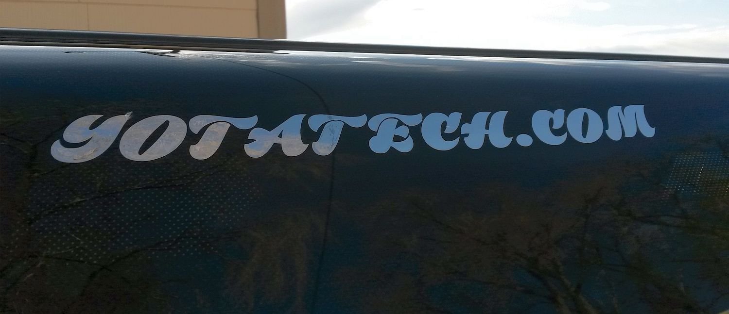

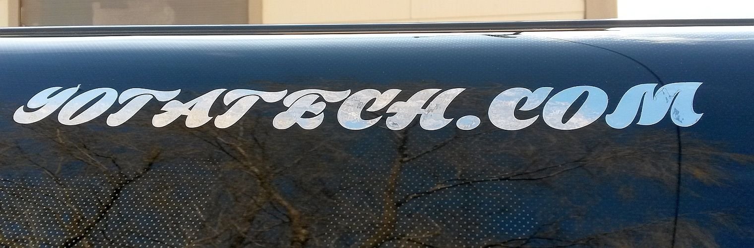

so to show my support for yota tech i got something custom cut for my rig i liked the font better an it came in chrome!
drivers side
drivers side
passenger
passenger
