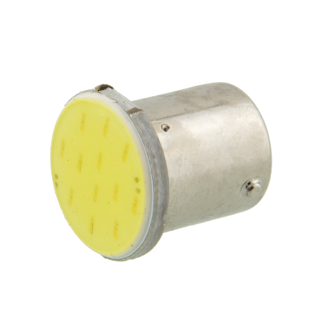

meh another failure the LED COB 1156 bulbs which held a lot of promise fail... now im thinking it'll have to be a panel type to get enough LED's on the job
heres a couple pictures of the bulb in action its fast to light an go off caught it right as it was going off the incandescent is still lit on the left no where as bright either an on turn mode it does the bulb blown flash but that can be fixed via modding the relay IF the bulb was as bright

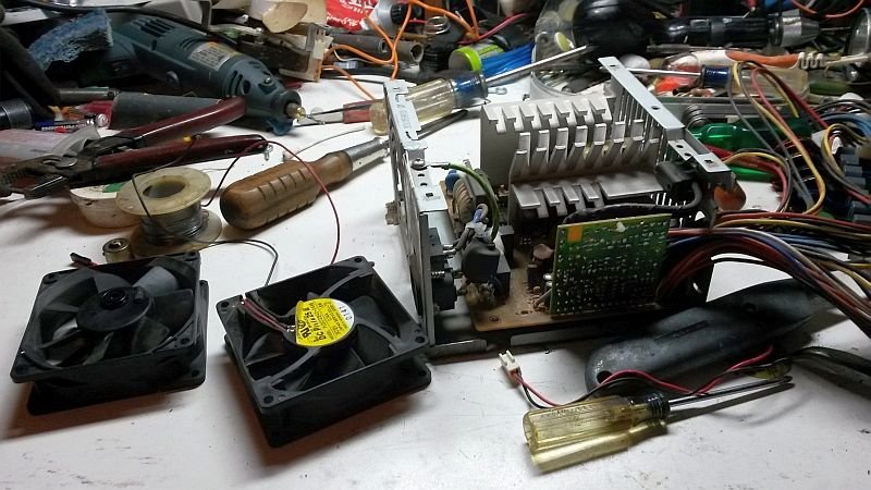

lets see today i got emails my parts are on the way the greaseable rear shackles an spring bushings for the rear

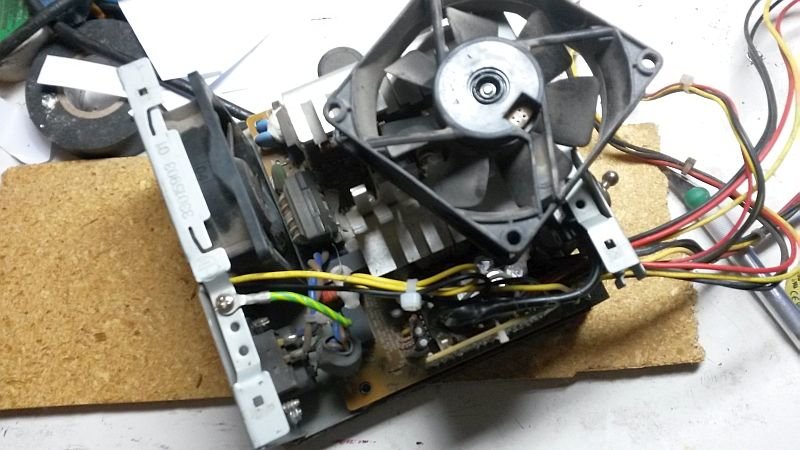

fixed the treager grill he blower fan was all jammed up an they sent us a new one under warranty i grabbed my electrolysis powersupply to do some repairs the cooling fan had failed last summer early on so i had a random pc fan blowing in it to keep it cool
** terry ** reminder blow out yours occasionally to help keep it cool an clean inside
so i replaced the fan cleaned up some of the extra wires that were redundant fixed the on off switch an painted the cover put some labels on it it can also be used to zinc plate nuts an bolts using vinegar sugar and the cleaner A&H stuff a chunk of hot dipped metal will give up a lot of zinc an it will deposit on the bolts nuts brackets (reversing the anode an cathode) so a good clean part hose it off after electrolysis an hang in electroplating bath to coat with a thin layer of zinc
repairing rust buster
all repaired an cleaned up
