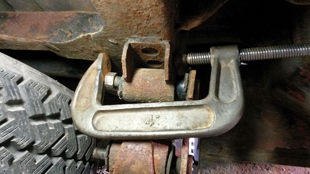

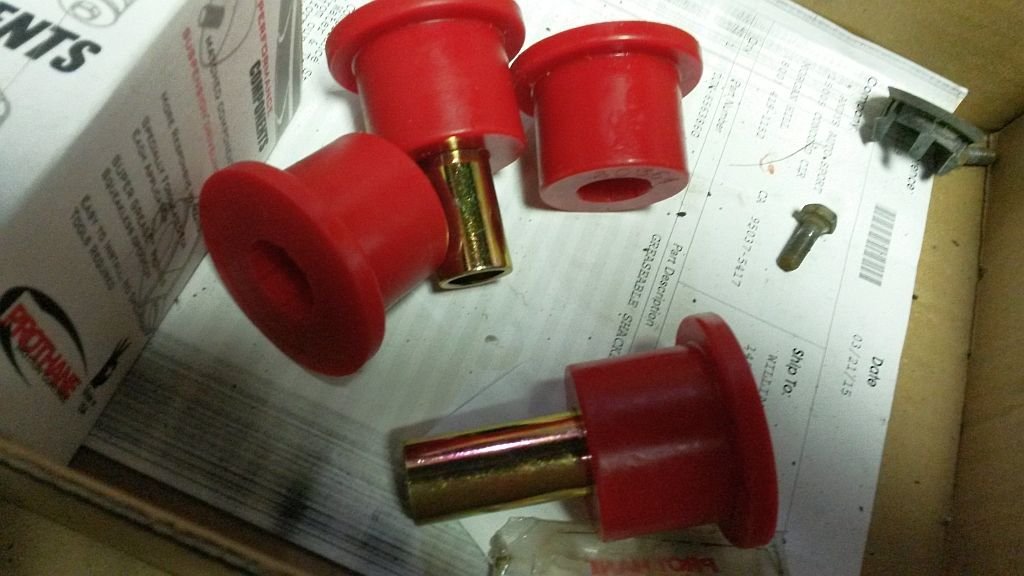

ok the greaseable shackles and polyurathane bushings good pairing not easy on a rust plauged truck
got her up on jack stands which were inside some old rims for a few extra inches of height i didnt want to pull the wheels holding the axle on the jack i started working the drivers side being next to the exhaust the top nut fought me all the way off save the last thread breaker bar 1/5th a turn at a time even oiled an such it fought ugh squeak! squeak! pant pant
working area drivers side

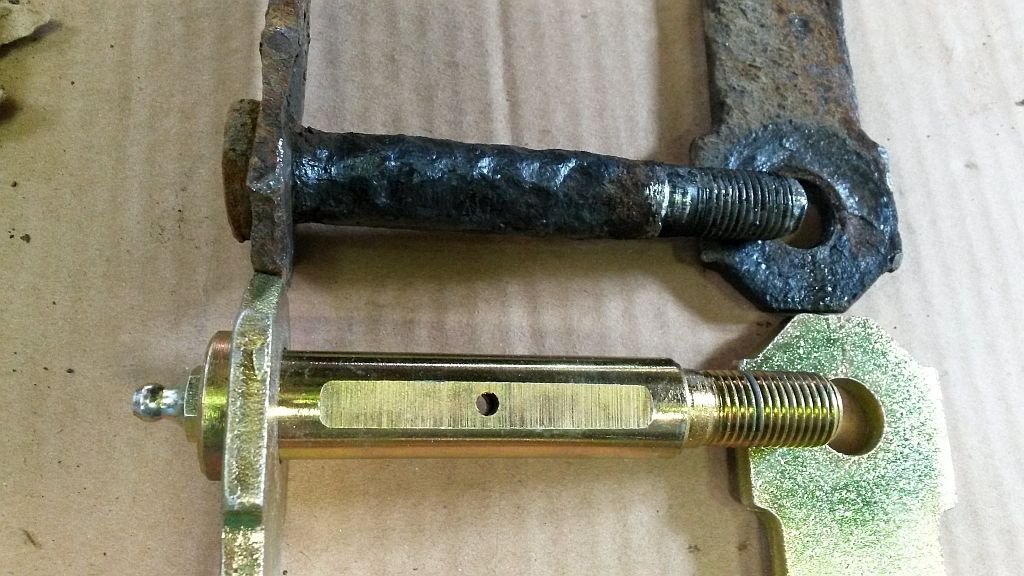

bushings removed not cleaned yet what a pain in the tail getting the shackle out had to use C clamps an slide hammer to get um out

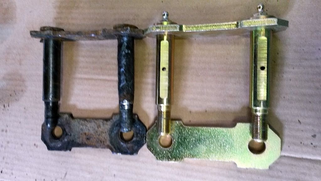

old versus new old 19mm to remove nuts new is 22mm to install really the only diference tween them an the new being greaseable

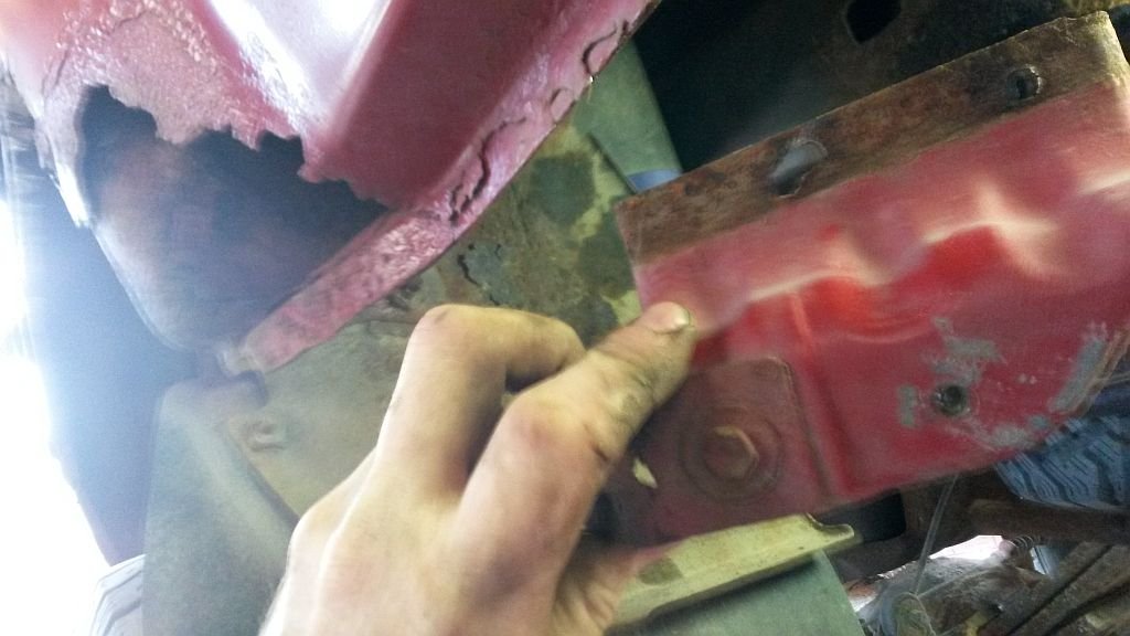

eaten away its worse around the other side

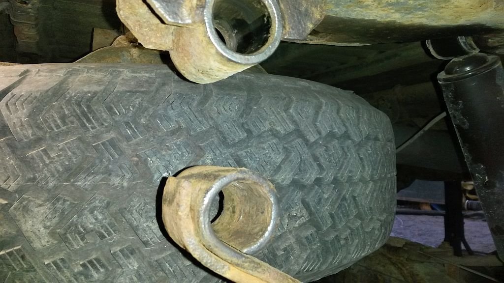

drivers side bushings outer side cracks splits
inner side the right pair are from the spring left from the body mount

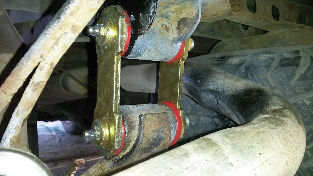

cleaned up then primer an paint ran out of both at that point
info on how to, not looking forward to the front eyes likely have to burn them out the kit does come with new steel sleeves
front eye bushings an sleeves
pressing bushings in to frame mount
installed after the spring bolt decided to come out of the brace had to press it into the bushing and bracket at the same time ugh...
an more to come the passenger side!

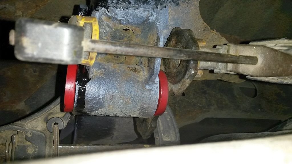

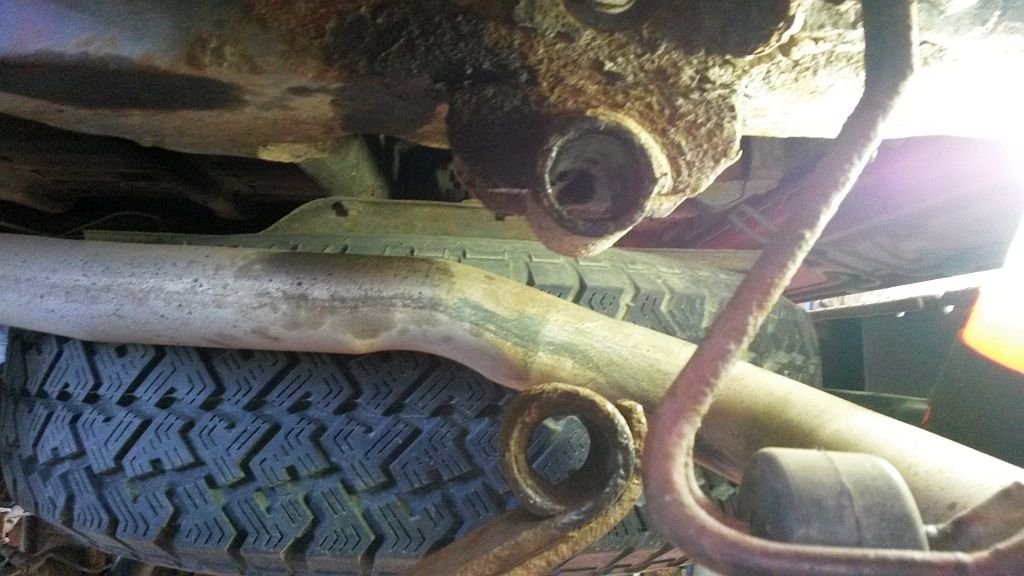

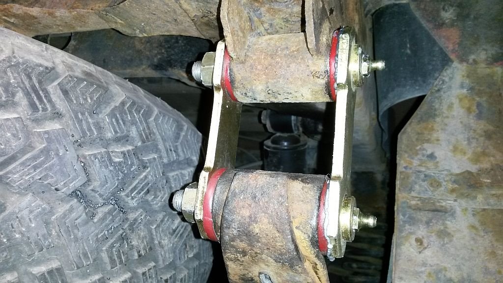

an now folks the continuation of the project

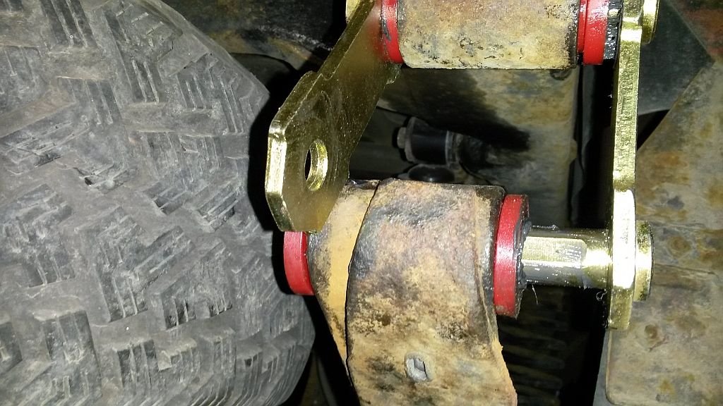

the passenger side surprised me the nuts came off without a fight thought Heyyy maybe catch a break ...yeah stupid of me to think that
wouldnt slide out of the bushings god did i have to fight it
annnnnd thats why the bushings were frozen on due to corrosion i had to shove them through the body mount to get it off

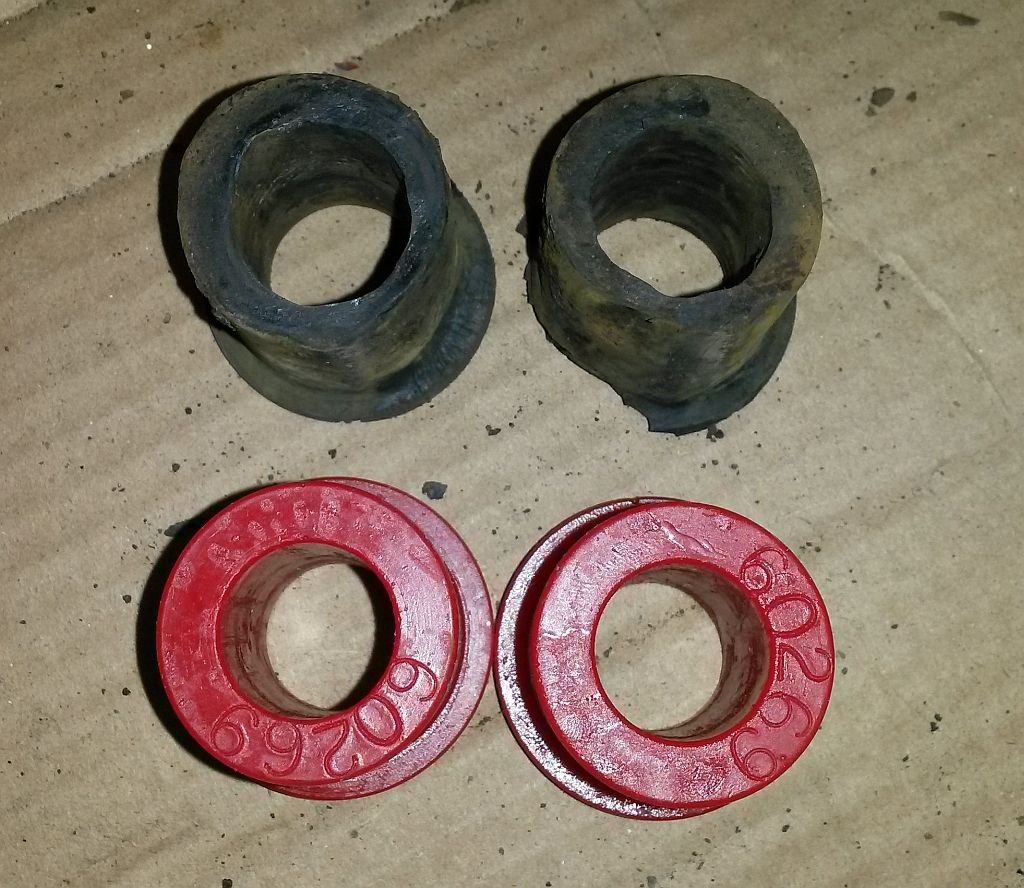

comparing the old to new bushings
somewhat cleaned

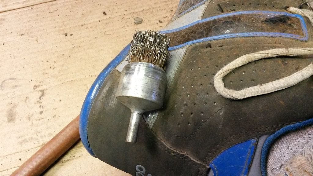

using this brush inside the holes Juuust fits you can see where its polishing itself on the mounts

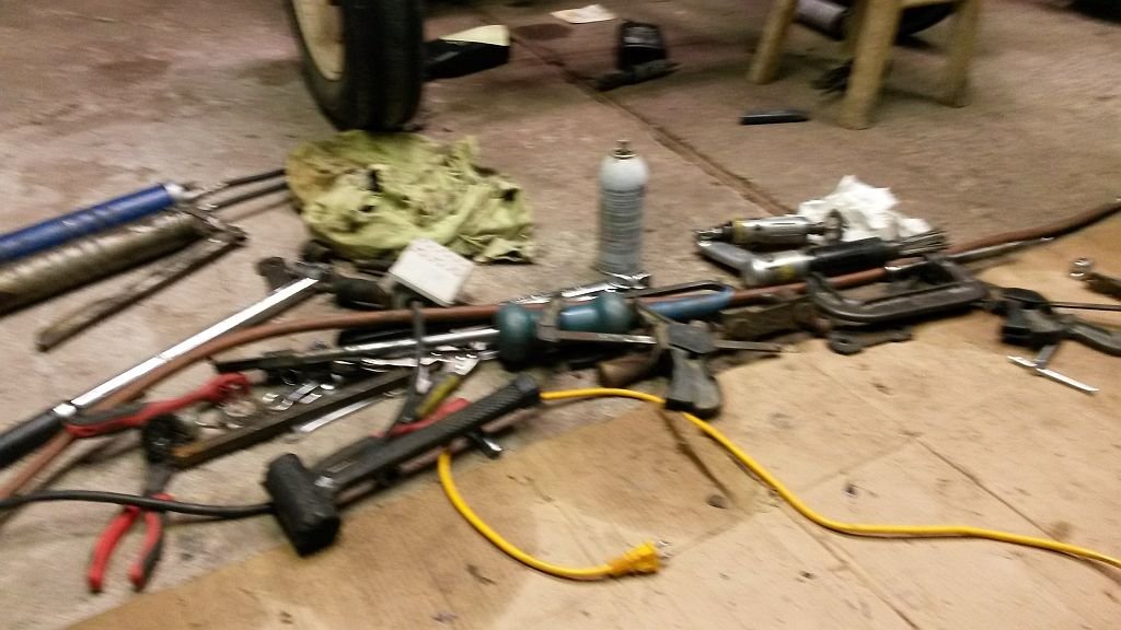

annnd it fought me being installed too at this point i thought i had it noooope it shoved the inner bushing out an i had to start all over taking the shackle out an reinstalling the bushing after trimming a small bit of damage to the bushing off
and with my dinner getting cold FINALLY i got it tourqed the nuts to 65 ft-lbs the book says to go 50 -75 so let um go a bit then ill retourqe them
the pile of tools needed for this an im not even done yet collapses

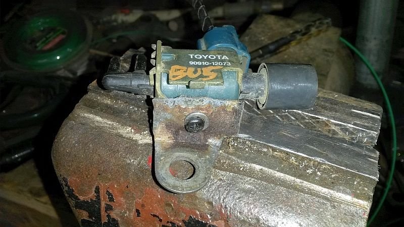

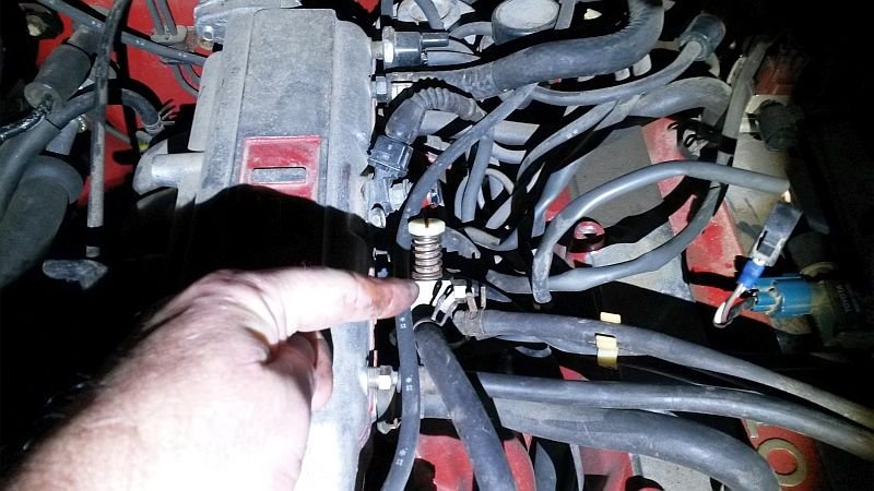

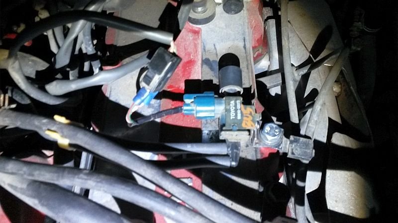

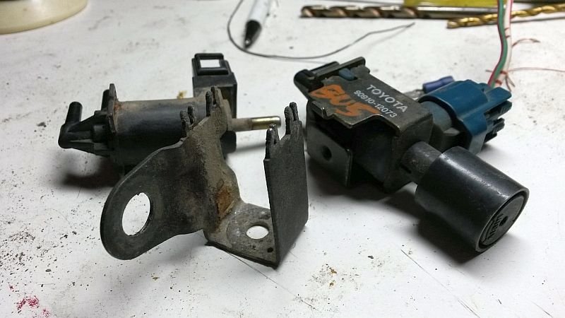

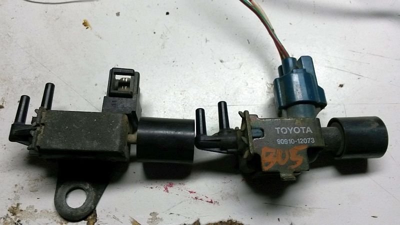

the T100 VSV arrived today so heres how to quite easily adapt it since the original is near impossible to find an the t100 part was only 11 bucks
so here we have the failed VSV on the left an the replacement on the right i did test it via a 12v DC power brick it clicked nice an loud the original didnt top wire is live so + an the bottom connector is the switched negative an when the AC switch is turned off an on it turns this valve off an on as well
so removed the bracket as i still want to bolt the VSV to the valve cover i need the tab an some of the old bracket
so after a bit of grinding off the excess bits an bending it up i drilled the small hole for a very tiny screw that i found one that fit after being trimmed down to less than 3/8 of an inch
heres the T100 VSV now attached to the tab from the old one
an here it is on the engine now i got it with a pigtail of the T100 harness an id recommend it in my case i put a couple male spade terminals on it so they plug into the factory harness plug i could have cut the original harness an put the new in but ehh i taped it all up nice an neat after this so it can be water proof an wont flap around
this is the idle adjustment valve if its working when the VSV is activated it allows more air into the engine bypassing the throttle plate causing a controlled increase in engine rpms which keeps the AC compressor on as it will cycle off at normal idle rpms but not around 1K rpms the white adjuster is how you adjust the AC idle and also works with the power steering if its loading the engine down
