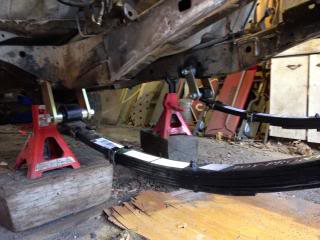

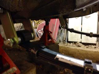

Went to the hardware store and picked up a chunk of the EMT 1" conduit and fit nice inside the tubes. So i started on the passenger side and it was obvious that it was not sqaure with the frame so I used the end grinder to give me some clearance for adjustment and did the same with the drivers side then using my sqaure against the side of the frame for a reference until they were good. to check the horizontal sqaureness i slid the conduit through both tubes and measured from the front of the truck at the frame back to each tube until they were the same distance. The distance from inside of tubes was 25" I went ahead and tacked them in place for now. Also when i was finished the conduit slid nice and free between the tubes.

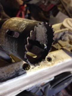

hole saw bit when i was done with it.

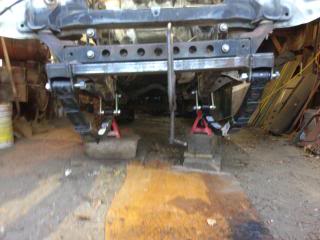

fitting the tubes with the conduit
the results...
